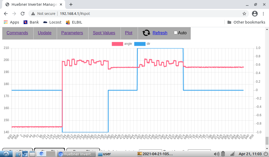

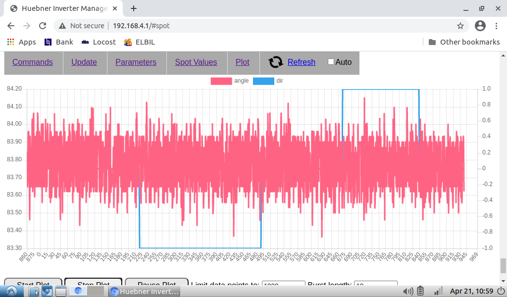

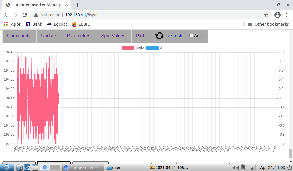

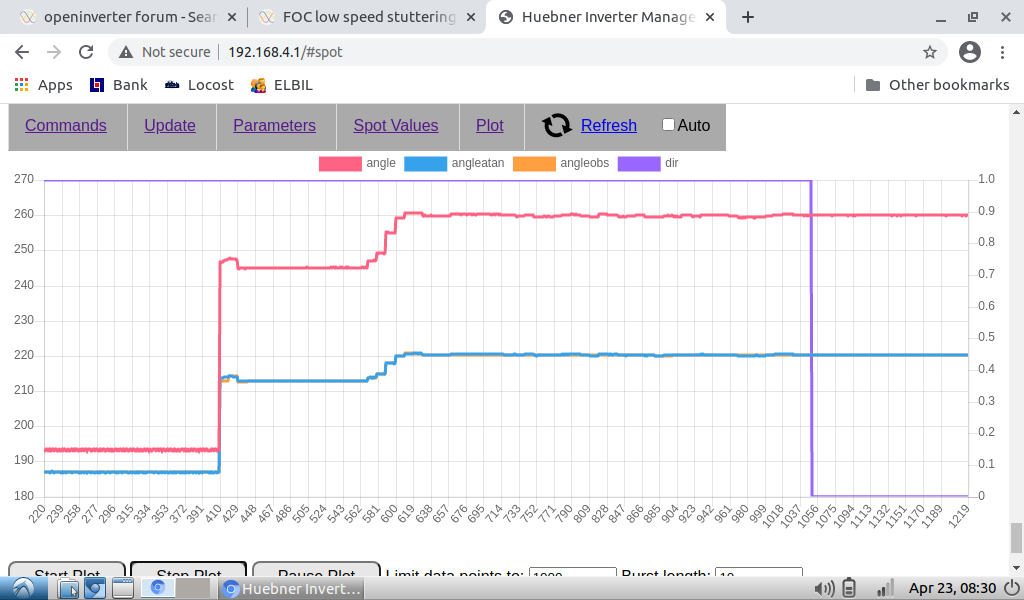

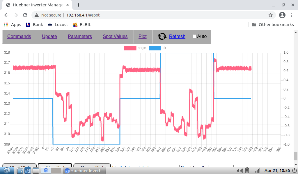

Unfortunatly it has no effect on the stuttering and now it is also unstable at standstill. I can see an increased current draw when selecting a direction compared to neutral and can also feel it in the car.

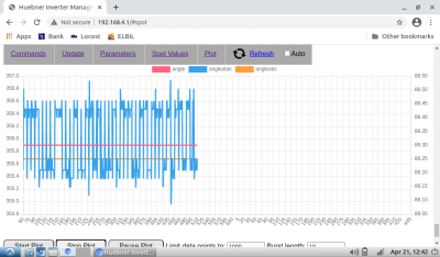

Some plots to illustrate: Any other plots that can be helpful at this point?

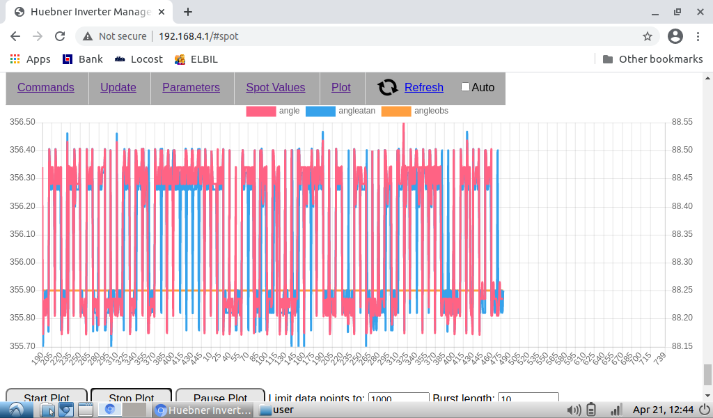

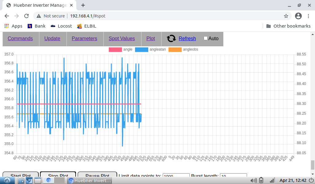

That's weird, not seen that on my setup, although it's only on the bench. I'll have another play when I get home.
So you have <0.5degree noise with the 5.0 (atan2) software? I don't expect the observer code to give a massive improvement in that case.
I can't explain the jumps in angle with changing direction. There's no 'direction' input in the angle code, only thing I can think of is some very small movement of the motor getting in there? (Do you have idle switched on?) But even if so, that much change in angle isn't great.
Could you try plotting angleobs and angleatan? This should confirm that both output the same angle, and any instability in the observer code compared to the atan2 code.
One other question - did you choose 'TIobserver' for 'anglemode' (beneath the dropdown to choose the encoder type on the web interface)? It defaults to the atan2 code.

Ok, I totally missed that I have to change a parameter... There is then something else in the test code making it unstable. I don't expect the direction signal to be the cause, but rather the fact that the inverter starts outputting PWM, hence driving the motor.
I think we can leave the jump in angle for now. Not the main issue. There is of course some backlash in the gear reduction etc so the motor can turn slightly even if I'm pressing the brake.
I get the same instabillity with both atan2 and TIobserver. However with TIobobserver I get no observable noise on angle... Angleatan and angleobs seem to agree but there is a about 90 degree angle difference between angle and selected angleatan or angleobs?? Is this due to my number of motorpolepairs(4) or resolverpolepairs(2)? And what does the angleofs do, default to 2048? Could this give an 90 degree offset?

The instability is strange, I'll dig into it when I'm home and see if I can find a cause. I could also put the new observer code into 5.0 perhaps as a test.
Ok, no noise with TIobserver is good, it's doing what it's supposed to (although I don't think your previous encoder noise was bad at all!)
angleatan and angleobs are both 'resolver degrees', whereas angle is scaled to electrical degrees - it won't (shouldn't) just be a fixed offset, but unless you can turn the motor fairly slowly through 360deg it might look like an offset - in your case, electrical degrees = resolver degrees * (4/2) (or angle = angleobs * (motorpolepairs/resolverpolepairs) or angle = angleatan * (motorpolepairs/resolverpolepairs))
Angleofs - do you mean sincosofs? This is also mine (but in Johannes's code now too). It only affects those with encoders (not resolvers etc) and just allows setting the 'midpoint' of the encoder output if it's not centred on 1.65V

Yes, the instability is strange. I'm thinking that it might not be caused by your additions either.
If you can create a .bin file of the SW before you added your changes I can test with that and then we will know if it is caused by this or something else?
Ok, nothing strange about the difference between angle and angleobs, just me not understanding the inner workings of the SW...
Correct, I mean sincosofs.

I'm really confused. I can't replicate this at all here (although this is only on the bench, but it's still a complete inverter/motor/encoder/etc setup).
Here's the TIobs_nosyncadv firmware that you had instability issues with running here: (angles on the left, direction on the right)
No steps in angle, or anything obvious changing when direction is changed.
What are your idle settings? (I have no idle set here)
From your previous images:
This is with the atan2 angle code, and 'only' a few mechanical degrees movement. Although using the atan2 angle calc, this is still using the observer speed calculation though (which then affects synadv)
This sort of makes sense - there will be a bit of movement due to play in the drivetrain and compliance from various bushings etc, so the motor could easily be turning a few degrees even with the wheels locked. That the movement appears to be in the same direction in forward and reverse could be down to the observer code outputting a (small) speed (absolute) by the firmware not changing its sign as the speed is lower than its threshold? Not certain why the stock firmware doesn't display any movement though - kinda ruins the above theory, but the 'movement' could actually just be syncadv being overly sensitive at low speeds...
The big step at the beginning is harder to explain...
My best theory is that this is down to the speed calculation in the TIobserver code - the observer sync advance wouldn't affect the atan2 measurement, and whatever is affecting it affects both atan2 and observer angles equally (and the 'shape' of the disturbance looks like the behaviour of the observer). I don't know why I can't replicate here though. (apart from no idle meaning no movement or pwm output on angle changes - it's difficult to hold the motor still)
Would you be willing to:
I guess unplugging your motor phase wires and doing the direction test would get a 'true no movement' sample, but that seems rather excessive!
If the 'stock_speed' firmware works for you, then I can either implement a threshold like the stock firmware, or make the syncadv less sensitive at lower speeds perhaps? Or just keep the stock speed calculation
- Share your idle settings
- Try the attached 'stock_speed' firmware (this uses the original speed calculation)

Here are my parameter file for the 5.0SW. Idle at stock -100, so should be deactivated.
Tested again with stm32_foc_TIobs_nosyncadv.bin, instability is back. Made a plot as per below. Had to move the car slightly to get the instability to start. Hard to see with this scale but there are a slight oscillation in angle. Regarding the instability. I can hear it and feel it in the car and I also see an increase in battery current. It might be down to my combination of motor/resolver pole pairs, mass off the car, backlash in gearbox etc. Thats why you are unable to recreate it in your setup.
As you guessed, it seem to originating from the speed calculation.
With the stm32_foc_stock_speed.bin the instability is gone!Tested again with stm32_foc_TIobs_nosyncadv.bin, instability is back. Made a plot as per below. Had to move the car slightly to get the instability to start. Hard to see with this scale but there are a slight oscillation in angle. Regarding the instability. I can hear it and feel it in the car and I also see an increase in battery current. It might be down to my combination of motor/resolver pole pairs, mass off the car, backlash in gearbox etc. Thats why you are unable to recreate it in your setup.
