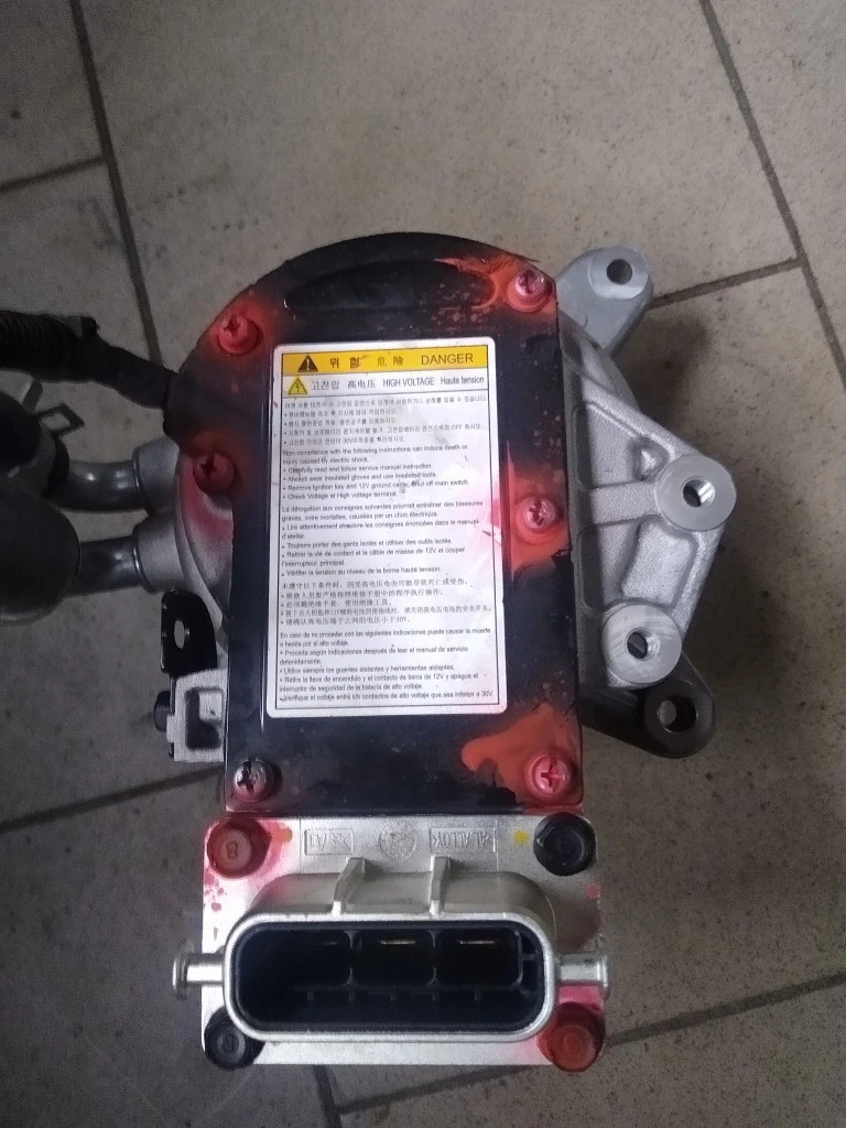

The best bet for the HSG is a Honda IMA inverter. It doesn't make sense to use a 50kW inverter to drive an 8kW motor although you certainly could. Openinverter can handle the resolver directly or you can use a Lebowski controller brain with a resolver interface. The HSG is an IPM (internal permanent magnet) motor so it will run best with a Field Orientated Controller. Oak Ridge National Labs in the USA have pushed that motor to 23kW, not bad for a 8kW rated motor! I have run the motor up to 14,000 rpm with a Lebowski controller at 190V with a Honda IMA power stage and field weakening. The motor is rated to 15,000 rpm. You do not need 190V, the motor runs fine on 18S lipo. Without field weakening the kv is ~ 32rpm/V and the motor will produce in excess of 40 Nm of torque.volski1 wrote: ↑Fri Mar 19, 2021 8:46 pm "Hi folks"

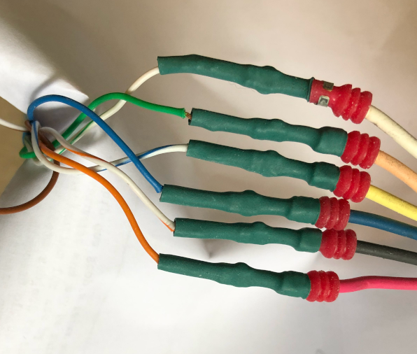

I just got one HSG motors AND Honda IMA inverter. I intend to make a small setup of about 52V or so to drive a DIY 3wheeler for my son.kiwifiat wrote: ↑Sat Mar 20, 2021 7:21 am The best bet for the HSG is a Honda IMA inverter. It doesn't make sense to use a 50kW inverter to drive an 8kW motor although you certainly could. Openinverter can handle the resolver directly or you can use a Lebowski controller brain with a resolver interface. The HSG is an IPM (internal permanent magnet) motor so it will run best with a Field Orientated Controller. Oak Ridge National Labs in the USA have pushed that motor to 23kW, not bad for a 8kW rated motor! I have run the motor up to 14,000 rpm with a Lebowski controller at 190V with a Honda IMA power stage and field weakening. The motor is rated to 15,000 rpm. You do not need 190V, the motor runs fine on 18S lipo. Without field weakening the kv is ~ 32rpm/V and the motor will produce in excess of 40 Nm of torque.
I found resolver connector is really easy to get from ebay or aliexpress. 10P male connector on the motor requires sealed female connector wired.
https://www.ebay.com/itm/20-set-1-2-3-4 ... 3233166806
What i dont have is resolver pinout and eventual thermistor so i can make a connector and test the motor with my Volt inverter before i proceed to make a Lebowski brain for IMA. I seem to remember you discussed HSG resolver pins somewhere online.

http://www.kniro.net/hybrid_starter_gen ... s-762.html is useful but has the wrong pinout, but http://www.kniro.net/resolver_sensor_sc ... s-768.html has the right resolver pinout for the HSG

Excitor coil is on pink/white. Feed back signals are on blue/yellow and black/red. I have almost finished my IMA/Lebowski board that includes resolver support for the HSG. Off to the pcb manufacturers shortly. I got plugs from Aliexpress but Autoclick in the UK have them too. I also tracked down the IMA main plug, digikey part number 670-2925-ND and pins 670-2268-1-NDarber333 wrote: ↑Fri Apr 02, 2021 6:19 pm

I only have one remaining BobC board available and the required resolver to Hall converter for an IMA conversion. There are three guys in the US and one in the UK working on Lebowski/IMA conversions now and Arber333 is about to start one. The single board solution for the IMA inverter is a little way off. PM me for details.
If you search for 174655-2 on Aliexpress you can find the HSG resolver plugs pretty cheap. The main plug and pins for the IMA inverter are available from Digikey.

Hm... would it be possible to modify your board to have pinout for the actual IMA driver board. Then what it would require would be pins going straight up soldered from driver pins/current sensor pins connecting with our lebowski board.kiwifiat wrote: ↑Fri Apr 02, 2021 10:33 pm Excitor coil is on pink/white. Feed back signals are on blue/yellow and black/red. I have almost finished my IMA/Lebowski board that includes resolver support for the HSG. Off to the pcb manufacturers shortly. I got plugs from Aliexpress but Autoclick in the UK have them too. I also tracked down the IMA main plug, digikey part number 670-2925-ND and pins 670-2268-1-ND
I see your application is prepared in the size of the brain board. Do you intend to unsolder the brain board and use your board on top of the drivers?
Then what it would be required is just +/-15V driver power supply and 5V supply for the sensors. I am leaning towards replacing the mainboard completely since it is only needs isolated power supply. And that could be achieved using regular 24V power supply from the main battery split onboard using zener diodes. That would give +15V to GND and -8V for the rest.

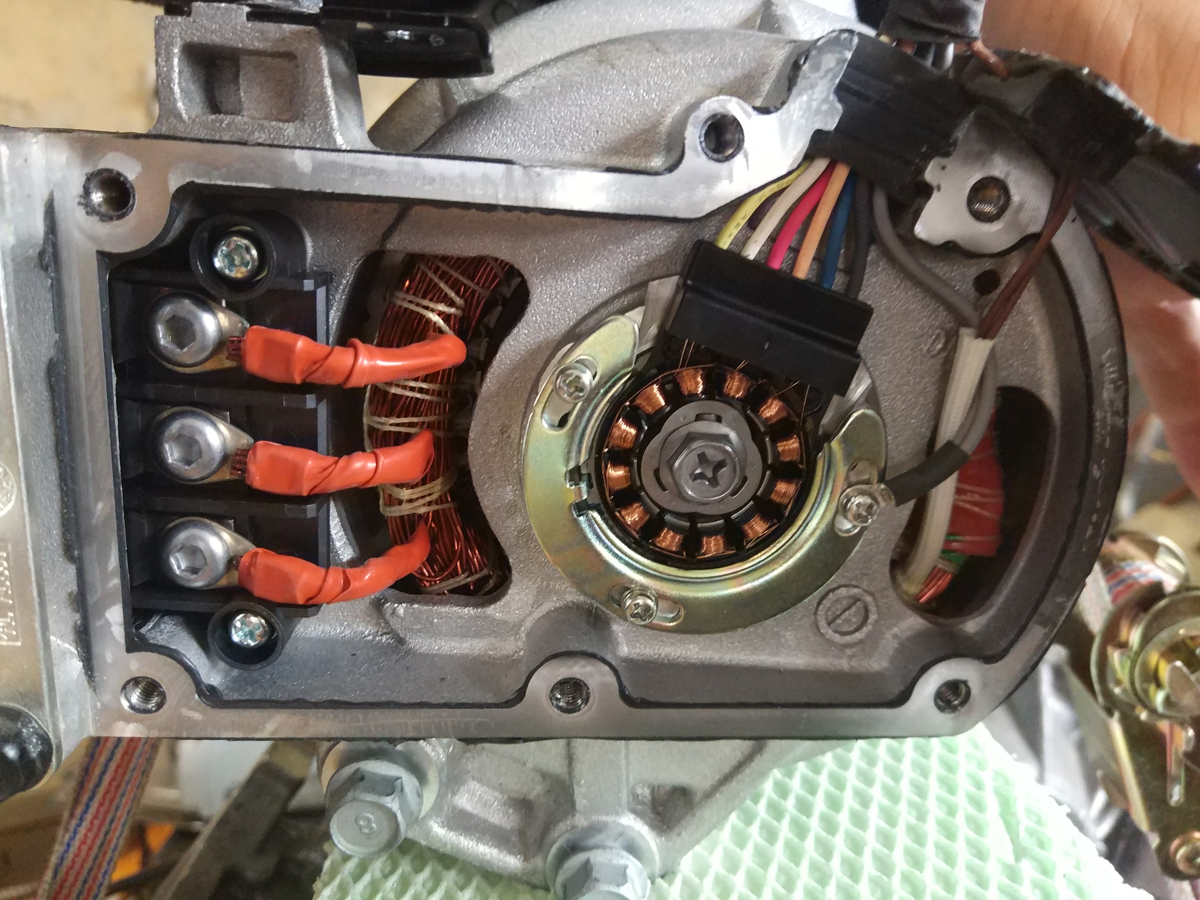

I got one HSG motor and i prepared my Volt test inverter to drive it with 360Vdc. That is correct! I applied full pack voltage to motor that in OEM uses However there is a twist . Since i will also be trying to run Outlander motor via BOTH power sections i decided to connect my HSG motor via the small power section meant to drive the Volt transmission Aux oil pump. Lebowski makes this almost too easy and i was spinning the motor via settings for regular Prius AC compressor in no time. 9000rpm at 35000erpm, go figure... This means motor is 4 pole pairs! I measured phase resistance and got 460mohm so i divide this between phases and i get 230mohm for a single phase. I tried FOC calibration and got some more results.

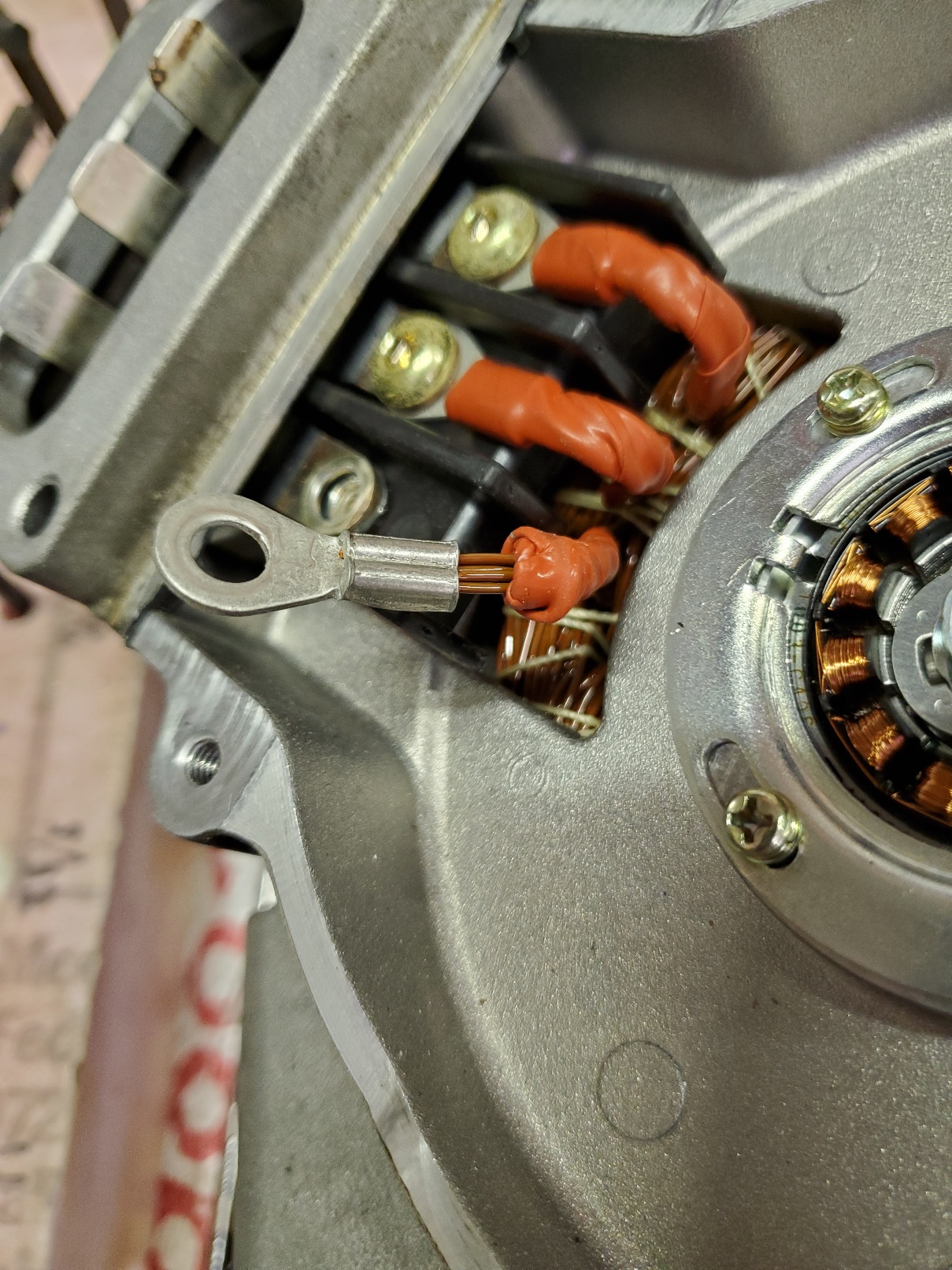

I was surprised to see each cable is just 6 strands of the motor winding wires crimped to a ring terminal. Does this limit the amps it can be force-fed?

Re: HSG - Hyundai/Kia
Maybe 6mm2? That would mean some 60A to 100A current limit.
It will not be force fed. It just wont accept more amps once stator is saturated.
On start from 360v i see 8A that falls to 1A with steady acceleration about 5000erpm/s. I may try for main power connections since small power section is limited to about 25A max.
