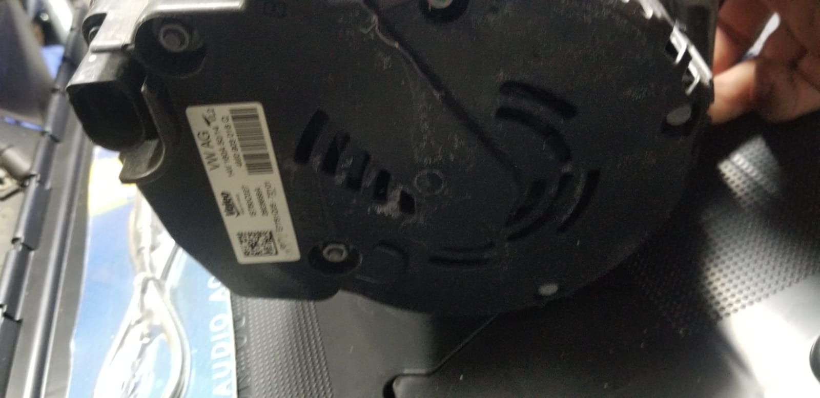

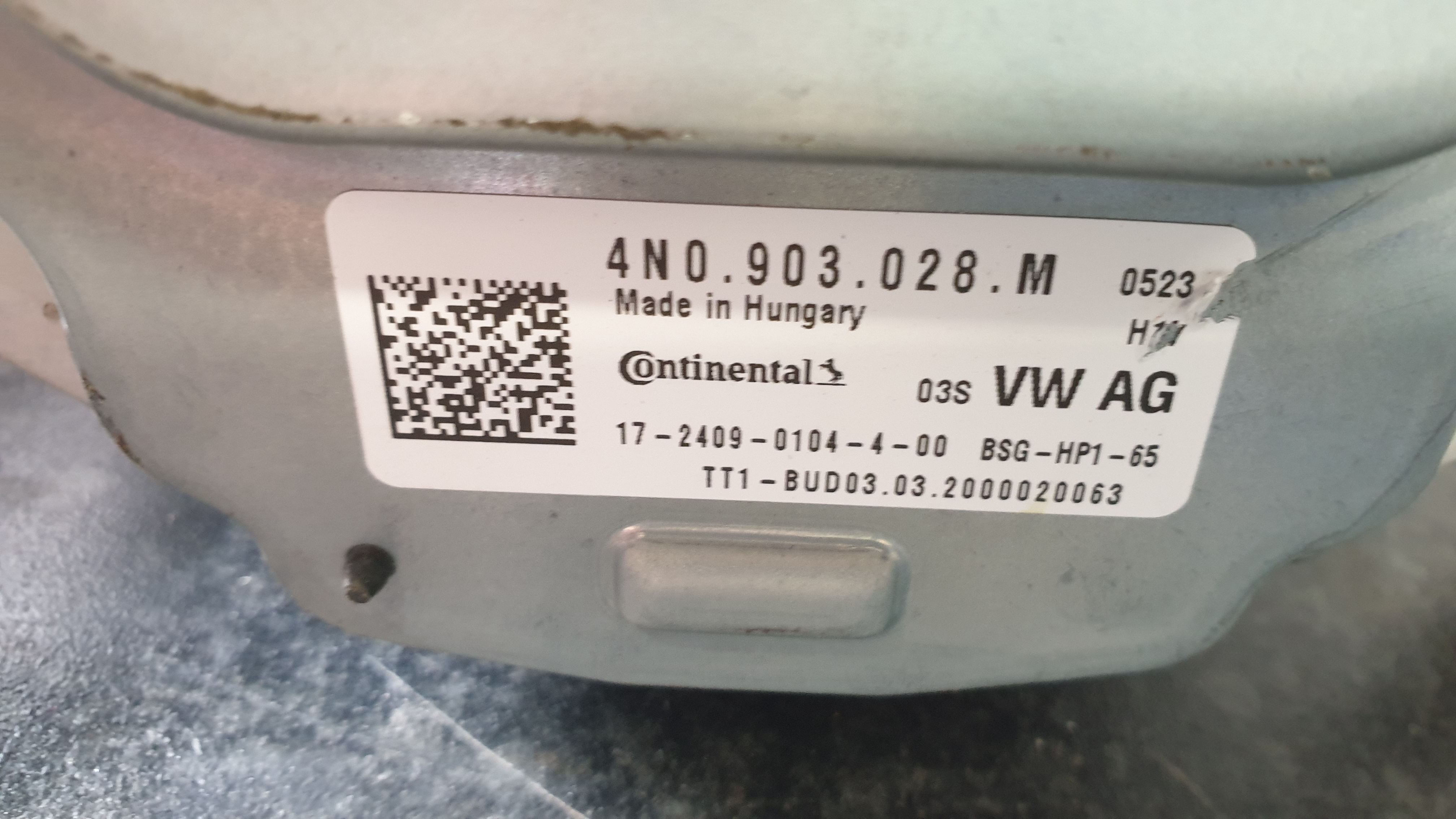

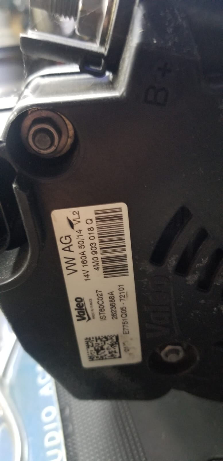

Thanks to the automotive industry trying desperately to hold onto the ICE as long as they can we have been gifted mild hybrid parts. The current specimen is from Johannes favorite automaker. Purchased just recently from ebay Germany :
https://www.ebay.de/itm/AUDI-A6-A7-4G-A ... 4579021396
It seems to be brand new and never fitted to a car. As the seller has quite a few and I observed some minor chips and scuffs on the casing I'm guessing its a qc reject straight from the factory.

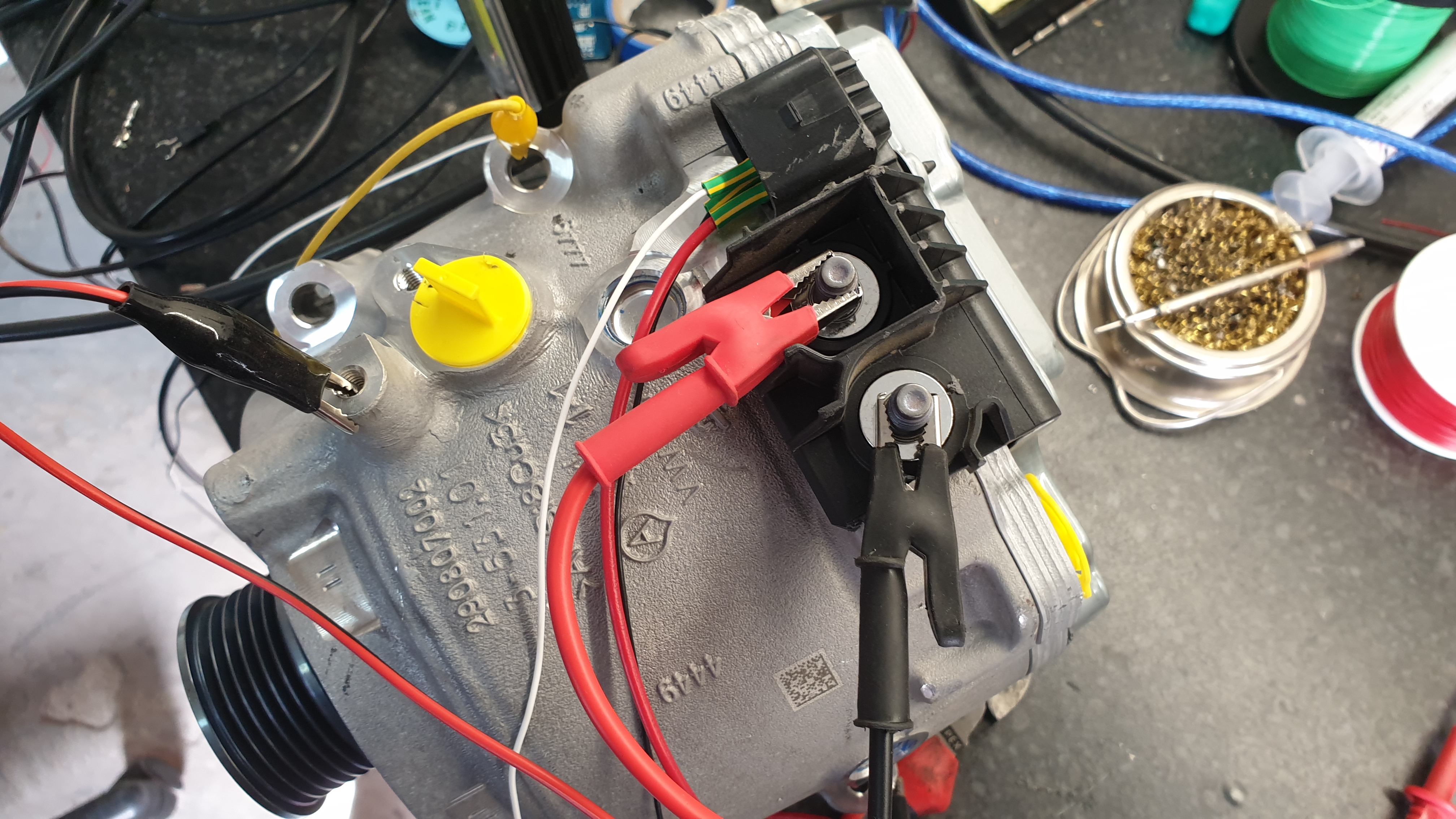

A small donation to the Audi tech info website later and we have a wiring diagram from an A6 with just such a unit. 5 pins out of a possible 8 are populated. +12v , CANH,CANL,LIN and a wierdo called SIG that seems to pump out a 125Hz square wave. Anyway, with 12v and 48v applied it sits there looking at me doing nothing but consuming a steady 120mA from 12v. Sigh....always the hard way...... without any can logs or info I set off via the long road. Some savvycan fuzzing later we find it wants to see 0x3c0 with byte2 bit2 set to wake up. You're welcome.
Attached some can logs. I have observed what looks like rotor rpm in 0x1a0 byte 2 and 48v voltage in 0x1ac bytes 6 and 7.
The rotor does not cog so is either wound or induction. I'd bet the former.
Now just to find the control commands..............
I'll ask just for the fun of it : anyone got a can log from a vw mild hybrid?

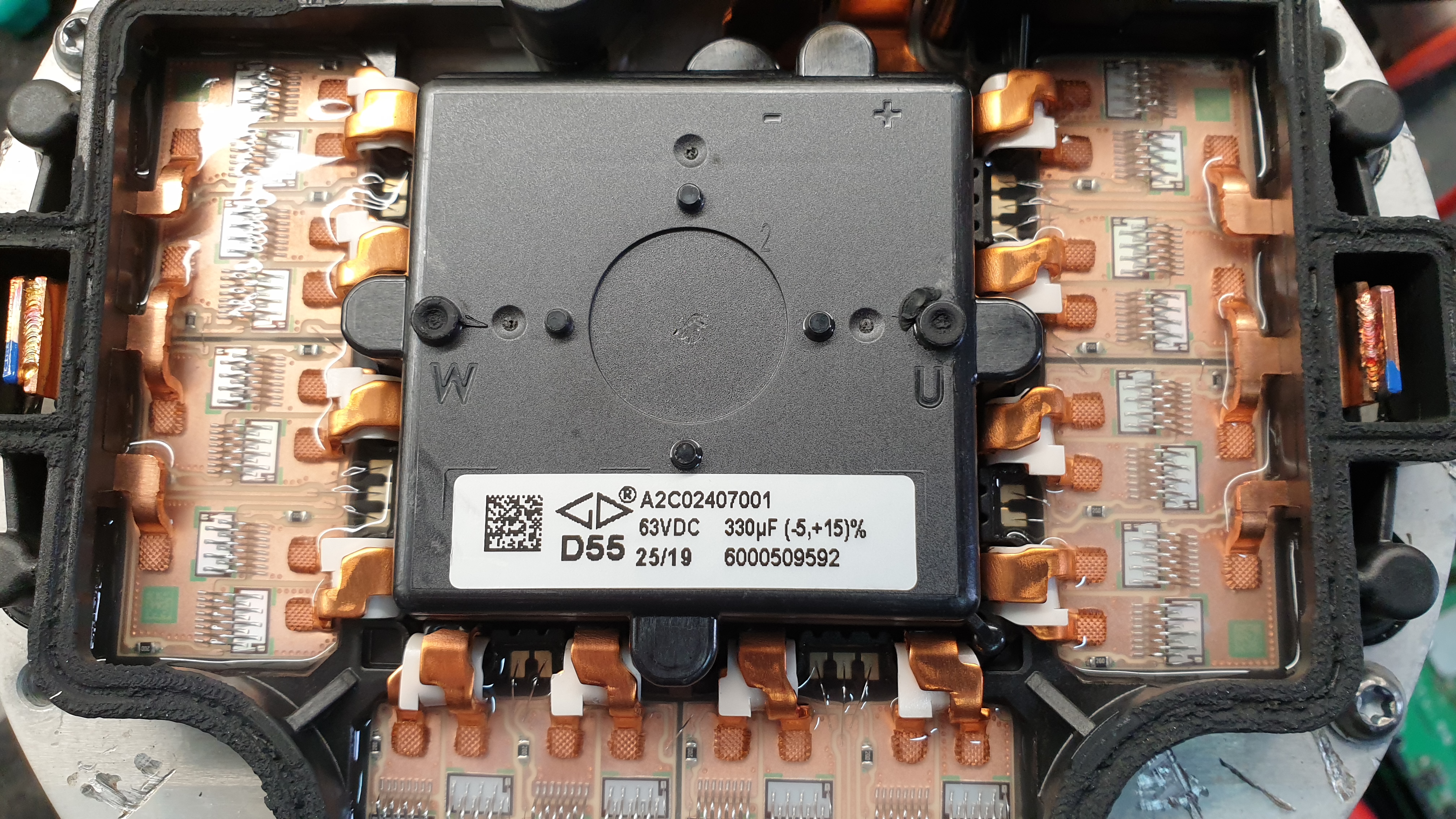

I was expecting mosfets! They look like tiny IGBTs?

annnddd this is as far as we can get without permanent damage. They fit the inverter on back then laser weld the stator wires to the inverter.

Some progress. Seems 0x3c0 byte2 bit 1 is KL15 via can :
BO_ 960 Klemmen_Status_01: 4 Gateway_MQB
 SG_ Klemmen_Status_01_CRC : 0|8@1+ (1,0) [0|255] "" Airbag_MQB,BMS_MQB,Motor_Diesel_MQB,Motor_Hybrid_MQB,Motor_Otto_MQB
 SG_ Klemmen_Status_01_BZ : 8|4@1+ (1,0) [0|15] "" Airbag_MQB,BMS_MQB,Motor_Diesel_MQB,Motor_Hybrid_MQB,Motor_Otto_MQB
 SG_ ZAS_Kl_S : 16|1@1+ (1,0) [0|1] "" Vector__XXX
 SG_ ZAS_Kl_15 : 17|1@1+ (1,0) [0|1] "" Airbag_MQB,BMS_MQB,Motor_Diesel_MQB,Motor_Hybrid_MQB,Motor_Otto_MQB
 SG_ ZAS_Kl_X : 18|1@1+ (1,0) [0|1] "" Vector__XXX
 SG_ ZAS_Kl_50 : 19|1@1+ (1,0) [0|1] "" Vector__XXX
So we just told it the ignition is on and it wakes and starts sending us messages. Now problem is I'm not firing off the counter and checksum so it don't like me.

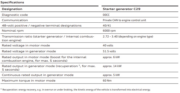

yep audi also have a 12v version which i have of the starter generator from the SQ7 but that operates on the lin bus below are some of the spec about the 48v version.
now if only someone had the lin bus decode or has a hybrid golf in london i could plug my scanner into.

Thats a great bit of info thanks. I'm wondering about just grabbing an ecu and powering it on the bench. Of course it wont spin up the unit but would pump out the can ids with the counter and checksum that could then be played with. Might work for your lin application also...
