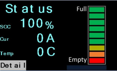

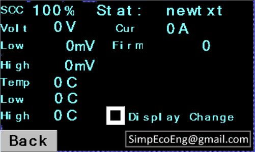

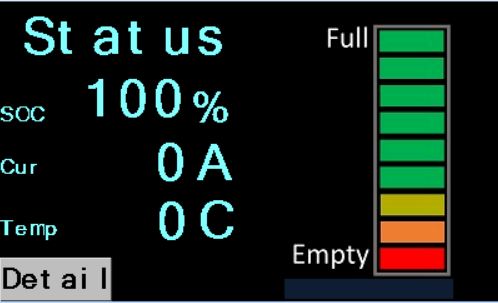

Its just using the teensy onboard serial.https://www.pjrc.com/teensy/td_uart.html
The nextion display is there to show pack stats, it does not show all cell voltages as that is too much.
The interface is only one way, as in the bms populates the info on the display and the display does not send anything back.
Attached the page layouts below.

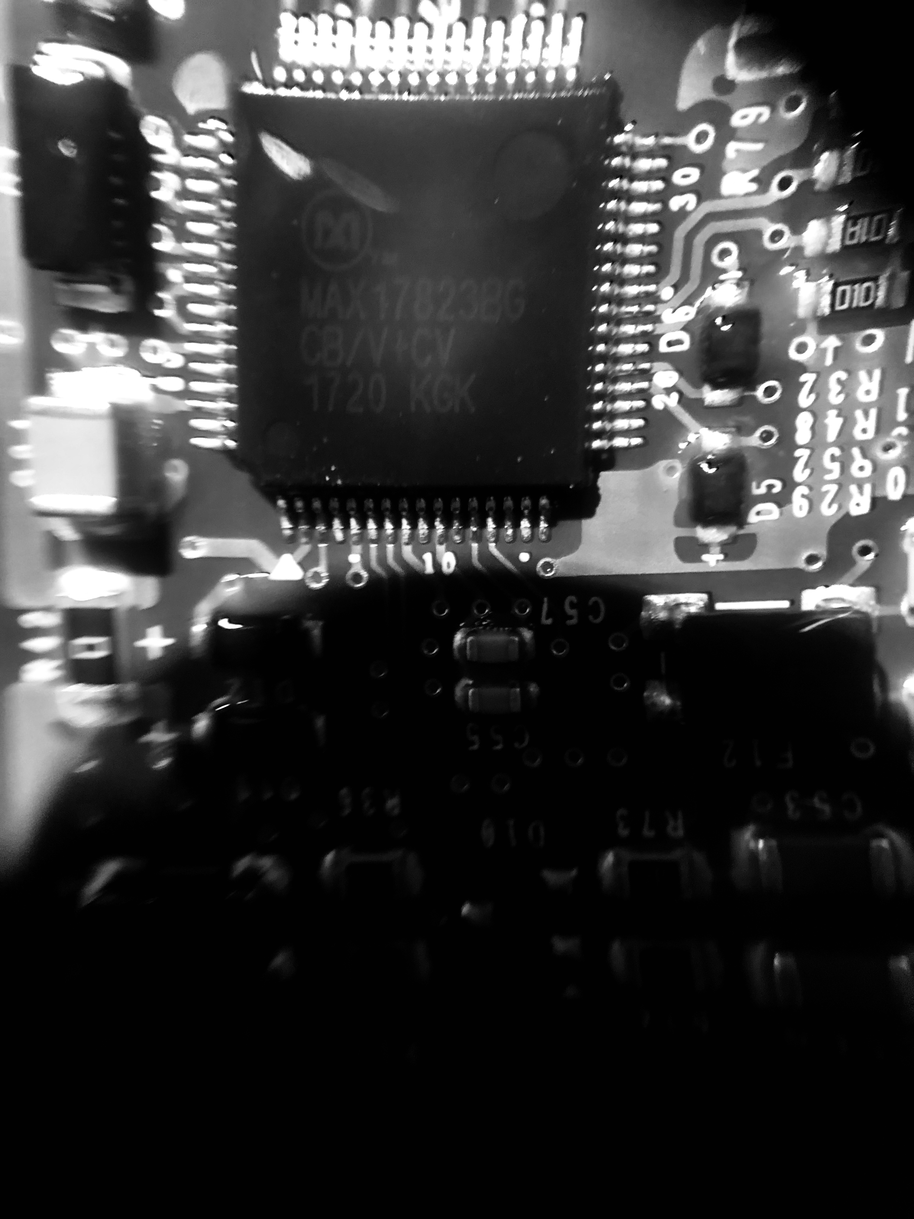

There are ten CMU's and one management unit inside the pack. I will do my best to find a car and get some canbus data out of it. Thanks for now. Here is some photos of the hardware.

Re: Simp BMS
looks like it is this chip : https://www.maximintegrated.com/en/prod ... ml/tb_tab0
So the daisy chaining would happen via UART style comms.
