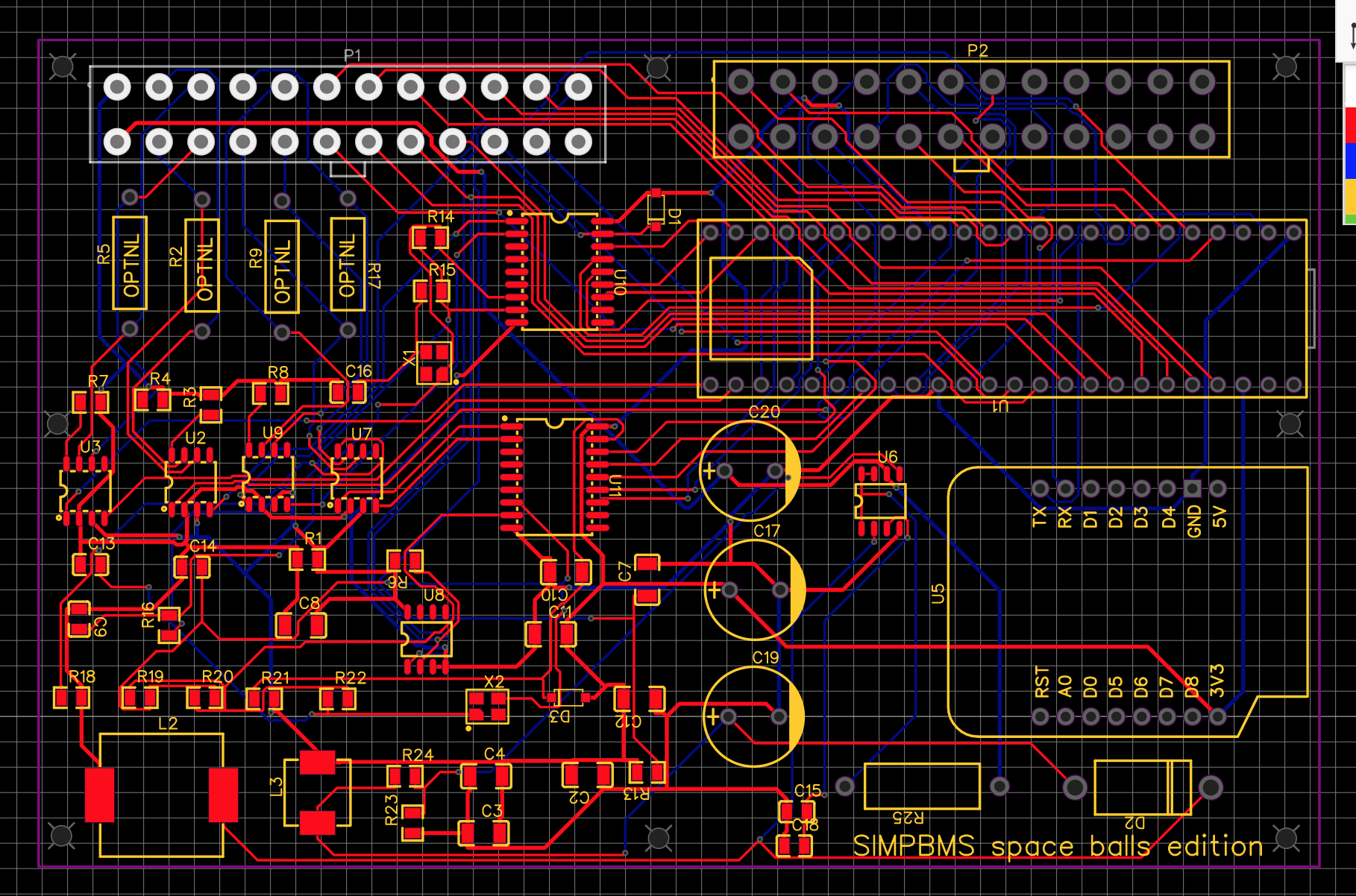

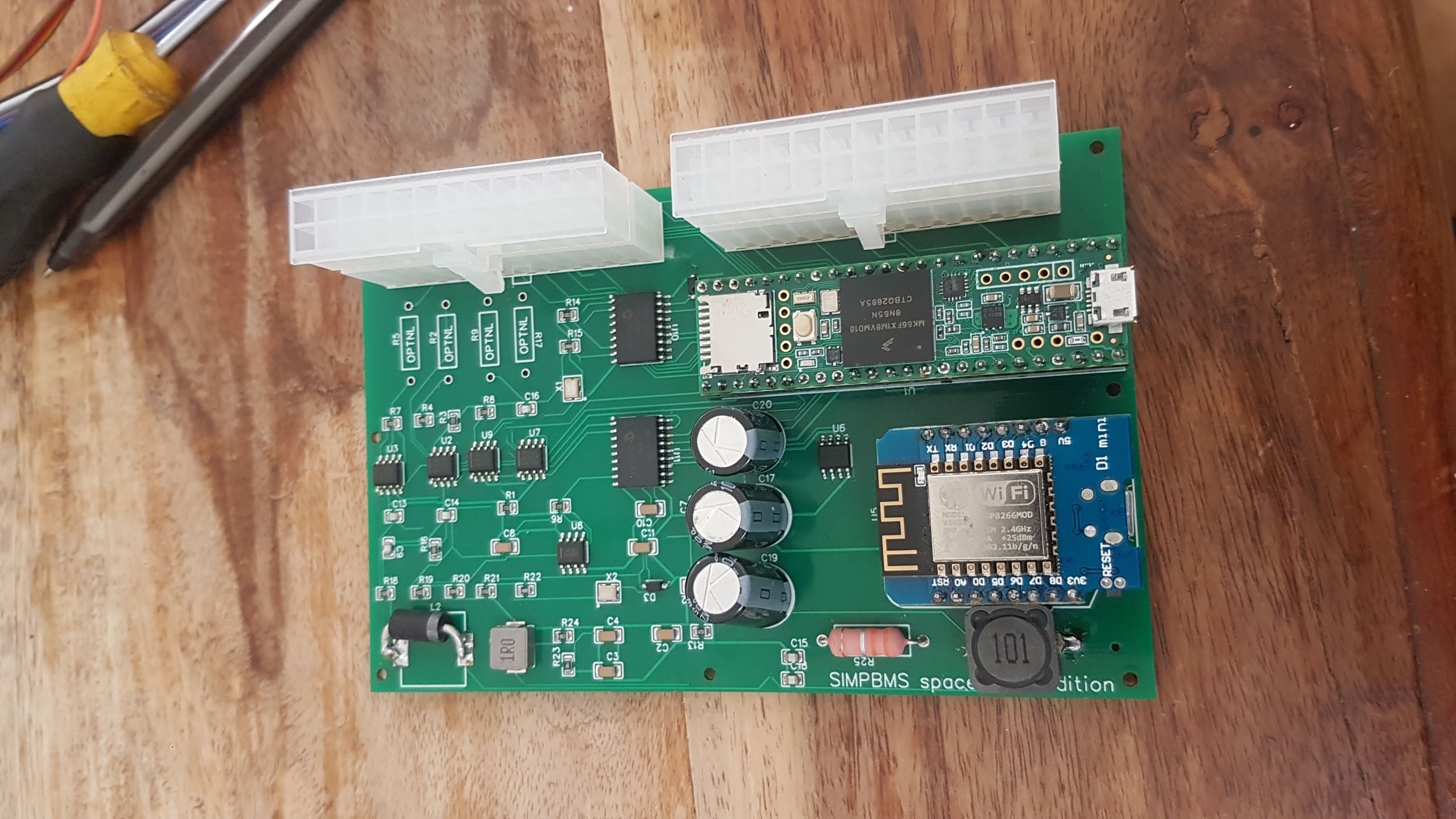

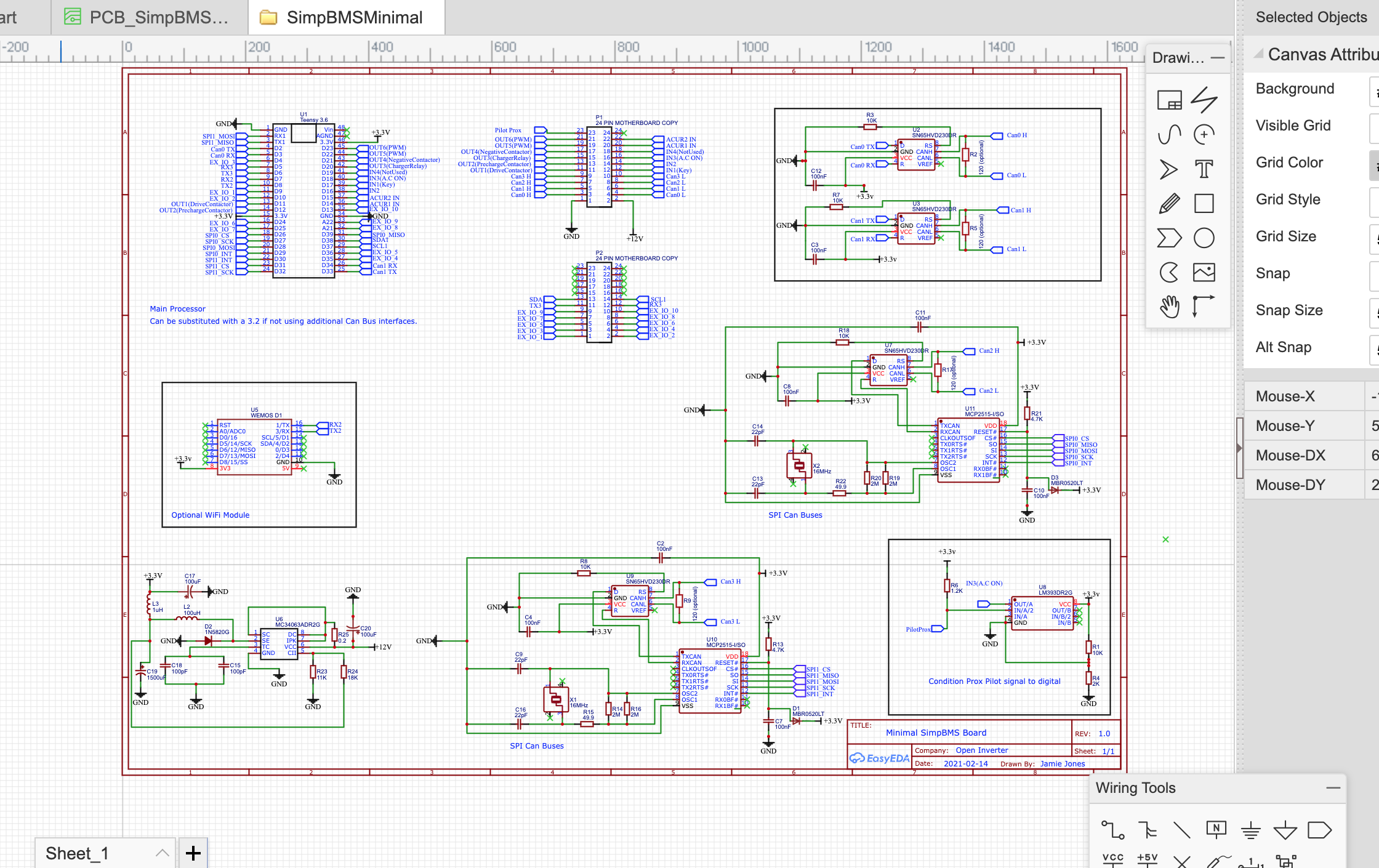

Will do a screen recording of the process of ordering an assembled board from JLC and upload if that'll be useful. Starting from downloading the files from Damiens/Johannes GitHub and uploading etc.
Also JLC have a great circuit/board designer that makes ordering from them super simple. https://easyeda.com/editor, you can either order assembled with a few clicks or order the boards from JLC and the components from LCSC. Also checkout https://oshwlab.com/ as a side note.
rstevens81 and myself have used it to design a 4 can board for a teensy 3.6 for simpbms (will open source once we've corrected the error, as seen in the assembled board and done some more testing)
