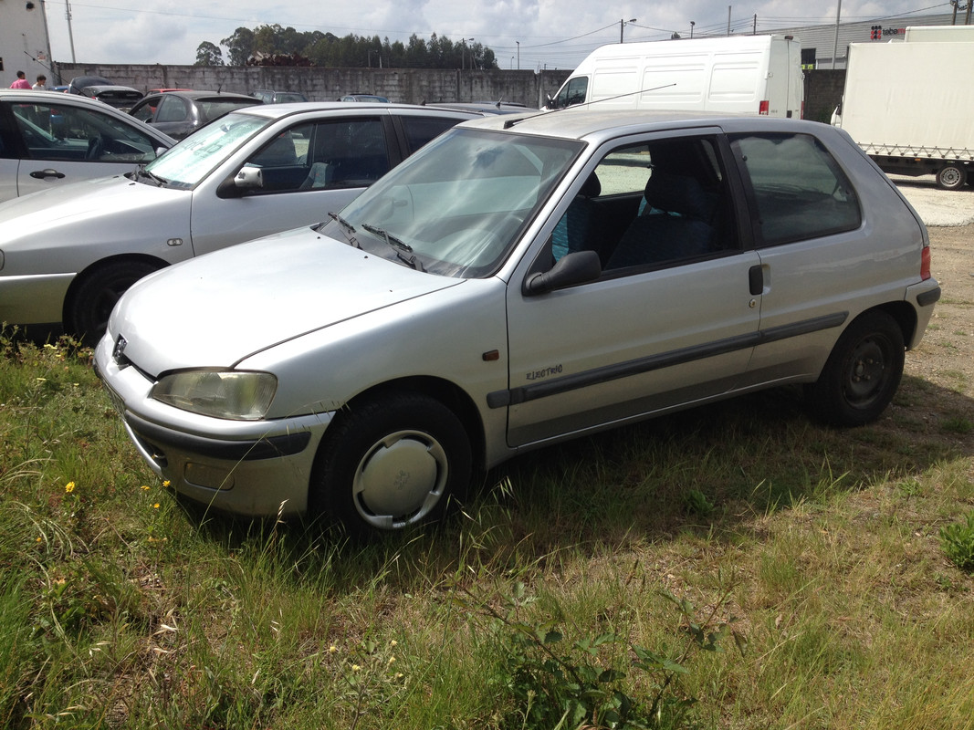

Getting tired of the 27hp motor and the old nicd battery pack (12kw new) that has a few dead cells so i can't drive anymore.
Looking to get more pawa! and range with a leaf swap or something fun by getting parts or better a salvage car.
We will see...

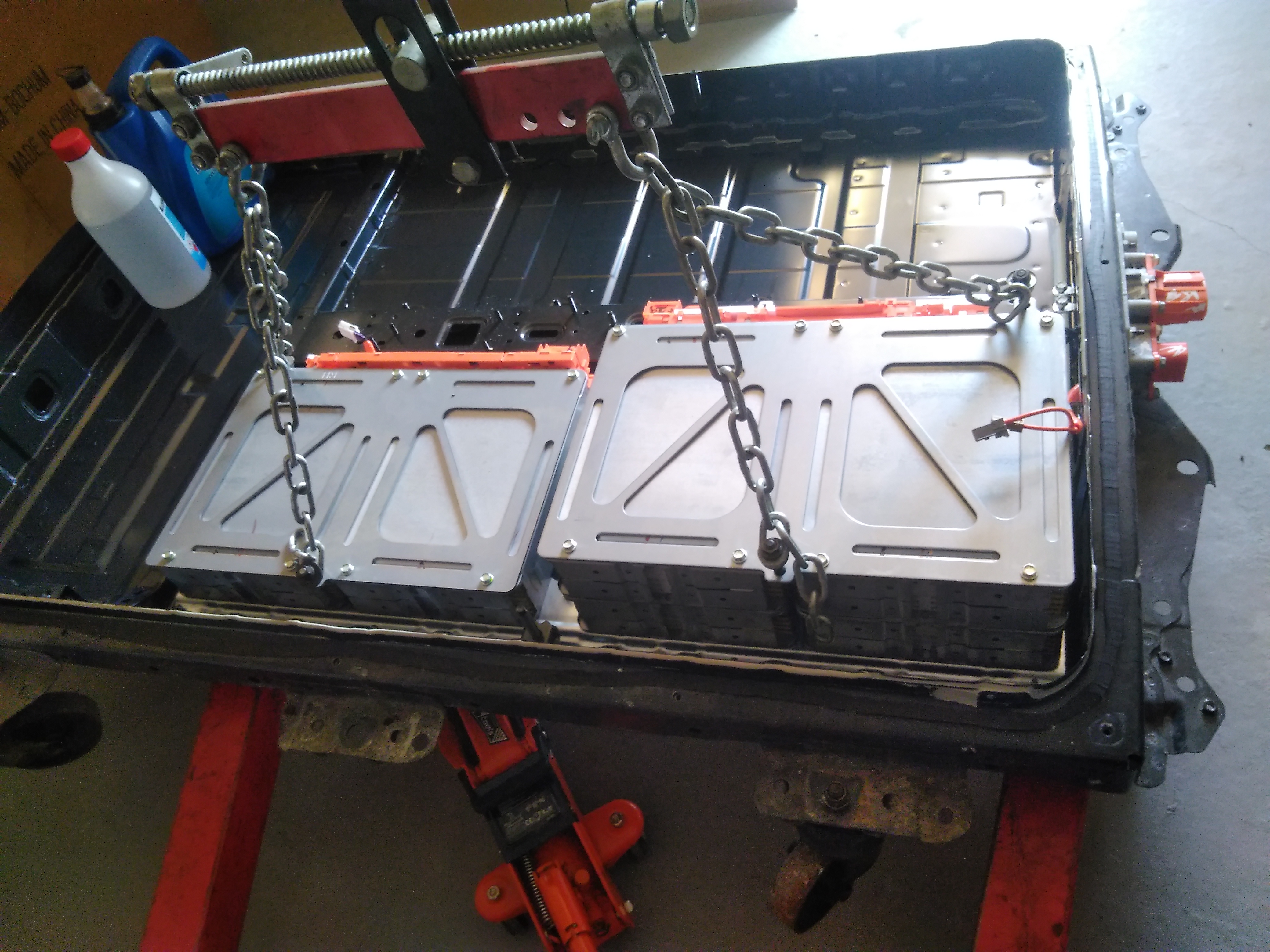

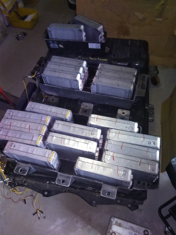

1 year later i find a leaf battery, i am interested in swapping the motor also.
I am thinking of gettin the complete swap and wiring, remove all the wires i don't need, or use the options
available here.
So how much hp can you get with a can vcu on leaf motor and stock inverter?
I know the replacement board allows for around 200hp that is not bad.
Do i need modifications to use the stock leaf dc charger?
available here.

The VCU allows for the stock 80 kW. The drop in board allows like 140 kW. I remember some youtube video where someone ran the charger and DC/DC converter.

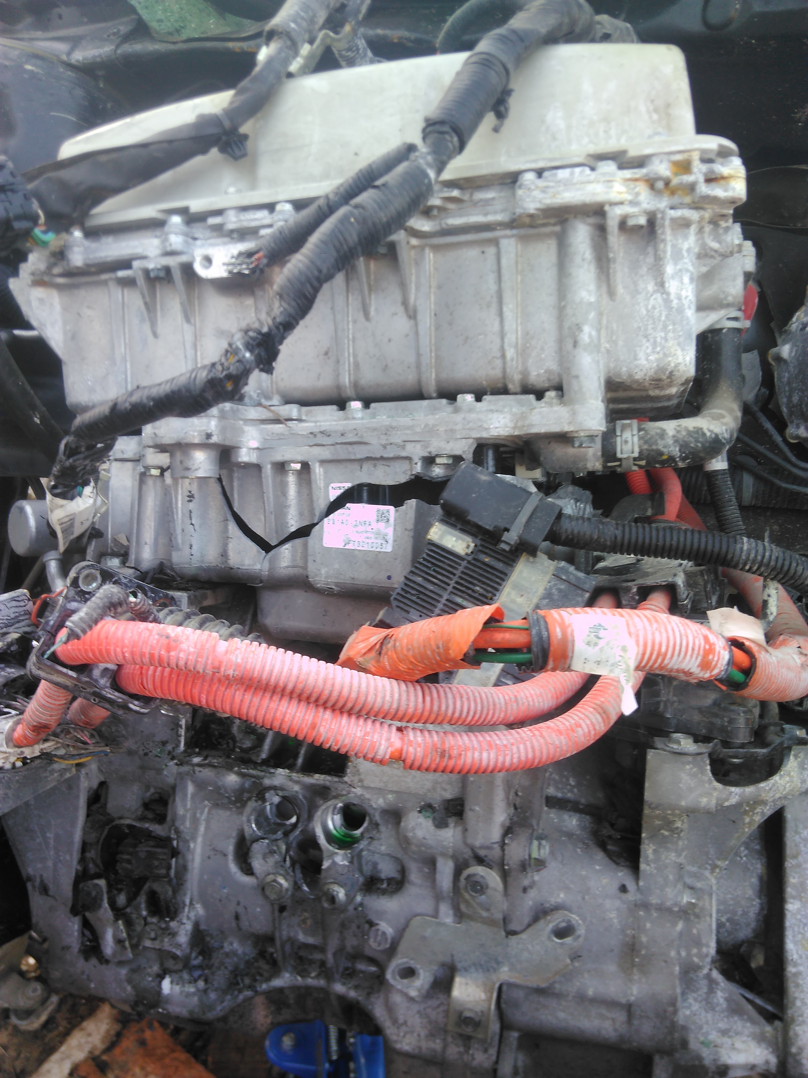

yes to be able to use the complete motor/inverter/charger unit would be the goal i can't find a video where all works.
The ResolveController does control all of that but is a bit expensive for my budget.
And to get 300hp like the guy with the crx would stronger igbt's be all you need to change

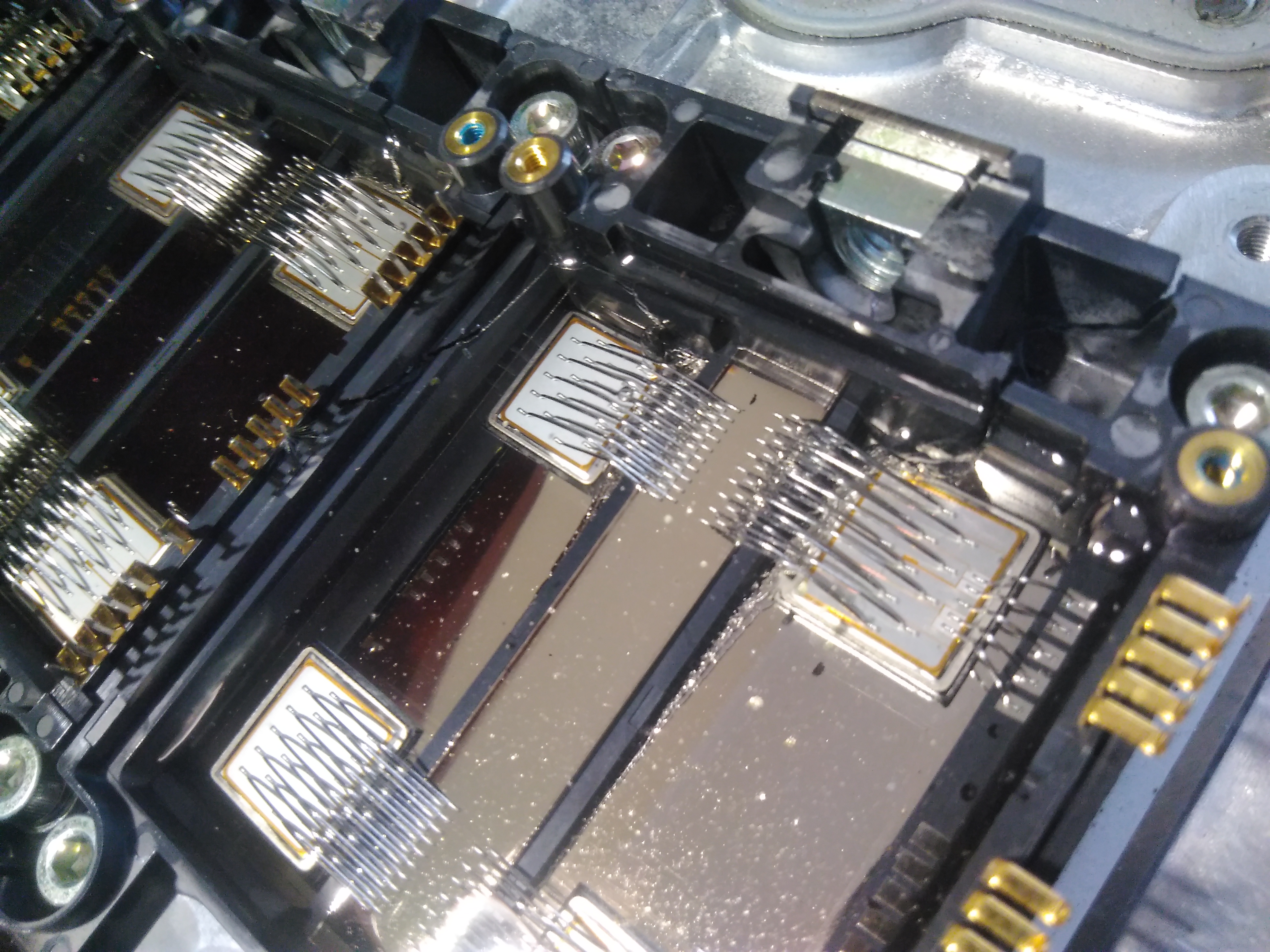

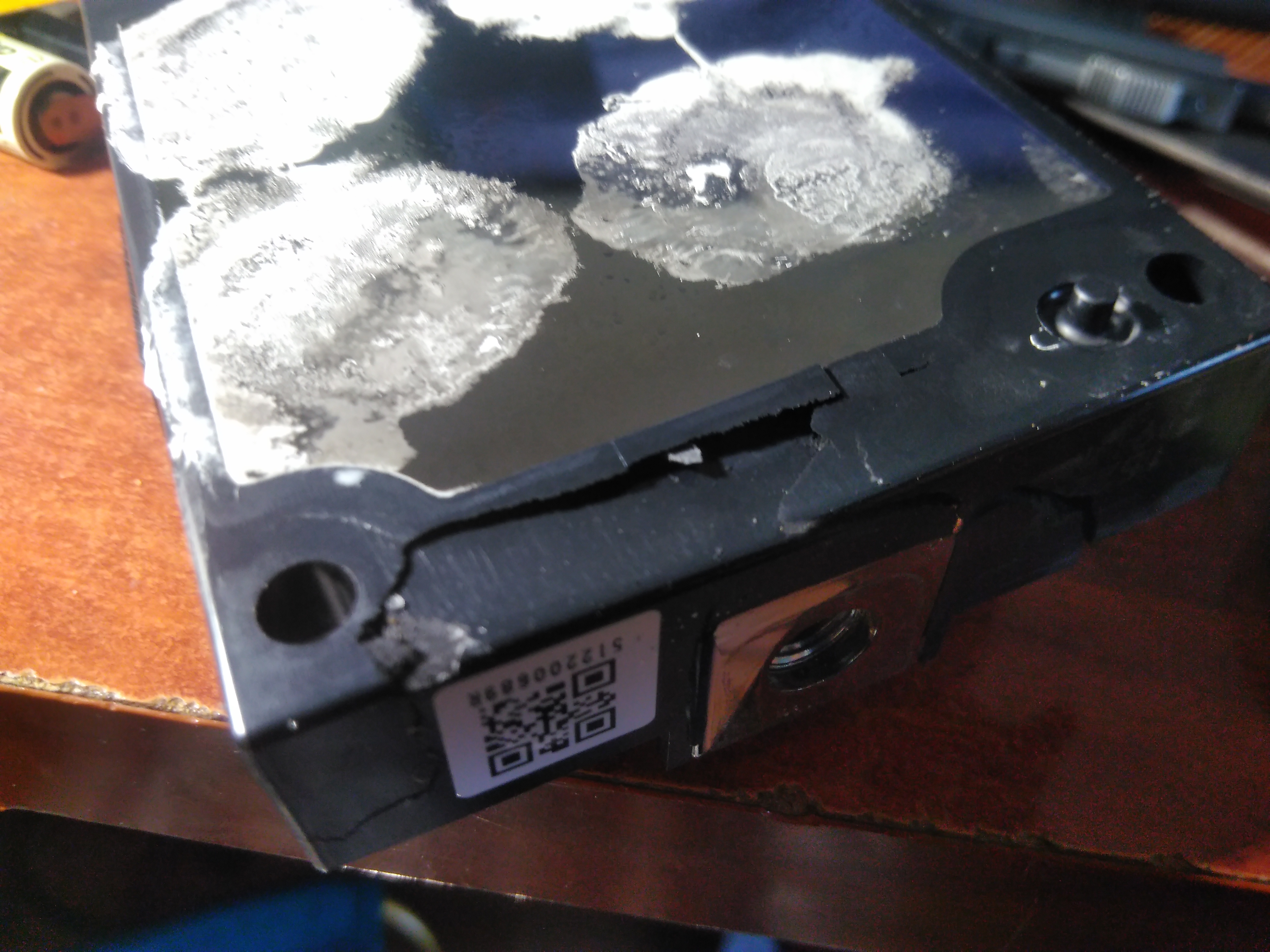

Thought i found a cheap motor unfortunatly everything is broken.
I have a welder i will try to repair a few things but even the igbt's broke on impact
not safe to use right
