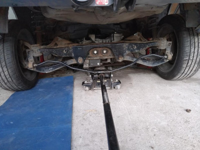

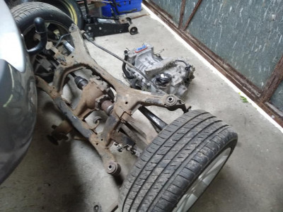

Update:
-Rear subframe was removed from car (leaf motor placed beside car for reference) -Motor top of motor required some surgery(originally I planned for a gen 1 motor, Gen 1.5 is taller) -Subframe required some cutting to fit motor( modifications to follow) -Motor is now spinning on 60v using leaf contractor box( Currently using P&S board as that came with motor)

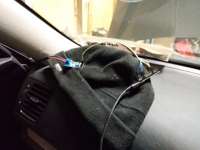

-Have the factory electric power steering working by injecting a can message (with kind help from Rikohm)
For the minute I'm using a Arduino nano with a mcp2515 simply sending the required can message once when key is turned to seat position. -Successfully got the valence batteries to communicate with the valence software( look at the cycle count) -Mocking up of front most battery box continues( one of three battery boxes) -Rear subframe has been modified -Test fitting to confirm all bracket locations are correct and have enough clearance

Re: Subaru Legacy , Rwd build using leaf motor.
Cool, gen 2 motor and gear box will fit in the rear without modding the body. what are you planing on doing for axels? Nissan and Subaru... might be worth it to see if the races or doh cups or shafts will hybrid together.
Or see if the leaf wheel bearing bolts into the Subaru knuckle.
Subaru and Nissan have shared rear diffs forever... People often swap in Subaru r180 diffs into Z cars. Bolt in affair!
