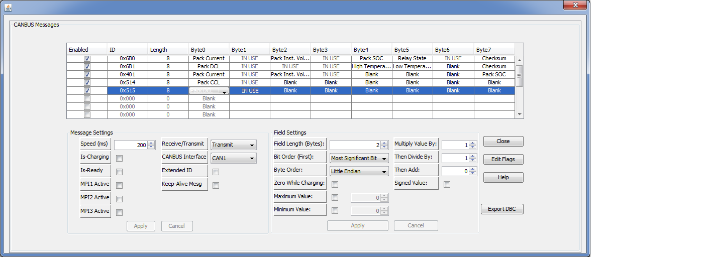

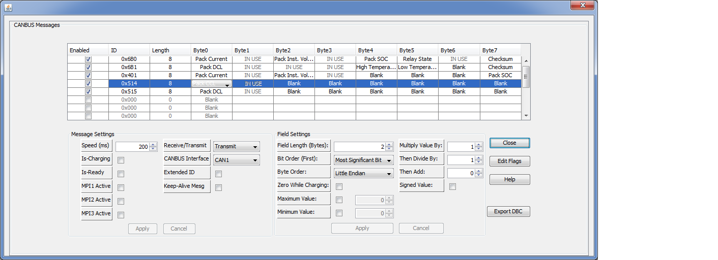

I got arround to doing it (finally), i seems that the command to send was missing a parameter before a concerning ID.
So the commands i used are :
1301 being the id in decimal (0x515),0 being the bit position, 16 being bit length (2 byte) and 32 the ofset.
1300 being the id in decimal (0x514),0 being the bit position, 16 being bit length (2 byte) and -32 the ofset as we want idcmin to be negative.
Since i'm using orion 2 bms the data sent is some what diffrent, as you can see in the pictures attached.
Biggest difference is the byte order on the bms side.
After a little testing when going over the max limit is like when the inverter goes overtemp. I can't really do more testing as my car is not road worthy yet (no doors, roof or body panels) and we are in lockdown again..
Cheers
Paul
can rx idcmax 1301 0 16 32
can rx idcmin 1300 0 16 -32
