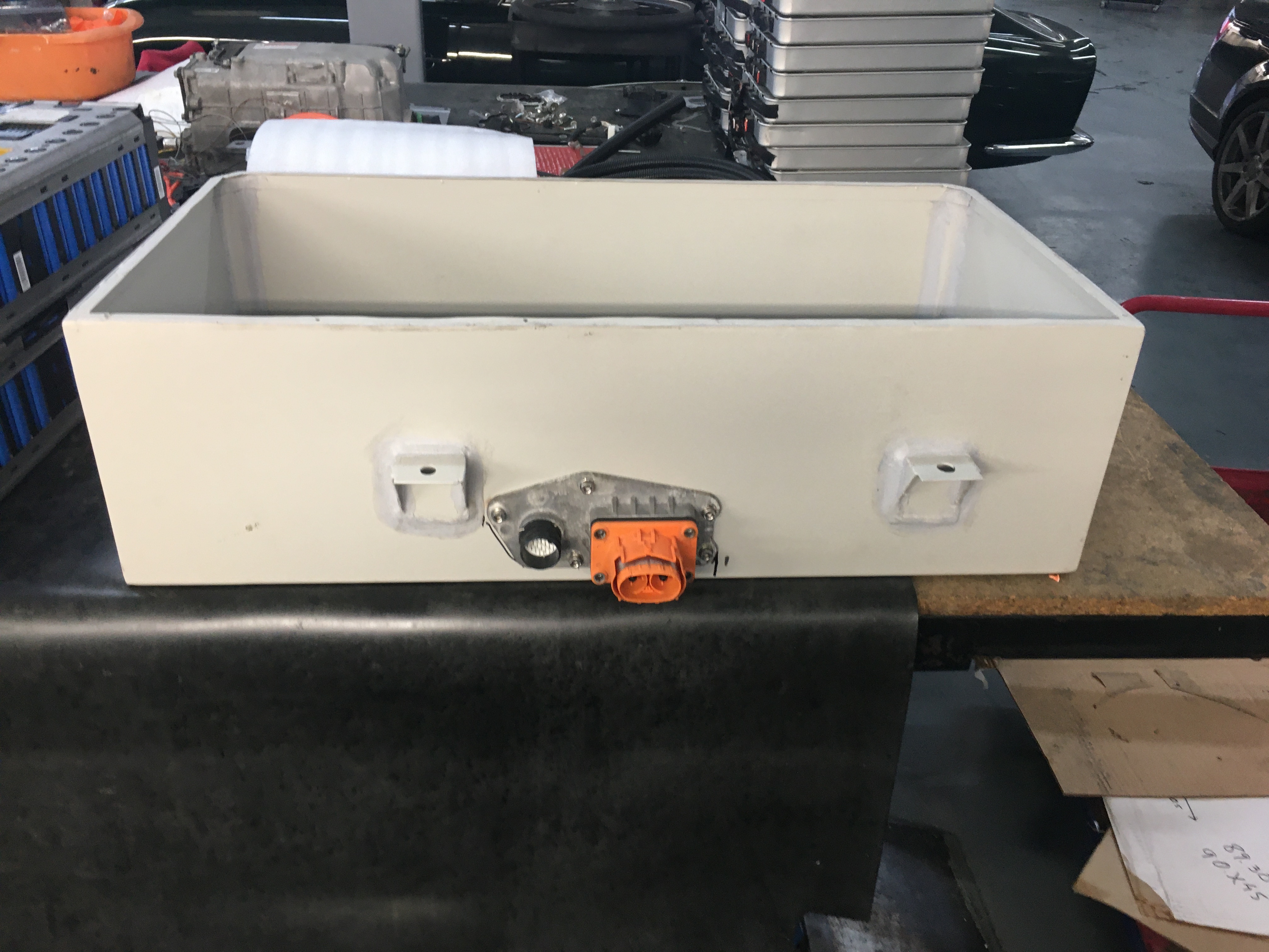

Just wanted to share some pictures of the almost finished rear battery box which will house 20 of the gen 1 Leaf cell modules.
I wanted to use as many of the original leaf connectors as possible, but as you can see the battery box connector plugs straight into the HVJB so it didn’t leave much room for insulation. I quickly designed a terminal housing to go round it.
