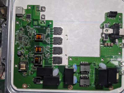

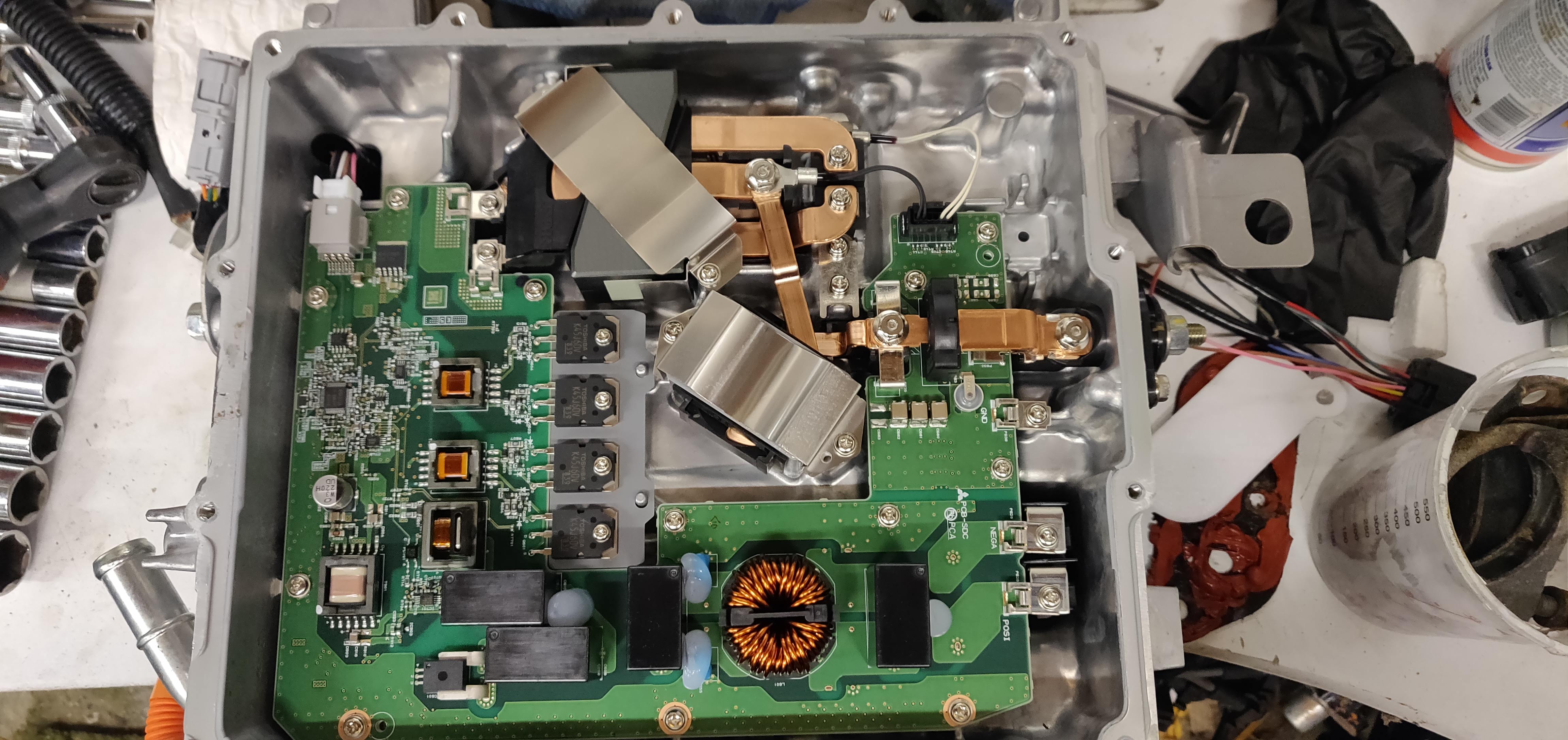

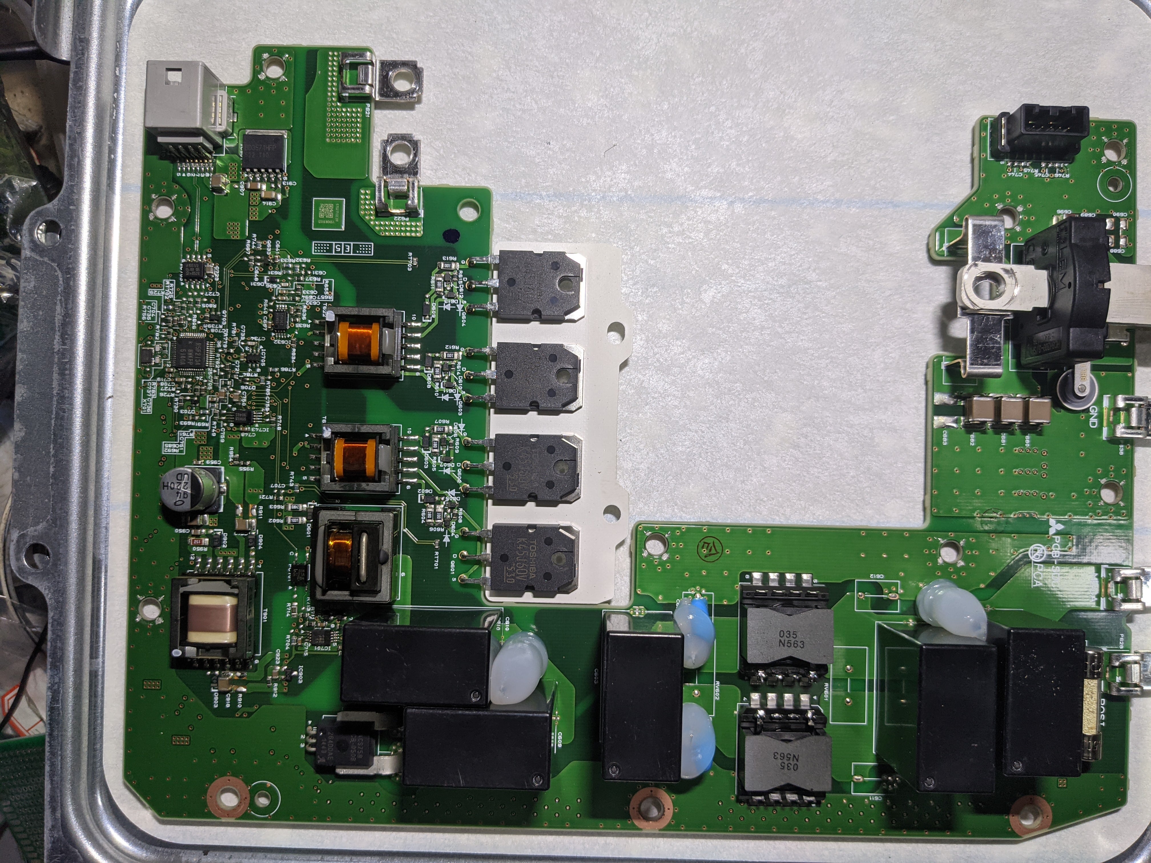

First post here, wanted to say thanks for all the useful info shared.
I'm currently converting a classic mini using outlander rear motor, inverter and charger.
Last night I installed the charger which just fits under a mini front seat.
I had to modify the 12V output stud so I could get the charger closer to the cross member.
Here is a photo of the under side of the charger, the 12v stud is simply bolted in like the HV out.

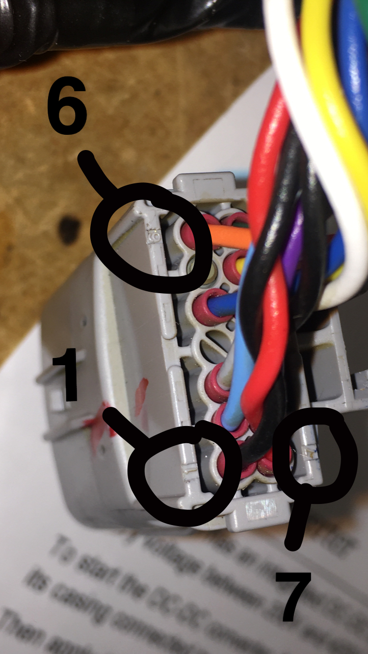

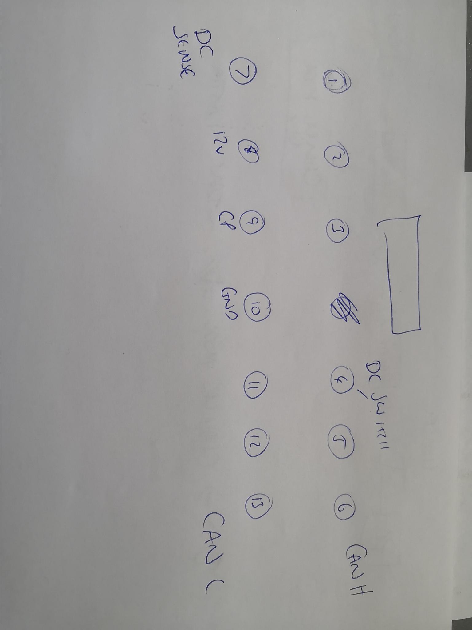

Hi, Just got the dcdc working on my OBC. As I'm reading through this thread I'm seeing different suggestions about what should be connected on pin 9(charger) from EVSE. Is it Proximity pilot or Control pilot? Thx
Clanarn
Posts: 54
Joined: Sun Oct 18, 2020 6:42 pm
Location: Göteborg Sweden
Re: Mitsubishi outlander charger and DC:DC
Post by Clanarn »
Ive also noticed that the pinout as described on the wiki page is wrong if you follow what is written on the Sumitomo connector.
This pinout should be correct for the Sumitomo connector:
Pin 1 CAN H (Black)
Pin 2 CHIN (Serial protocol to EV Remote wifi module)
Pin 3 DC SW (enables the DC:DC converter)
Pin 4 (Blue) NC on outlander
Pin 5 NC on outlander
Pin 6 (Orange) NC on outlander
Pin 7 CAN L (Red)
Pin 8 CHOT (Serial protocol to EV Remote wifi module)
Pin 9 NC
Pin 10 GND
Pin 11 Proximity signal from charger
Pin 12 IGCT main power to charger
Pin 13 Sense line for DC to DC converter
Pin 12(IGCT main power to charger) needs 12v power also. I connect it together with Pin 13(Sense line for DC to DC converter)
Posts: 1595
Has thanked: 75 times
Been thanked: 304 times
Pilot proximity doesn't go to the charger, you'll likely want to use it with how ever you are controlling it though.
I think pin numbers are messed up on the connectors though, can't remember if the housing has different numbering. But looking at the plug, from the back where the wires come out, clip up, top left, call that 1, to its right 2 etc, 7 is bottom left.

Ok i see. Thanks for explaining. "Proximity signal from charger" pin is actually Control pilot then.

Clanarn wrote: Wed Mar 17, 2021 9:37 pm Pinout
Hey, thanks for this, this is the pinout that worked for us.
Has someone had any luck of separating the DC/DC unit from the charger and using it separately?
We got DC/DC working this morning, but 3.3kW is not enough for us, so we have a Tesla Gen2 unit for charging. It would be great to extract the DC/DC board and coils into a separate box that could also be about 50% smaller than the existing unit.
It is a shame that the Mitsubishi OBC only has 3.3kW, I even thought about using two of these in parallel to bring it up to the 6.6kW we need...
We opened the unit, and traced the lines from the outside connector, to the one on the board but they go through the charger board & its microcontroller first.
