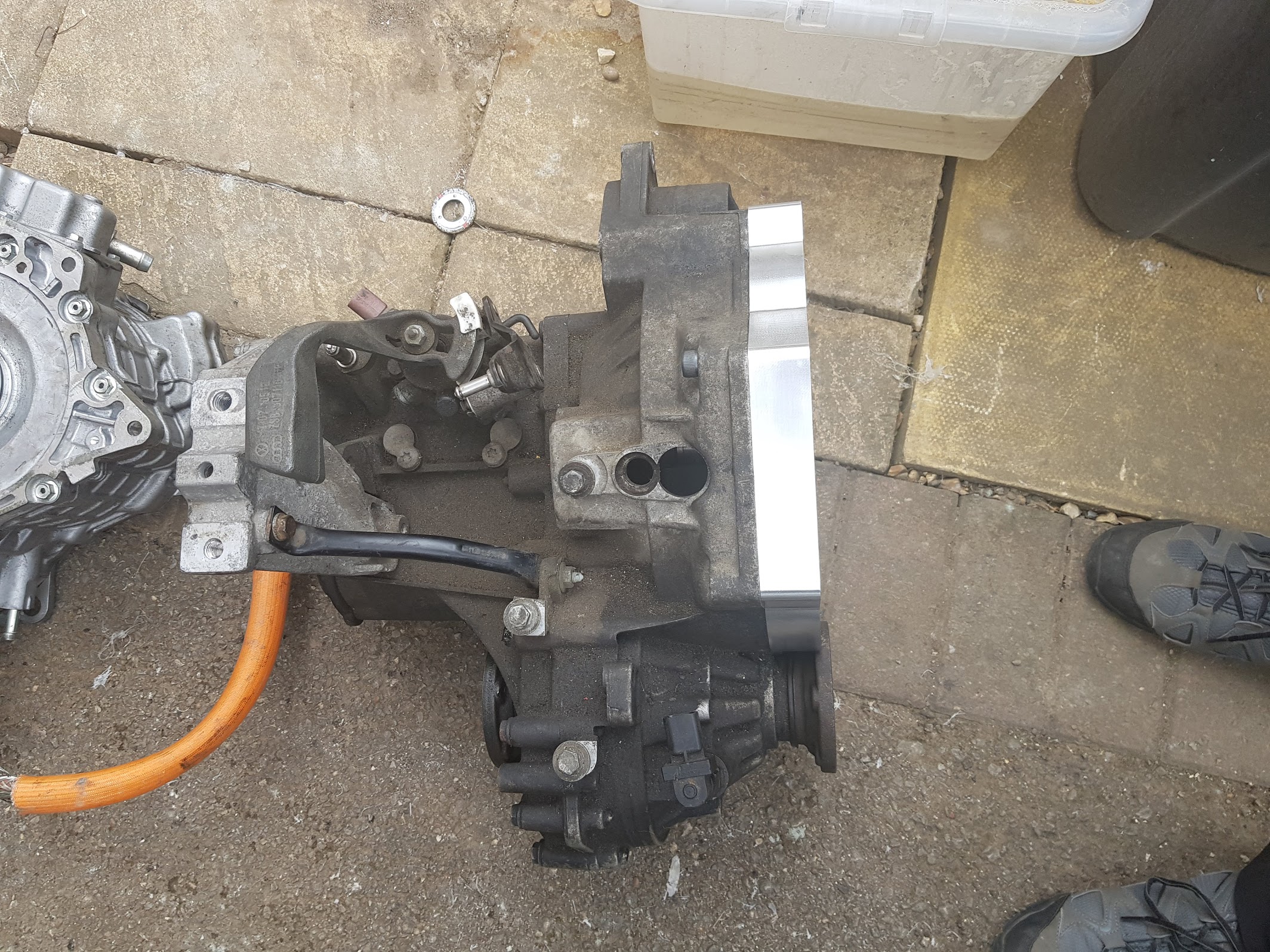

Re: VW - Beetle 2003
Coupler and adaptor plate seem good.
Pressing a long screwdriver on to where the gearbox input shaft enters the box and the other end on to the ear while spinning doesn't highlight any excessive vibration when spinning.
Couple more holes to drill and then I can test fit to car

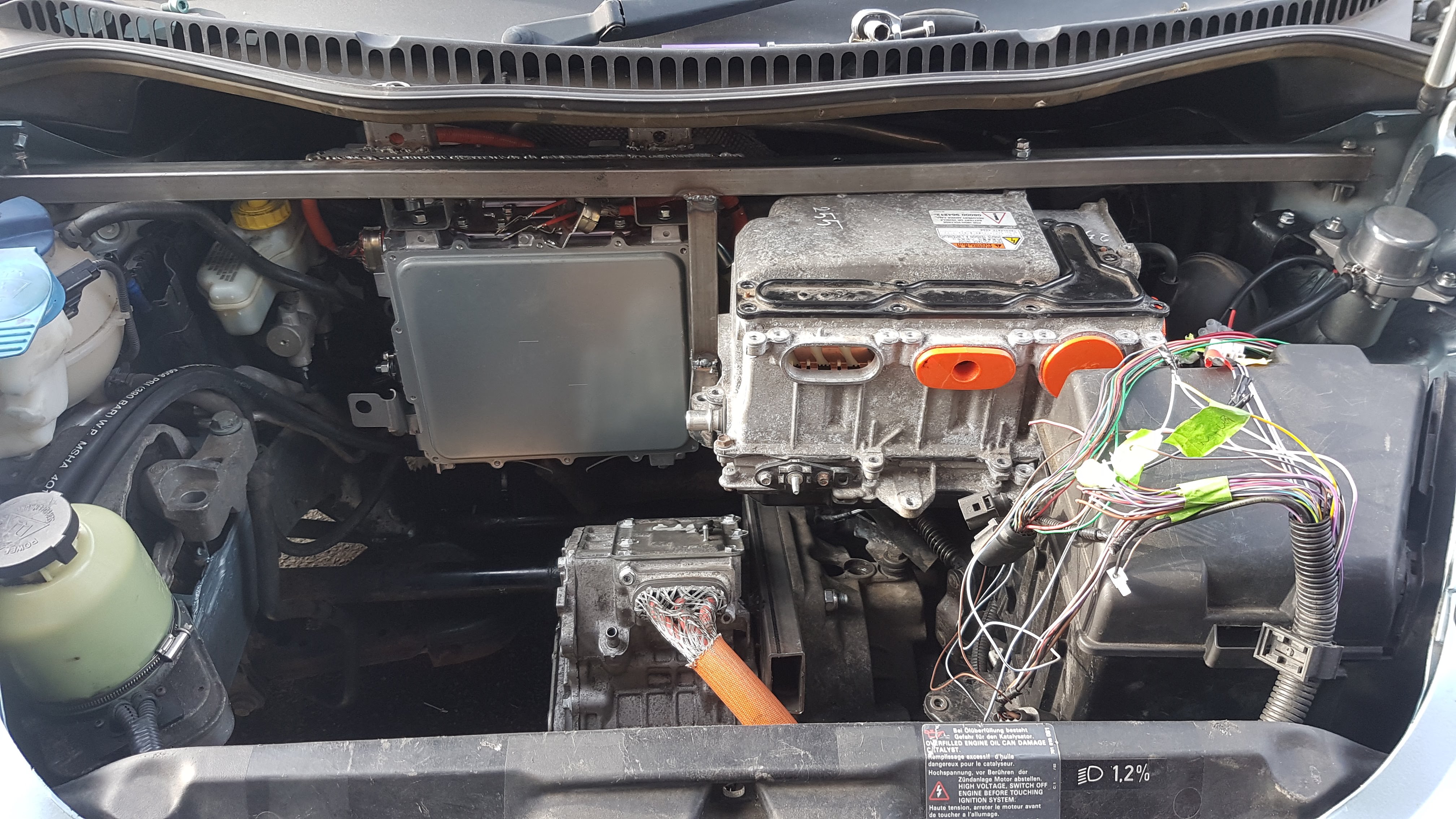

Just been working on the VCU side of things.
I seem to have problems with the timings of the canbus messages using stm32-car
video of behaviour
https://photos.google.com/share/AF1QipN ... 8xTW9RWnVn
The can period is set to 10ms but there seems to be enough delay to make the needle very erratic. Using an arduino uno and can bus module it's stable at 10ms.
video of behaviour
Look at stm32_can.cpp . I forgot to update that on github. In line 344 it should say "false" not "true" . So like this:
Any other device sending the same message? CAN bus well layd out and terminated?
I had a stable display even with 100ms interval.
So I've pull it from the car, put a 120ohm on the cluster end and on the stm32 end.
With the one can bus map, for id 640, 16, 16, 4, plus the hardcoded message in stm32-car.
Seems stable now at 10ms, it twitches occasionally, 100ms still rising to ~700 then dropping, so will stick with 10ms.
I'm thinking the old ECU must have had a termination in it and the other is somewhere else in the car as it doesn't appear to be in the cluster.
The diagram doesn't make it obvious where the 2 ends are.
Thanks for the help.

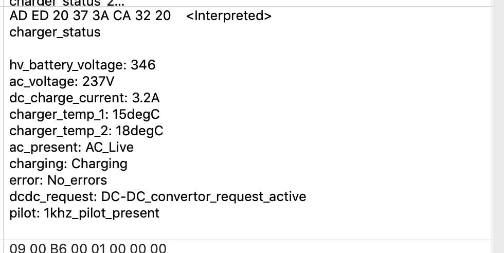

I've now got my pack charing with an outlander charger, current savvy can is sending the frames, but looking at integrating in to simpBMS
My adaptor plate has just been delivered.
