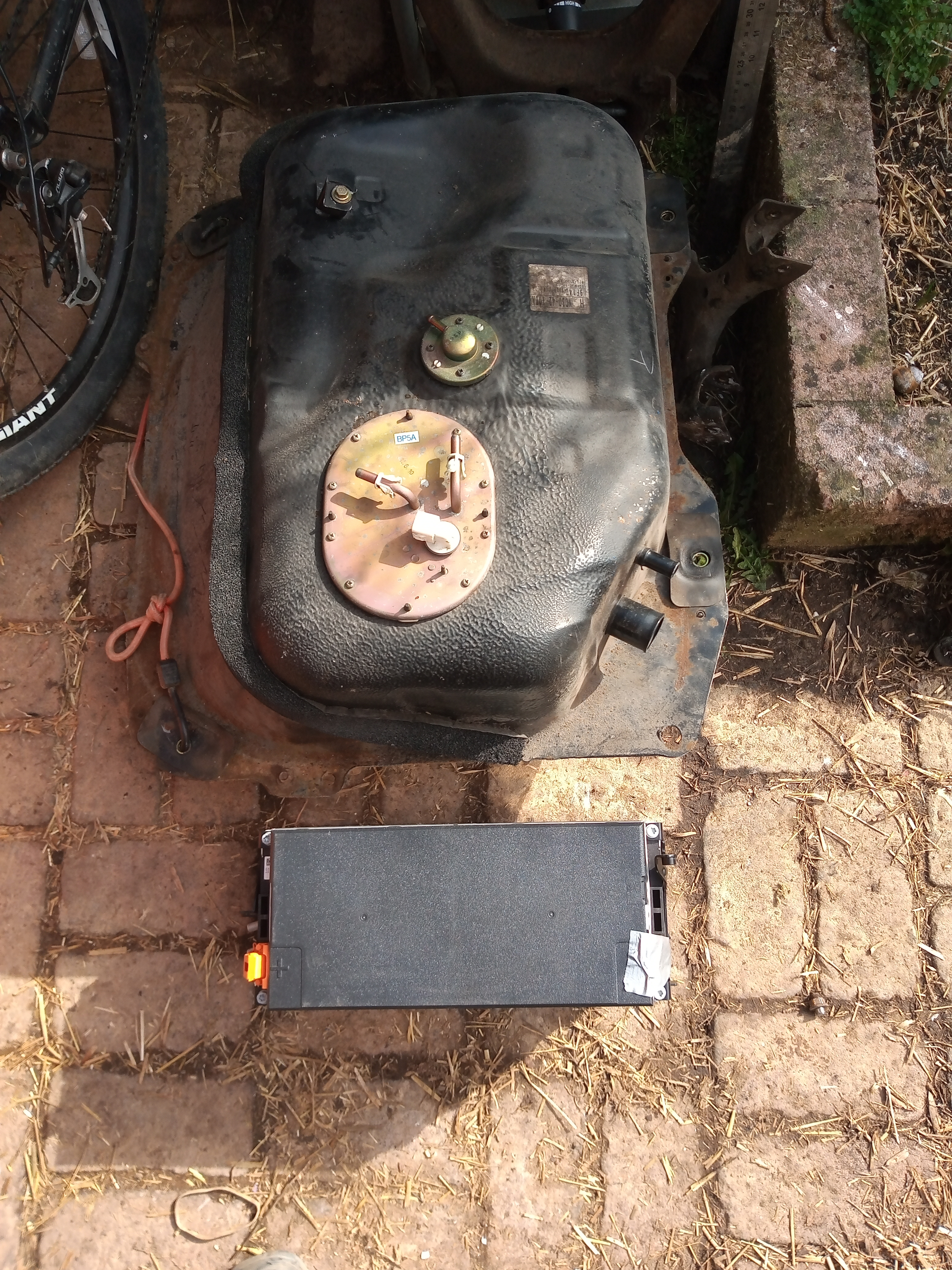

Parts acquired so far:
1. Car I really like ... this car should be lighter than stock when done!
2. Outlander rear motor + diff (haven't decided if to use gearbox or not yet, or if to modify the Outlander diff to connect to prop shaft)
3. Prius inverter & Yaris inverter (spare/parts)
4. EVBMW inverter board (finally managed to solder the horrid connector)
5. VW Passat GTE 9.9 kwhr battery (Samsung 28ah 96s) - photos soon of dissembling... I really like these modules
6. Low voltage (slow) charger to charge individual modules for bench testing.
7. Various Arduino, stm32, Teensy & electronics bits and bobs for the task at hand.
8. Lathe on order to allow the manufacturing/modifying of parts
9. 3d printer for all of those bits and bobs I will need.
10. TIG welder I know I will need one this is a mx5 afterall!

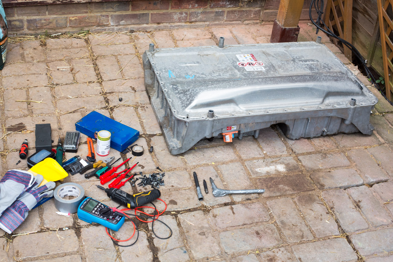

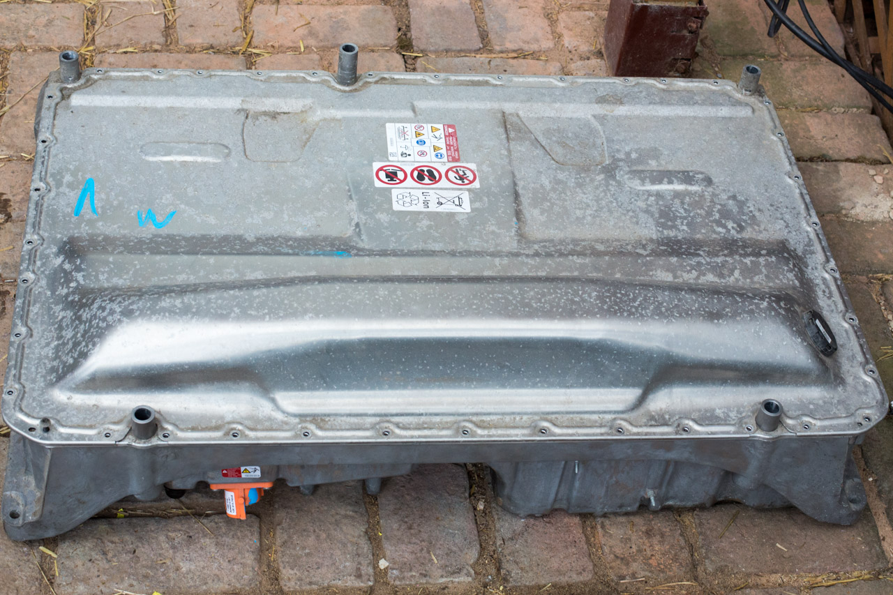

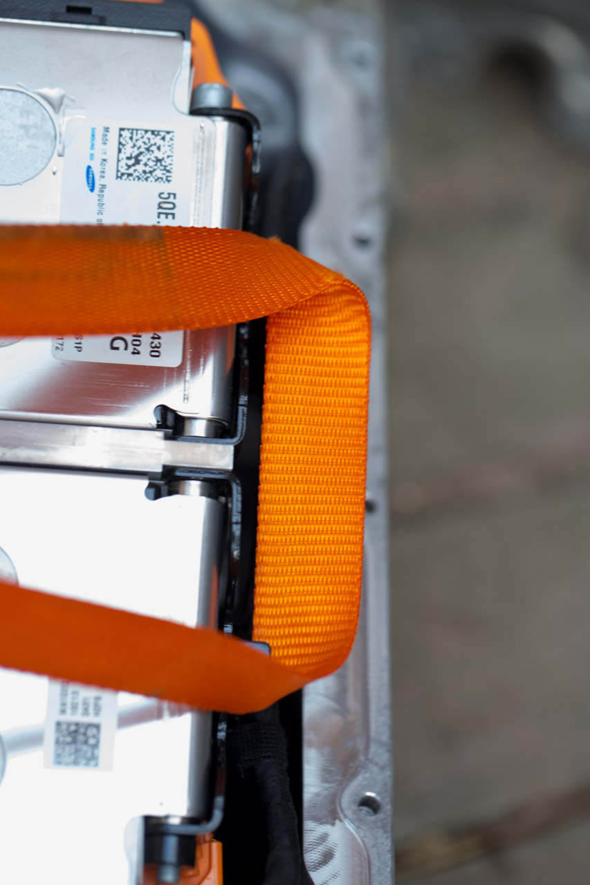

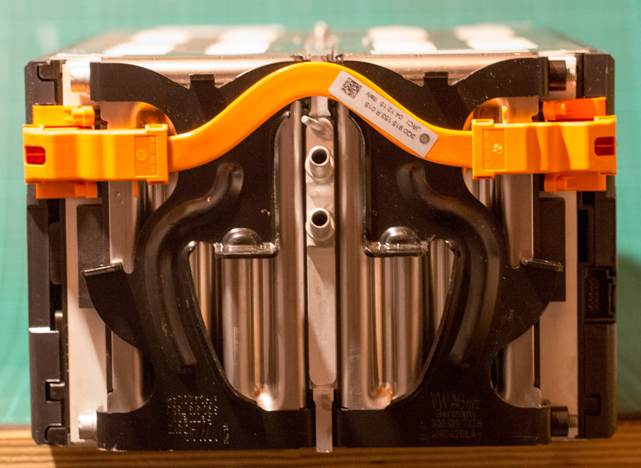

Since we don’t (yet) have a VW section …

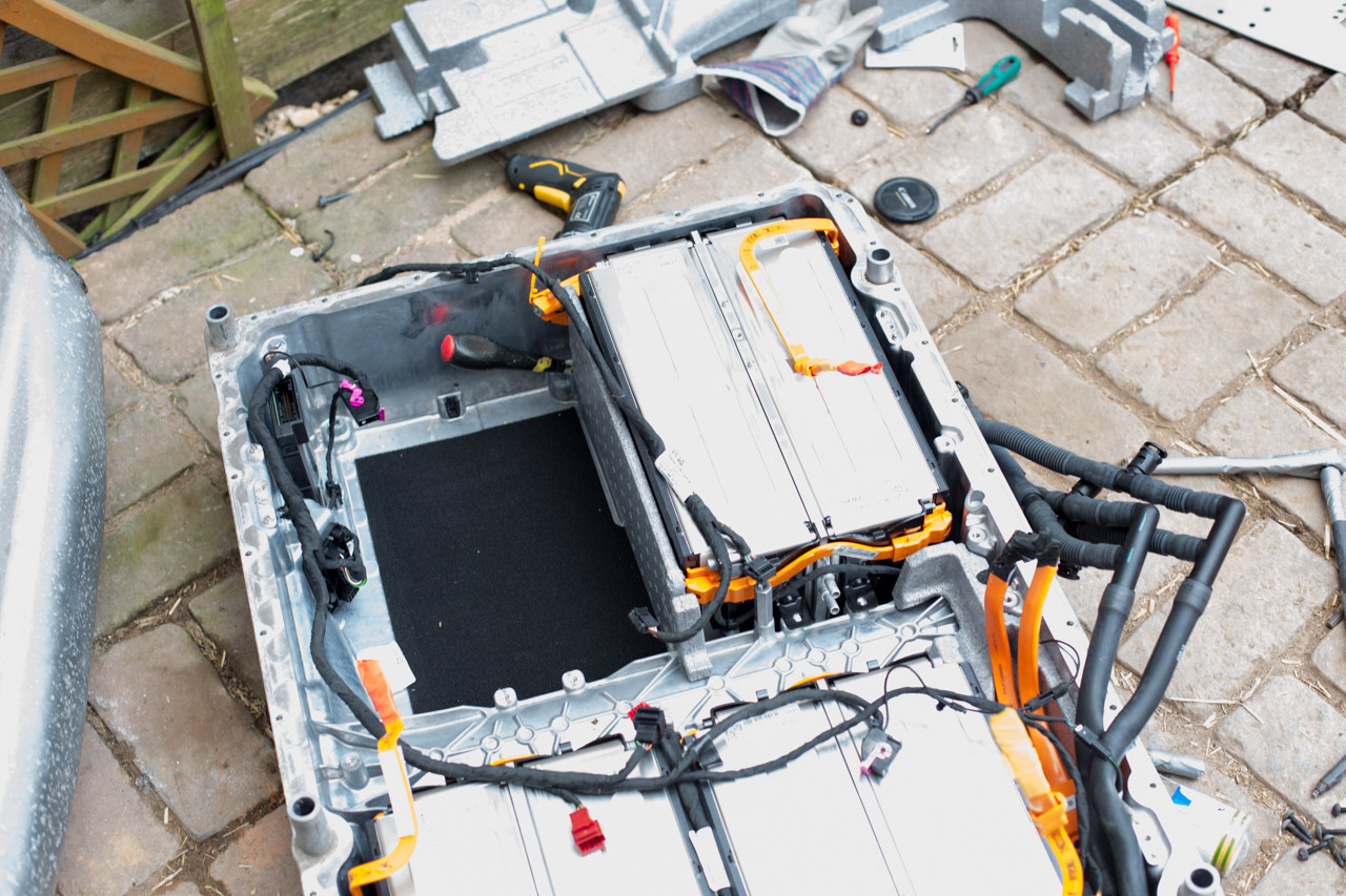

Welcome to my disassembly log of the VW Passat GTE 9.9 KWHR Battery (96S 28AH Samsung).
IMORTANT NOTE: I CAN NOT TAKE RESPONSIBILITY FOR ANYONE ELSE DISMANTLING A BATTERY IT IS HERE FOR EDUCATIONAL PURPOSES ONLY, YOU ARE ON YOUR OWN! Please appropriately educate yourself on safety!

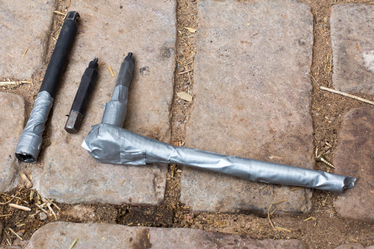

I Can Not understate the importance of Insulation when dealing With High Voltages, Both of your tools and yourself of course! Also ensuring that we do everything to prevent a Shor Circuit.
All Metal tools were covered in Tape And/Or Heat Shrink so that in the event of a drop there would not be a dangerous short circuit, and also as an added layer of insulation from the battery to myself!
I only ever toughed the HV contacts when I absolutely had to, no point taking chances!
Useful/Tools used:
1. Torx & Socket Drive Set (insulated with shrink wrap/tape)
2. Electric Screwdriver
3. Magnet on a stick (Covered in tape of course)
4. Insulation Tape & Duct Tape
5. Gloves … I used nitrile gloves, Electrician’s gloves & some garden gloves so I didn’t tear the electrical gloves.
6. Electrical screwdrivers & a normal screwdrivers covered in insulation tape.
7. Voltmeter
8. Insulated shoes
9. Nylon straps the battery came tied to the pallet.
10. Emergency help on hand in case of electrocution (including gloves for them & I attached one of the nylon straps to myself so I could be pulled away)
11. Work in the dry obviously

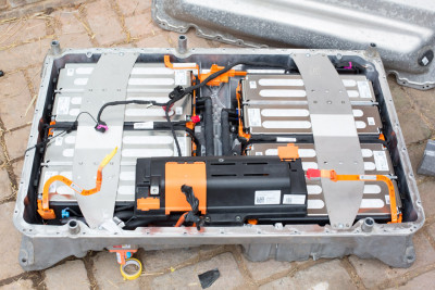

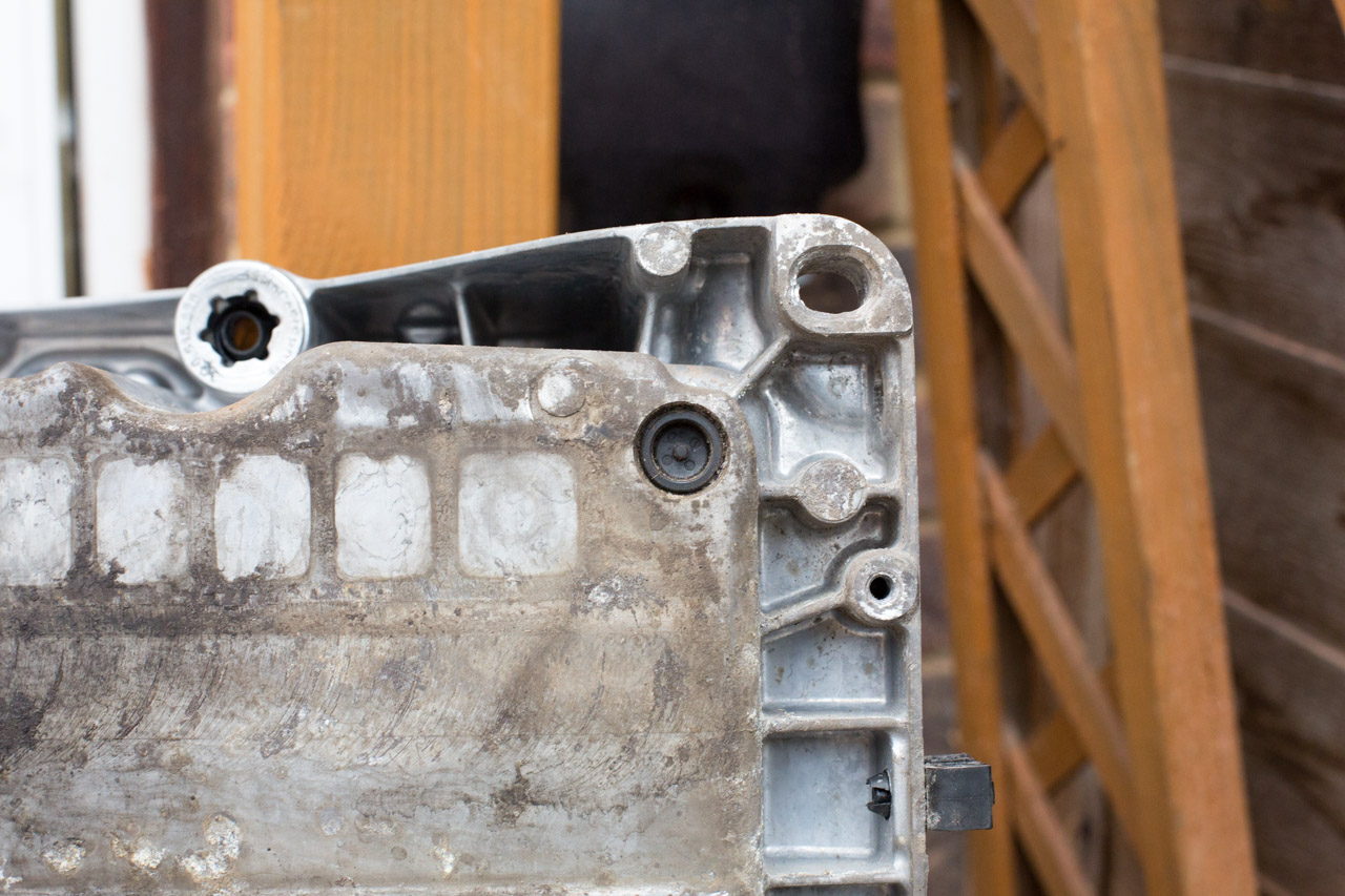

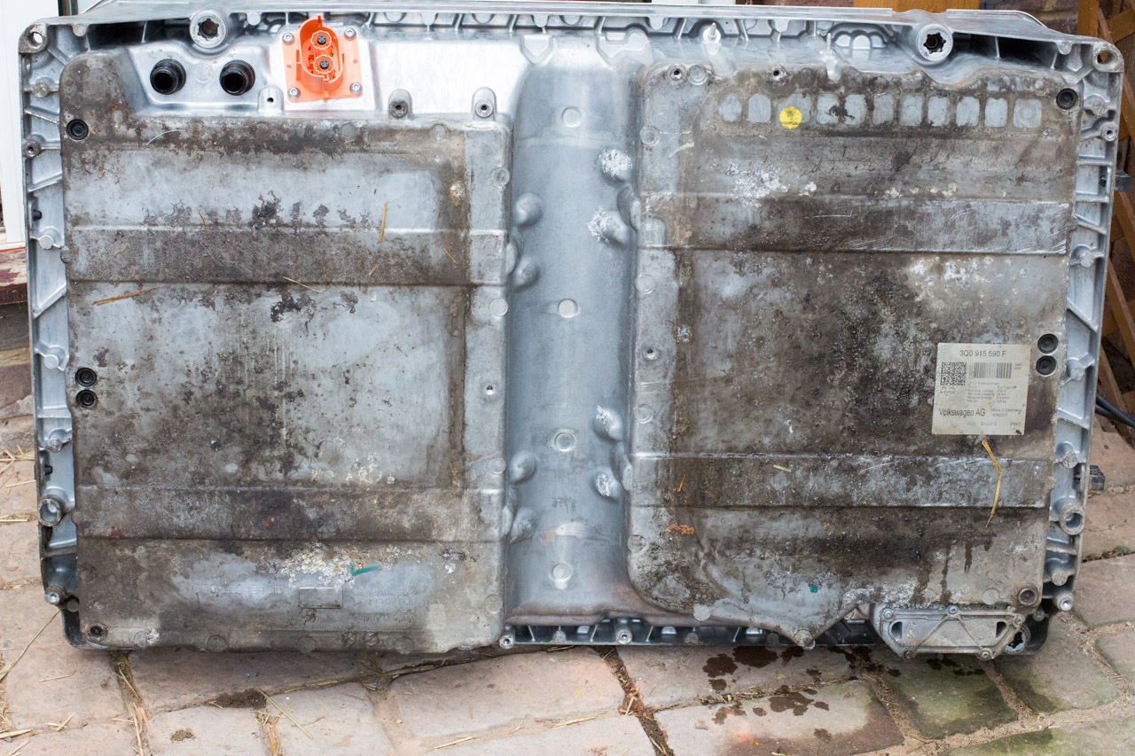

This VW battery box is seriously impressive piece of cast aluminum, probably bomb proof , however about 30kg, so about 25% of total weight, if anyone does use one of these batteries In a project I would seriously consider using the original box.
After Undoing all of the torx bolt on the top the cover can be removed … look at those precision straps to hold the modules down.

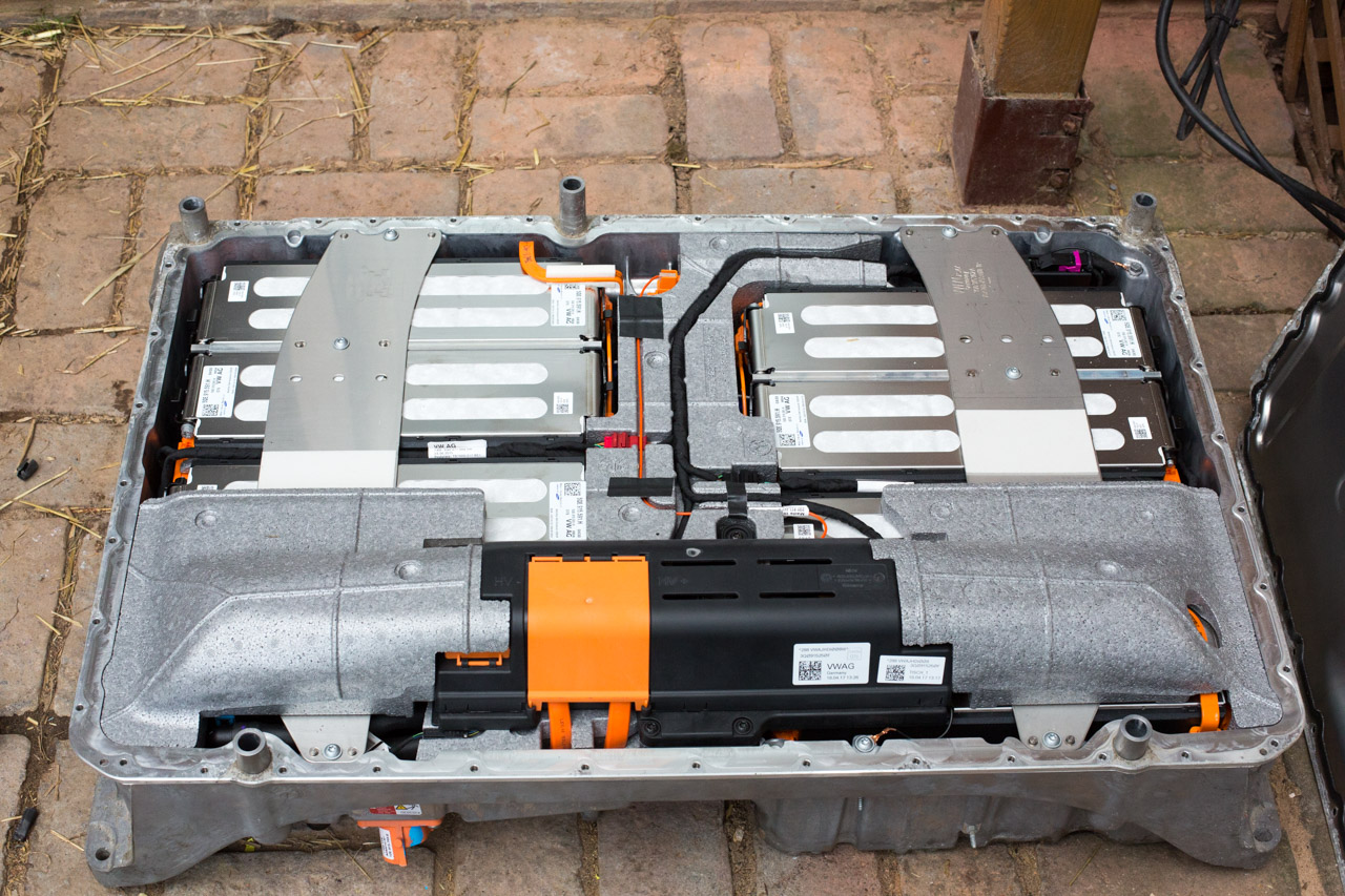

At this point after prodding about underneath the foam and looking down the sides I need access to the bottom to unbolt the modules, find that un-loved screwdriver (covered in paint in my case on top of my daughter’s rabbit hutch) and use gentle persuasion to remove the rubber plugs to get access to the torx bolts and remove them. Be very careful this thing is damn heavy you don’t wan this to land on your toes or any part of your body.
Now back to the top side … remove all the foam, disconnect all of the cables you can (I could not remove the module bms plugs). Happily my module sat at 355 volts (88.8v per module) so not too low at about 3.7v per cell!
I then started tackling all of the bolts holding down the modules in the middle, however then came the ones that were under the Contactor box.
The scary bit where I disconnected the HV connections from the Contactor box thing, immediately covering with insulation tape, first negative, positive, then I tackled the mid pack connection (not shown in this photo). Then I removed all of the connections from the contactor box to allow it the removed to allow access to the torx bolts obstructed by it.

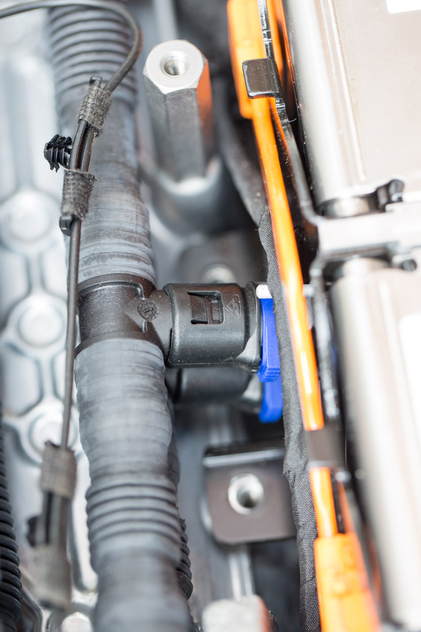

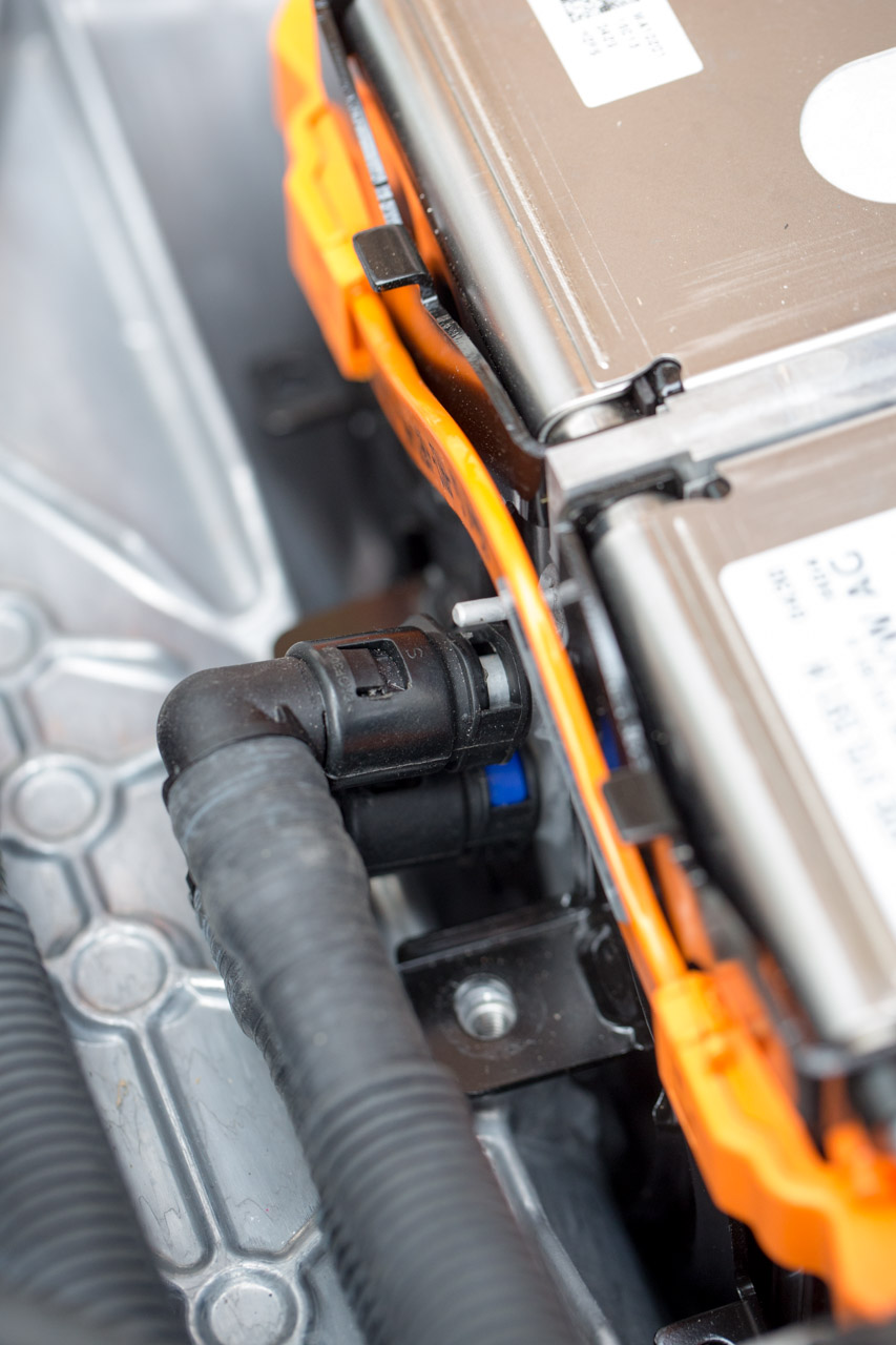

The coolant pipes need disconnecting, these damn blue plastic clips are fiddly, the really nice laser cut straps (left/right) holding down the modules need removing.
Then the really fun/controversial part trying to get the modules out! What I found that worked was to use a strap to lift the outer side up, jammed a wooden mallet underneath, this allowed me access to the bolts that connect the module to module HV strap (& BMS connector) so they can be removed therefore allowing the modules to be lifted vertically (once the wooden mallet was removed).
Useful/Tools used:
7. Voltmeter
8. Insulated shoes

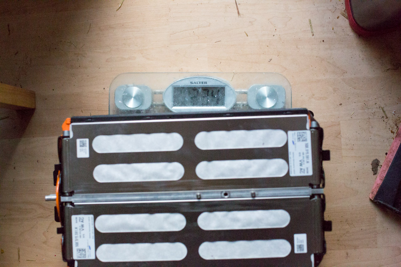

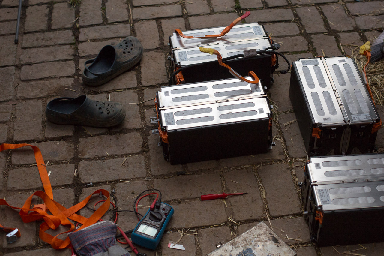

This first module is the hardest once that one is out it makes the second one easier, then onto the other side!
There out!! As you can see by this point I was shattered…. But one more job to do.
23.4Kg for a 24s 28ah module with liquid cooling not to bad. Hopefully i will get some up close photos of the modules at the weekend

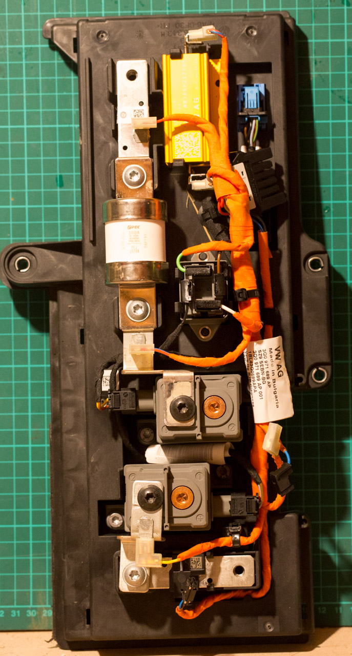

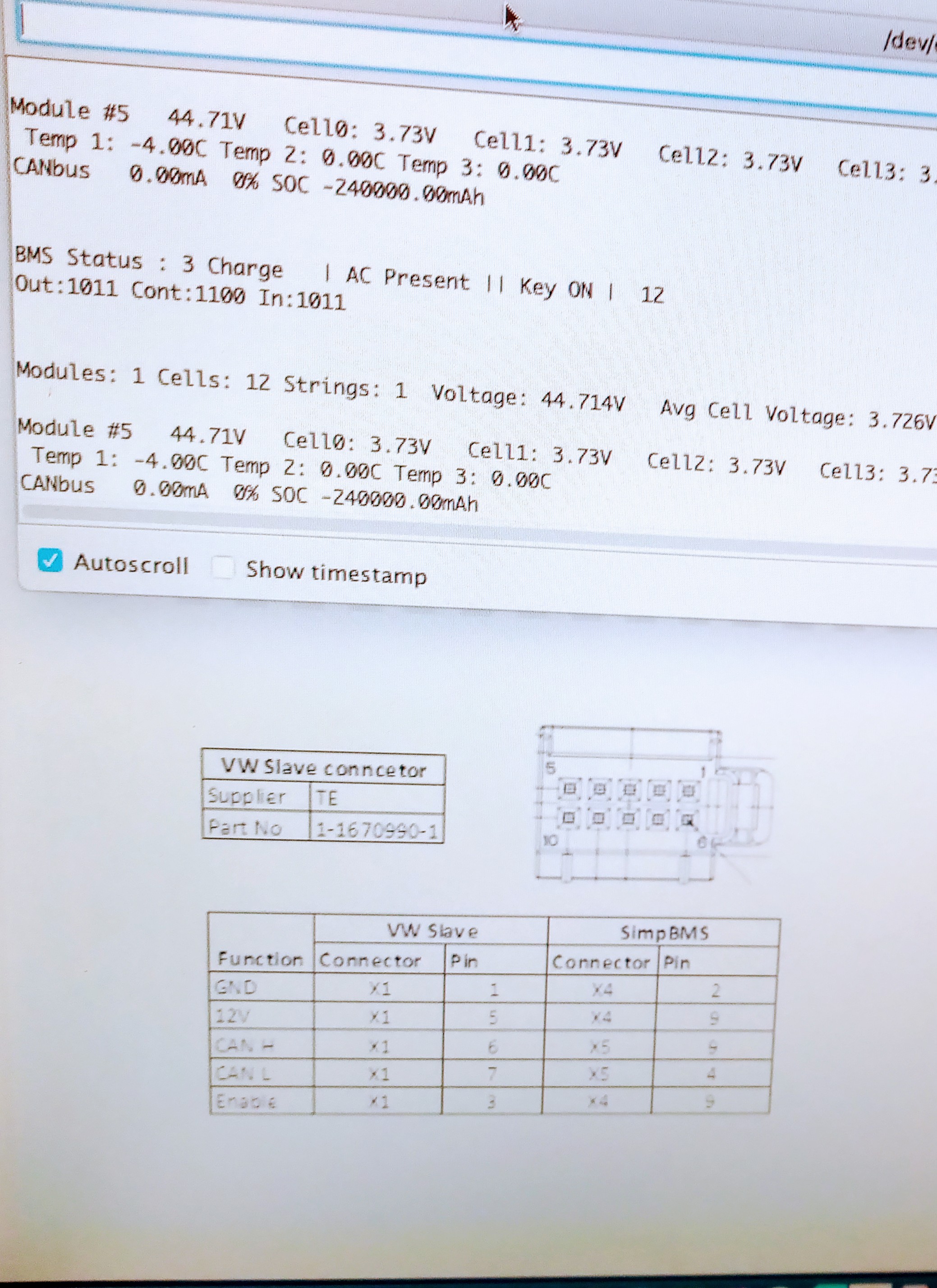

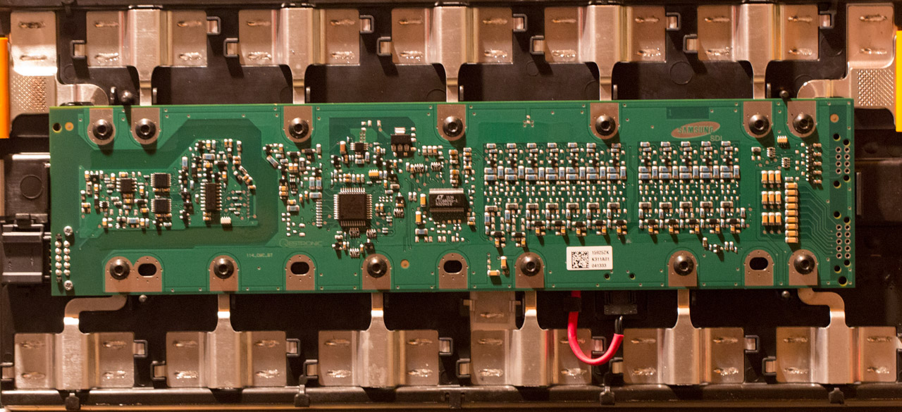

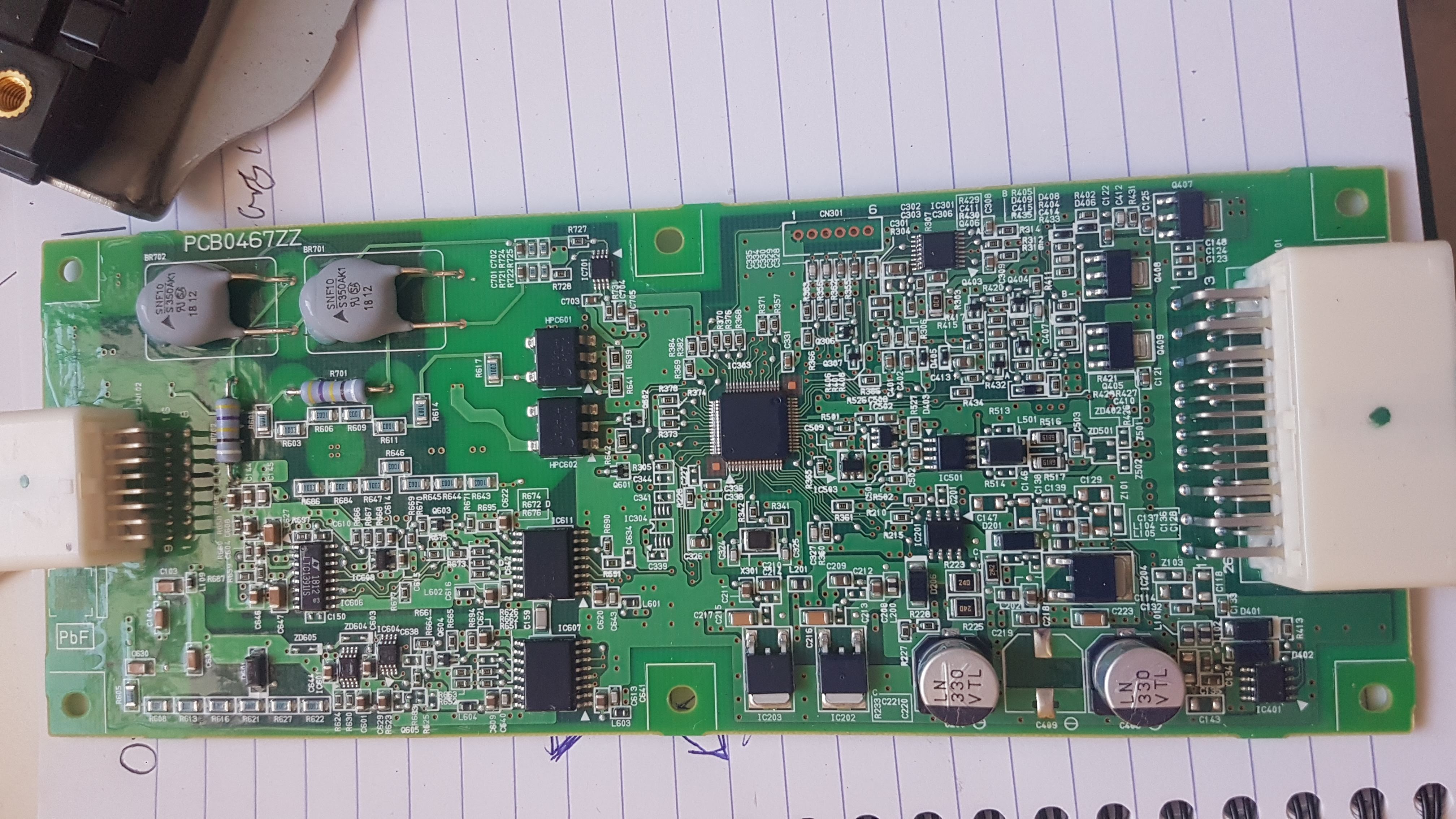

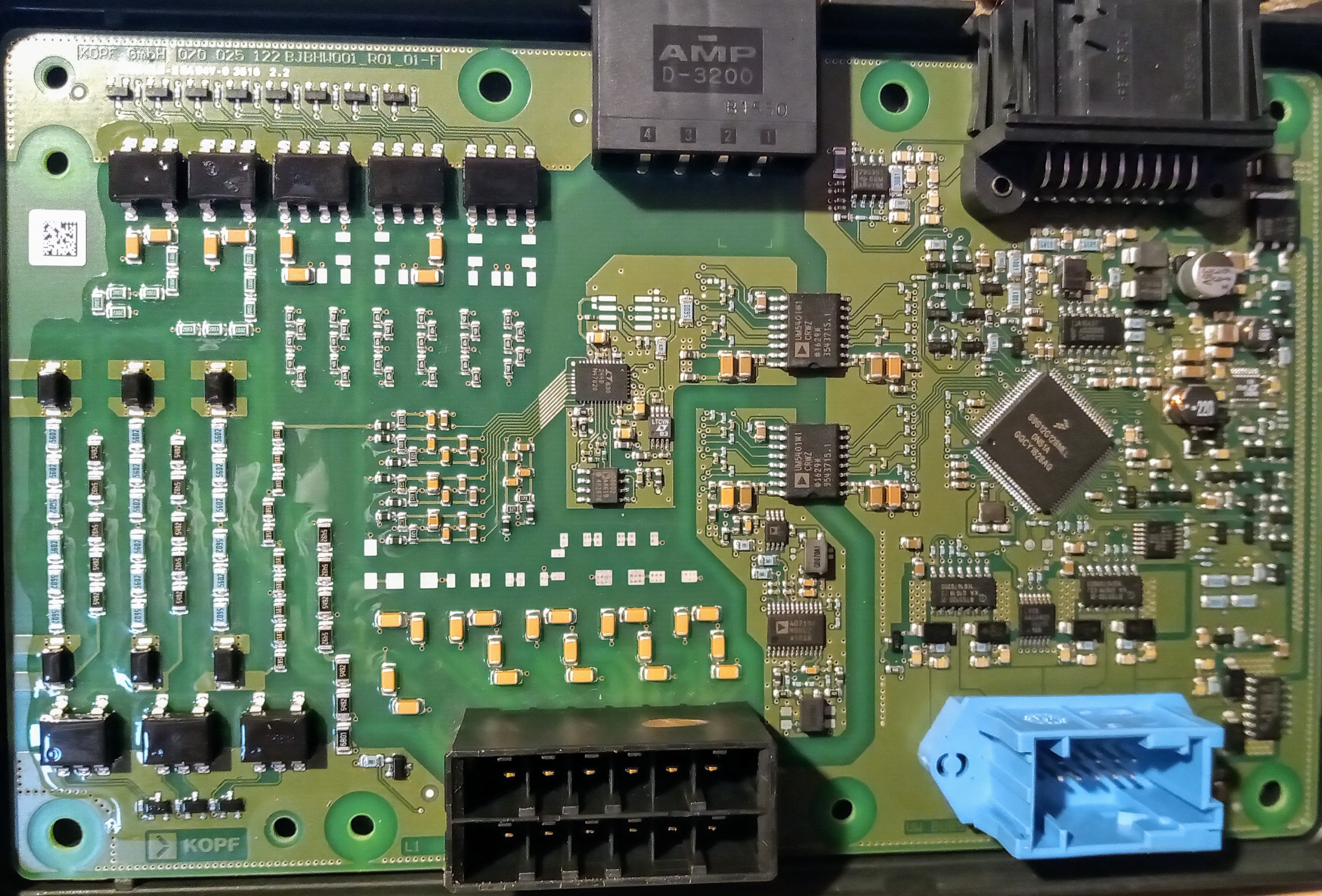

Okay, I have got myself addicted to something dangerous ... bateries, i have brought myself another Passat GTE battery pack so now i have 19.8KWhr (minus degredgation of course) of battery. well i had been busy with life in general so it took me a while to prgressing much further.
I thought i would quickly post some snaps of the inside nice contactor box that comes with the bateries and a quick look at the BMS.
1. inside Contactor Box (unfortunately i had no luck in tracking down what the shunt characteristcs were to resue it) 2. Nice view Coolent conectors and how the two halfs conect together
3. Close up view of the BMS, the markings on the chip are LTC6804G1 Now the real fun starts ... i got myself a teensy 3.2 & MCP2562 ... lets try and see if i can get some can captures from the modules and see if i can make sense of it
Based on the data sheet [havent found the exact one yet] even if i dont suceed in talking to the BMS via canbus i might be able to talk to the LTC via SPI

You realise right that the SimpBMS already has voltage and temperature read out for these modules?rstevens81 wrote: ↑Mon Nov 16, 2020 11:01 pm Now the real fun starts ... i got myself a teensy 3.2 & MCP2562 ... lets try and see if i can get some can captures from the modules and see if i can make sense of it
It requires a can command message to spit out useful data.
Have a look here: https://github.com/tomdebree/VW-bms

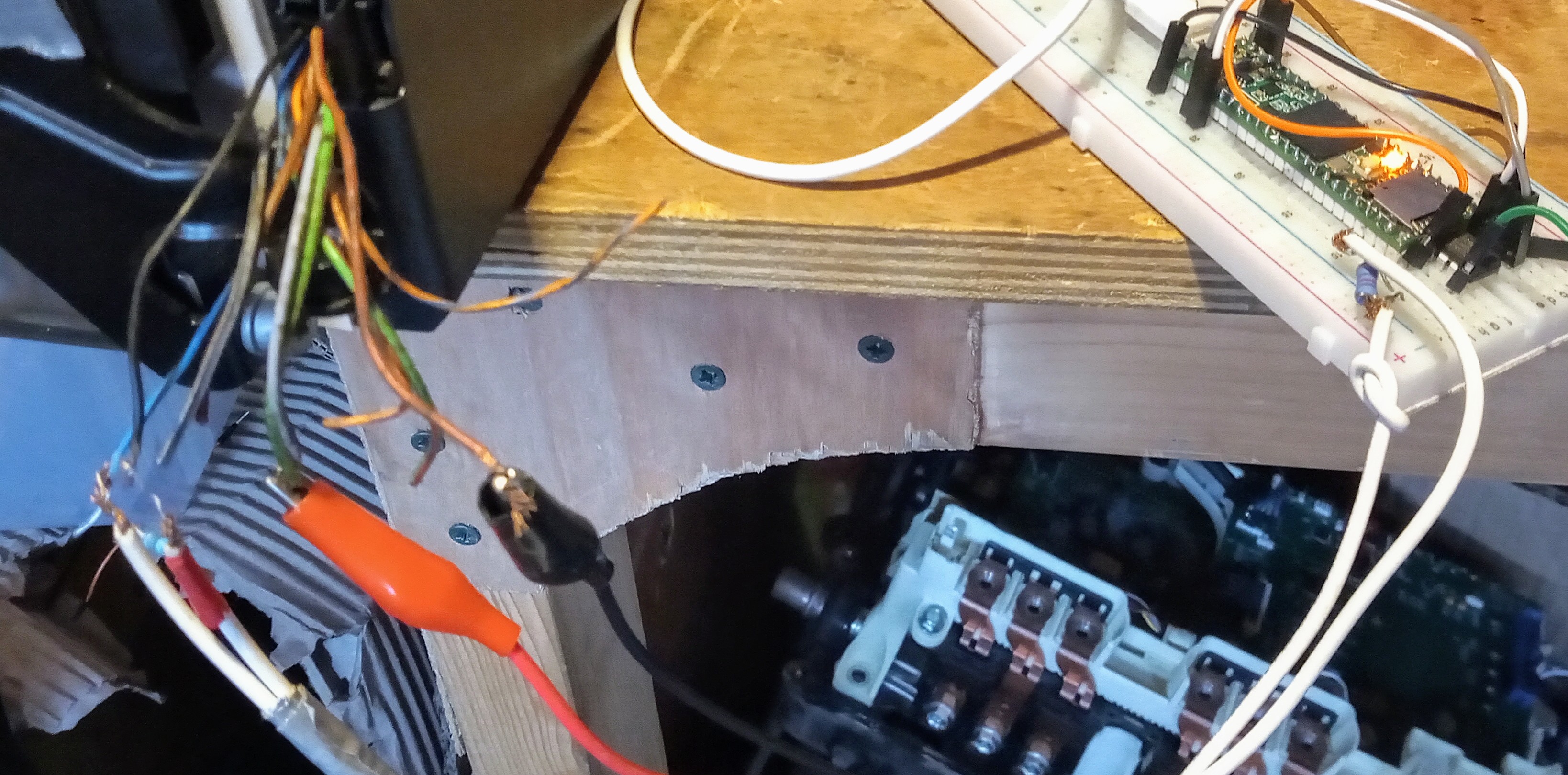

Re: Mazda Mx5 (MK2)

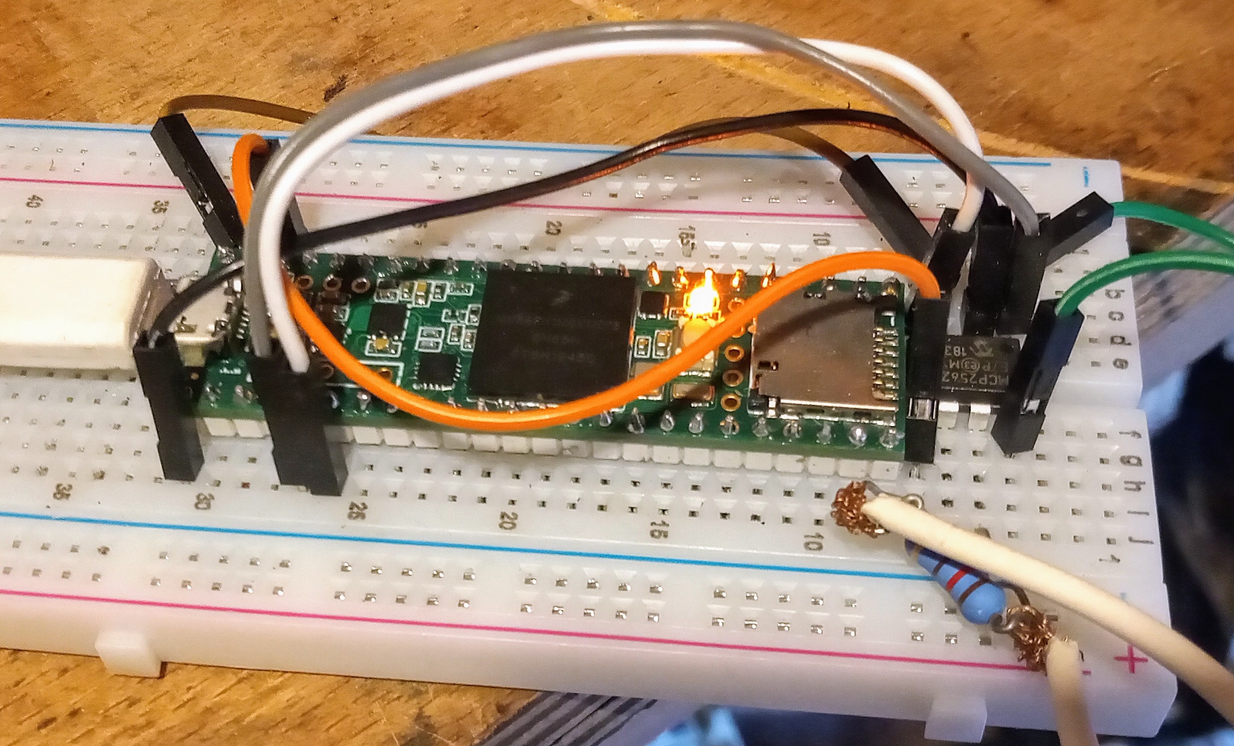

Ahh in your user manual you refer to Panasonic gte (golf), batteries these are Samsung gte ones (Passat).
I tried last night on a breadboard but didn't get it to work, but my cheap Chinese resistors were mislabeled or just crap only giving 105, so I ordered some more, so hopefully will try again soon.

Re: Mazda Mx5 (MK2)
Should be the same for both, you need to make sure to wire the 12V power and enable on the slaves.

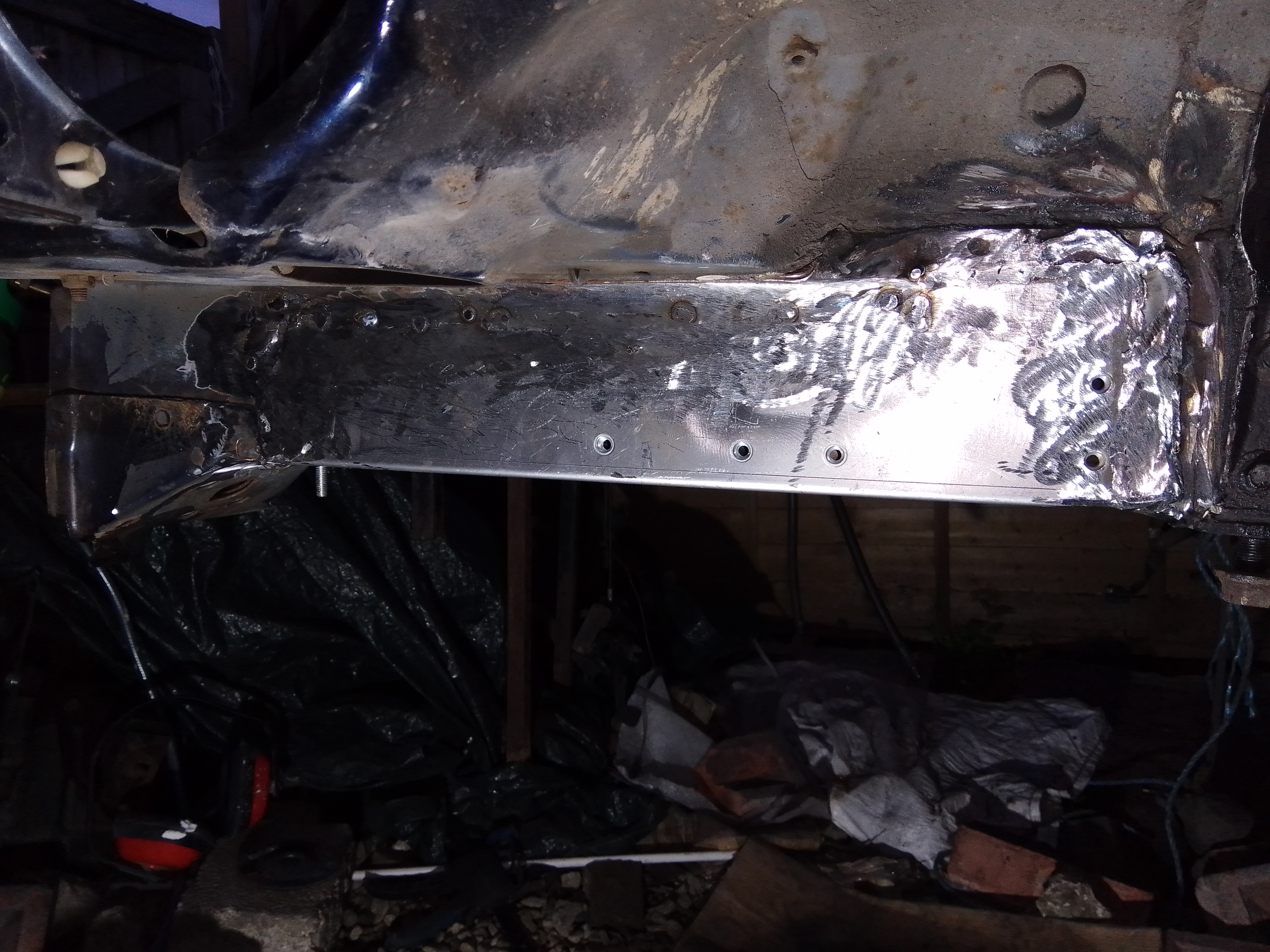

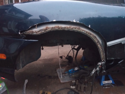

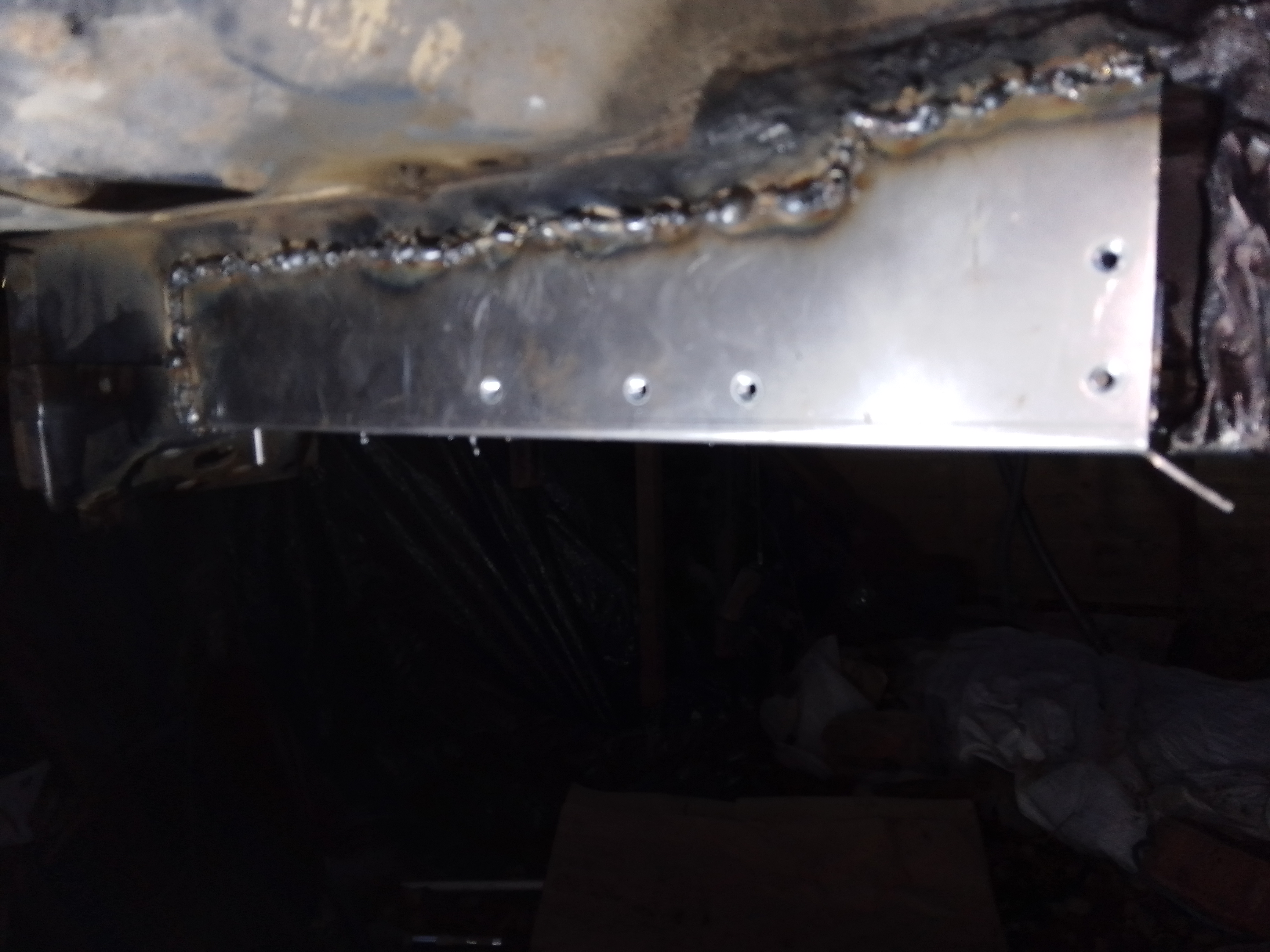

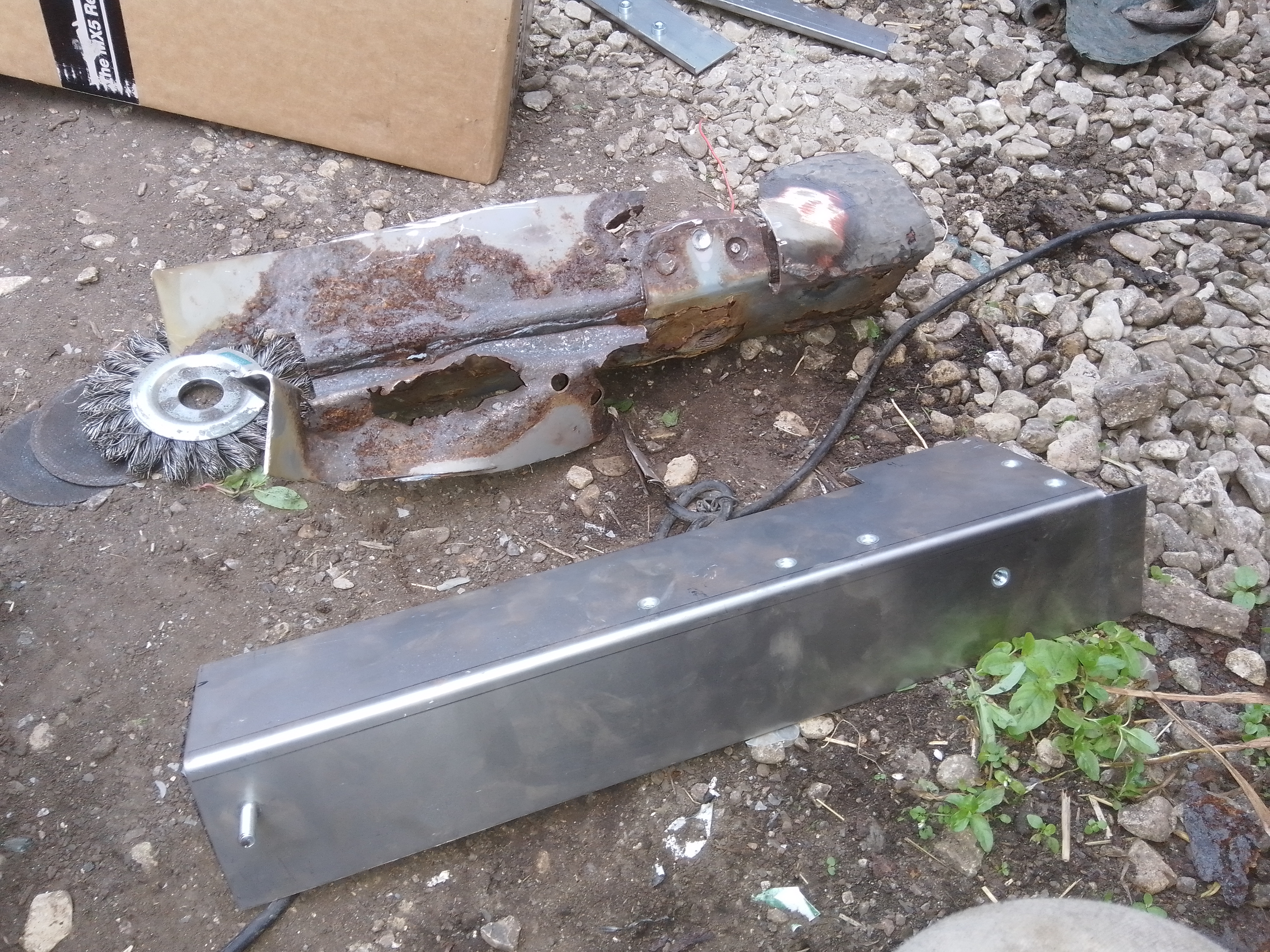

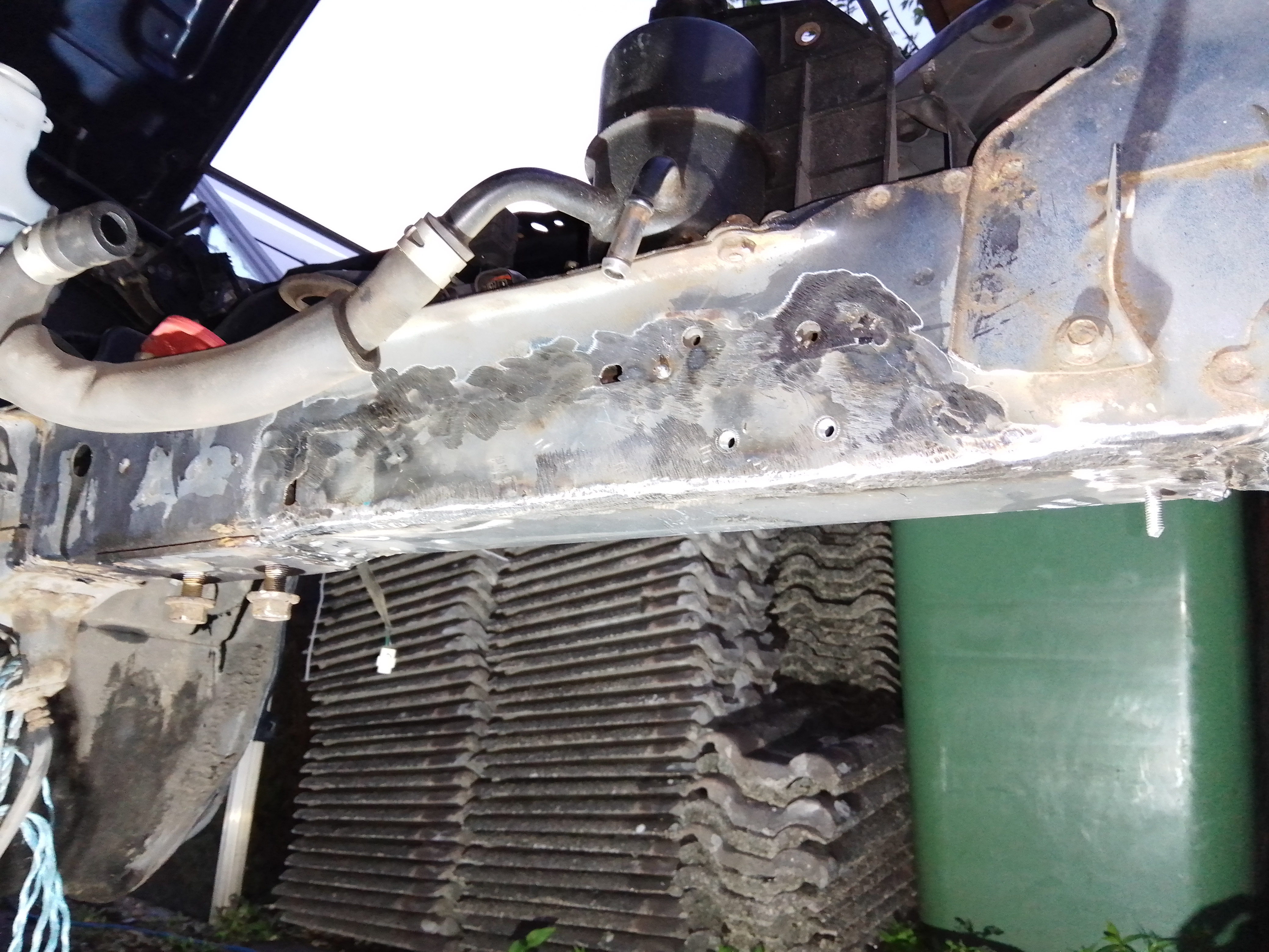

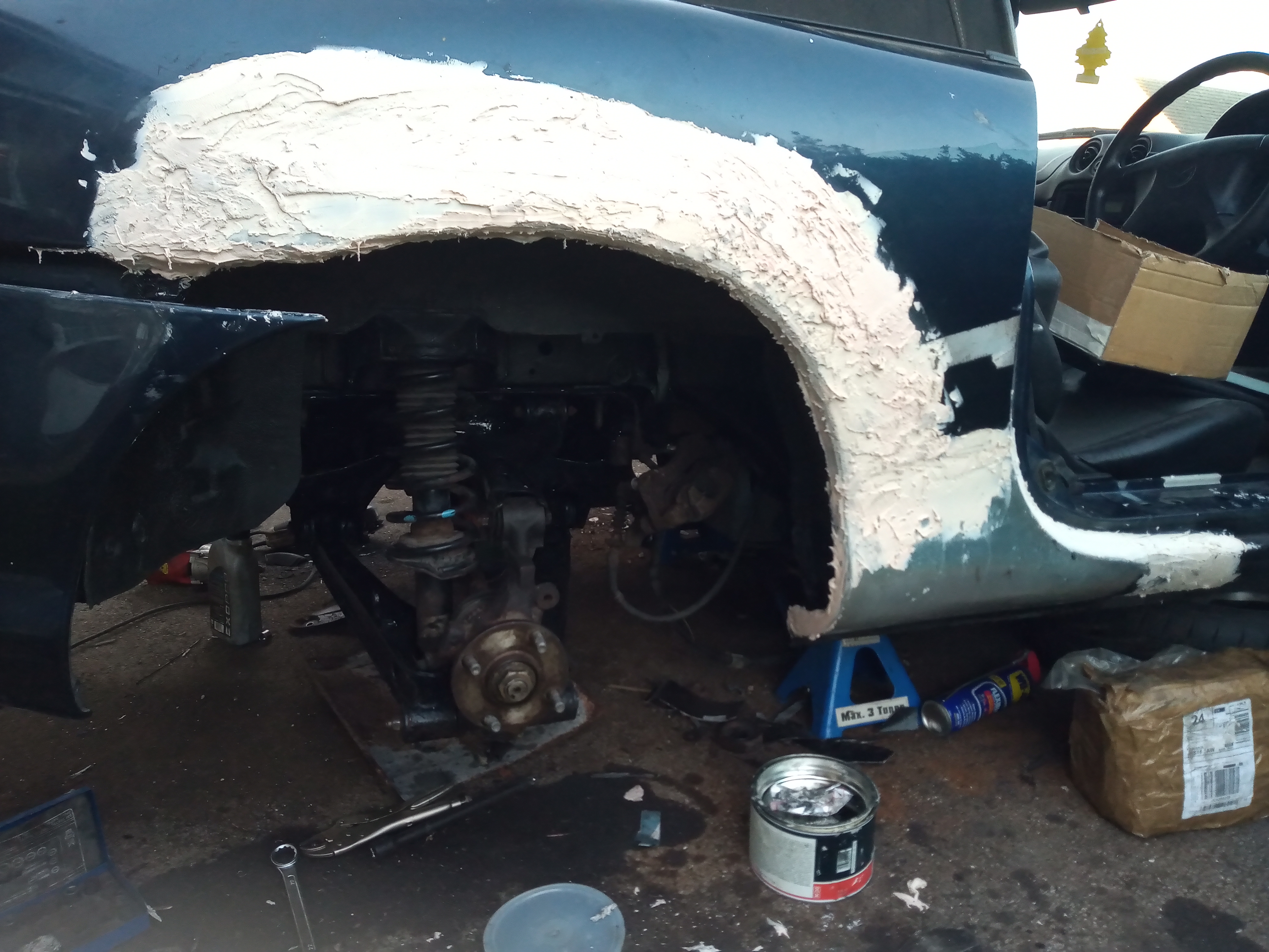

Re: Mazda Mx5 (MK2)

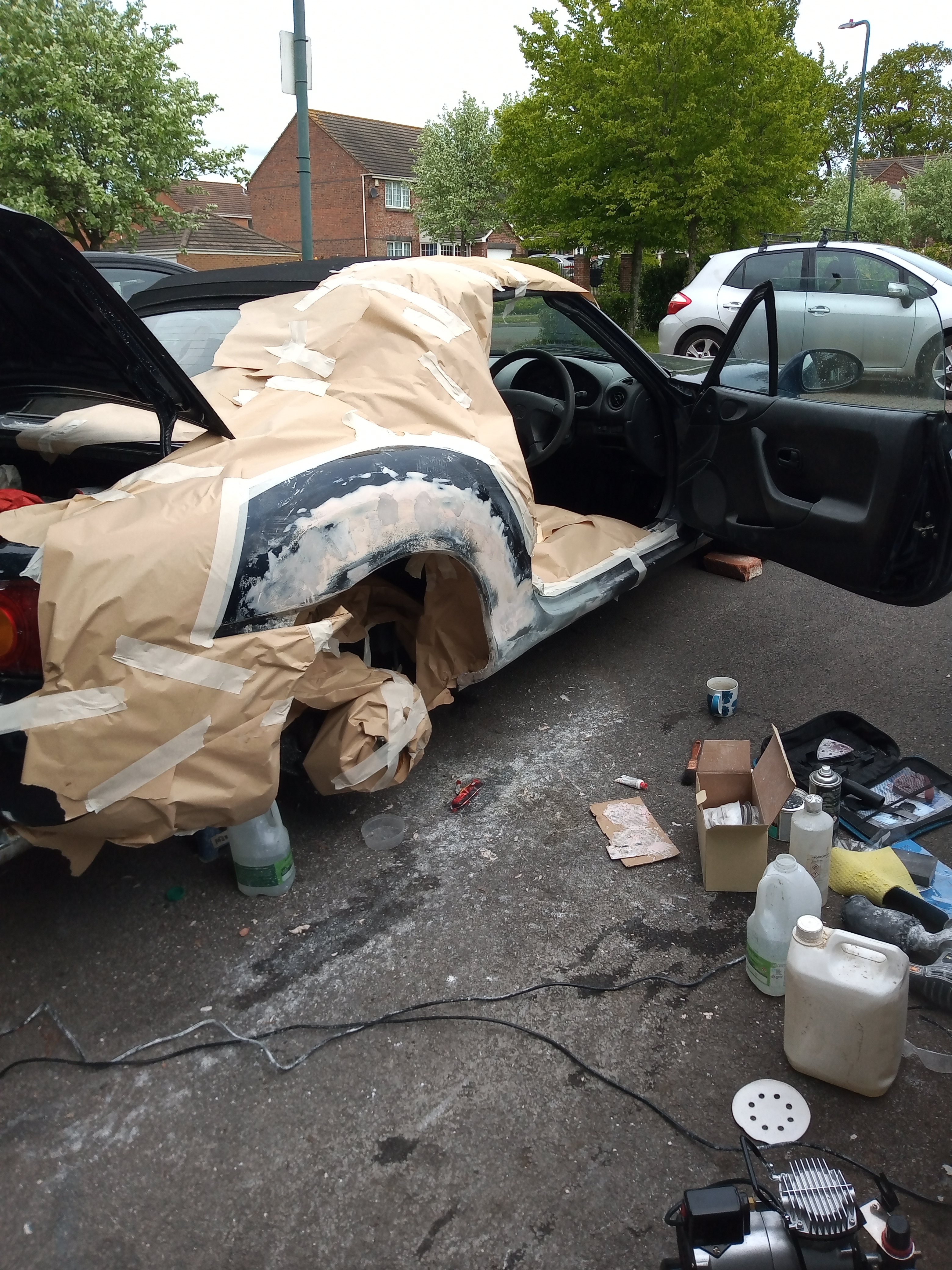

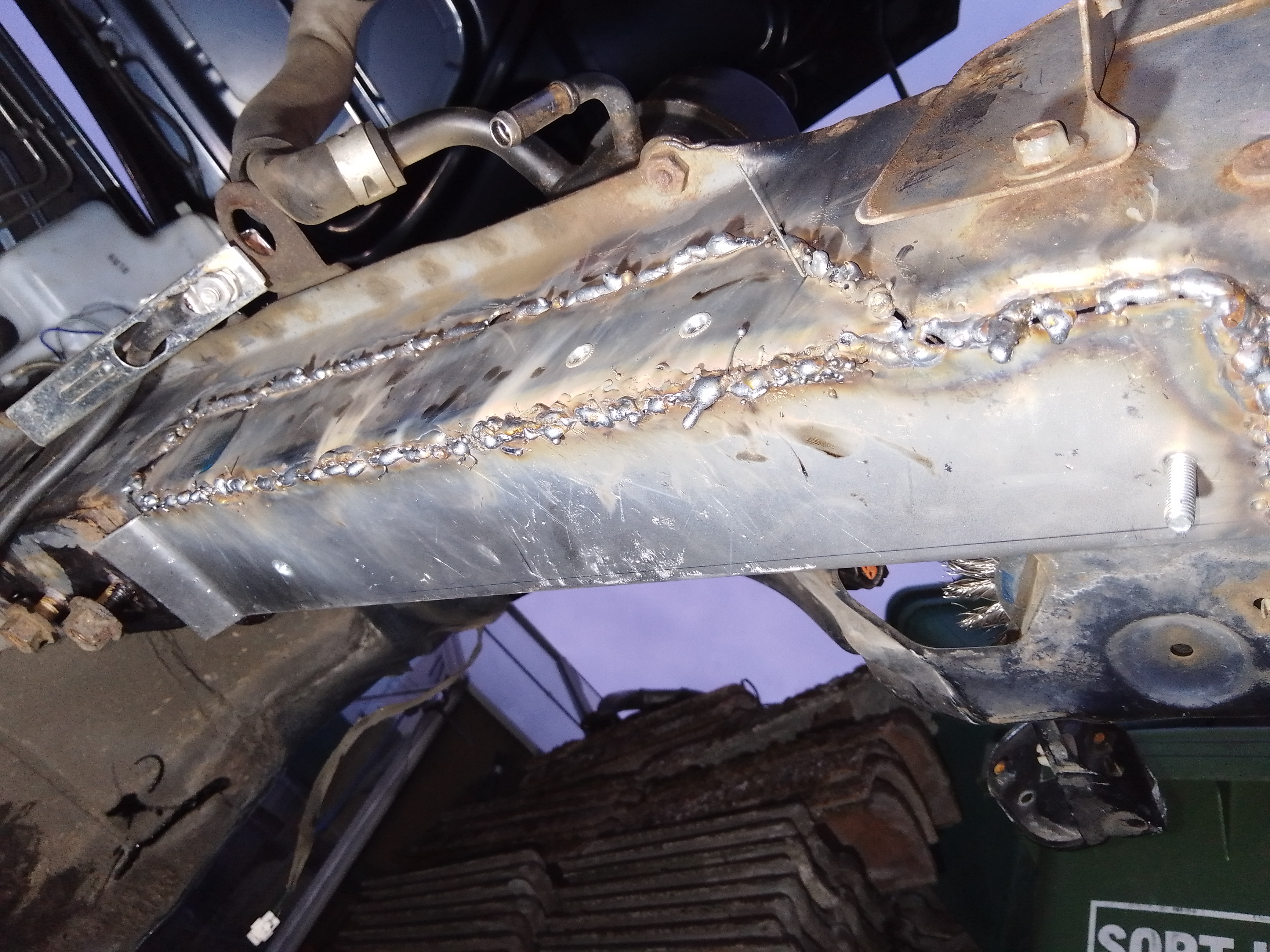

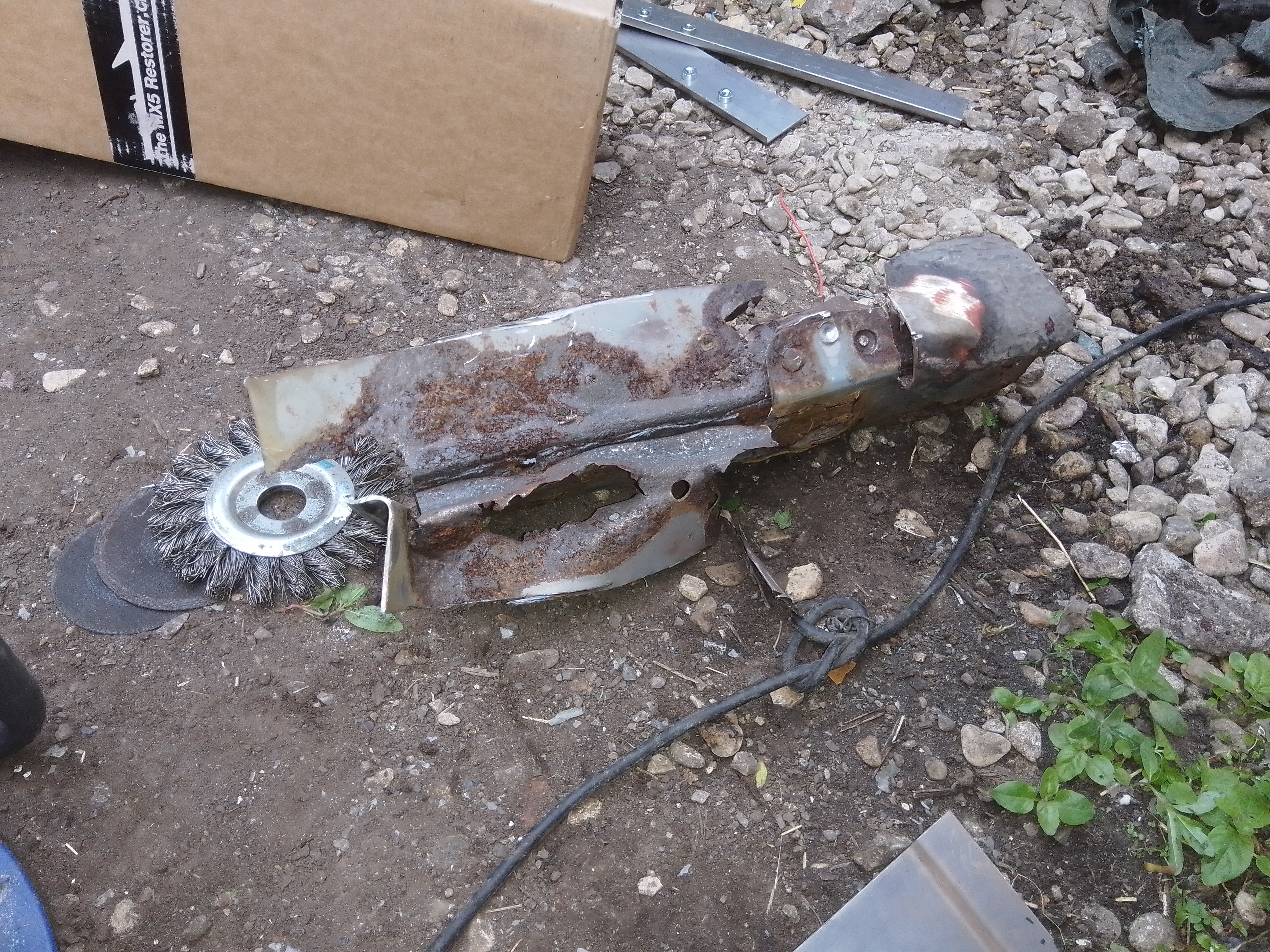

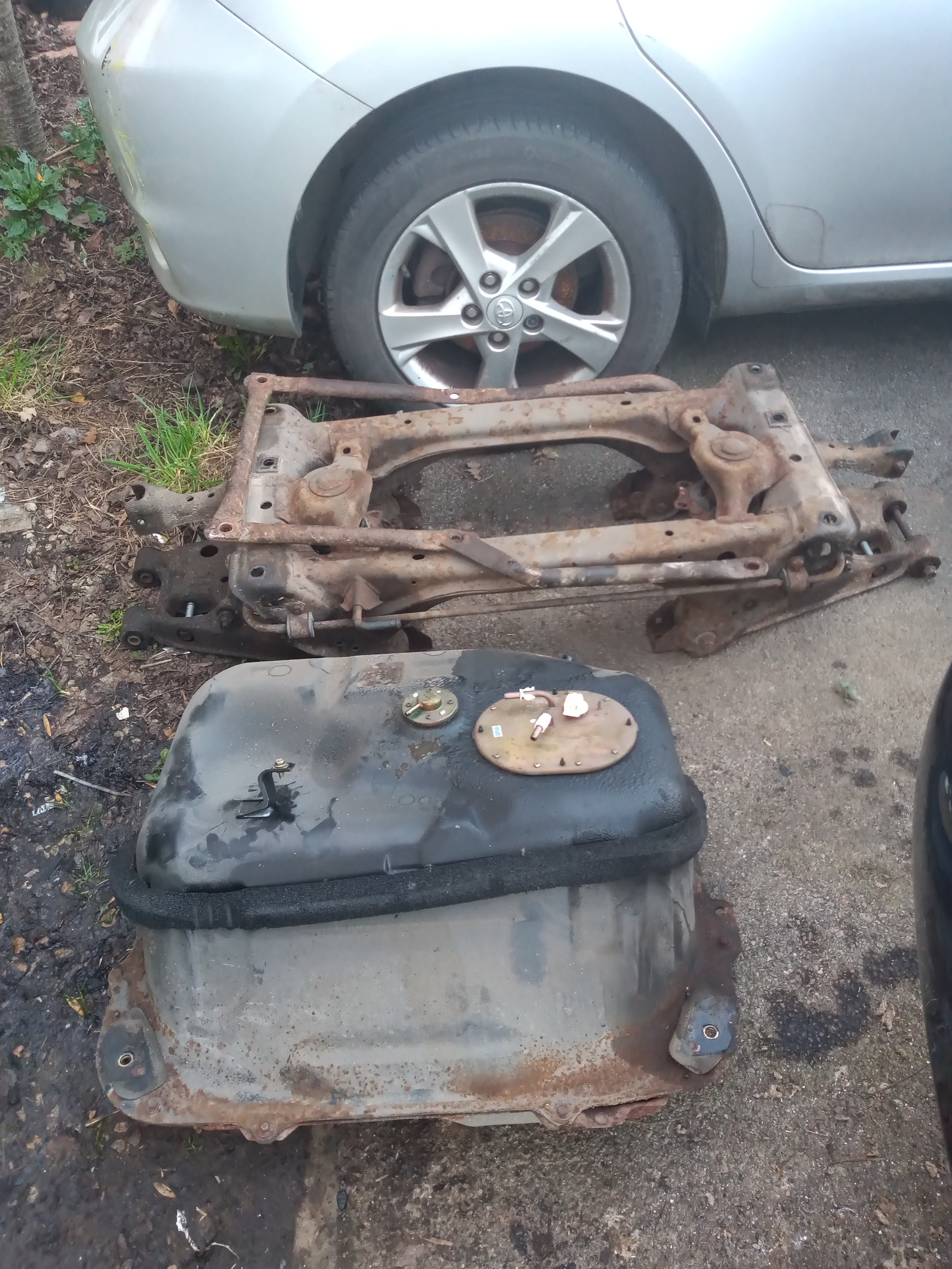

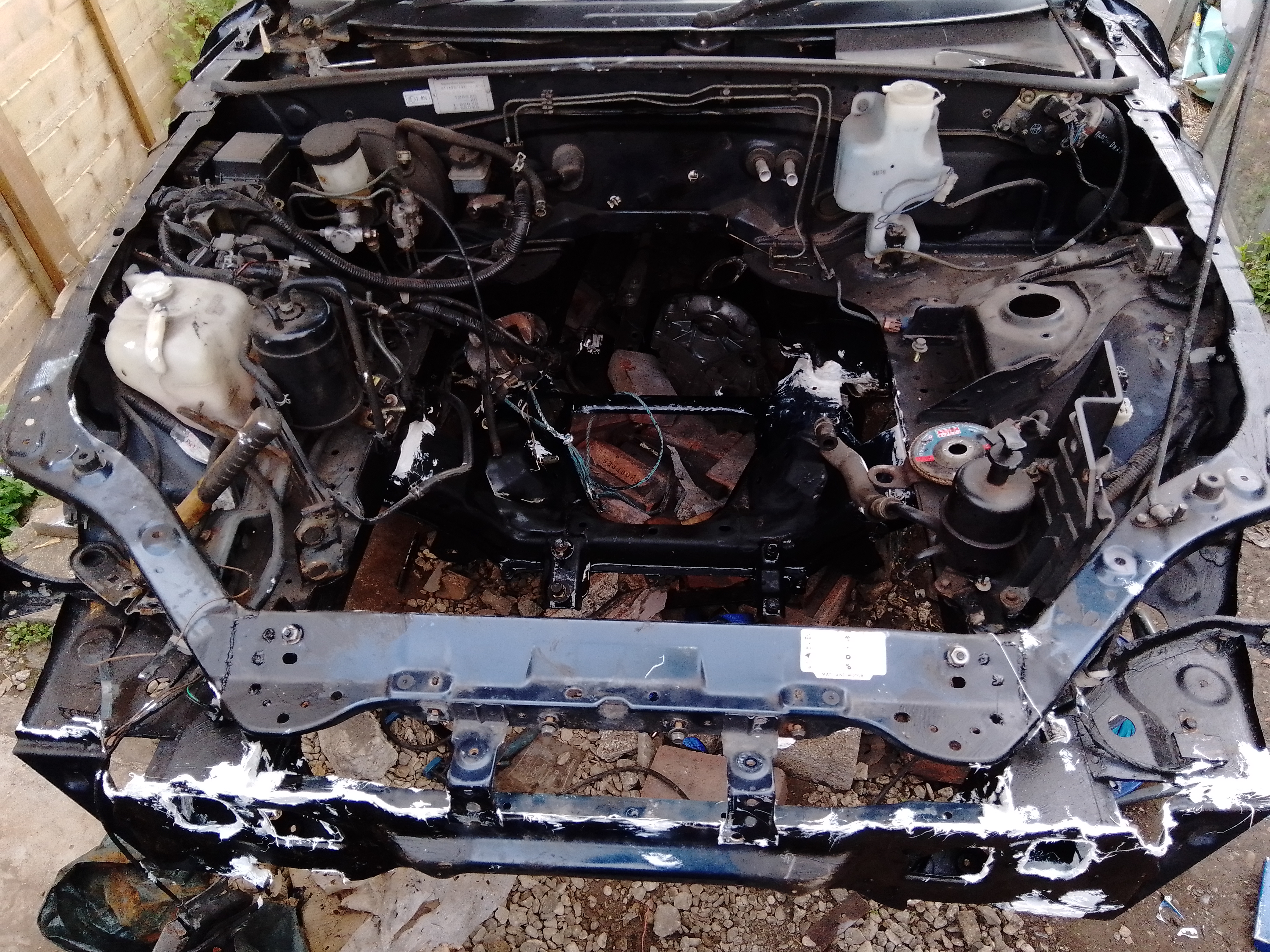

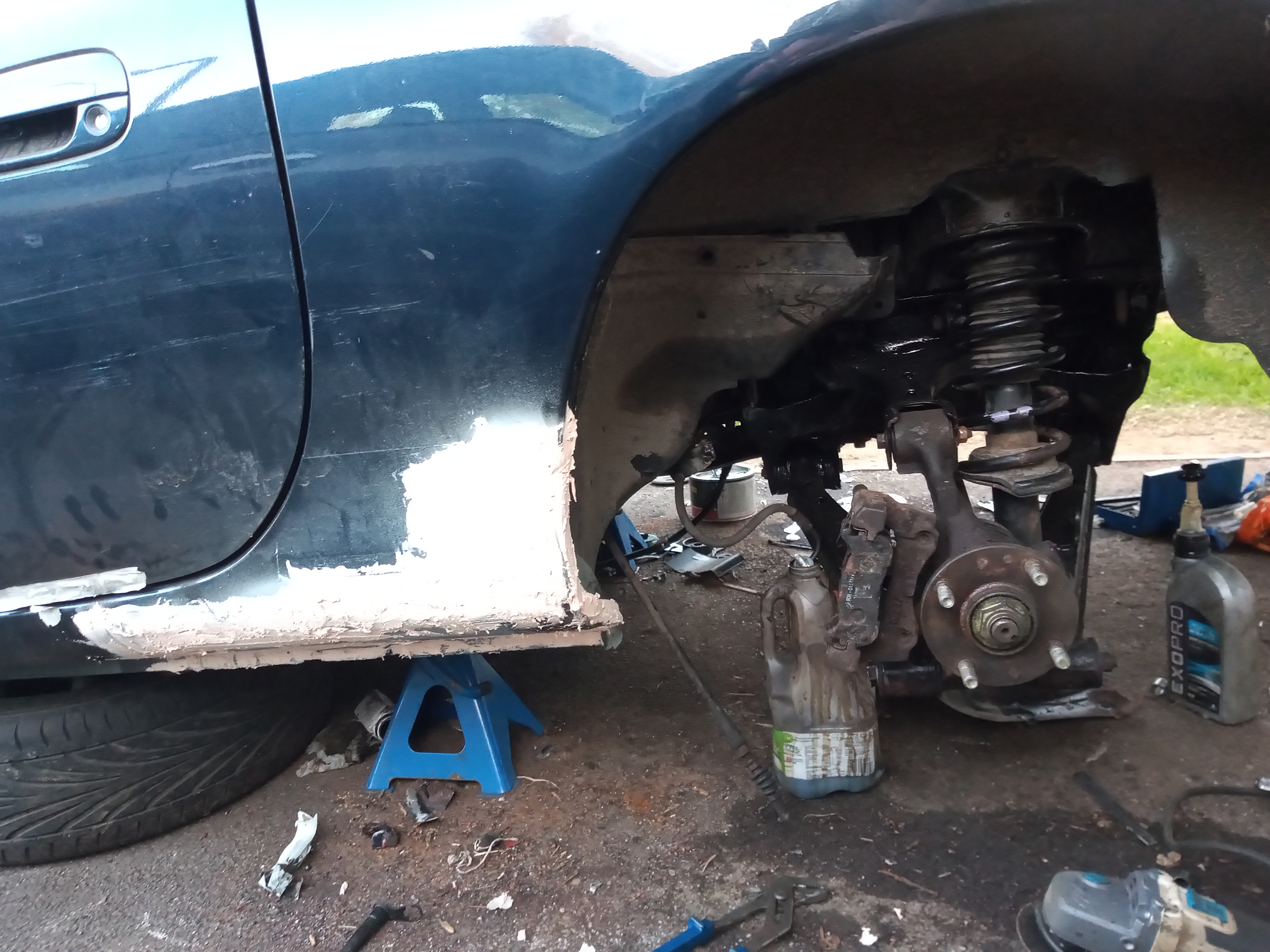

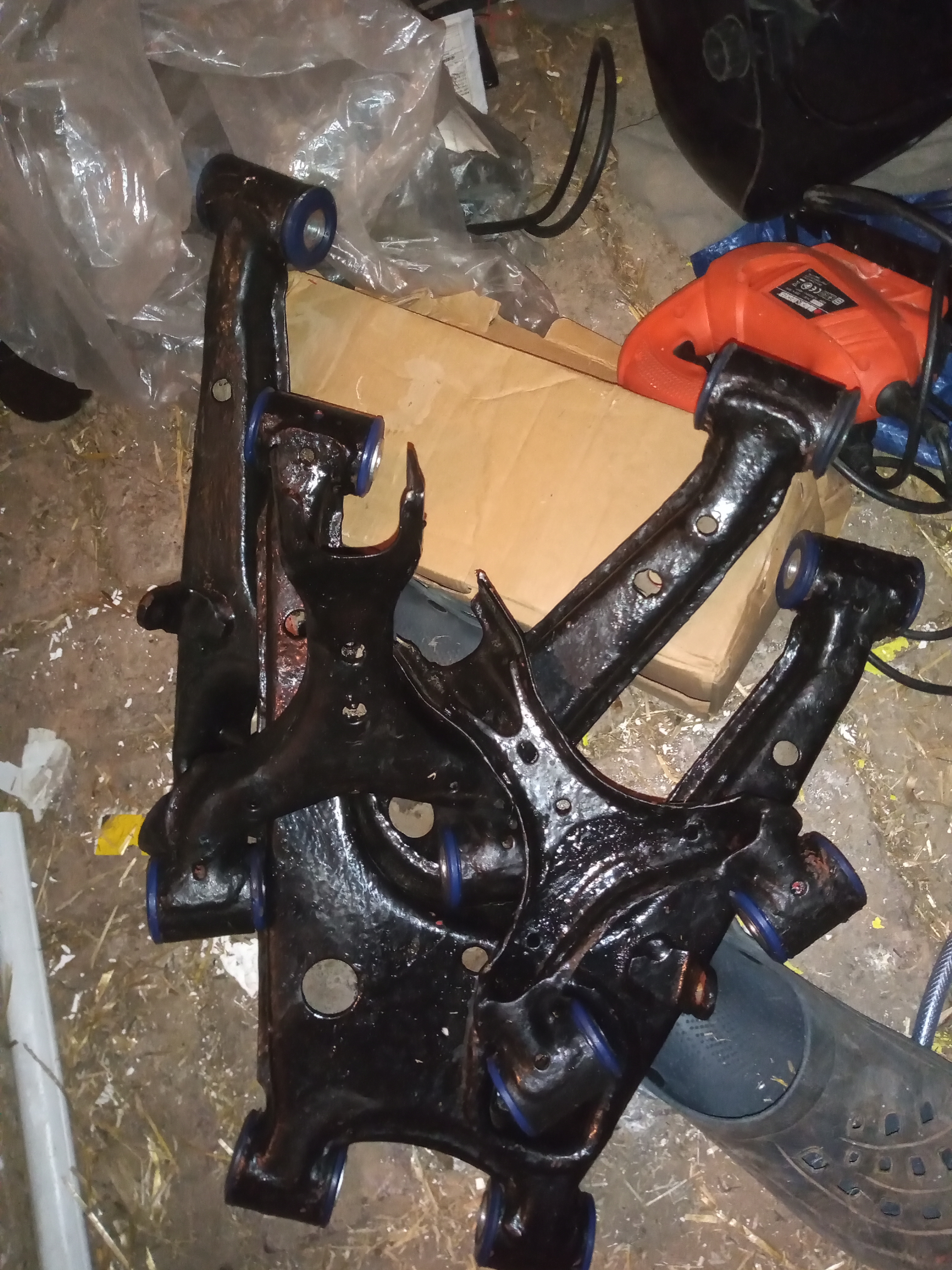

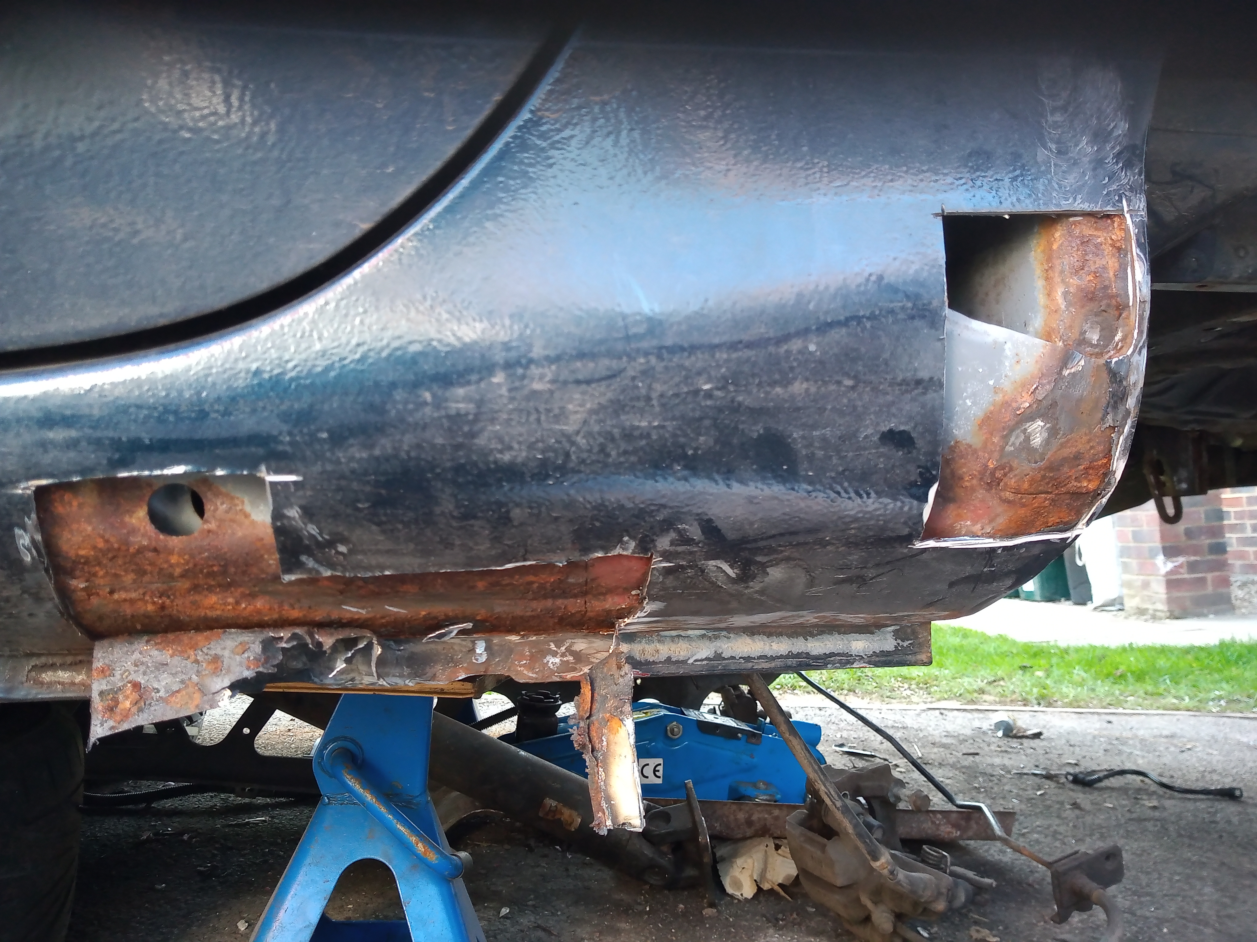

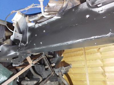

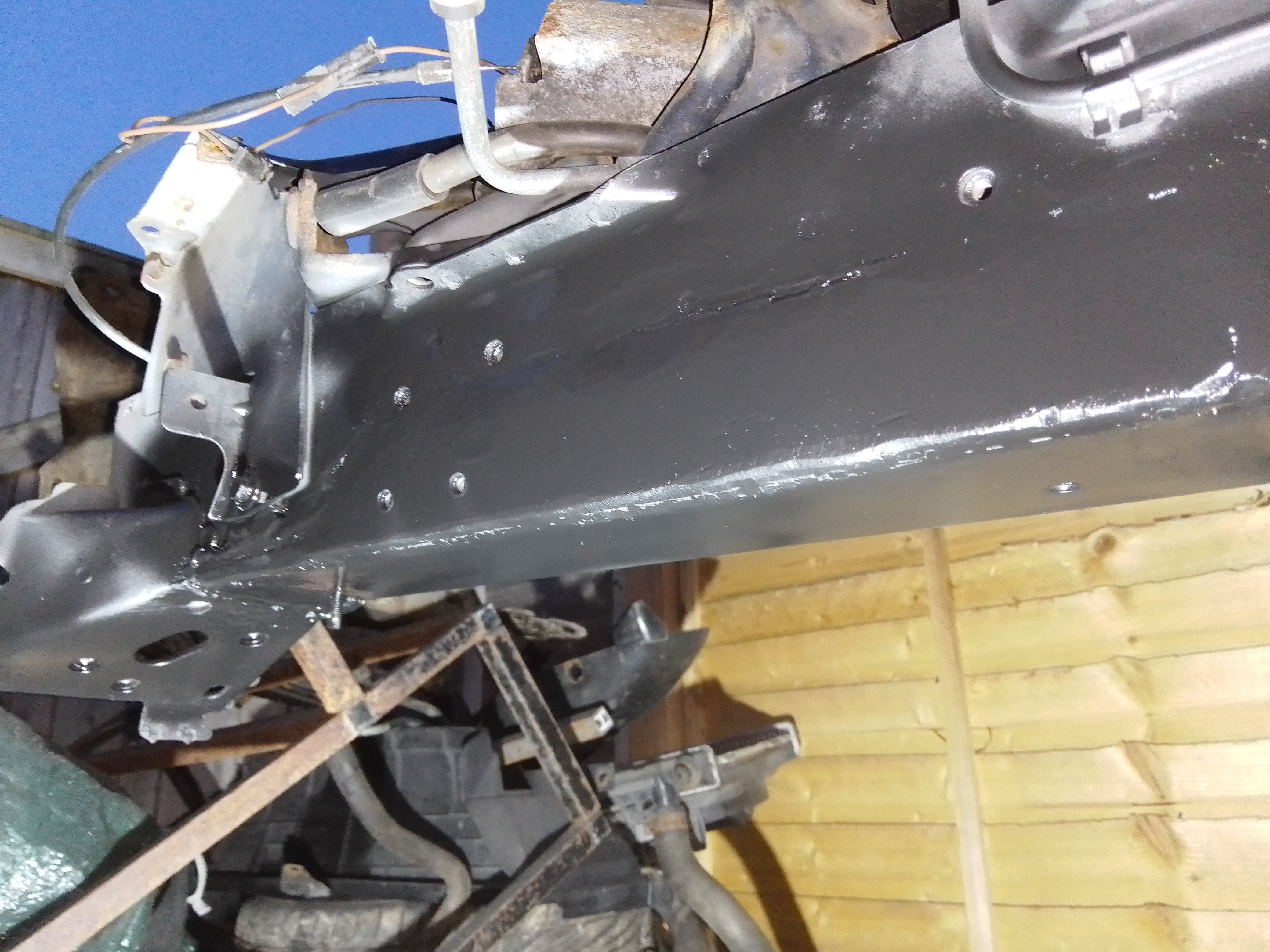

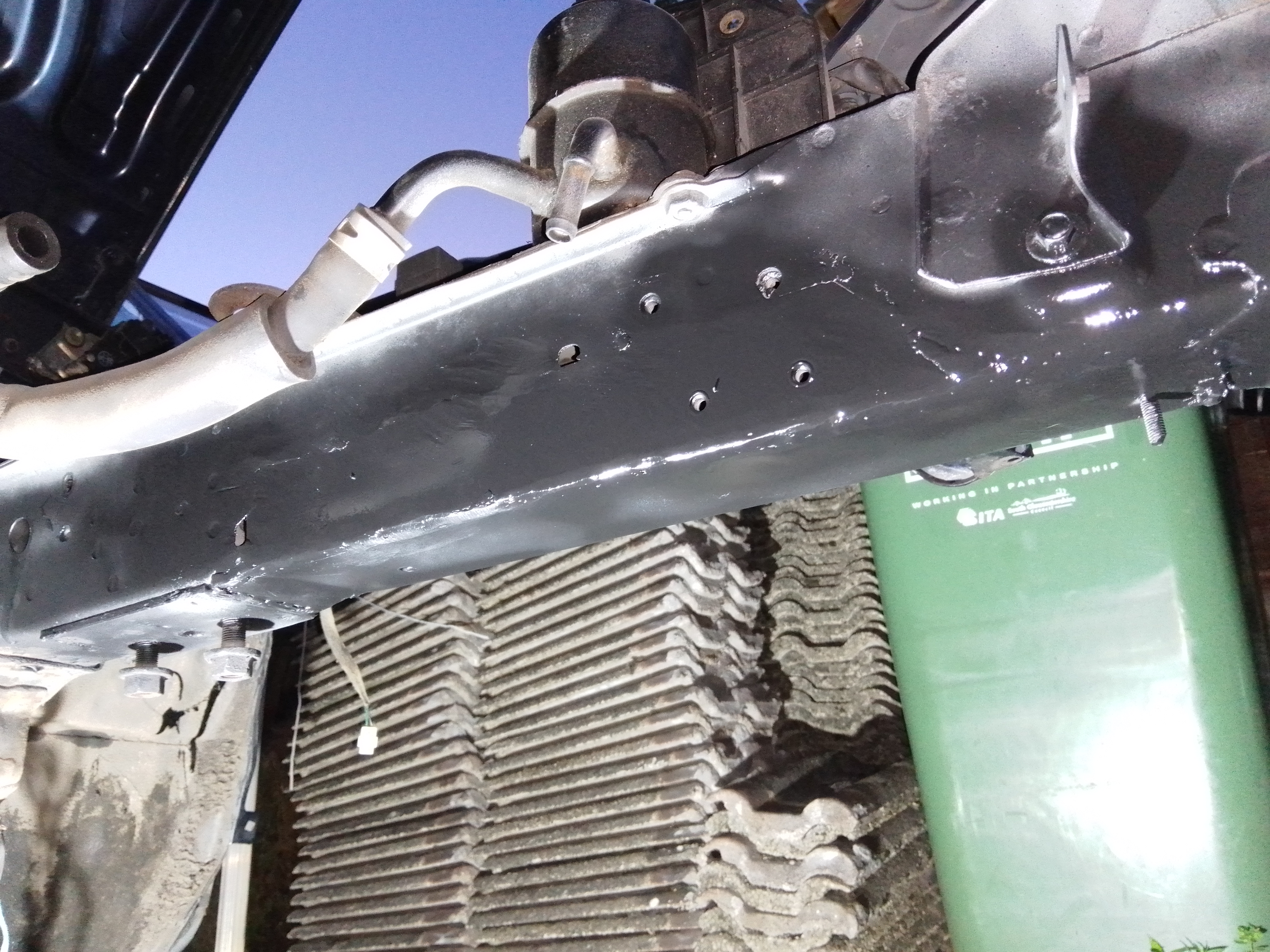

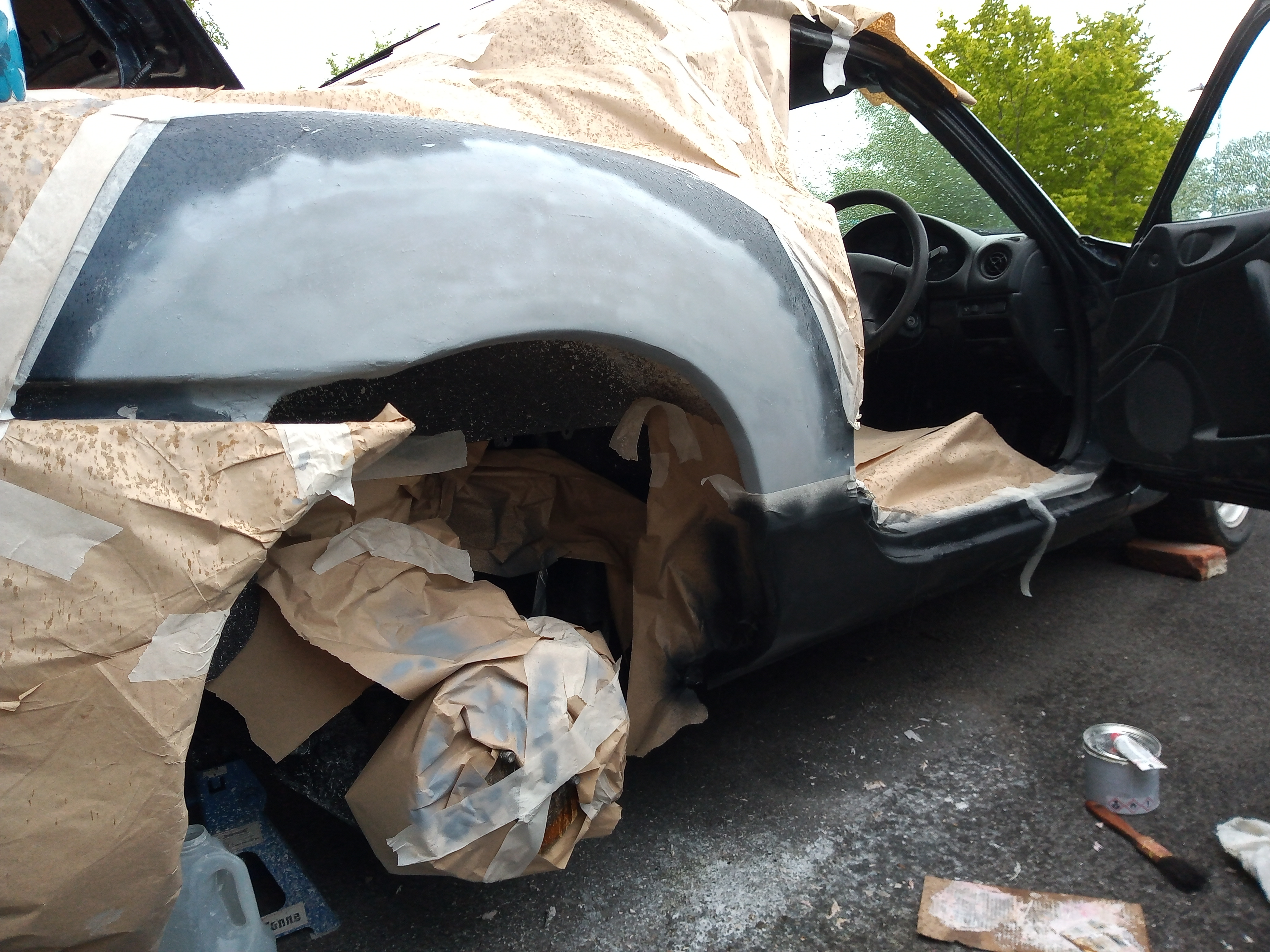

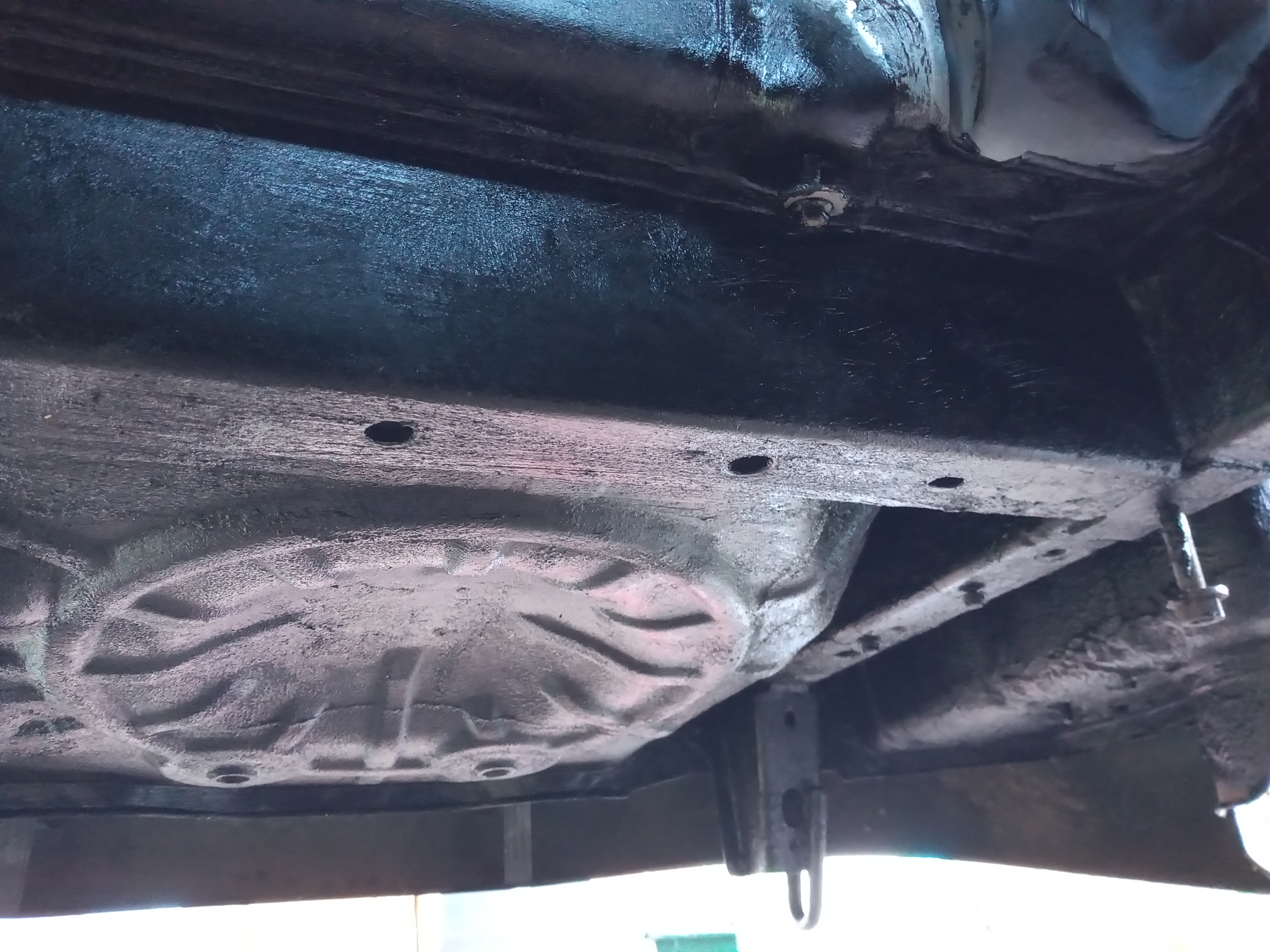

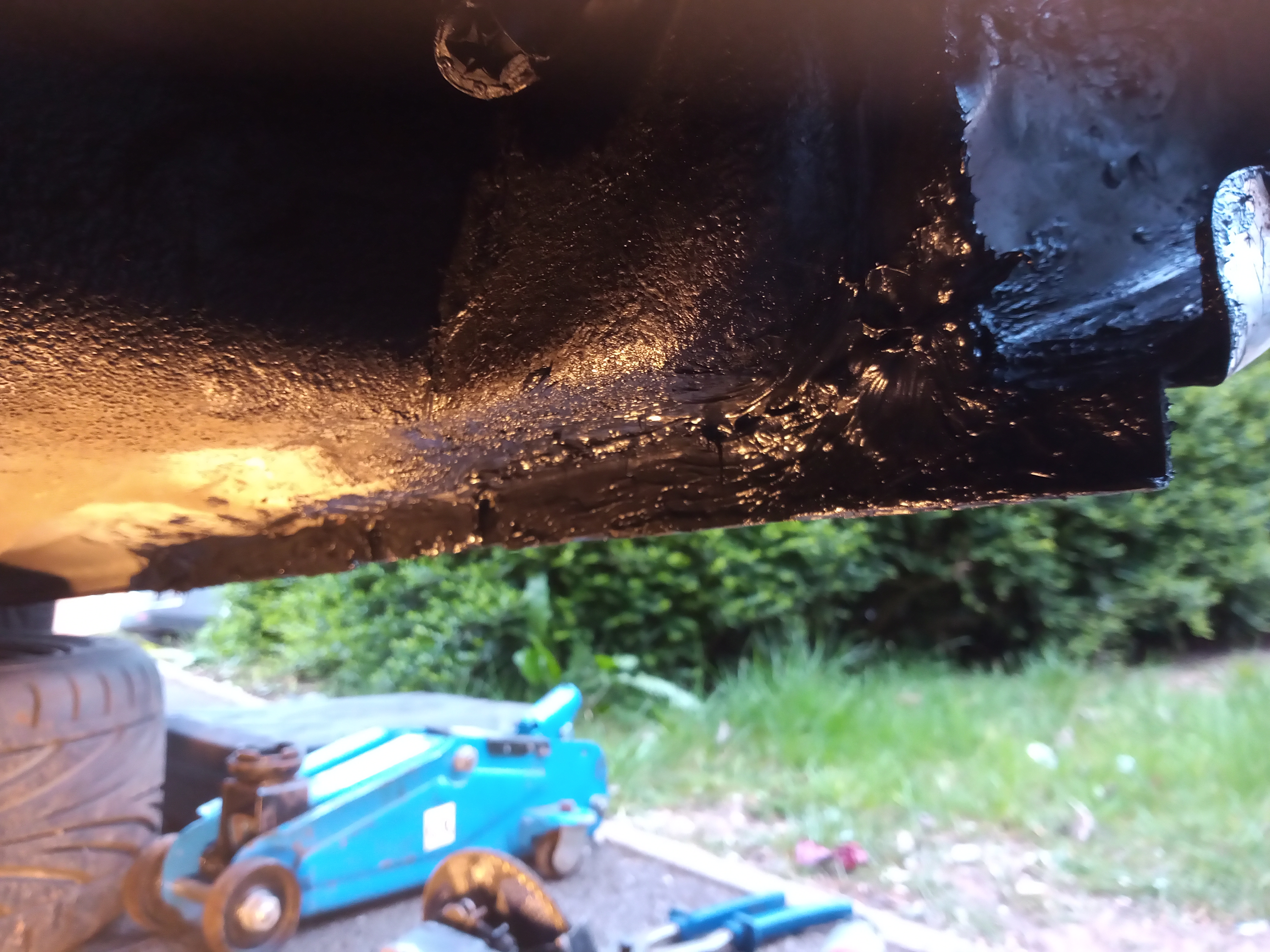

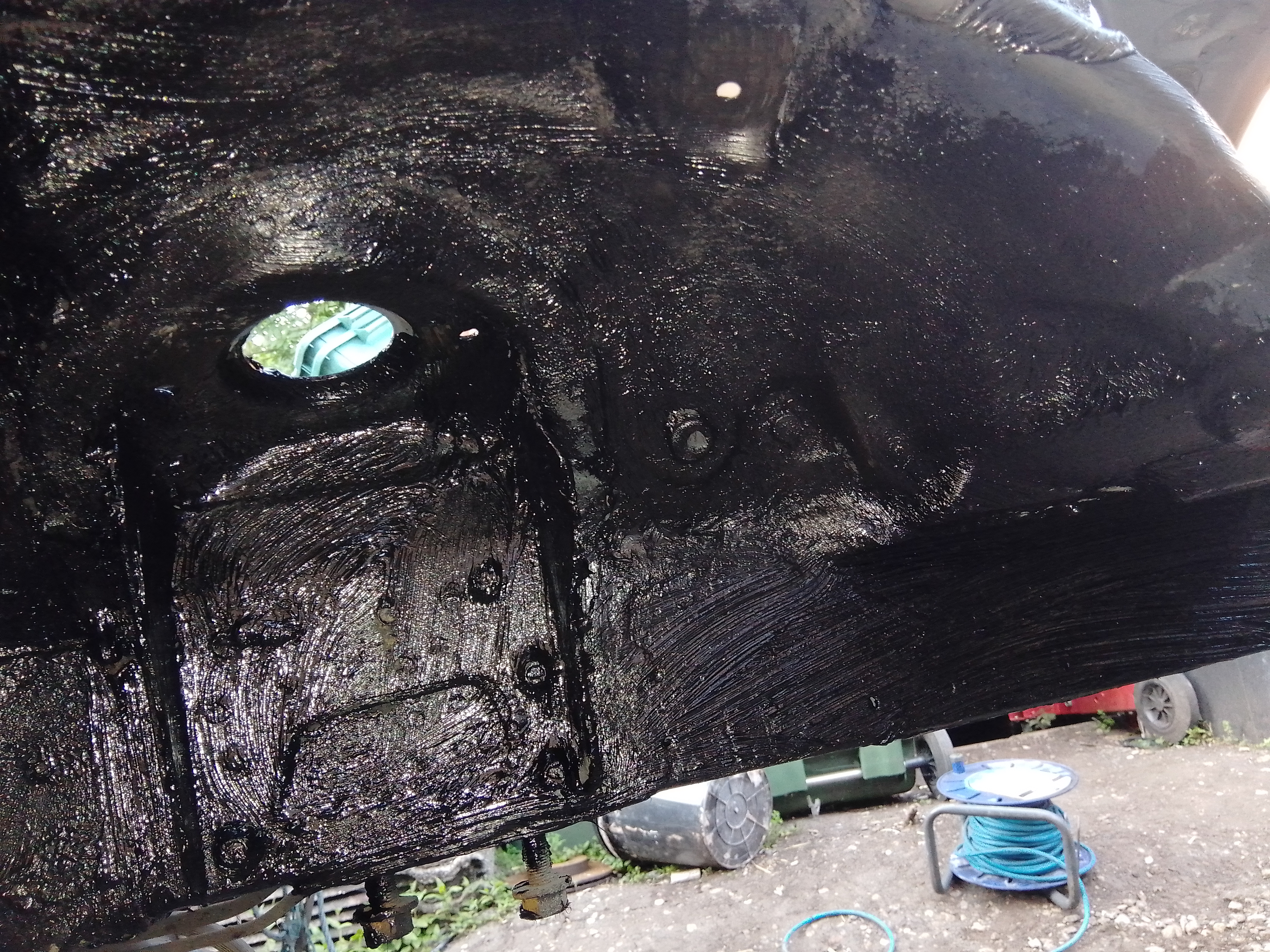

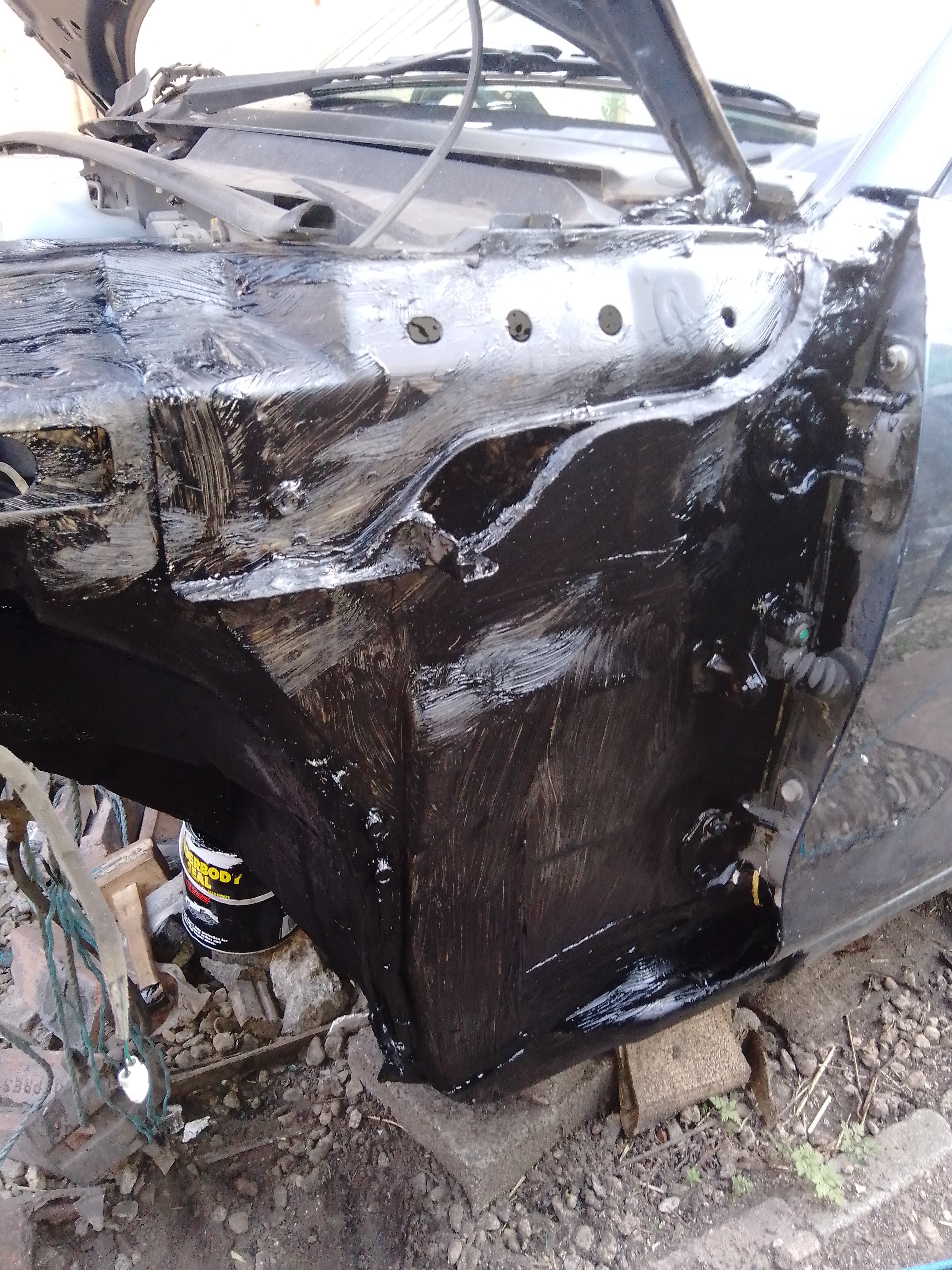

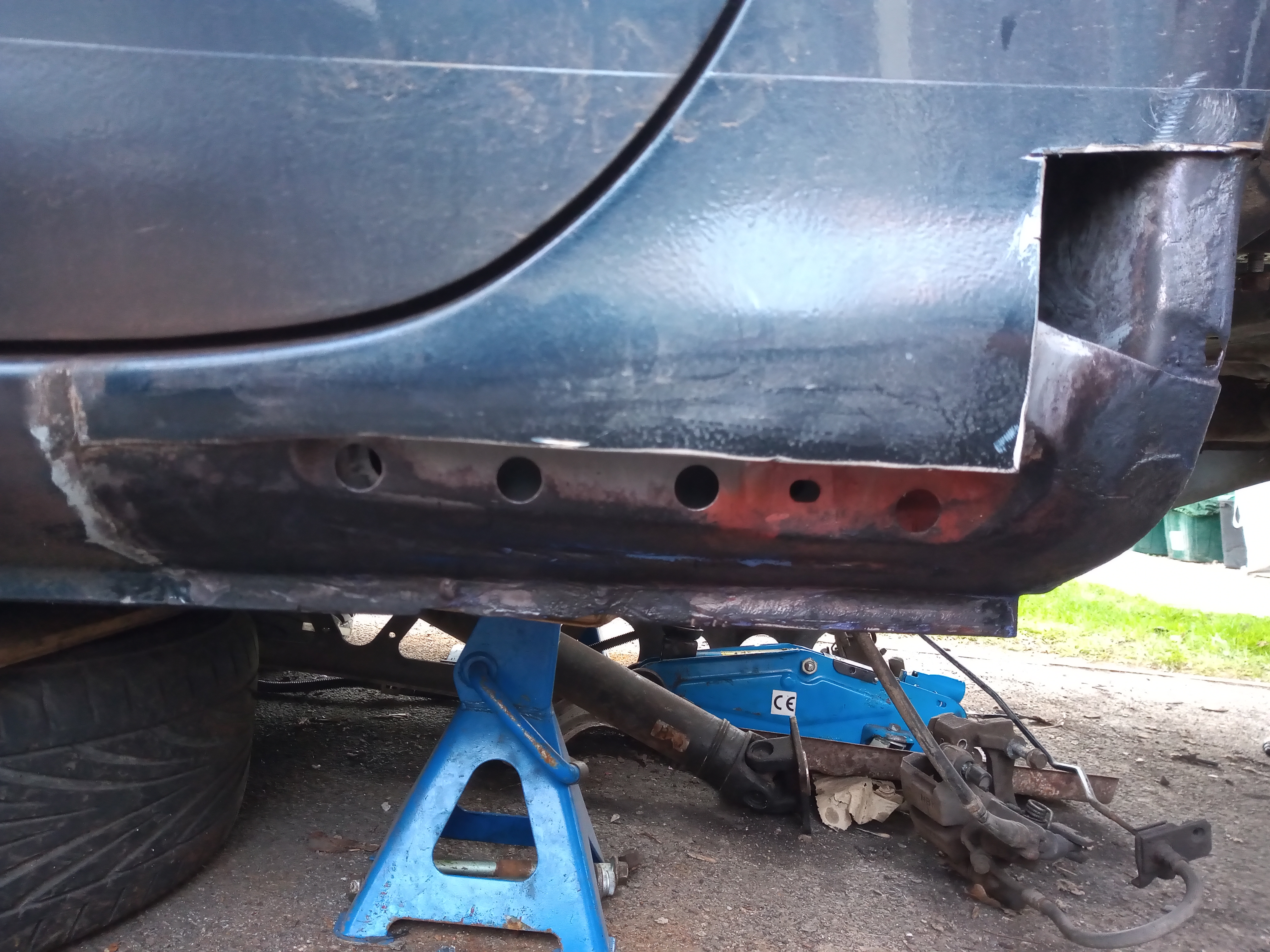

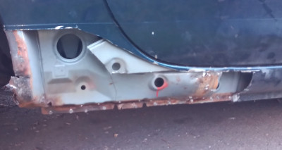

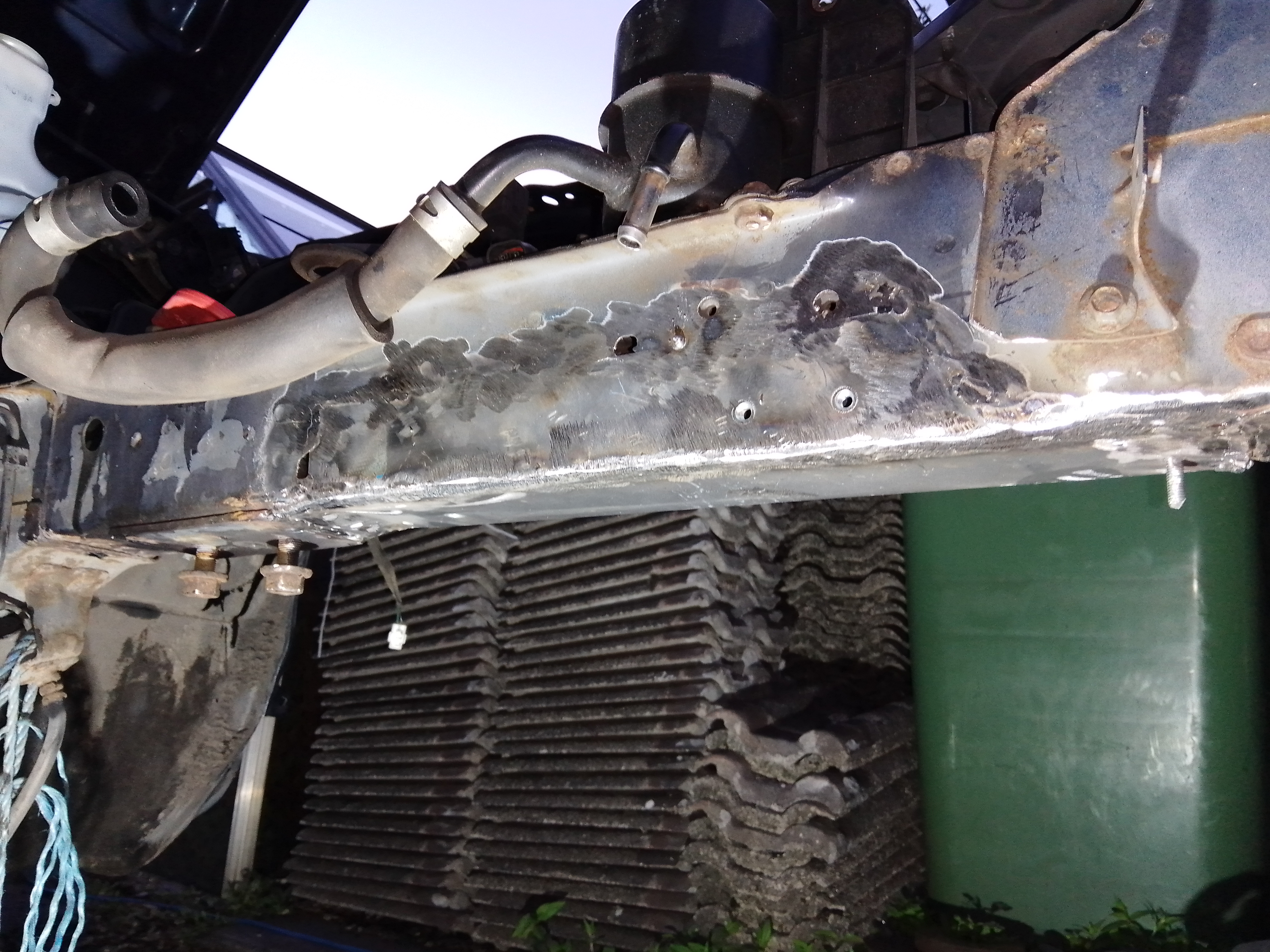

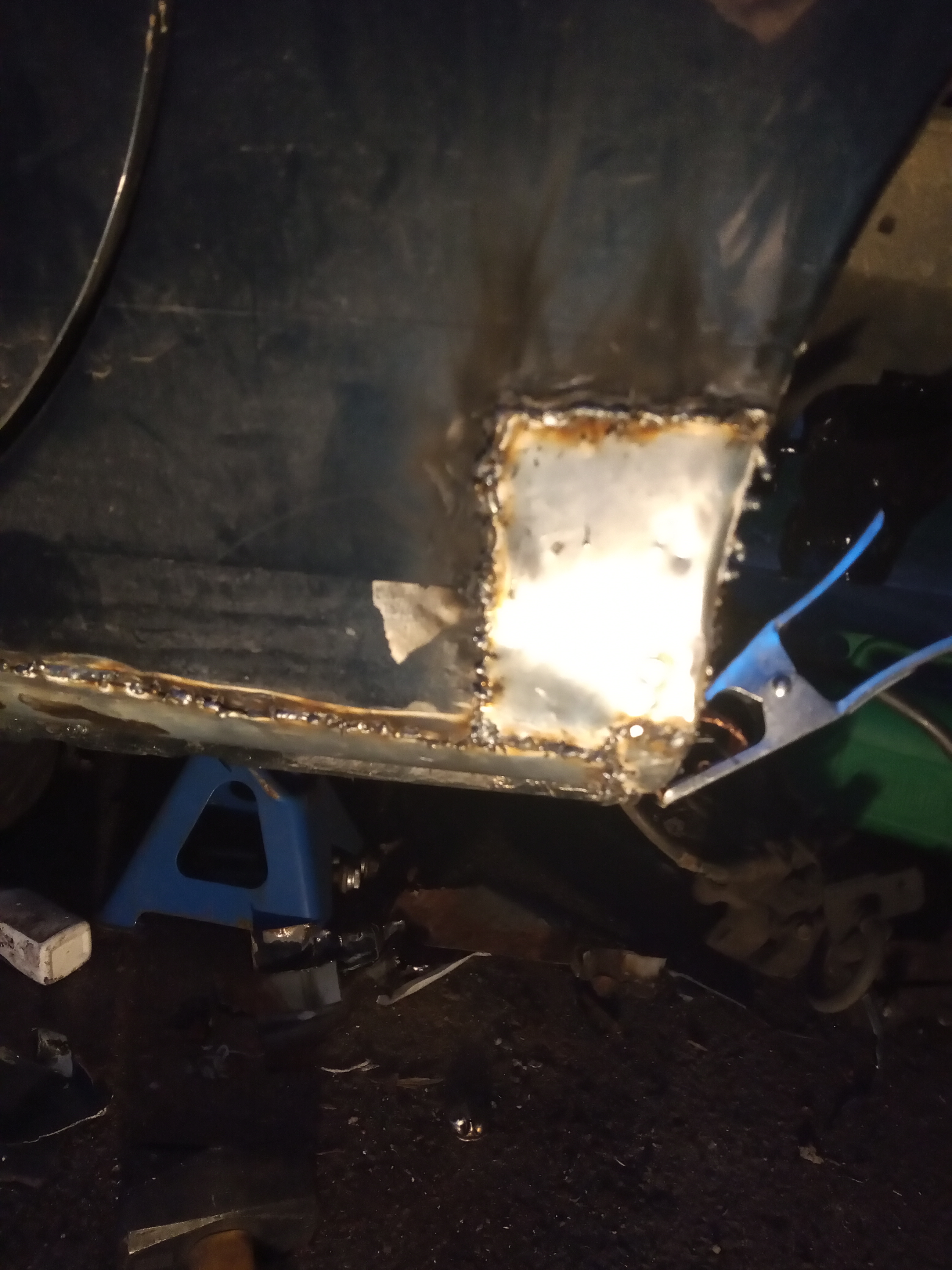

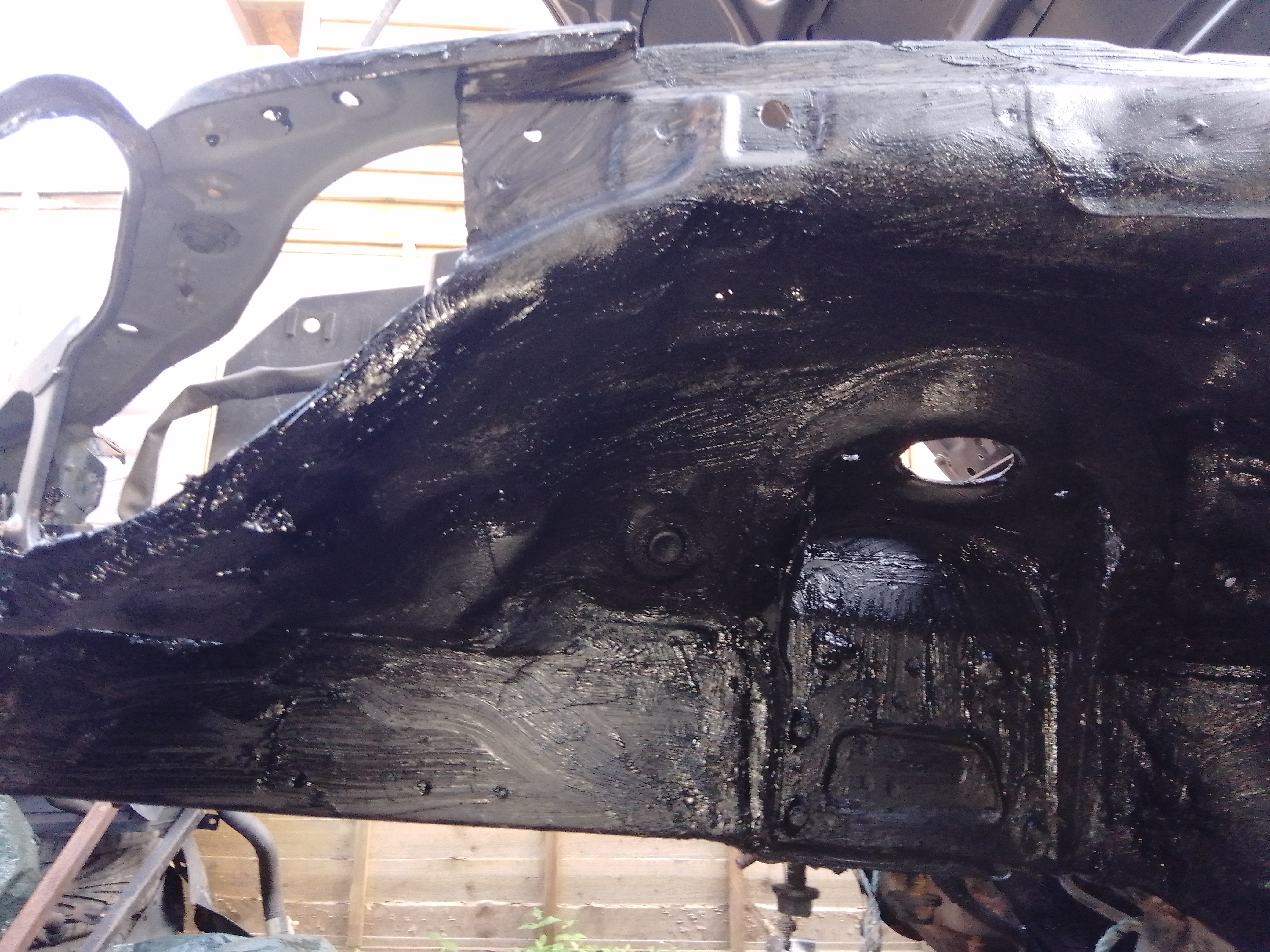

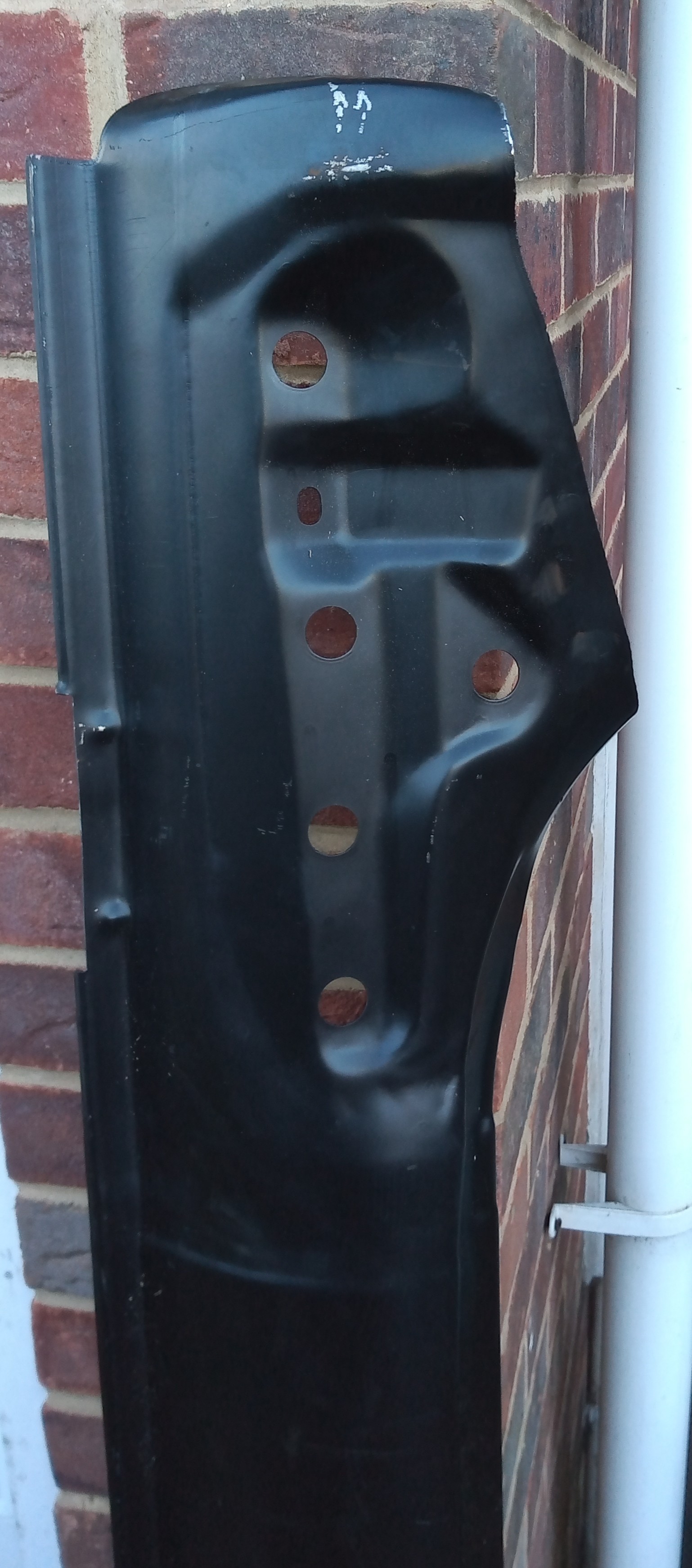

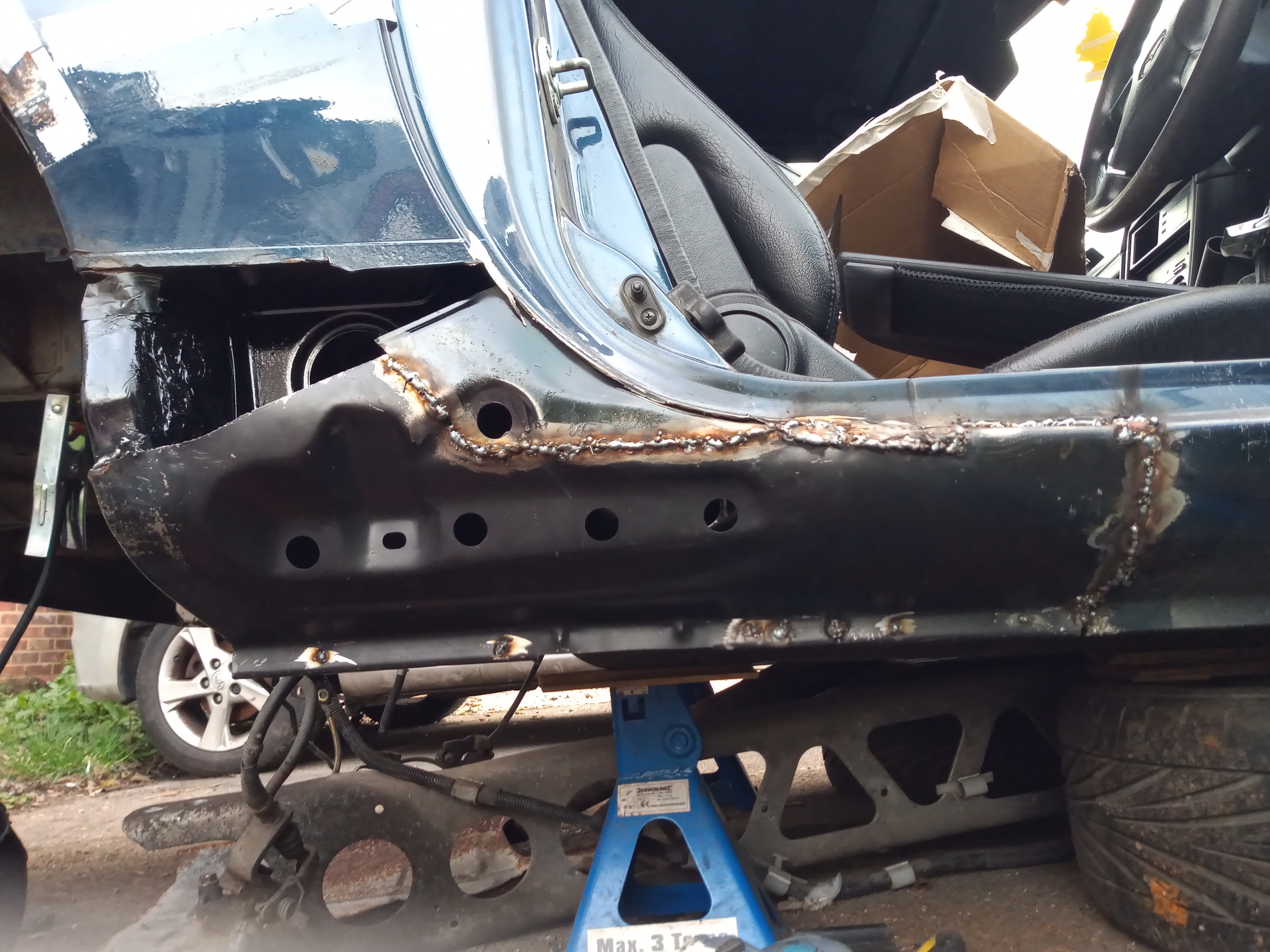

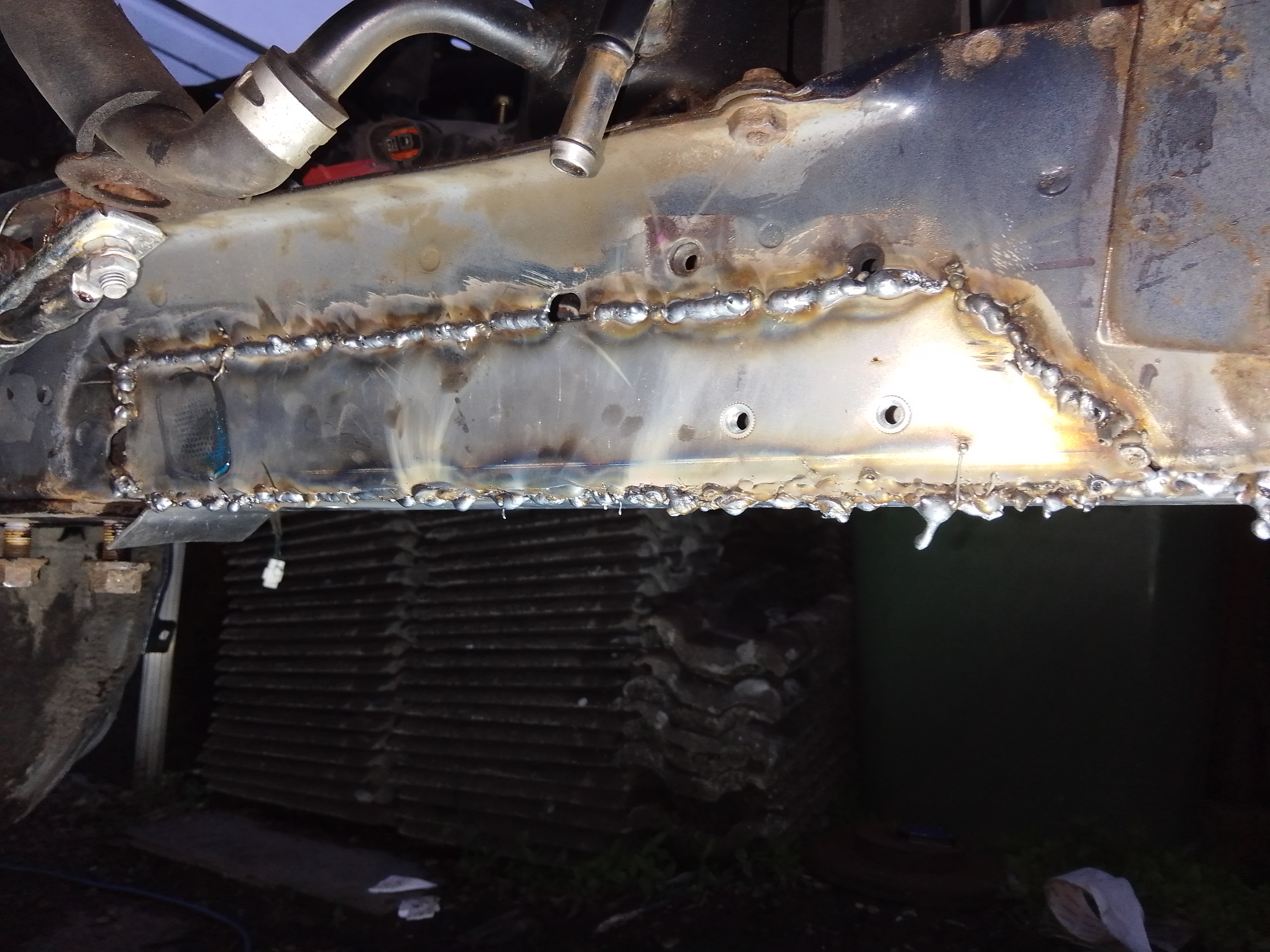

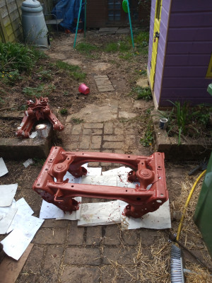

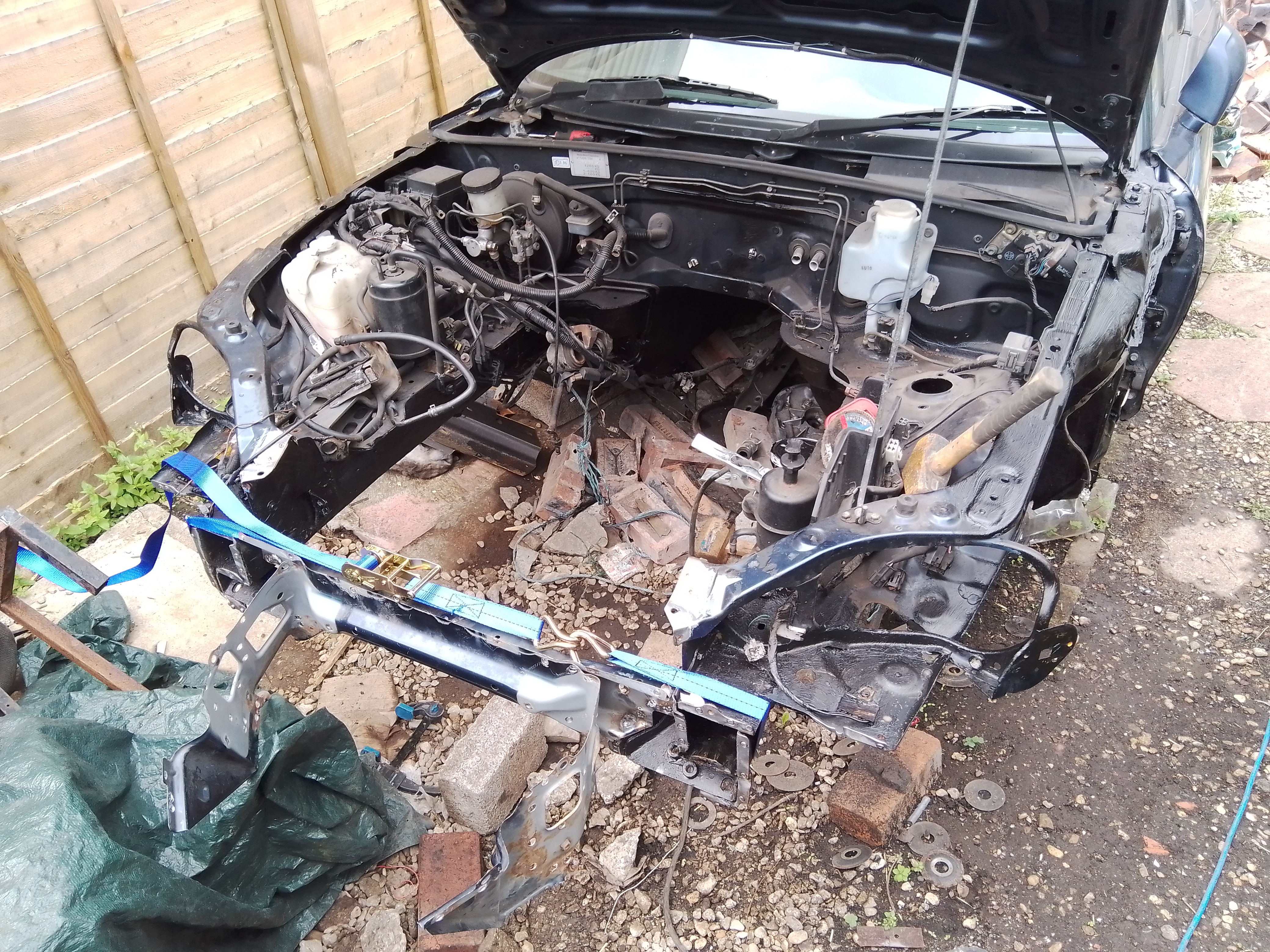

Sort of an update but not really very ev-ish at the moment.
I'm now starting to hate the word restoration part of the restomod!
Put the car in for its MOT just before Christmas, surprise surprise it failed, basically minor stuff end snapped on spring and a little rust on the sill (tiny hole).
Stopped for Christmas as that was Daddy daughter time with Disney
Do decided ok since I'm going to be going to all of the effort to ev convert it in the near future I am going to do this right.....it's amazing how far rust goes under the skin well am now completely back to good metal.
Have now got some gas again for the welding! (Current UK laws are very confusing on if buying welding gas is allowed).
Out with the old! In with the new (well not quite yet ) What is really good is that this is the first time rust repair has been done here on a 1999 mazda that's quite amazing!
Next is weld in new sill + repair panel for the forward part of arch.
Repair arch
Then probably going to drop the subframe to underseal the car (plus paint the subframe).
I am just glad this is the car I've always wanted otherwise this would be a pain!
Repair arch

Tom (de Bree)'s simp BMS instruction manual, you only need 12v to two pins, ground to one and then there are 2 can pins
https://github.com/Tom-evnut/SimpBMS
A teensy 3.2 and toms firmware and a can transceiver will get you BMS cell voltages and temps.Oh and you will need a bag of 120 ohm resistors!
(I will try and add a pics of it in the morning)

Re: Mazda Mx5 (MK2)
As promised ...
A teensy 3.6 in this case (just an advanced version of a 3.2) I have used a 3.2. Some quality shed wiring .... Simp BMS outputs bus serial yes it is cold! If you are interested the insides of the control board ... It will be nice if I can just use the output of this board for current measurement but if it is limited to 200amps as suggested by DIY electric car post I might need to swap it out for a bigger one ... Some Damian style testing on the weekend with a 12v battery maybe I have attached the mcp2562 datasheet so you can work out which pins to connect, note you have to pull the enable pin to ground

So you've done away with the main control board for controlling the precharge and main contactors and just using the inverter? Do you know if they have economisers built in?

I haven't decided firmly one way or the other yet, was favouring inverter control as less modes of failure.
unfortunately the contactors don't have economisers they draw 0.556amps. edit: just checked against gv242 (with economiser), that draws 0.160amps, so 3.5x more current can we live with 6.6w loss Vs 2 watts?

Re the contactor, as long as it doesn't burn it out without an economizer I can live without.
My control box looks different to yours so may contain different innards. Hopefully get to brave removing it tomorrow.

Might need to separate out the wiki pages for the Golf and Passat? My main control board looks different to yours.

Yes we might, for the time being shall we just have separate headers for golf & Passat? Or shall we get the pain of 2 pages over with now? Do your contactors look similar?
Silly note the control box is underneath the contactors on mine, the BMS is bolted on the side. Seems strange to have such different PCB designs, sort of paying for the same job twice.
Yes I'm not too worried about 6.6w of heat dissipation in a UK climate! As I expect the bus bars will act as good heatsink.
Edit Just saw your pics in the wiki, makes it even stranger they have 2 designs, I can only imagine that it was two competing projects and the management went with both!

OK, long time update....
well life as usual throws spanners in the works we basically moved house so i had to get the mx5 back on the road in ice form for when we moved house and i have been back on the de-rusting and am now at the stage where the motor is fitted well here are some pics from the past...oh shit nearly 2 years!
well here is the back end refurbishment (repainted rear sub frame and re bushed and under sealed the rear half of the car), new rear sills, and new arches (inner and outer) and this is what i got it just so i could move it for last summer when we moved.
My phone broke so i could not salvage all of the pictures from it

some more pics ... sadly i seem to have lost some pics of when i welded the new wings on and the sub frame after its painting

well that was up to spring 2021 so i had the summer to be a naughty boy and enjoy using it as the sale of our house went through.
Well moved in in September 2021 I have alot of house work to do, so far I have:
(1) redecorated the bathroom (completely ripping out everything and repositioning waste pipes etc. it had BROWN toilet sink, showers and tiles, so everything was replaced)
(2) removed an unsupported chimney breast in master bedroom with giant steel beam (builders wanted silly money to install rsj, so did it myself)
(3) redecorated 3! bedrooms (including re plastering and new ceiling due to removal of chimney)
(4) oversaw getting the house re-wired as the house didn't have an earth wire and had numerous mystery wires in walls (including a live one in the bathroom wall)
(5) Organising wetting the house re-plumbed as the boiler was in my daughters bedroom so needed to be moved/replaced, then found out the central heating needed re-plumbing as it was a 1 pipe system, which ment all radiators were in series!!)
(6) now started redecorating kitchen (completely ripped out as it was pure 70's bright orange!)
Whilst all of the above has been going on i have been shoe-honing more restoration and getting the motor in!
as you can see front chassis rails have had it !!

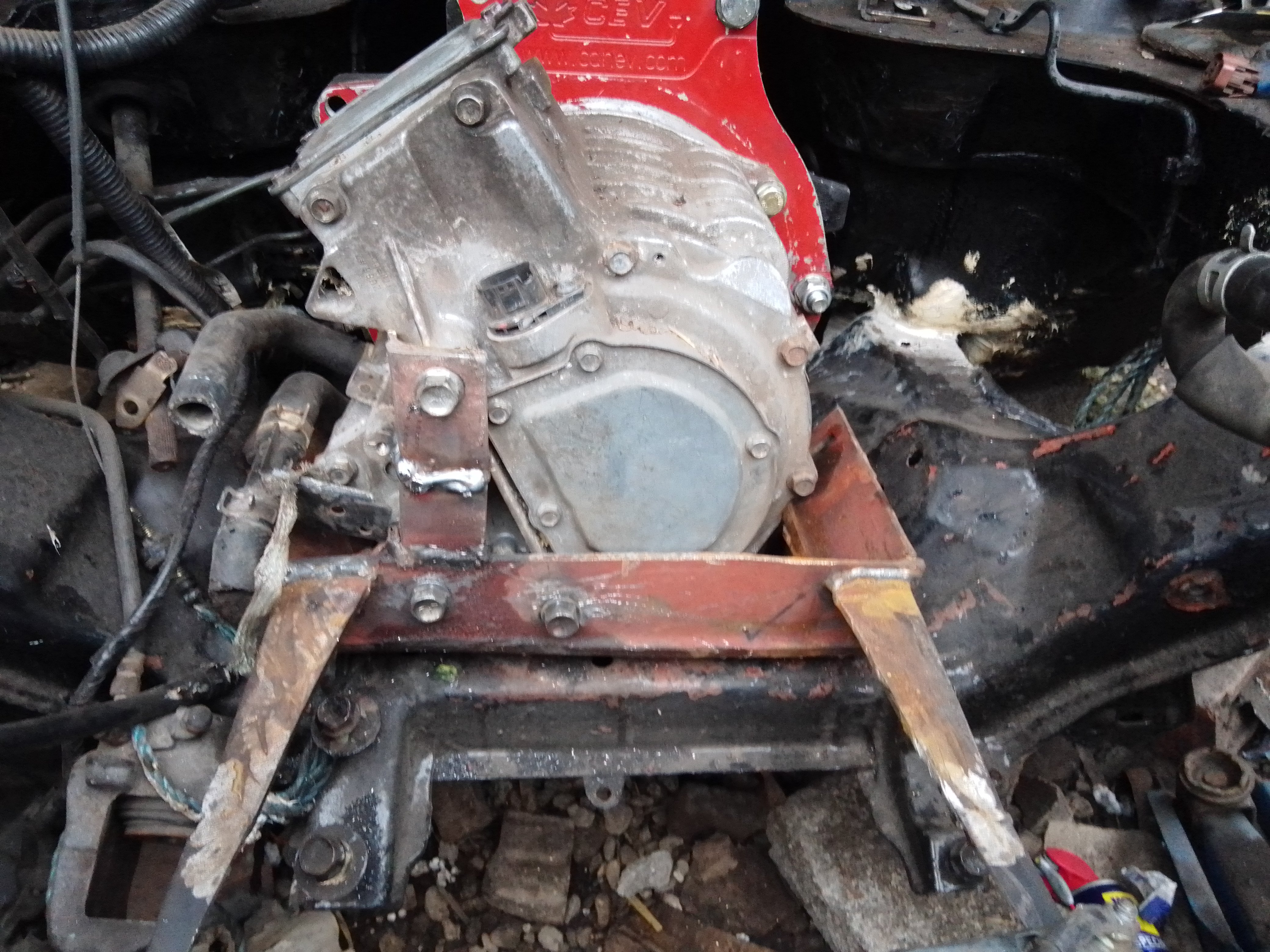

Re: Mazda Mx5 (MK2)

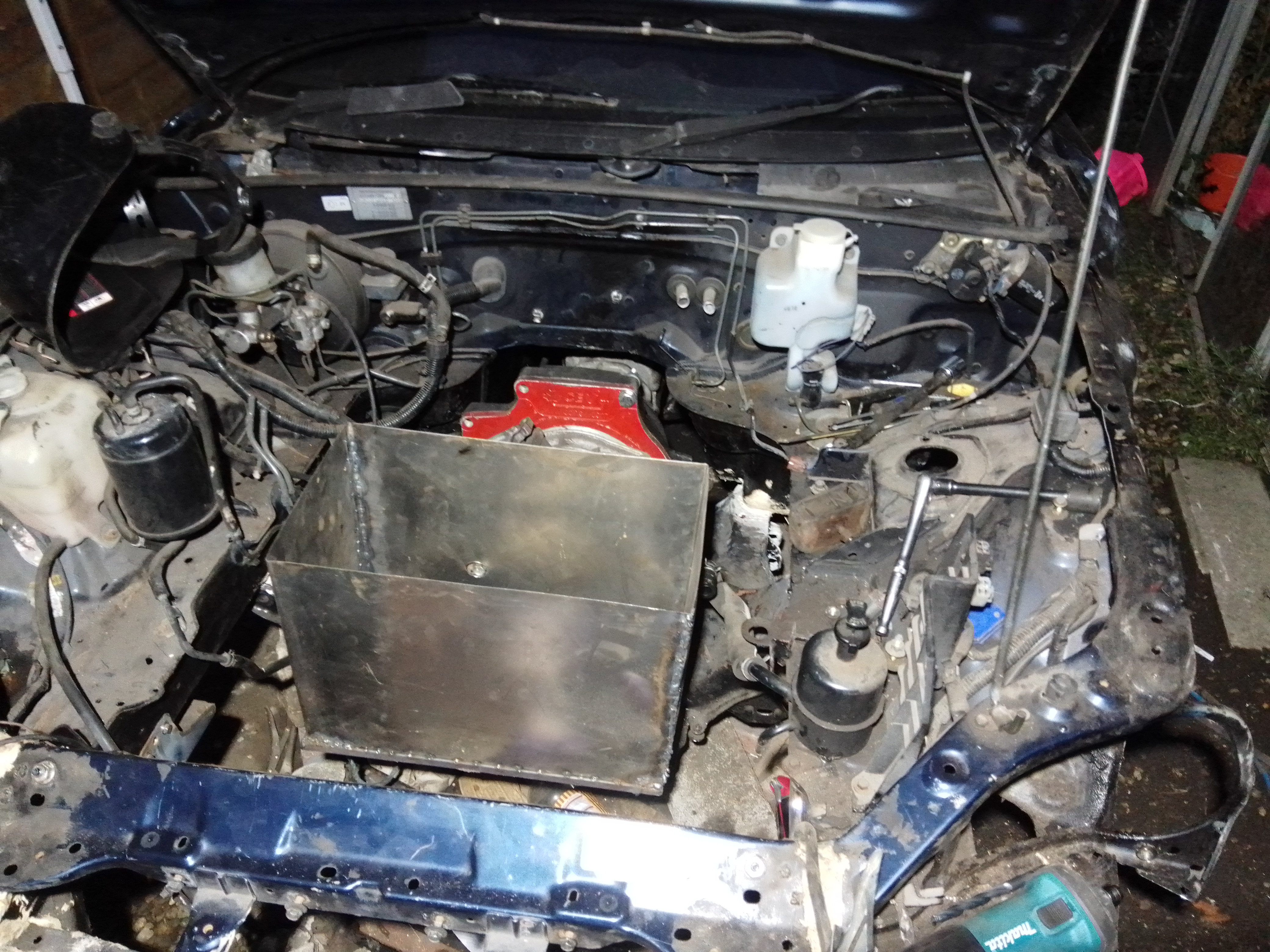

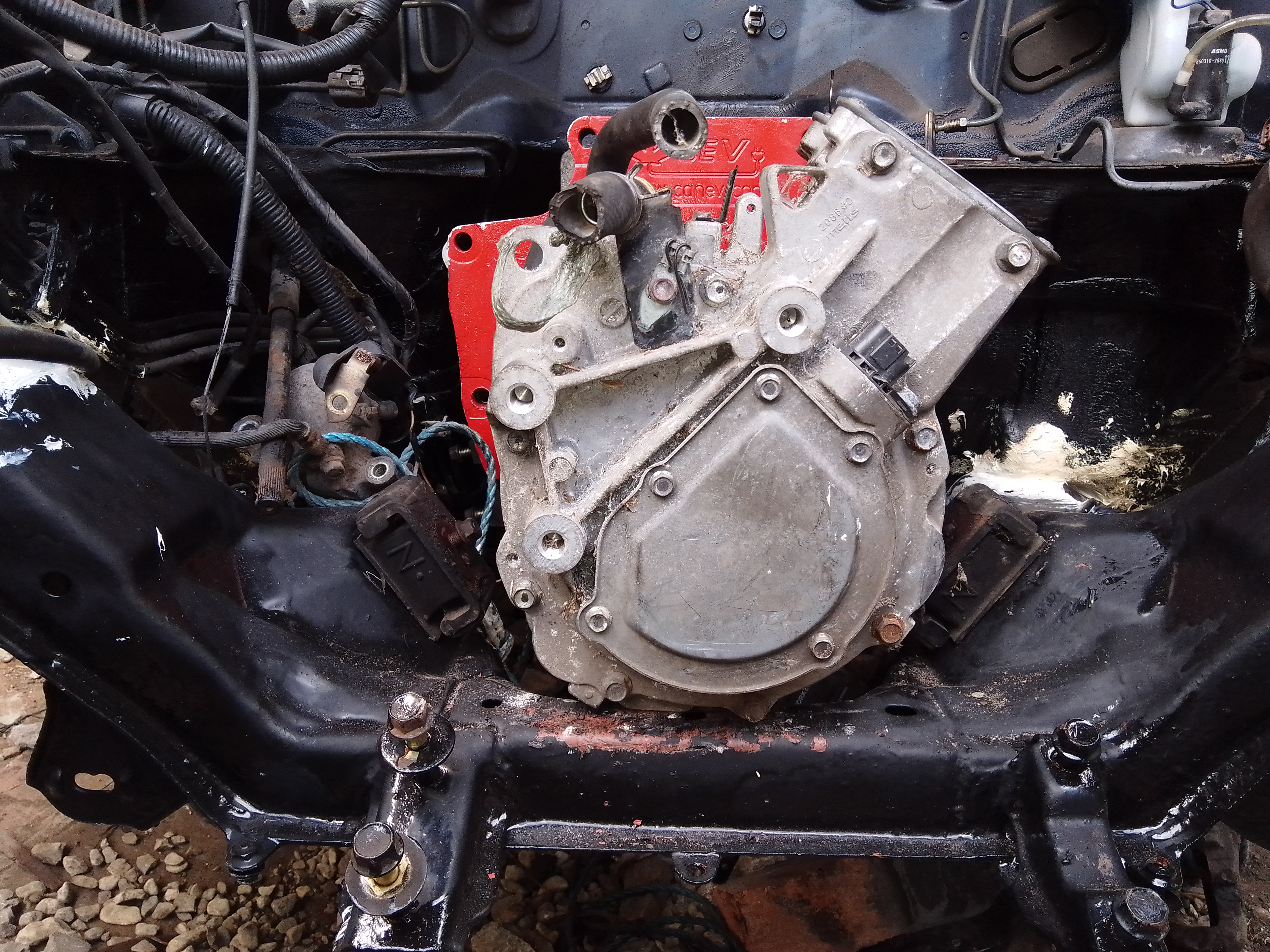

some more pics... plus an early mock up...

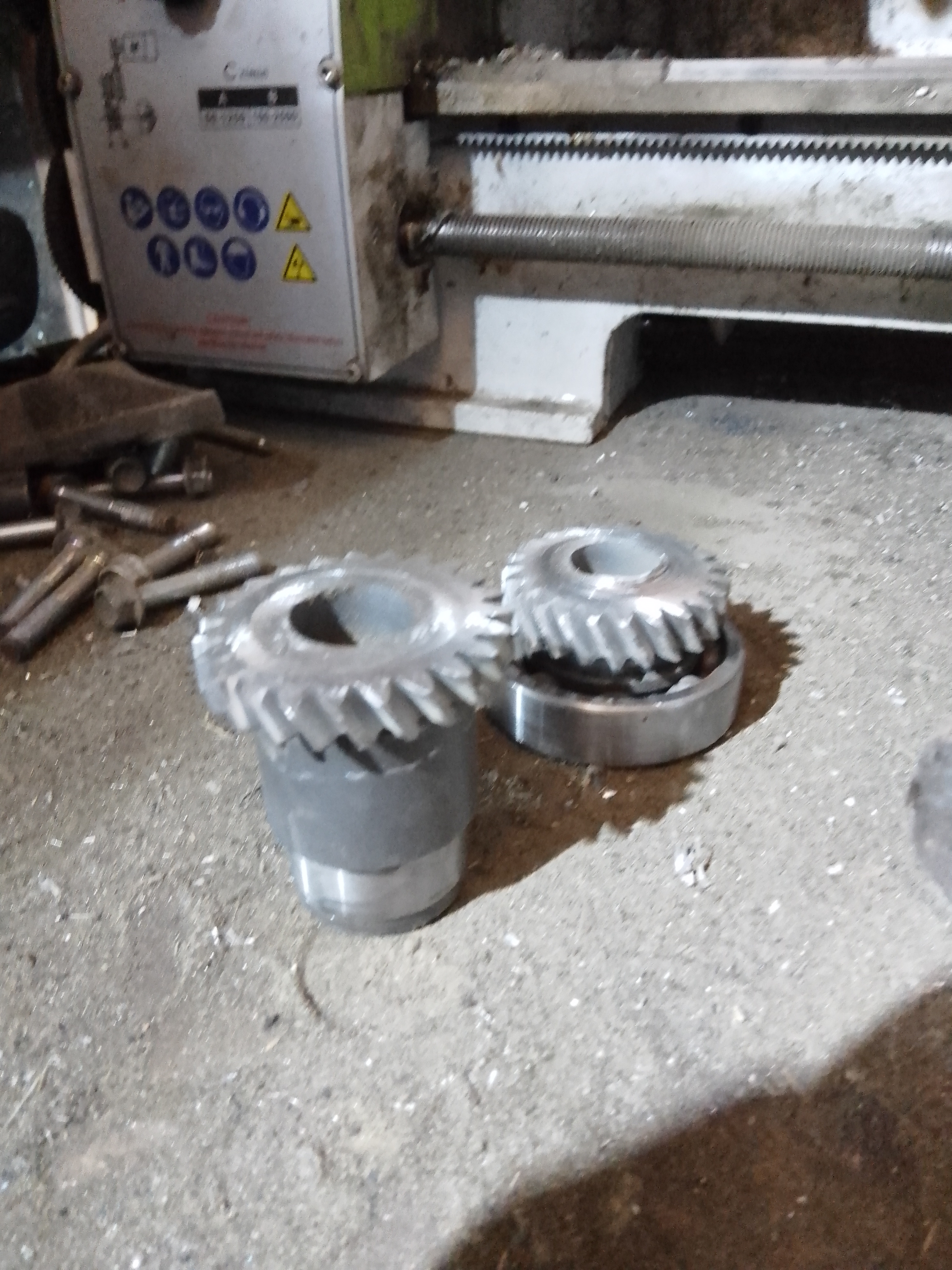

now for the good stuff ...
