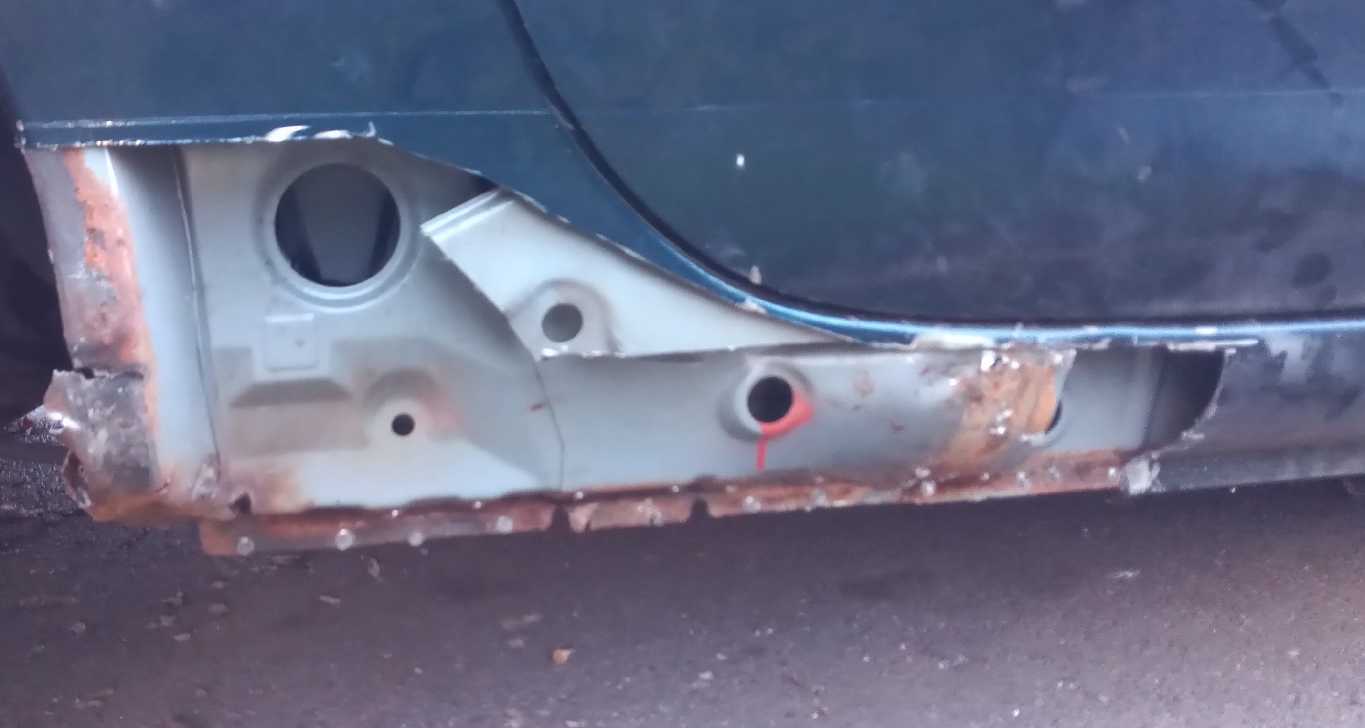

Put the car in for its MOT just before Christmas, surprise surprise it failed, basically minor stuff end snapped on spring and a little rust on the sill (tiny hole).
Stopped for Christmas as that was Daddy daughter time with Disney :)
Do decided ok since I'm going to be going to all of the effort to ev convert it in the near future I am going to do this right.....it's amazing how far rust goes under the skin well am now completely back to good metal.
Have now got some gas again for the welding! (Current UK laws are very confusing on if buying welding gas is allowed).
Out with the old!
In with the new (well not quite yet :))
What is really good is that this is the first time rust repair has been done here on a 1999 mazda that's quite amazing!
Next is weld in new sill + repair panel for the forward part of arch.
Repair arch
Then probably going to drop the subframe to underseal the car (plus paint the subframe).
I am just glad this is the car I've always wanted otherwise this would be a pain!

Whilst all of the above has been going on i have been shoe-honing more restoration and getting the motor in!
as you can see front chassis
rails have had it !!
