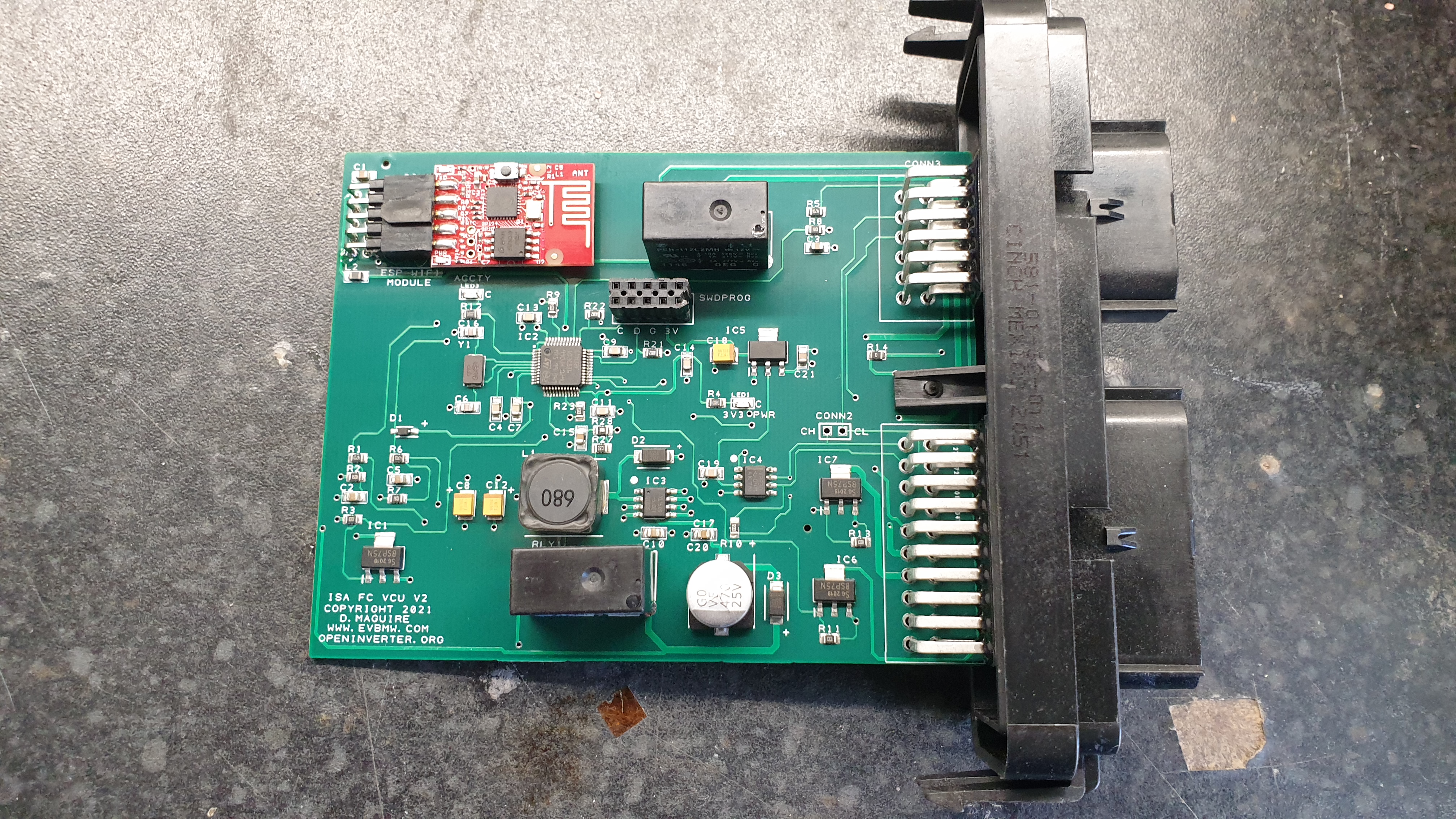

- Posts: 3563
- Been thanked: 87 times
Schematic for stm32 version. Farirly simple from a hardware point of view. Pin compatible with the sam3 version. Now to go rip off Johannes stm32car....again ....
- Chademo_VCU_V2_ISA - Schematic.pdf
- (154.36 KiB) Downloaded 184 times
- Posts: 656
Sounds like a plan. I can't do the same for STM32 that I did for the SAM3X, don't know bare C well at all.
Good luck!
Good luck!

I've found a flow diagram to follow https://www.evcreate.nl/chademo-fast-charging-in-diy/

- Posts: 3563
Boards have arrived. Now time for some software...
- Posts: 1595
- Has thanked: 75 times
- Been thanked: 304 times
Check my repo above, not tested it beyond sticking it on a bluepill but I don't think it's a million miles off. Still want to move some of the ISA shunt values to OI values for viewing in the web interface. Happy to make any other changes it might require.

- Posts: 3563
Yep thanks tried that out yesterday. I think something is broken in libopeninv or the bootloader as I can't get it to even flash an led. Same with other projects. Johannes is investigating.
