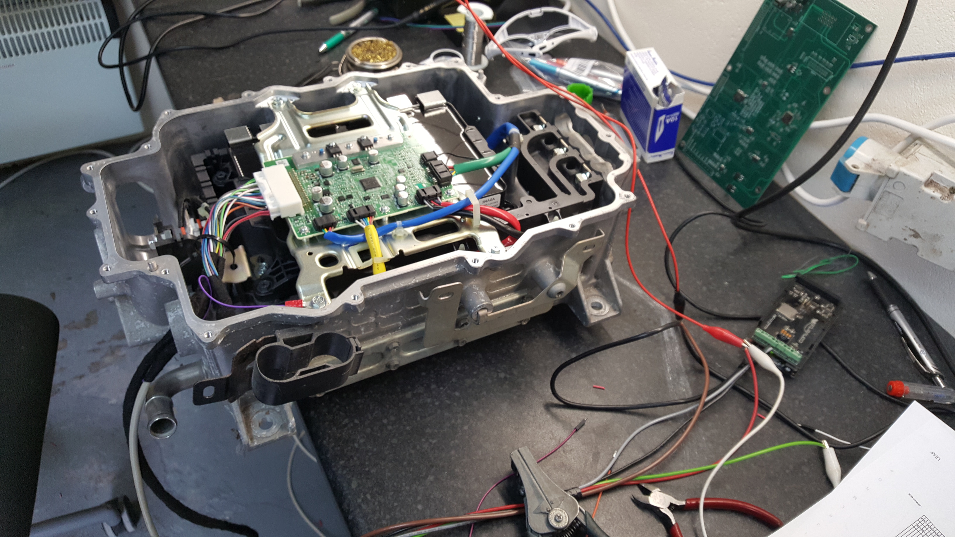

Today I tried to do this operation myself on my Gen1 inverter. I have previously tested out the Arduino and CAN-comunication with a Gen2 inverter and everything worked like expected. When I now do the same operation won't the motor turn on my Gen1, what I think might be broken on my Gen1 is the voltage sense component because I read 255 on byte 1 in CAN-message 1DA. What voltage measurement do you get Kevin when you read out that message from your inverter?
Anyone who has experience with broken voltage sense components on inverters? 😉
Robin Guldmyr
MR Electronics AB
Posts: 4000
Been thanked: 1115 times
Re: Leaf Gen 1 Inverter Board
Started testing. I get 372v on 1DA when hv is applied which is correct. Think I have screwed up the resolver wiring as getting 16krpm and -24f motor temp:)

In other news all the wiring diagrams for the gen 1 resolver connector on the motor that I have are wrong. Correct pinout :
1-2: Temp sensor. 20k at approx 20c ambient
3-8: 17R. Exciter
6-7: 37R. Sin/Cos
4-5 : 37R. Sin/Cos

I know the wiring I attached are as correct it can be, the problem is how Nissan show the terminals on the pictures of the connectors, they are seen from the connecting side of the connectors so a little confusing when you try to filter out the correct colours and pins ;) the last problem is that Nissan changes colour on the wires from connector F13 and CN2 and the pin numbers :)

Doing a double post here as well as on the E46 build thread. Had some good progress getting the Gen 1 leaf inverter responding to CAN. Big thanks to celeron55 for all his help and hard work. I have setup a Github repo for an open source controller project:
https://github.com/damienmaguire/Nissan ... Controller
As of now I can start the inverter and command torque in one direction only so still need to work out a bit of the can messaging. As always any help much appreciated. Here is a video of the first run :

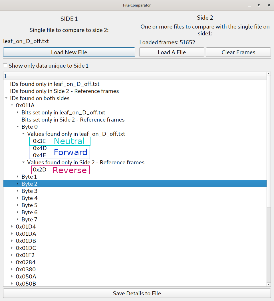

Try sending these values on the first byte in message 0x11A to the inverter. The data is from your CAN-logs.

Some new Leaf logs uploaded : https://github.com/damienmaguire/LeafLo ... aster/2019
Same 2011 car as before.
0x1d4 byte 6 seems to have an active role.
0x00 when in park and brake released.
0x20 when brake lightly pressed in park.
0x30 when brake heavilly pressed in park.
Changes when driving, braking and regening.

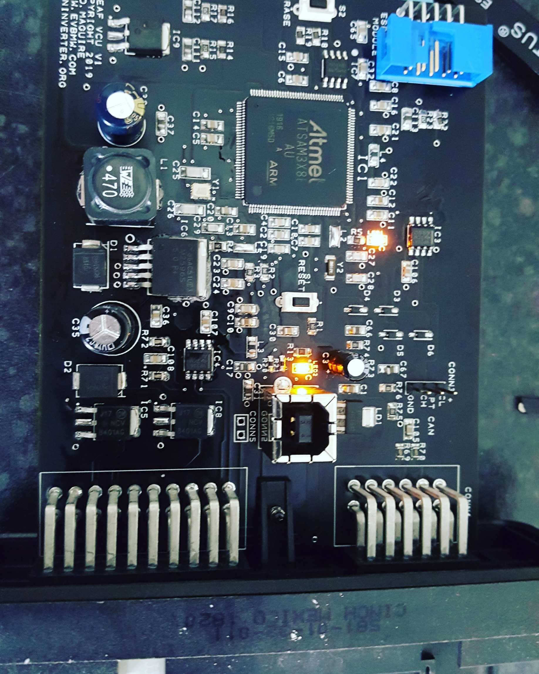

Controller up and running on the bench:)

This looks super clean. Is the intent to keep this CAN based for commands or will this have analog inputs for throttle/brake/direction?

So good news is we can now command positive and negative torque and regen the motor in both directions.
Posts: 4000
0x1d4 byte 6 needs to be 0x30 before the inverter will accept a positive torque command. Updated the software on github for running on the open source vcu. All I need to do now is get it to read the throttle pedal and send torque commands that way.
