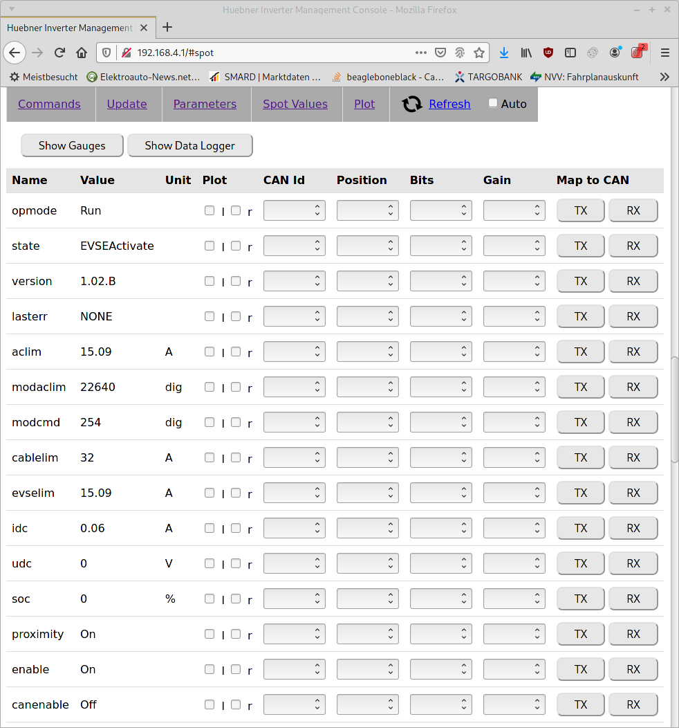

I have developed an openinverter-style firmware for the Gen2 Tesla charger, more specifically the boards with STM32 processor like V5aB2.
UPDATE:
Manual in the wiki: https://openinverter.org/wiki/GEN2
Download link: https://openinverter.org/files/stm32_charger.zip
Shop link: https://openinverter.org/shop/index.php ... duct_id=67
UPDATE2:
the firmware will be published as open source soon. If you want to grab it earlier jump on to patreon: https://www.patreon.com/openinverter
I have annoyed Damien by sending him outside in the freezing cold to test it in his BMW :P It works.
More specifically it features
  • All features of the original firmware
  • openinverter parameter handling via web interface
  • openinverter spot value handling via web interface
  • Over The Air update via bin file
  • Plotting and logging
  • DC current set point
  • external CAN control
External CAN control requires routing to internal CAN bus onto the external header as shown on the picture. It has quite a few IDs on it so check for collisions with your existing CAN infrastructure before doing this.
I have mapped out CHAdeMO so it will accept like this
#0x102 - 8 - 0 udclimh udcliml idcspnt 0 canenable soc 0
Sending SoC will allow implementing a SoC limit in the charger and might be handy for just displaying it.
It will also generate the 108 and 109 message CHAdeMO style.

So, getting close to releasing. Jack Bauer will do one more test, then the firmware will become available for download. It works like this
- If you buy fully assembled boards from Damien, you will get a fully working board
- If you make your own board from JLCPCB the firmware will allow 5 minutes of charging and then stop
- You then go to the shop, specify the serial number(s) of your board(s) and buy as many pins as you need. You will receive the pin for each board, enter it via the web interface and will have unlimited charging thereafter.
- Patreons who have been supporting me longer than 6 months will get a free pin per $5. More details will be published there soon
Now, I'm looking for 5 volunteers who will go through the registration process and test the charger in their setup in exchange for a free pin.
Ideally I would like to test 5 different setups
- 1 phase wall outlet in the US
- 3 phase wall outlet (EU)
- 1 phase EVSE
- 3 phase EVSE
- Charger as CHAdeMO EVSE
If you're interested please describe your setup here.

Let the testing begin :)
Damien reports the current drop issue is FIXED!
Please follow this manual to install, register and run the software: https://openinverter.org/wiki/GEN2#Comm ... age_manual
Well, instead of going via the web shop send me your serial number via private message.
Report any problems that you run into. Except one: "my charger only runs for 5 minutes" !!

jon volk wrote: Mon Jan 11, 2021 6:51 pm So, inquiring minds want to know. Where was issue in drop?
Basically the STM32 has a 3 message CAN send FIFO. So if your code is like
can_send();
can_send();
can_send();
can_send();
Then the last message will be dropped. To get around this you have to implement a software FIFO that stores the excess messages until the hardware FIFO is free again and then sends them out. That's exactly what the CAN module in libopeninv does and that is why building your software on top of stm32-template is super king :D
