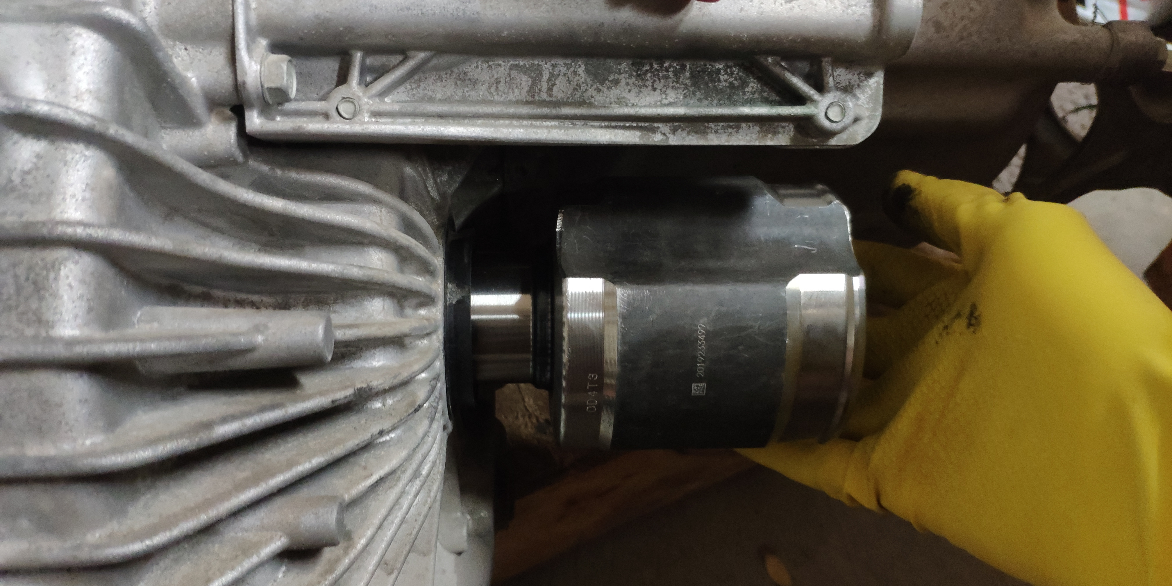

This is the first time I'm working with these.
So I've got these blanks meant for the SDU. See attached. Is this how far they're meant to go? I cannot put them any farther, but to me it looks like they should. There's a ring on them which is what seems to prevent them from going in farther.
Posts: 2963
Has thanked: 330 times
Been thanked: 848 times
Re: Tesla SDU Knocking\Clunking Noise
Take the clip off, it will lock it in place no need for that right now.

Actually the noise went away after inserting the stumps!
I'll mark it solved. At least for now.
