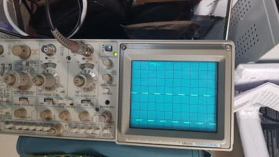

Hi There.
I have a rev2 pcb built and all functionality looks fine. The web interface all works as advertised now thanks to a new STM32 module that I replaced.
I still measure no PWM on any of the gate inputs. I do get a 5V Vcc and a 3.3V where one of the PWM signals should be displayed. The 3.3v is displayed immediately when I start the inverter ( Start 2 ) and stops immediately when halt the inverter. The other PWM signal looks like ground. ?
I have ordered some new components for the main board but I don't have them yet. Thank God I socketed them initially.
Anyone got any ideas ( Brilliant or silly will be appreciated )

Why are all your digital inputs high? Forward=Reverse means neutral, as displayed by "dir". Neutral means no PWM.
Check if RN2 is mounted the right way around -> dot on resistor net pointing towards PWM header

Hey Johannes.
Consider yourself a legend (in my book anyway). The Resistor network RN2 was reversed. The really annoying thing about this is that I checked all components except the ones I thought weren't necessary, for dry joints and shorts etc at least three times. After swapping this around I powered up and did nothing else. It even now shows FORWARDS in the spot values. I will award myself a serious flogging.
You on the other hand are now officially entitled to loan of my bike and free pass to a pub of your choice, if ever come to Ireland.
Thank you again. I can now continue onward and upwards.
