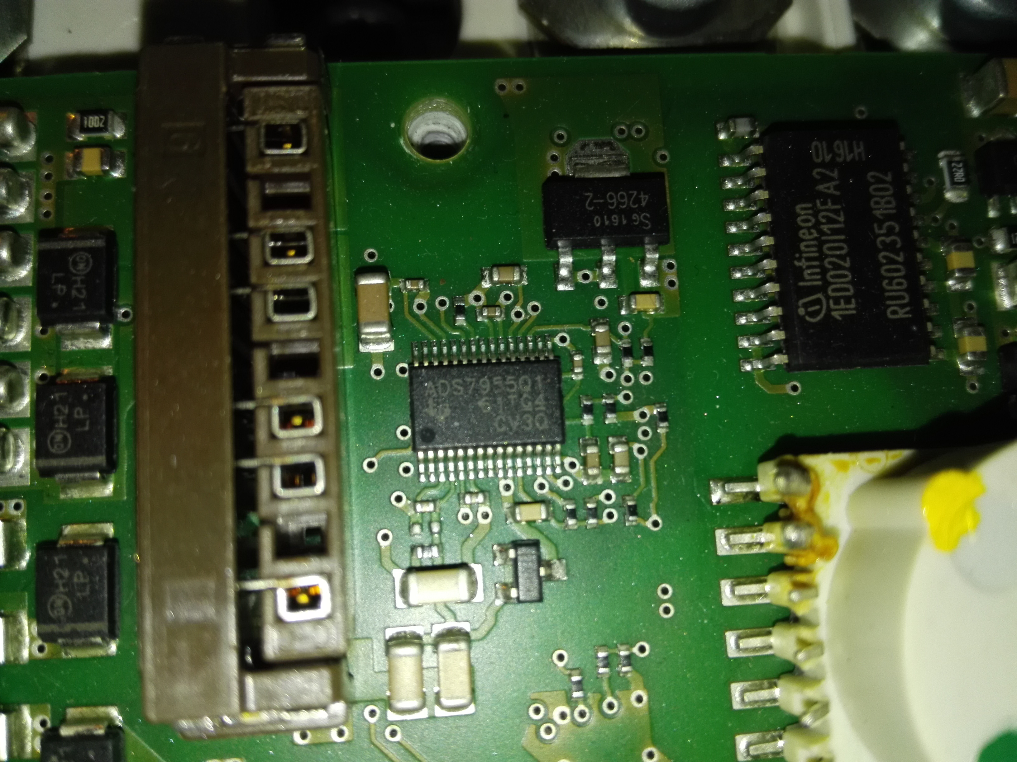

Got my inverter today and started the teardown :D
got to the IGBT board and started probing the lines, figured out a few more pins. the IGBT has 3 temp sensors but couldnt seem to find where that signal leads to.
looking at the connector on the board looks like
https://www.mouser.co.uk/ProductDetail/ ... YDcw%3D%3D
still need to give it a proper measure but hopefully its correct
Pin No I/O Description Notes

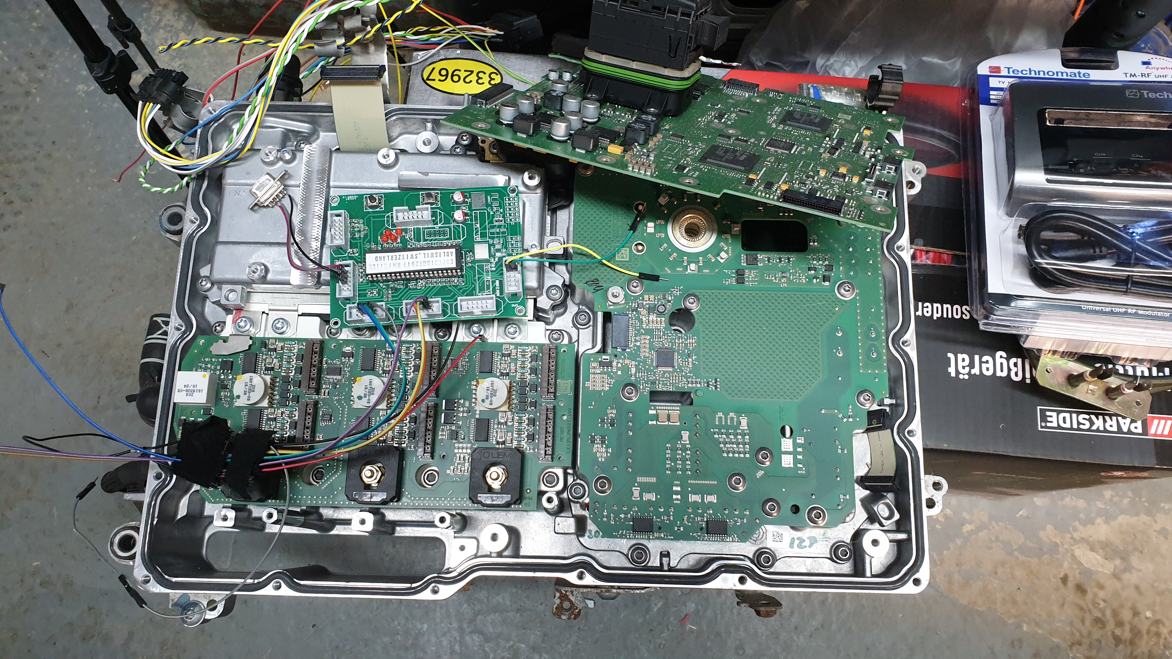

Got mail from Damien :)
With the existing notes and the jumper cables he sent along it took me 10 minutes to fire up the inverter.
It draws 2.3W from the 32V line in idle and 10.7W when running at 8.8 kHz. 5V for openinverter board and BMW logic are provided by my USB hub, so apparently not much draw there.
Despite this being the same power module as in the Leaf 3 inverter (Infineon FS800R07) the deadtime requirement seems much lower. When run with 800 ns it draws 70 mA from 50V and with 2.5us it draws 66 mA. Will investigate further, maybe they use smaller gate resistors. There is certainly no electronic dead time guard, because setting deadtime 0 sends the lab supply into current limit.
The openinverter board almost bolts onto the 4 screw holes on the capacitor cover :) According to Damien the cover is pretty bulky so there should be enough room for an adapter board and a mainboard on top.

Now, I tried to find a nice analog bus voltage and temperature signal. Not so, they chose to digitally isolate in form of a ADS7955 ADC and ISO7241 digital isolator. Bus voltage sensing itself is 1V/100V resistor chain.
So now I can attempt to use it or just put some analog isolator on the adapter board.
Posts: 5810
Has thanked: 162 times
Been thanked: 1039 times
Re: i3 controller hacking from diyelectriccar.com
So UDC is on CH5 and 3 temperatures are on channels CH0-CH2
Using the ADC is pretty simple, It is just sent 16 bits with instructions and returns the value resulting from the second-to-last instruction. I could just resort to bit-banging SPI via udc/tmphs and some general output pin. Or I could place an attiny or something on the adapter board to convert the digital data stream back to analog.

There is also another isolator coupled to some mystery ST chip (it says 78387).
Posts: 3563
Been thanked: 87 times
Nice find. Obviously this is why they needed the tricore mcu:)
edit: my mistake, it has 2 tricore mcus.
