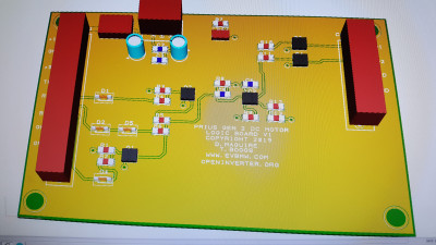

Having seen so may people struggling with putting together the hardware and power electronics for a DC motor controller I decided to whip up a simple board to utilise the cheap and plentiful Gen 2 Prius inverter as the power stage for a DC motor controller. You get the added bonus of a DC DC converter built in and possibilty of using the boost converter for battery charging at some future stage.
https://github.com/damienmaguire/Prius- ... Controller
I'll post up a video tutorial as soon as the boards arrive.

My white arrow is in need of this board. Will we be able to use mg1 in parallel with mg2? Will I need two of these boards or can I split the pwm output to both inverters? Mg2 maxes out with 370 amps and mg1 maxes out with about 230 amps to the one DC motor. Total 600 amps. I'm going to worry about breaking the 318i drive train.
Waiting for the boards and dc tutorial.
Thanks Damien

Oops, I see on the schematic there are pwm outs for mg1 and mg2, so one board! Can't wait, ordering parts today.

On this subject I have redesigned this board to utilise JLCPCB parts and have a bunch of ten on the way fully populated bar the screw connector. Once received I will do a video showing how it all wires up.
Posts: 3563
Been thanked: 87 times
Re: Prius Gen2 Inverter DC Motor Controller
As if by magic:)
