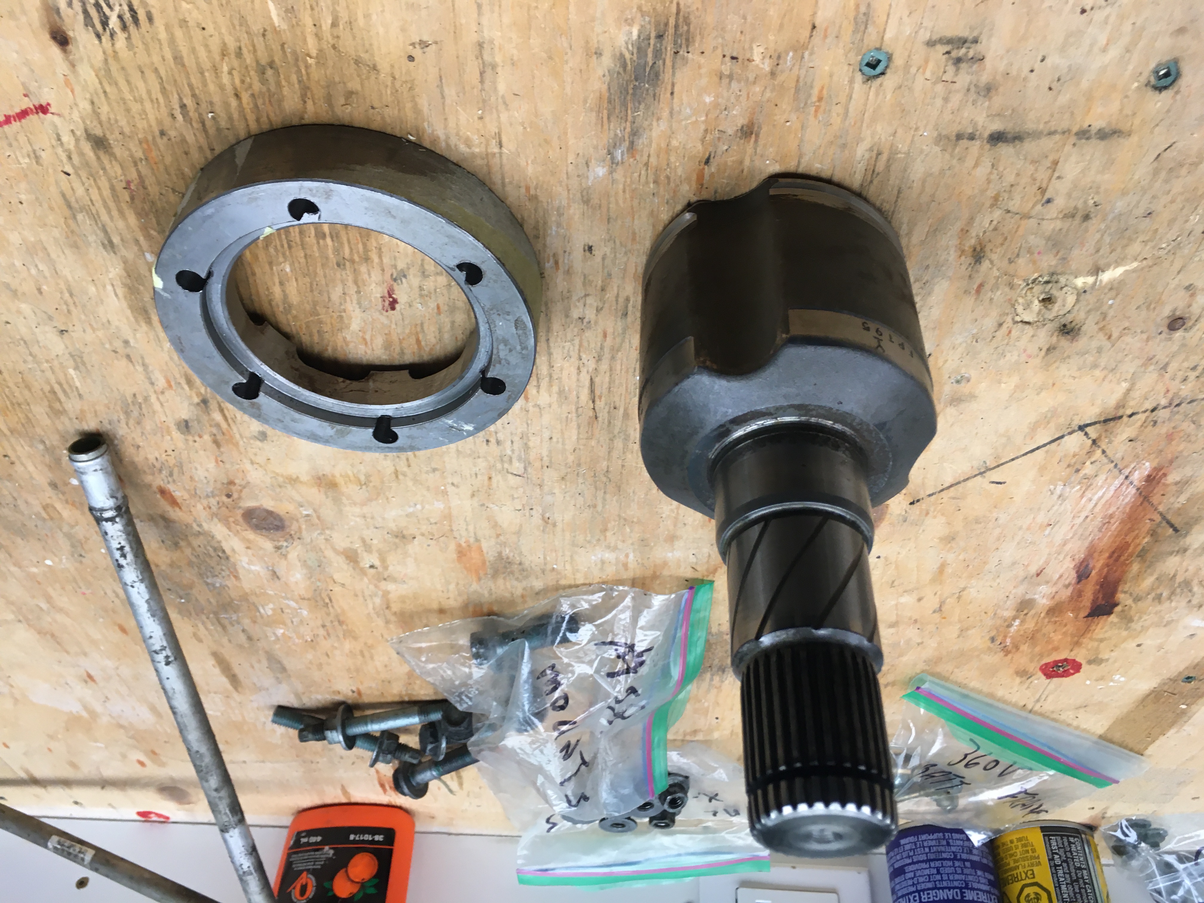

I got the Porsche Tesla frame in early January and installed the Tesla motor into the car for initial fitting. It's a tight fit but nothing is rubbing.
Now I need to fit and measure the Tesla drive stub shaft in preparation for cutting to length and welding the cup adaptors for the Porsche drive shafts. I have an '02 Boxster S and was wondering what is the total length of the Tesla drive shaft stub with the cup welded on?

I can’t easily get access to my stumps, as they’re well loctited in. I’ll take some pictures of them in situ this weekend. Bear in mind my car is the baby 2.7 and will have different drive shafts and adapters to the S.
Have you asked Nev? His Boxster conversion is an S and he’s probably got the dims somewhere.

Maybe the safest way is to measure the distance over the flanges of the original diff. Borrow somewhere a large caliper (how I did it), measure the original distance vs. the flanges in Tesla DU and dimensions the cup adaptors accordingly.
This is how I made mine from Tesla stubs. Original stub at the left.

FJ3422 wrote: Fri Jan 29, 2021 10:05 am Maybe the safest way is to measure the distance over the flanges of the original diff. Borrow somewhere a large caliper (how I did it), measure the original distance vs. the flanges in Tesla DU and dimensions the cup adaptors accordingly.
Good shout. Measuring my thin 2.7 shafts will be no use for S variants.

FJ3422 wrote: Fri Jan 29, 2021 10:05 am This is how I made mine from Tesla stubs. Original stub at the left.
Wy didn't you weld first the chunks of metal to the Tesla stubs and then afterwards on the lathe you brought everything into shape? 8-)
Wouldn't that be more precise? Since welding can "move" the parts?

EV_Builder wrote: Sun Jan 31, 2021 11:24 am
Sure, that would have been more precise. But I am limited in machining possibilities (just messing around in my 32sqm basement) and had nothing to fix the welded adapter for drilling & tapping the hole-pattern. So I had to do that before mating the parts. Stubs were pressed-in, axial & radial runout checked, welded at the inside, checked again, and finally welded around on the outside. Runout in both directions is less than 0,1mm which is sufficient.
