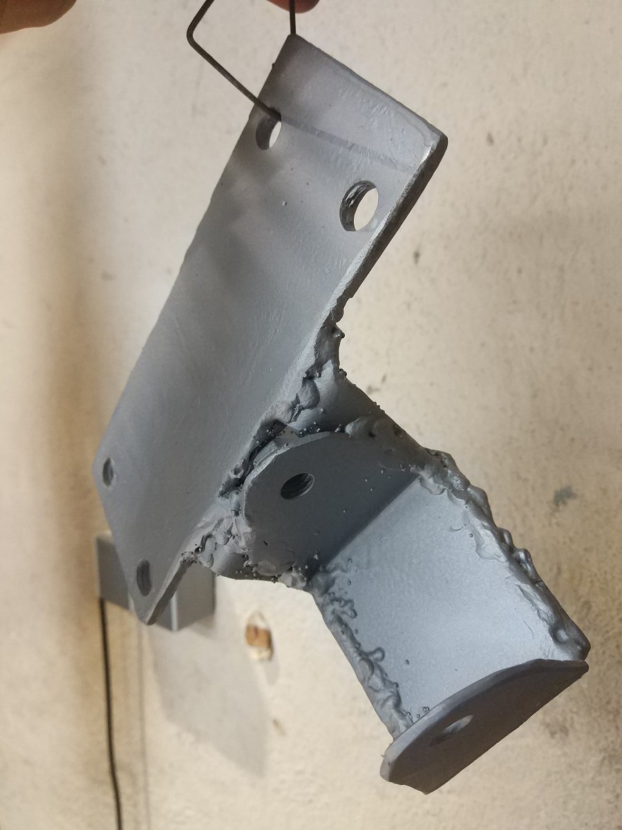

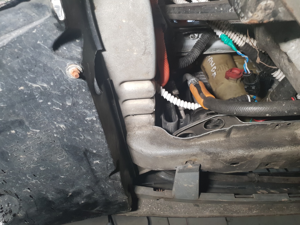

My negligence caught up with me. If you remember from the motor mounting post i made a rather flimsy rear mount and convinced myself that torque will only pass through it in one direction. Well DOH! Torque passes through it from two sides...sometimes more than one reversals in a second! This really stressed the 12mm bolt which was fixed only from one side. And last weekend it broke just as i was trying to setup the motor parameters.
Of course motor was jumping at less than ideal settings and caused additional stress in the single mounting point. This sheared the bolt clean off.
I went back to the drawing board and this time i decided to make a propper fork mount with a box fixture. I welded the box on my first try and it seemed it would work.
But i noticed the rear edge of the box leans over to the HPAS body! That is unacceptable and prone to damage. So i decided to cut the box from the plate and reweld it at an angle, so that rear box part would clear the HPAS body behind the motor. There will be a lot of welding involved!!!

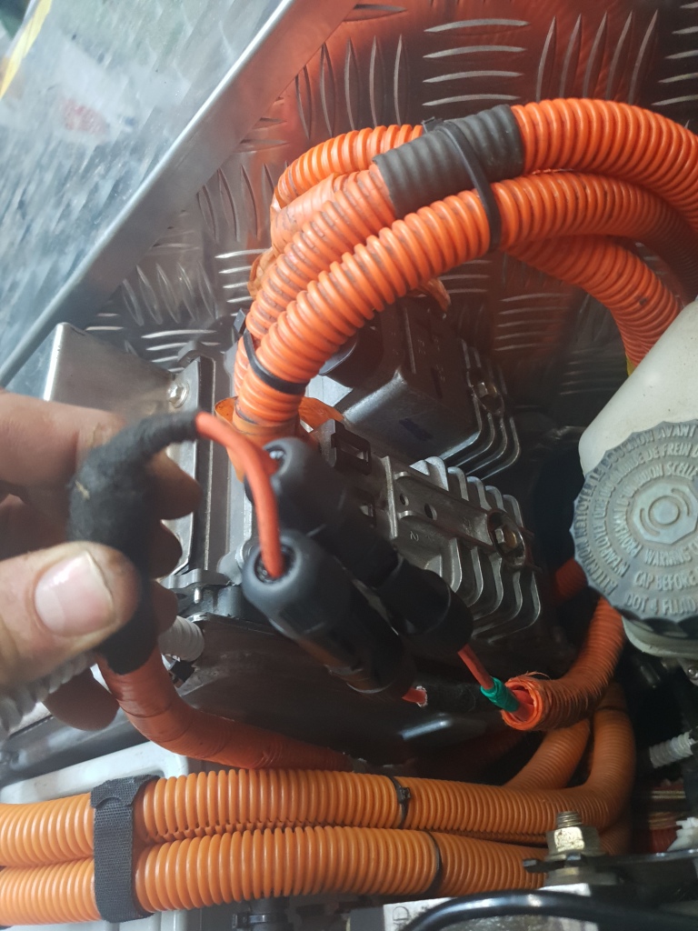

Well i have done some more driving and i noticed a disturbing thing. When inverter started PWM at car driveoff and sometimes when it stopped my speedo went crays and turned almost to full speed 240kh/h. It was really annoying, but nothing more, untill i noticed the speedo really governs the odometer. I thought this was counted by signal from ABS sensors! Lazy engineers went the easy route obviously .
Now if i dont want to have the signal raising my Km driven i will have to shield the cables that go to my junction box. No problem, i have 4 core LiYCY shielded cable and i really need only 3 cores from axle sensor to the box. Then there is a 4 core from the box towards speedo dial. I am not sure where the pulses come in. I will probably need to take everything apart
Here is a strange thing though. RPM indicator surprisingly does not bounce even with the fact it takes and process the same signal as speedo. So i could assume arduino signal is good and errors show on the original wires after arduino interface.
Maybe i should just build a low pass filter for blanking signals over 200Hz.

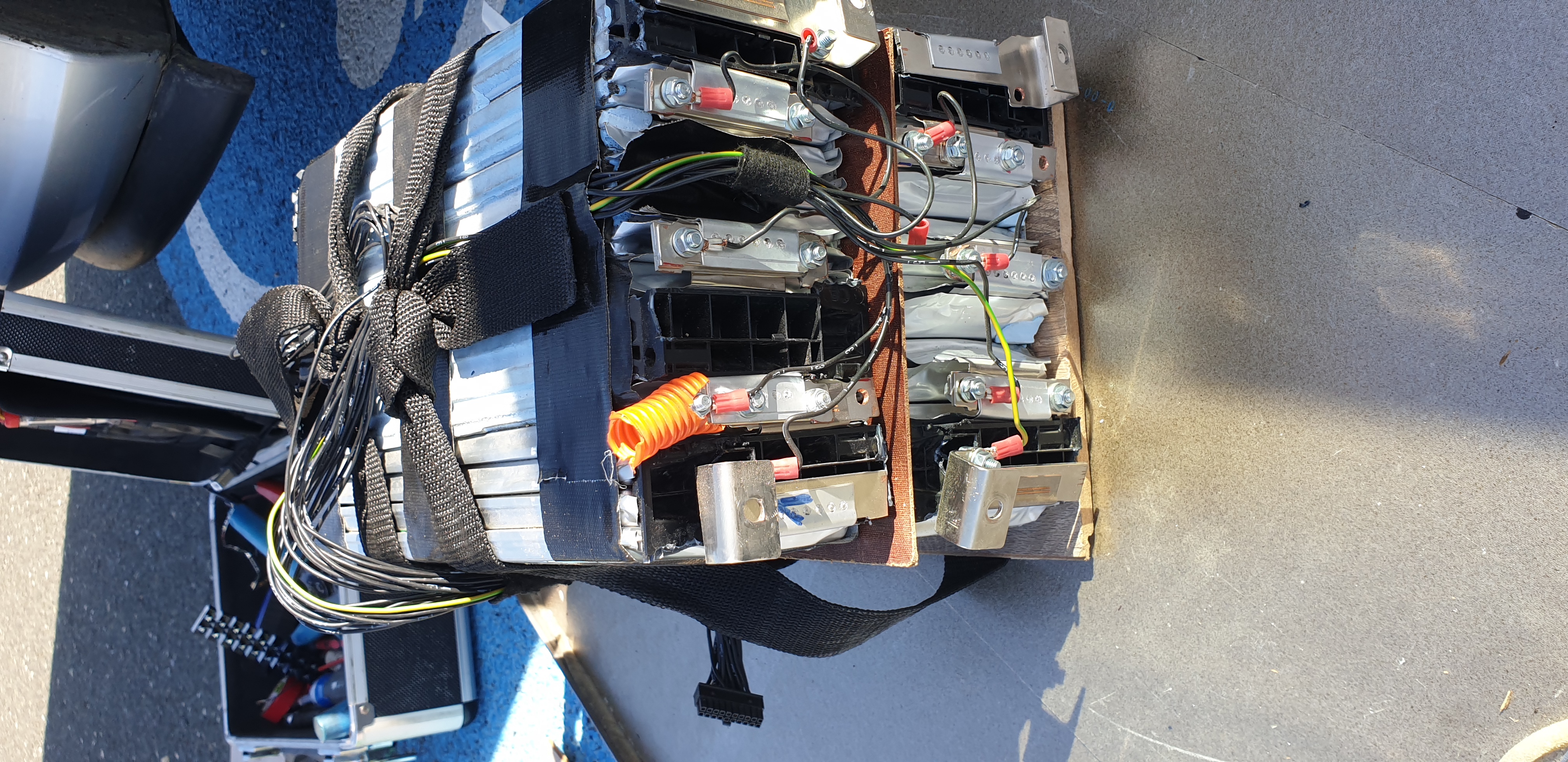

Finally i made enough of the BMS boards that i can comfortably go and slaughter those Jaguar modules.
First i remove the plastic cover and BMS connection. Then i mark cuts that will make the 2P blocks. Some of them can be used 2P2S since they were
meant to connect to the other side of the module. I then separated individual cells and drilled 5mm holes in their tabs. I connected cells in groups of 2P8S with a tab for + and - side. Today I have made enough cells to fit into the front box. Hurrah! And when i calculated their number i got 10 groupd of 8 cells which i will use in modules of 16 cells as BMS supports that. And behold, all 80 cells will fit the front box! I guess rear box will holt only 2P16S + 2P8S which is 86Vdc
I cut them down to 2P blocks for 120Ah. First i remove the plastic cover and BMS connection. Then i mark cuts that will make the 2P blocks. Some of them can be used 2P2S since they were

I made more of the BMS cables for my Minifit connectors. I think they are great. Very compact and firm attachment to the board.
I crimped terminals and inserted the wires by their numbers so that there would be no doubt on how to assemble them on the battery side. After some more work on the battery packs i was looking at how to assemble and connect them in my pack. Orientation of the packs is vital to ease of assembly. I learned with Mazda that i need to put modules together so that assembly/disassembly is safe even using metal tools.
I was sitting in front of the battery thinking how to do that in constrained space of the battery box, when it dawned on me! Battery terminals are oriented to bolt cables from the top. If i would make them accept copper rails from the sides, i could make the connections more managable... straight rails. Also since i will be stacking two modules one over the other i need to pay attention to clearance between two modules. But terminal is just under the top/bottom of the modules leaving no space for the head of the connecting bolt. Just using the bolt on existing terminals would create possibility bolt heat would touch something conductive on the other pack and ... BANG!
But end terminals are welded to battery tabs. And any twisting could tear them off and destroy that module! And taking 2P8S modules apart is out of the question since i already taped the modules up and made all packages nice and tight.
Question is how to bend 1mm thick end terminal by 90deg in a specific spot? Answer lies in a correct use of torque and support.
To achieve that i made a bending tool. It is made from 4mm copper contact, steel could do, but it is more difficult to form. I bent it at right angle and cut one end to size, so it will support the force of my torque directly on the spot where contact needs to bend. The other side i bent up and taped it up so it wouldnt hurt my hand. I also drilled a hole for the M6 bolt and after some thought i decided to solder a nut underneath it. This allows me to assemble the whole thing without having to look everywhere when that nut rolls away . With this tool bolted to the terminal i pushed into the terminal to keep it in position and pushed down on one end. Terminal twisted exactly on the spot i desired and the form of the tool allowed me to remove it sideways from the bend. Voila!
I now have all my end terminals bent so they accept rails from the side.

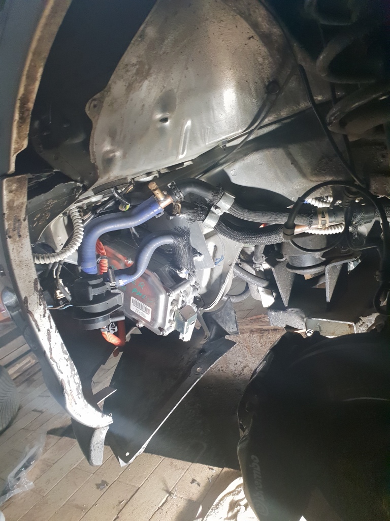

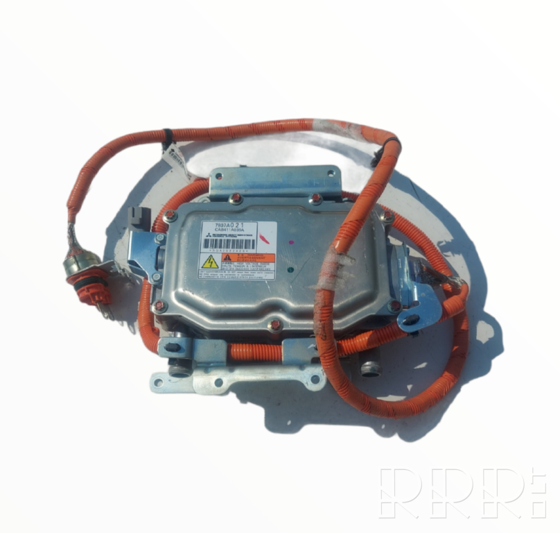

All things vary and my Webasto fuel heater is no different. Last week it bought the farm and the winter is really comming!
So i needed a replacement fast. Option would be to cannibalize the second one from Mazda, but that one neeeds servicing too as i noticed.
So another serious option was to remove Webasto and install Outlander electric heater. I thought on how to deair the system and i made (soldered) a simple valve from copper pipe and valve which was made just for that purpose. I put that to the highest point in the system.
First i needed to decide on how to connect it to HV. I just love those solar connectors. They are sealed and polarized. If you decide on a convention which connector is + and - you never need to worry when to dissassemble it. I connected directly to inverters second connector which originally connectede to heater and AC compressor anyway.
Webasto was removed and i used its mounting plate to now mount electric heater. Some bent hoses and a CAN harness later i had a working HV heater. It only needs to see correct CAN telegram to start. I set my DUE up to show telegram only at start without correct values. Those values are added when i ground a certain pin on DUE. In addition i implemented temp loop with CAN reporting. DUE is looking at a certain byte and regulating heaeter power accordingly. I decided i dont need to go over 55deg outlet temperature and 50deg for the full power of the heater. This saves some energy.

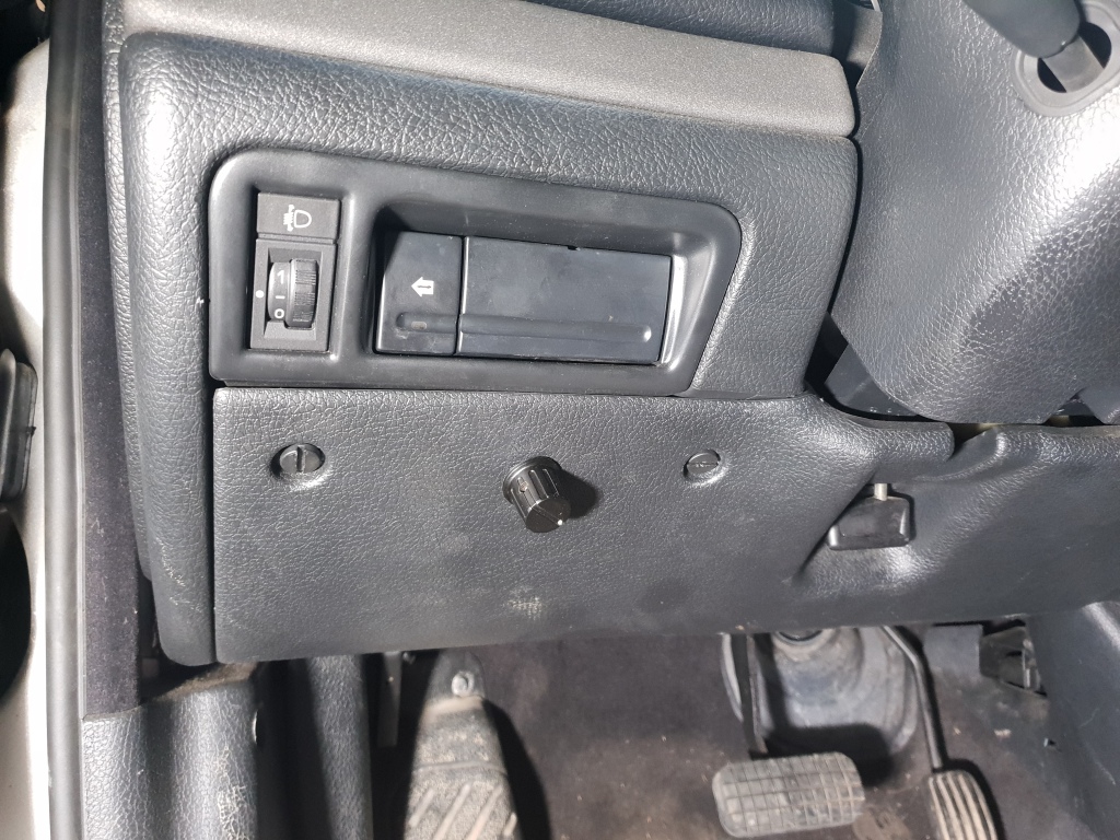

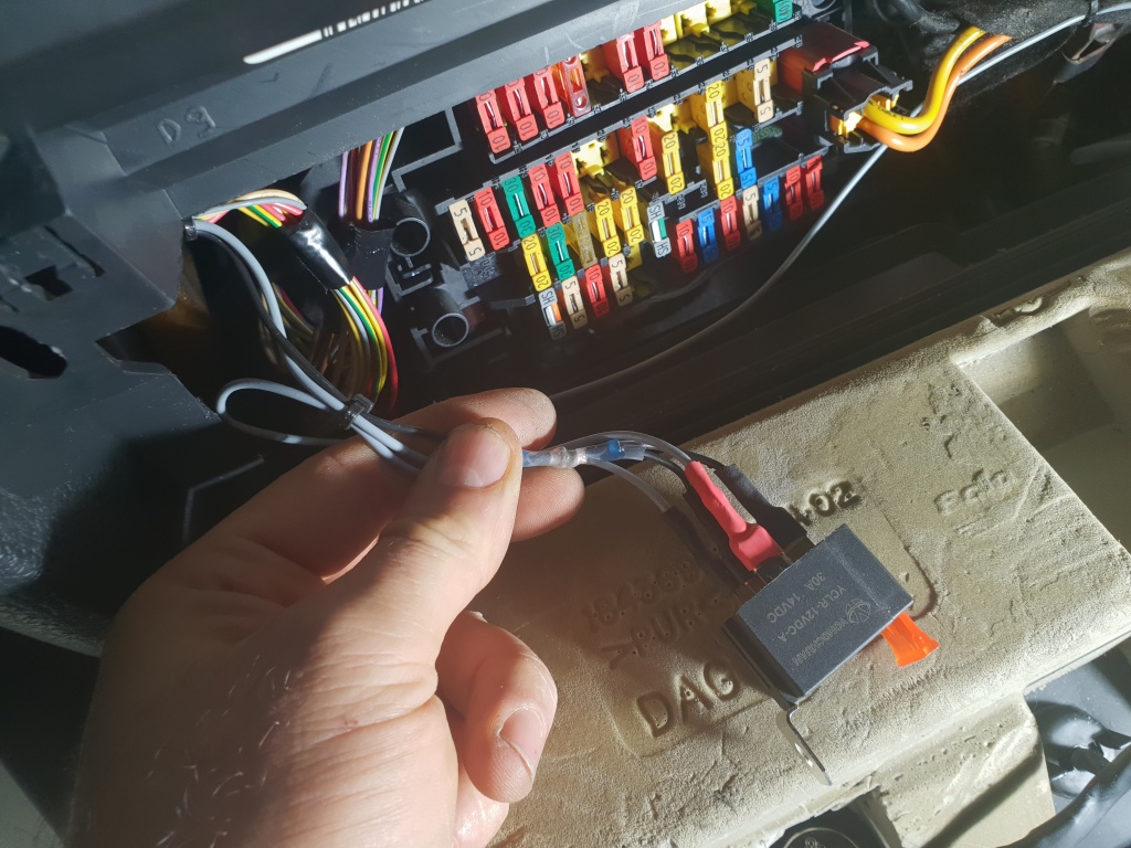

After some thought i prepared a cruise control switch to a new task. After i cut the wires i spliced my new wires in and tried not to touch the signaling light. So i allways see if heater is on.
Since the switch is signal high 12V it is too much for my poor DUE and i had to add a relay to invert the signal to GND. On DUE i use weak pullup and this relay pulls it down to GND.
After a week of slow use finally temp got to -2deg and heater had to go to work.
I needed about 12kWh now!!! Quite a change in range from 9.4kWh in summer.
SOC shows 33% draw at -2deg!

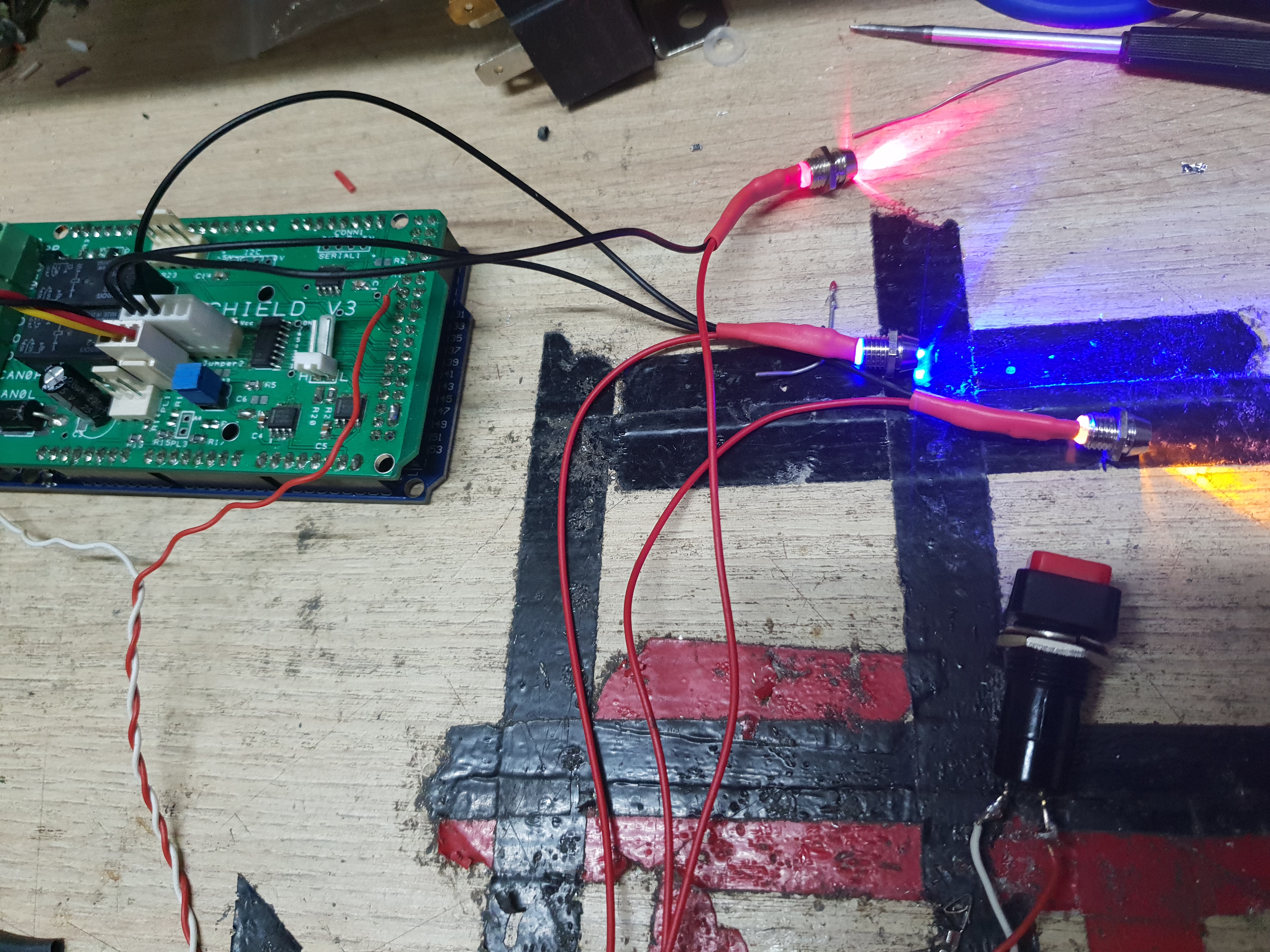

I have 3x Eltek chargers wired 3phase in star circuit with common neutral. Each can pull 3kW from its phase. Now in my house i have various loads distributed between phases. To avoid overloading my system i decided to make a loop in my DUE code that will allow me to toggle between chargers with a single button. This will only take one input pin and toggle between 3 CAN addresses in any combination.
CheckButton function is used with flags
Then i call function
Now function i declare with all options and debouncing
Now i can see all combinations and toggle code for CAN bus telegram
I also added three LEDs to signify each charger channel and provide visual UI.
I coded them to transistor pins of the ULN2003 chip so DUE provides pulldown and 12V is connected to each LED.
charger%20flags
bool Charger1 = false; //flag for charger1
bool Charger2 = false; //flag for charger2
bool Charger3 = false; //flag for charger3

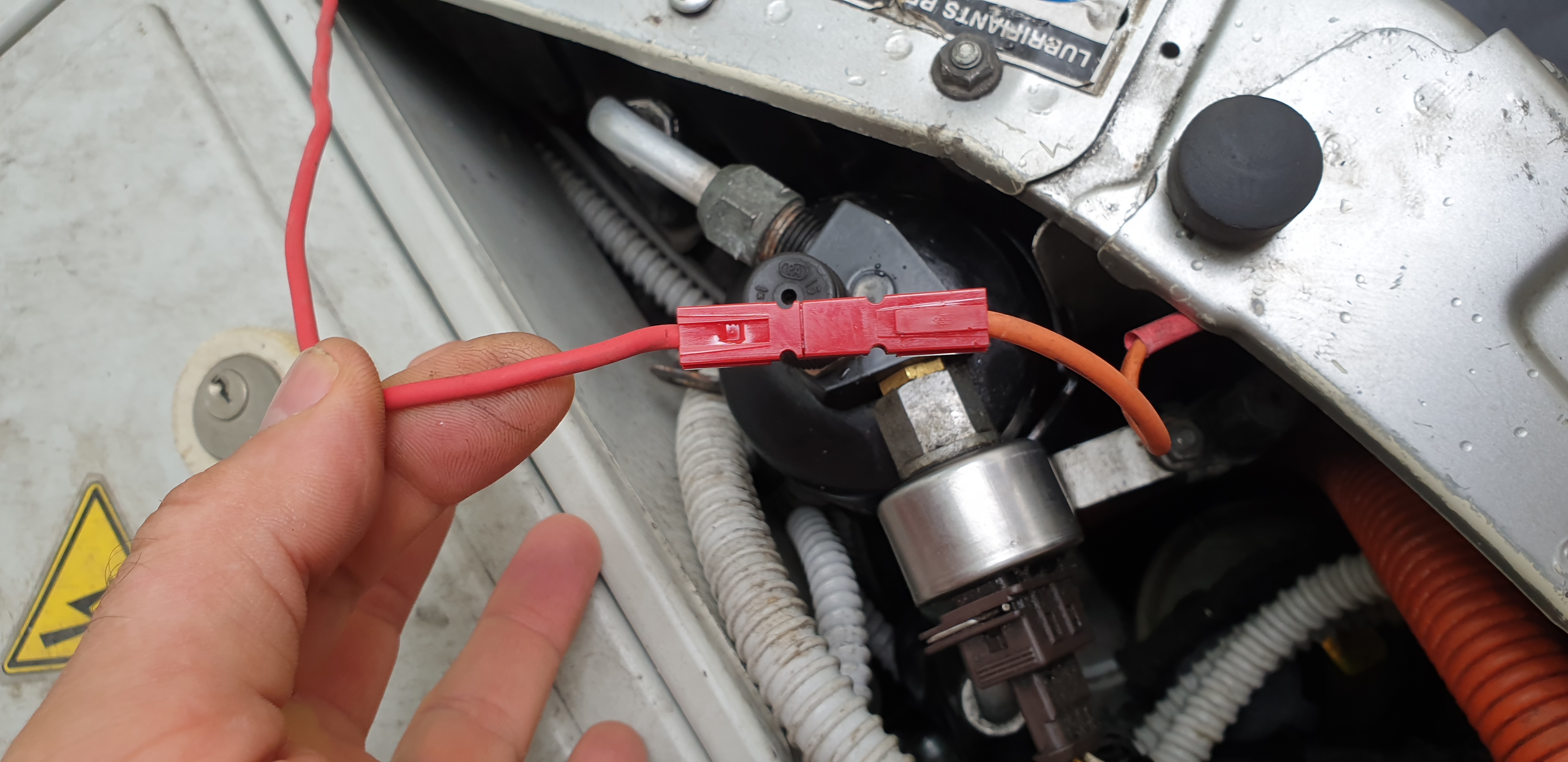

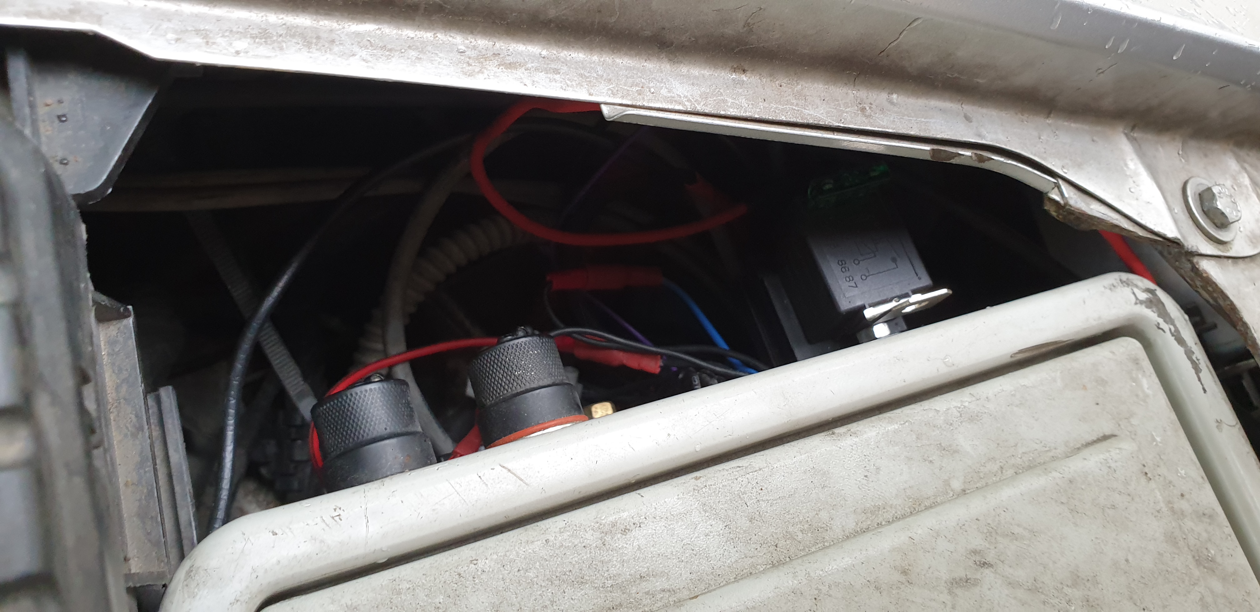

AC clutch relay is making noise on VCU supply line. There is this 12V supply line that goes from BSI to the rear of the car from where i took 12V to supply my DUE and relay logic.
To solve the issue I took one wire from my latching relay. This will provide 12V when inverter is ON. I routed it through the firewall to my 12V connection under center console. I reconnected my DUE and from the short drive i took to test it seems AC clutch relay doesnt disturb DUE anymore.
I still hear the AC relay unpleasant burst through the radio, but my new supply line is clean.
On second note i spliced cooling fan wires and fit another command wire to it. I tested that particular connection to confirm the kind of signal i need to run cooling fans at low speed. I found if i connect 12V to thin red line only right fan comes to life and at full speed! We dont want that.
Next i found if i connect 12V to thick white line this will start both fans at low speed. I imagine low speed should still be enough to cool down 3 Eltek chargers.
So i pulled wire out of connector and spliced another (orange) cable into it. After protecting connection with heatshrink tubes i pushed relays back into their place with additional orange wire going towards 30A relay. I use coolant pump signal to start this relay which will then run coolant fans at drive or at charging. I like to keep connection simple for now, but later i intend to harvest CAN signal from chargers which report temperature and i will slave that relay to DUE coolant output.

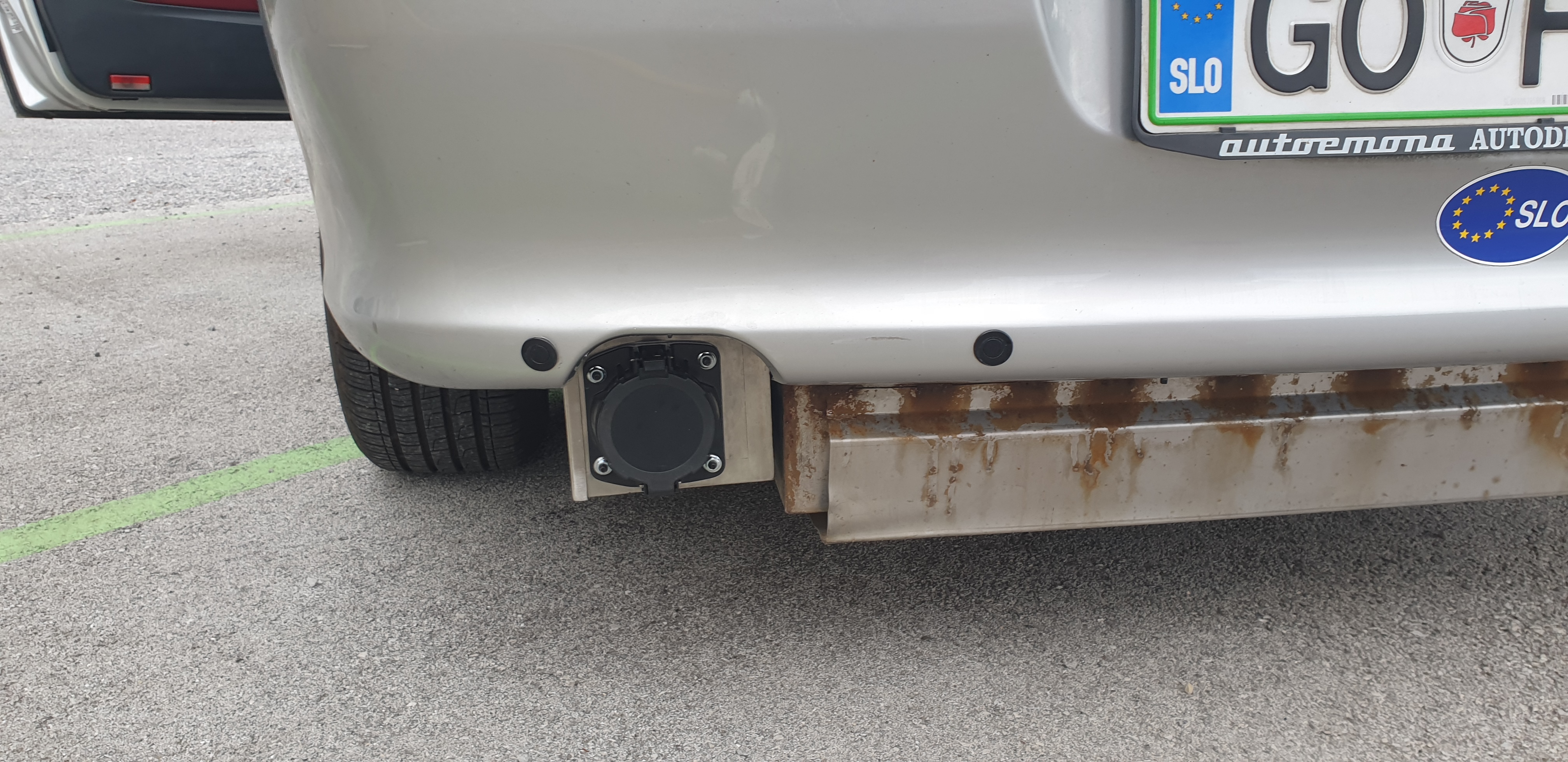

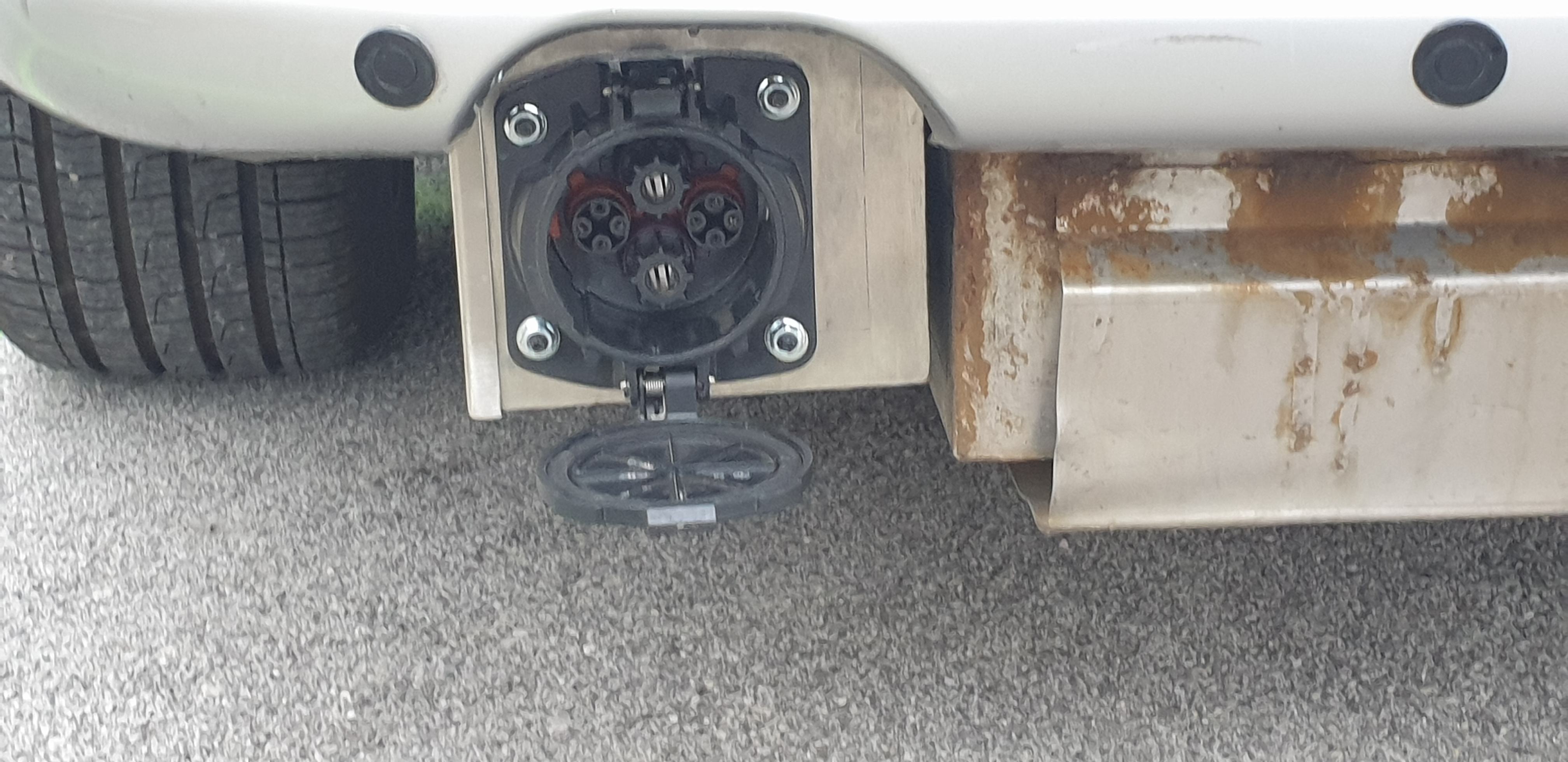

I mounted the box to the place of exhaust. While i thinkered with idea to suspend it the same way as the exhaust, rubber blocks cause it to hang too low, not good for safety. In the end i used two M8 bolts to firmly attach the box to the rear battery box.
It is self sustained, no power from the car required. Only solid GND is required. I intend to test this a bit. In the end i will probably add CAN line to BMS for protection.
Idea is to use a heartbeat telegram similar to Outlanders 0x285 to keep chademo operating. If that ID would be missing VCU would stop Chademo process.
Edit: that rust does not belong there . I guess there is no such thing as inox welding wire. I have to sort it out before winter.

Welding stainless steel in a way that the welds won't rust is pretty difficult. You have to have good Argon gas coverage (most simple MIG welders don't have gas preflow or postflow) and the welds have to be cleaned and passivated. That's usually a really nasty acid based solution which is applied to the welds to make them as shiny as the rest of the metal.
If you have any contaminations or bad gas coverage, the welds and surrounding areas will start to rust.
- Posts: 3265
- Has thanked: 80 times
- Been thanked: 234 times
Re: Peugeot 406 coupe Pininfarina with Leaf motor and Ampera inverter
Yes, but i didnt use any gas mix. Only flux cored wire. As i just got that welder and welds seem really good in all positions i assumed wire was inox as opposed "for welding inox" as stated on the box... got me there.crasbe wrote: ↑Mon Aug 22, 2022 9:31 am Welding stainless steel in a way that the welds won't rust is pretty difficult. You have to have good Argon gas coverage (most simple MIG welders don't have gas preflow or postflow) and the welds have to be cleaned and passivated. That's usually a really nasty acid based solution which is applied to the welds to make them as shiny as the rest of the metal.
Evidence of my MIG flux welding in photo. Incidentaly i found out that flux cored wire for inox is the same one as for welding other steel alloys.
I will get on the brush and grinder then...

Flux Core certainly has it's applications, but corrosion resistant stainless steel welding certainly isn't one of them... as you learned now
But given the material, with a good coat of paint after derusting it should last a long time as well.

True, i really like flux because i can use it outside without worrying about wind. Surface does need some grinding but still less than MIG weld starved of CO2.

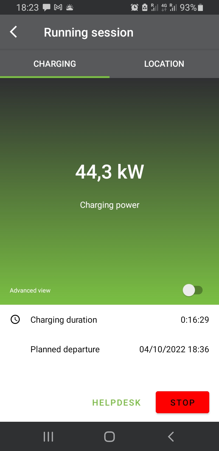

My wife and i went to Croatia to test my new Chademo system. I admit i have been testing it quite succesfully here, but i never went further than a single fast charging requirtement. This trip should show the merits of Chademo charging on a lesser battery size - yes i consider 40kW a bit smallish.
We went to Split which is about 450km from ourt home. We had some great sights, but a lot of drive and stops.
First we went along the coast and stopped at several short Lidl chargers. That went great at 120A charging = 43kW charge power. Temperature rose steadily up to about 45deg! First I had to remove batery box cover to cool down cells while driving and then i reduced charging to 25kW to keep cells at about 42deg. But we got there...
We drove around split for several days and there wasnt any problem. Cells were somewhat warm, but they chilled down in the evening...
Trip back turned into a nightmare though. About halfh way back one cell pair developed a high state during charge. It seemed to be riding high during charging for example at 4.12V while others were only at 3.95V. I had to stop charging there, but we had to be on our way nontheless.
While driving at 110km/h suddenly that particular cell dropped to 0V!!! It kept that state through the drive. Luckily there was a resting station with a charger there. I plugged up and charged. BMS showed cell quickly recovered.
It kept its state about 0.5V above the rest during charge and it stayed there when i stopped charging! This was no mere faulty sens connection.
Cell pair was quite hot to touch. Sensor showed 47deg, but i think it was more.
I had to remove the whole 16S2P (2 stacks) pack out to determine the faulty cell. Once i isolated it i didnt have any other option than to isolate that particular 8S2P stack and bypass it. This left me with 88S2P configuration, but we at least were able to continue our return home.
This event also showed me importance of standard configuration. While i played with various cell packs and their positions i found out i didnt use identical configuration - positive and negative electrode positions - simply because of using shorter lines. I couldnt use the same contact bus since it wasnt correct lenght. That caused me to strip a pack and reshuffle it to get to proper contact position. Kind of like an open heart surgery on the parking lot.... exactly like it! I will now proceed with battery cooling system and i think of making it more like temperature management. Like liquid cooling/heating and temperature sensing and 3way valve actuators...
This system now has priority over driving.
