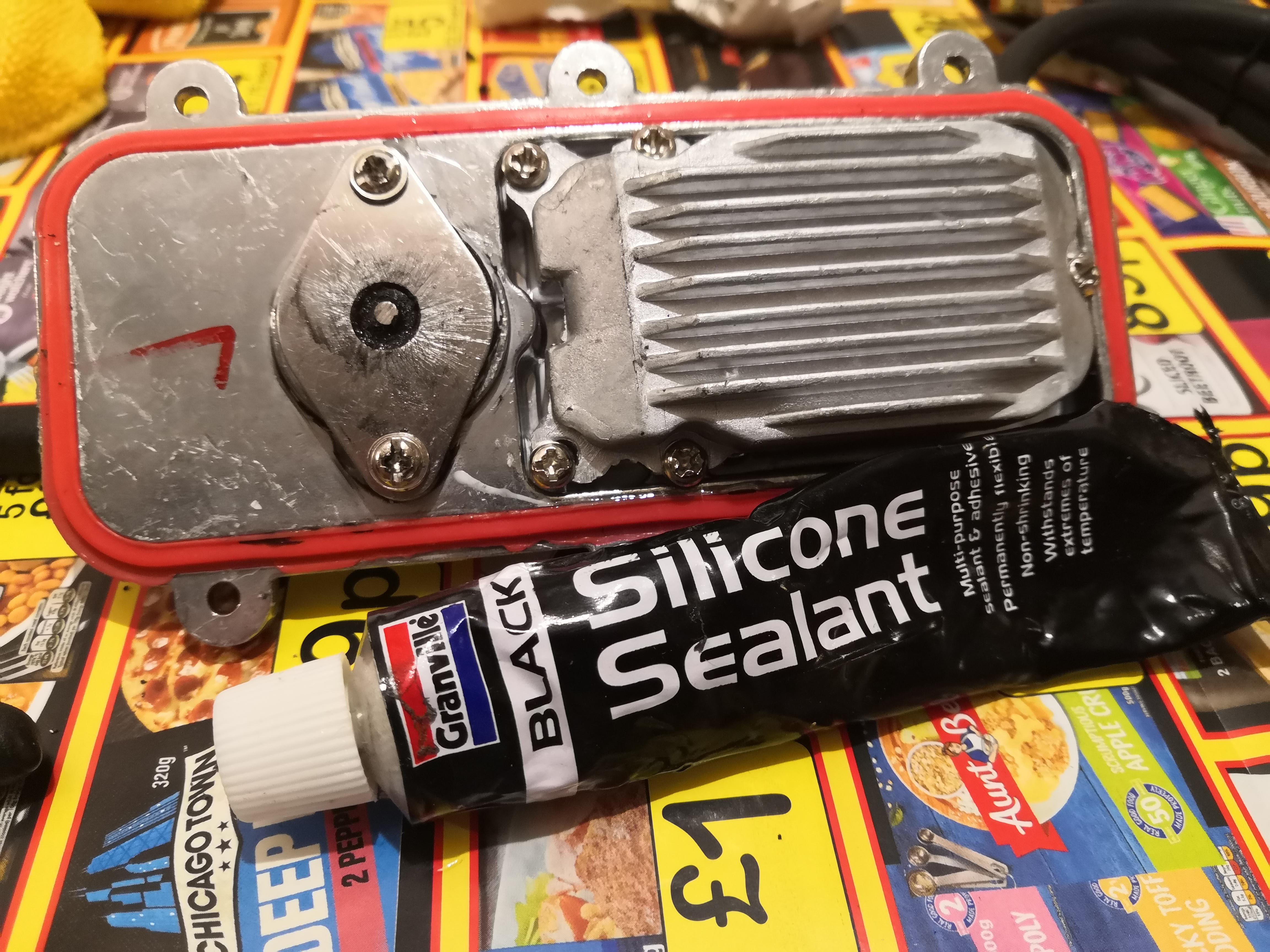

I have bought one of these and modified it to remove the pump - see photo. Planning to use it in a closed loop for my heater with an external DC pump and thermostat.
Not got further than modifying it though.
[Note, I didn't just cut the impeller off. I've also disconnected and removed the motor from the other side but couldn't find that photo.]

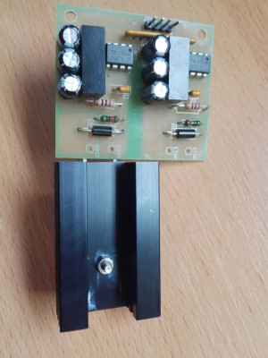

If we just talk heater (without pump) I'd simply use an isolated gate driver and a TO-247 IGBT and clock that with 70% dutycycle at a few 10s of Hz.
If the integrated pump is just a DC motor with a rectifier it would run as well.
In my Polo conversion I switch the air heating element with an IGBT, just without the clocking.
I would probably integrate it with the VCU that can generate the PWM on one of it's open collector outputs when selected via the web interface or at some outside temperature threshold.

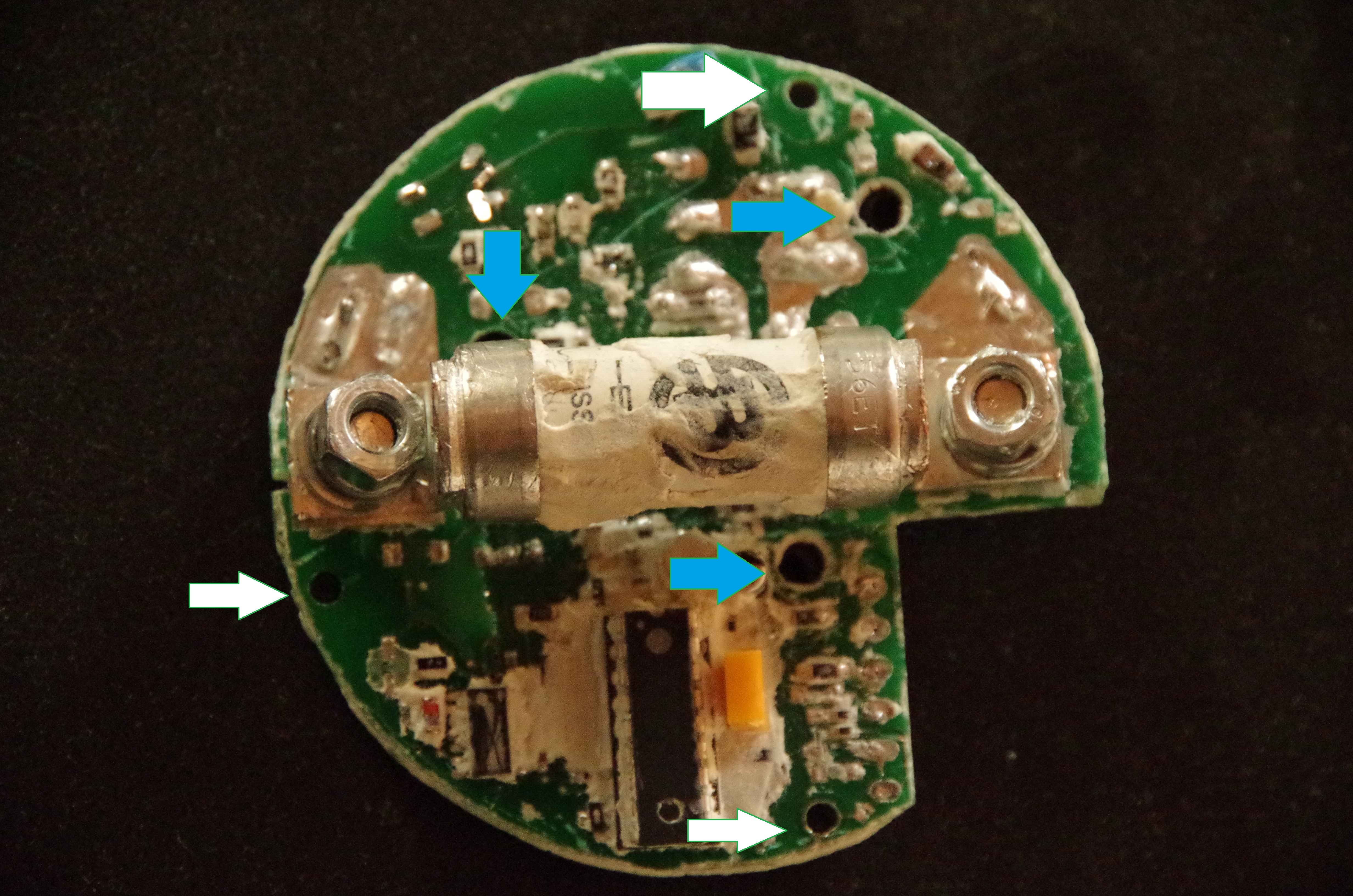

I've repaired the RM3 heater in my Think, removing the potting compound is no fun.
The original PWM control with a PIC is designed in such a way that the 55A fuse triggers when it is permanently on, as well as for safety in the event of excess temperature due to a short circuit in the heating to kill the fuse.
I continued to use the original temperature sensor (LM335) and switched the heating coil in series instead of original parallel. These are accessible from the top. An IGBT (IRG4PC50) with opto driver(HPCLJ312) as a switch, supplied via a series resistor, elcap and Z-diode. HV fuse with 16A. Temperature control with an OPV as a comparator and supply via 12V (heater on).
I also used the overtemperature protection again, but the switch is only accessible after removing the potting compound.
To my regret, i have not created a complete circuit diagram.

I used a knife to remove the compound. The first thing I did was uncover and removing the connectors, then the fastening screws.
There are three screws PH1 that hold the board (white arrows), three that fix the IGBT's under the board (blue arrows) and two screws for the thermal switch. After exposing and removing the screws, I peeled off the compount around the circuit board and pulled it out with a lever. It is possible that the thermal switch and screws can only removed after removing the PCB. You get easier access when removing the fuse first, but in my case a screw turned with the nut so it was not possible.
There are some infos and solutions at https://www.fingers-welt.de/phpBB/viewt ... 14&t=11820 but i have implemented a less complex solution.

Got the heater yesterday. It can simply be opened by removing 4 bolts. I cut the wire to the AC motor and put it back together. The heating element looks like a square mushroom surrounded by water, maybe like 5x8cm

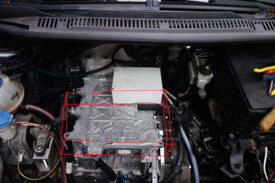

Do you by any chance need DCDC from Ampera? I will go Outlander charger/DCDC route and i will soon take the Ampera DCDC out. I will got for wholy liquid cooled electronics. It is 1,8kW unit commanded by single 12V enable and CAN signal. It is air cooled and it is not IP65 rated though. I am running EHPAS pump, Vacuum pump, all lighting and electronics and i dont see 14V go above 50A. I use 2x 12V 4000rpm fans directly on the ribs and they are adequate. If you take the DCDC you get them too.

Yes that would be good, just HxWxD. Thanks
I think not, I can hear the pump moan if I turn off climate control, which apparently closes the heater valve. And then it runs a lot lighter with climate control on. But who knows what happens, it doesn't really work anyway.arber333 wrote: ↑Wed Nov 11, 2020 7:18 am You could have a control switch (thermostat) inside cabin that switches coolant flow towards internal heat matrix. Those open only at 80deg which is too hot for EV use. Or you have the cloged up matrix. Grease from the coolant can form clogs in the matrix because there is some threaded rod inside those pipes which increases flow time through heater. Nasty stuff, better to just replace the matrix...
Hmm, that sounds very tempting. Do you have some dimensions? Would be nice if it fitted into the original battery box. But could also go on top of the inverter, it is pretty dry up there since I blocked the air inlets.arber333 wrote: ↑Wed Nov 11, 2020 7:18 am Do you by any chance need DCDC from Ampera? I will go Outlander charger/DCDC route and i will soon take the Ampera DCDC out. I will got for wholy liquid cooled electronics. It is 1,8kW unit commanded by single 12V enable and CAN signal. It is air cooled and it is not IP65 rated though. I am running EHPAS pump, Vacuum pump, all lighting and electronics and i dont see 14V go above 50A. I use 2x 12V 4000rpm fans directly on the ribs and they are adequate. If you take the DCDC you get them too.

Just went outside and measured, it is about as wide as the inverter and about as high as my white junction box, so it would fit nicely. Will see how far I get with the 750W or rather 500W (left over after lights, fan and misc). Then will let you know

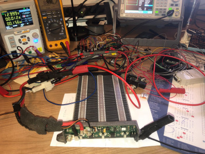

I have the Volvo PTC here now, what sort of PWM does it need? Amplitude, frequency?
EDIT: Arber, I really think you have a point with the thermostat. I heated the water for 30 minutes yesterday and left the fan running at medium speed with air recirculation. Everything was hot but the inside of the car wasn't. Maybe water is bypassed rather than blocked.

Argh! So Mr. Supersmart here had removed a climate control servo some months back because it was noisy. I thought it was just for A/C but in reality it controlled air flow via heater matrix or not! By default it is set to NOT flow via the matrix. So put servo back in and now I get warm air from the vents. So will give the water heater a second chance.
Will put a small PWM circuit in the white junction box and hook it up to a Schuko socket, so I can either plug the heater into that or the wall.
