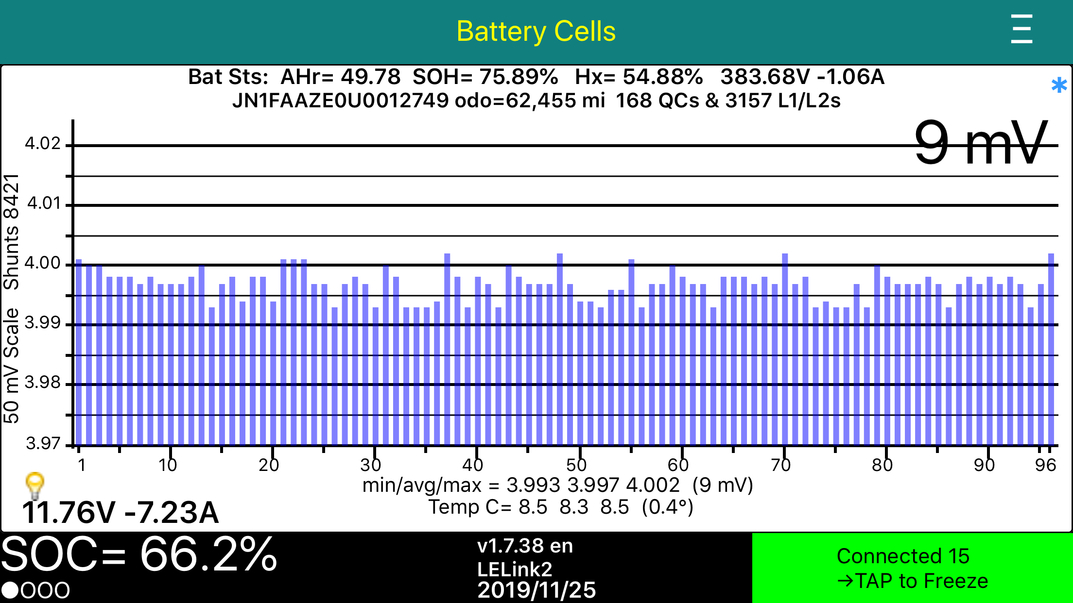

You need to get a pack sniffer 2 from Wolftronix. that and a 5V USB portable power supply it will tell you if the battery is there and what shape it is in.

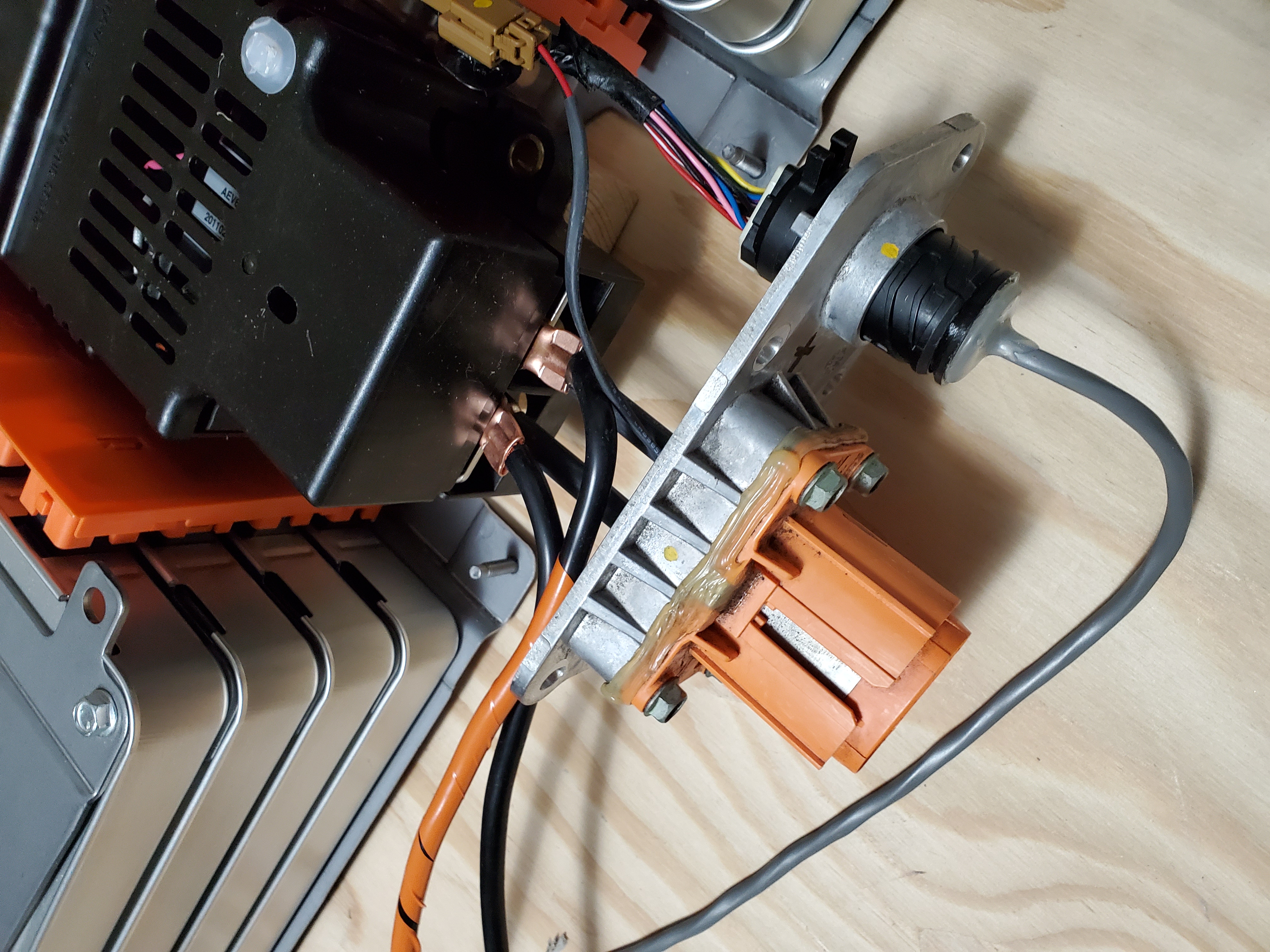

Re: Id love to chat!!! RX8 to Leaf Conversion
Yeah. This is the plug that comes out of the battery box. (both BMS and HV). The Pack Sniffer 2 connects directly to the BMS.
By battery is out of the box.

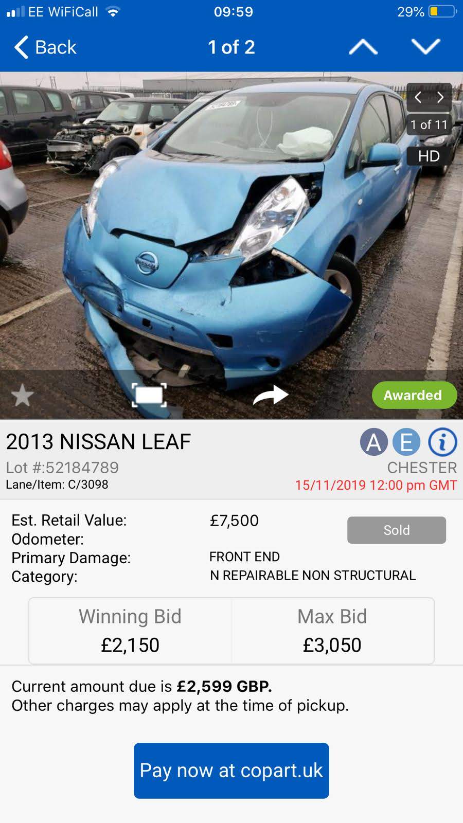

Worthwhile being aware of this if you're not interested in the pack itself:
This was me. I took a punt as it was a good price and the front impact clearly wasn’t deep so the hope was that it avoided the power electronics. The worst case I intended to use any parts that were salvageable and just sell off the rest. I managed to get all the HV components needed and even sold a door to someone from the leaf owners forum. The rest though nobody was interested in, I could have disassembled and sold bit by bit on eBay but it really was not financially worth the time, labour or garage space (as it was being rented). Many of these parts are common on eBay but if you do find a buyer for a specific part it might be worth your time. In the end after ringing around several local garages I managed to sell the rest for £150 (Mike Brewer I am not).Kevin Sharpe wrote: ↑Fri May 01, 2020 1:48 pmNo, the car was purchased by one of our course participants
In hindsight I got Very lucky. The 12v battery got trashed in the impact which preserved the HV components while making the car appear completely dead. If you find one that appears similar it’s worth taking a 12v battery and some jump leads (There’s a bonnet release on the gen 1 is by driver’s right knee and there is a catch that’s fiddly to release under the bonnet itself). If you can’t get access to the underside to use a pack sniffer and the car has 12v power you could get an OBDII connector with leaf spy pro app. Send me a PM if you have any more questions and good luck with the conversion.

LOL, I just spotted this post.Extremetaz wrote: ↑Tue May 05, 2020 1:59 pm Worthwhile being aware of this if you're not interested in the pack itself:
https://www.adverts.ie/car/nissan/leaf/ ... f/19933827
I bought this car and was amazed at how clean it was.
It's now completely stripped of all electrical parts for my EV conversion and anything I can't use is for sale.
