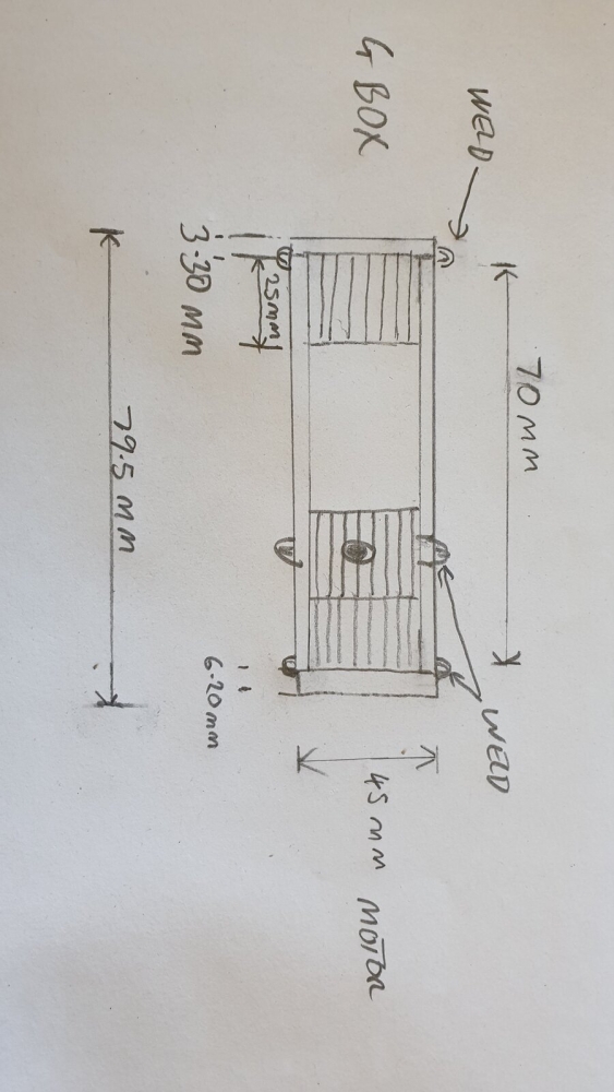

This is a rough mock up of the coupler design.
The main drive splines will be welded on the outside and the tensioning spline will be welded through holes in the coupler.

I'm pushing on with the Fiat 124 clutch disc and am planning to make the coupler in the same way as Arlin Sansome did in his video above.
Can anyone think of a good reason NOT to go this way before I spend money getting the parts waterjet cut?

Thanks, I definitely want to weld in two disc centres for the Leaf motor side so what I wanted was advice if the design is a good one.
It's good that you say it should be good for a DIY design. My goal here is to build an affordable electric car with a repeatable design and without having to spend a fortune on local experts. The adapters will need water jet cut but that shouldn't be a big deal and now we have a design for them it will be easy for others to replicate.
There are a couple of reasons I wanted to make it using the BMW coupler instead of just welding the two disc centres into a bit of pipe.
1. I don't have a lathe so I wouldn't be able to machine the pipe to fit the disc centres. They are different diameters so either the pipe would need turned or the disc centres.
2. The idea of being able to reuse the Leaf side of the coupler and just get another adapter plate water jet to match whatever comes next is appealing. This motor may end up in another car.
3. I may be wrong about this but it looked like it would be easier to weld the disc centres to the triangle adapters and still keep everything straight than it would be with a pipe.
4. It looks like it will be easier to achieve two disc centres on the Leaf motor side with this design.

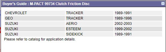

For those in a market that doesn't have a lot of Fiat's driving around, early 90s Geo Tracker discs have the 7/8" 20 spline center. Which has the same fit to all these Fiat ones.
Here's an interchange table.
edit: this disc doesn't fit fantastic
I just would not trust plasma cut disk for anything beyond the dyno. those a plates are not balanced. Cnc or lathe.
And the drive shaft yoke. again not meant for that rpm. arlins use case is fine. Anything beyond that is a big risk.
there are plenty of misalignment couplers out there. A few of us are using the rotex gs38.
Thanks for this, It's the kind of response I was looking for when I posted.
It's interesting you think the dyno where Arlin was putting 700 phase amps through it (and planing higher) is a safer environment for an out of balance coupler than in a car. I'm not certain that is correct although I'm a rank amateur so not really qualified to comment. I do agree an out of balance coupler would be a bad thing and look forward to seeing him test it as the balance at high rpm was a concern.
So we have one for and one against, anyone else have any thoughts.

Alibro wrote: Sun Sep 20, 2020 10:06 pm
Bratitude wrote: Sun Sep 20, 2020 8:49 pm
Alibro wrote: Sun Sep 20, 2020 12:55 pm
If arlins dyno explodes, it’s doing it in a isolated location. It’s not a moving in a vehicle in public.
I’d rather have something explode when stationary, than when I’m moving at 120km on a highway. With traffic.
you can do a lot of things, and some of which are done by folks on this forum. Is it a safe methodology? No. dose it work? Yes.
Personally, looking at the full cost of making a coupler for the leaf out of clutch disks, raw material and machining made no sense to me.
it just made more economical sense to get a batch of custom couplers made. I didnt have personal access to a lathe big enough, or welding equipment capable.
machining down splined centres and interface fitting them in a rotex or love joy, is a safe way forward.

Bratitude wrote: Sun Sep 20, 2020 11:55 pm Personally, looking at the full cost of making a coupler for the leaf out of clutch disks, raw material and machining made no sense to me.
I agree welded coupler is not optimal, but if you consider my EV is my prime mover to work i needed to get it working when my clutch shed splines. When such a case repeated in the course of 1/2 a year i went for the best available option. Also i knew a single clutch center will not support the weight of the coupler. So we welded two clutch centers and it worked. I am actually impressed that i could weld on the fine grained coupler casting material.
Well i will get my friend to build splined insert tube with dowel pin groove on the outer side from tempered steel. This could be then cut to length and inserted into machined coupler whatever flavour that might be. Before final installation you would still need access to lathe, but it would mean a lot less operation and everything would be balanced in center.
