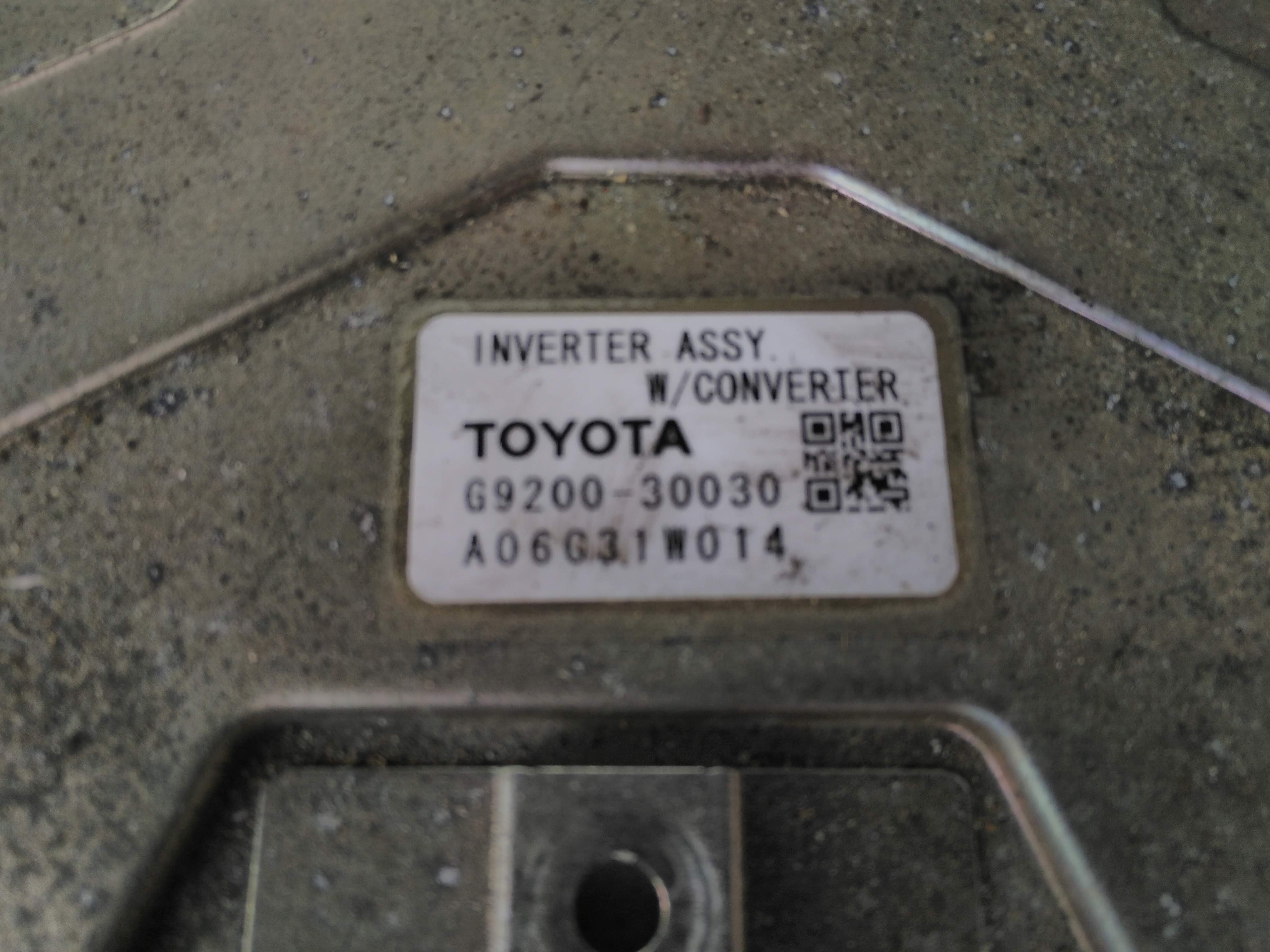

Post by Kevin Sharpe »
Kevin Sharpe wrote: Mon Sep 07, 2020 9:54 am I'll also try and find the inverter part number on LEXI when I'm at the workshop :)
Here is the label from our GS450H (2006 car iirc);

does anyone have experience with G9201-30010 its a 2008 RHD gs450h , its from the same period so I wouldn't expect it to be an issue but it also isn't listed on the hardware wiki.

xp677
Posts: 440
Location: UK
Been thanked: 15 times
Re: GS450H Discussion
Post by xp677 »
TFirenza wrote: Tue Sep 08, 2020 9:00 am does anyone have experience with G9201-30010 its a 2008 RHD gs450h , its from the same period so I wouldn't expect it to be an issue but it also isn't listed on the hardware wiki.
As far as we know, all the "square" inverters from the Gen1 GS450h/Camry are the same when it comes to control.
The Camry inverters have different connectors, the LHD inverters have the ports on the other side (mirrored casing), but when it comes to using them, they are all the same.
I've ran both a 2006 and a 2010 RHD GS450h inverter, no issues.

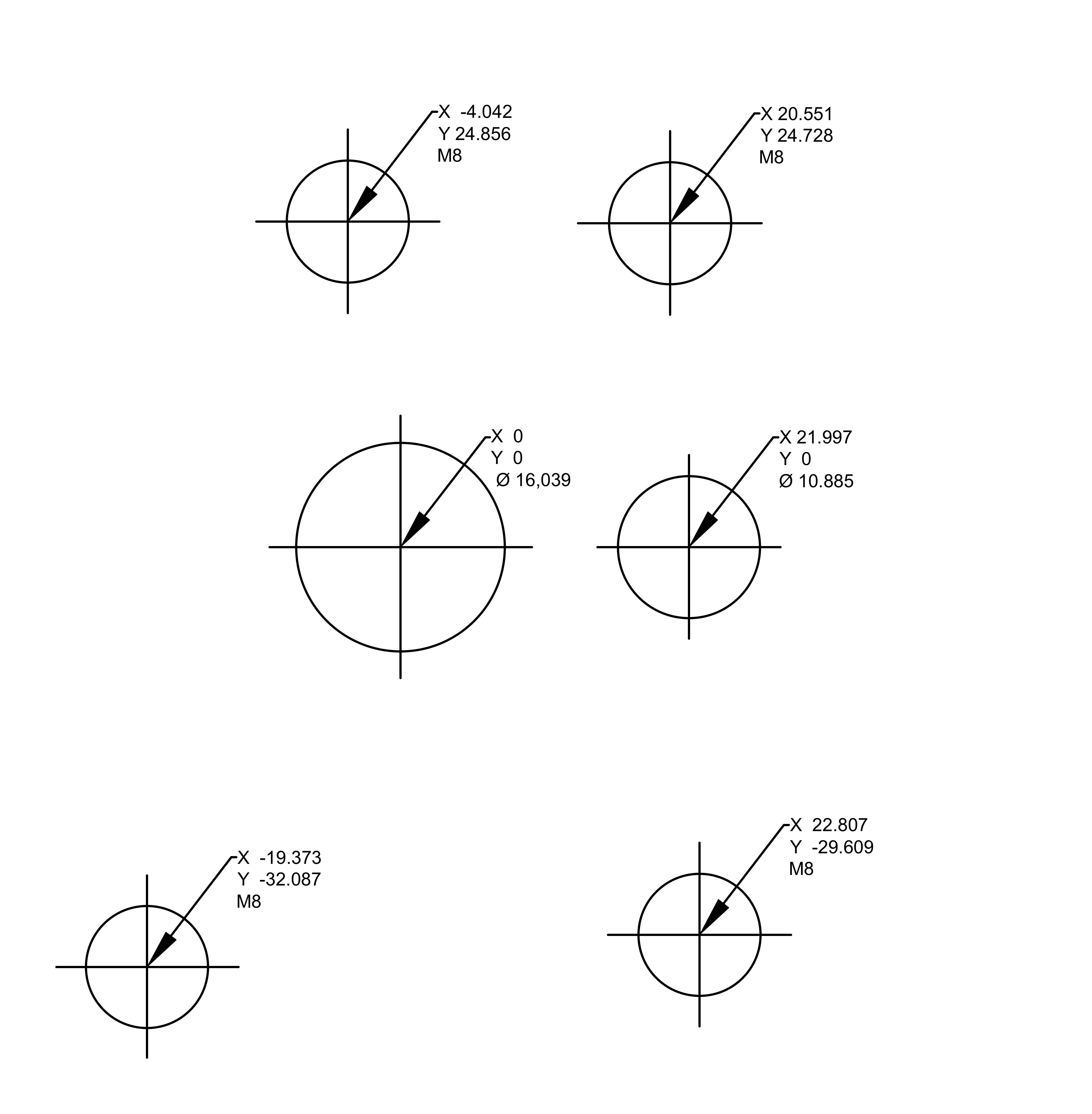

Mobert
Posts: 7
Joined: Wed Jun 03, 2020 6:11 pm
Location: Austria
Post by Mobert »
Oil pump flange on the transmission,
