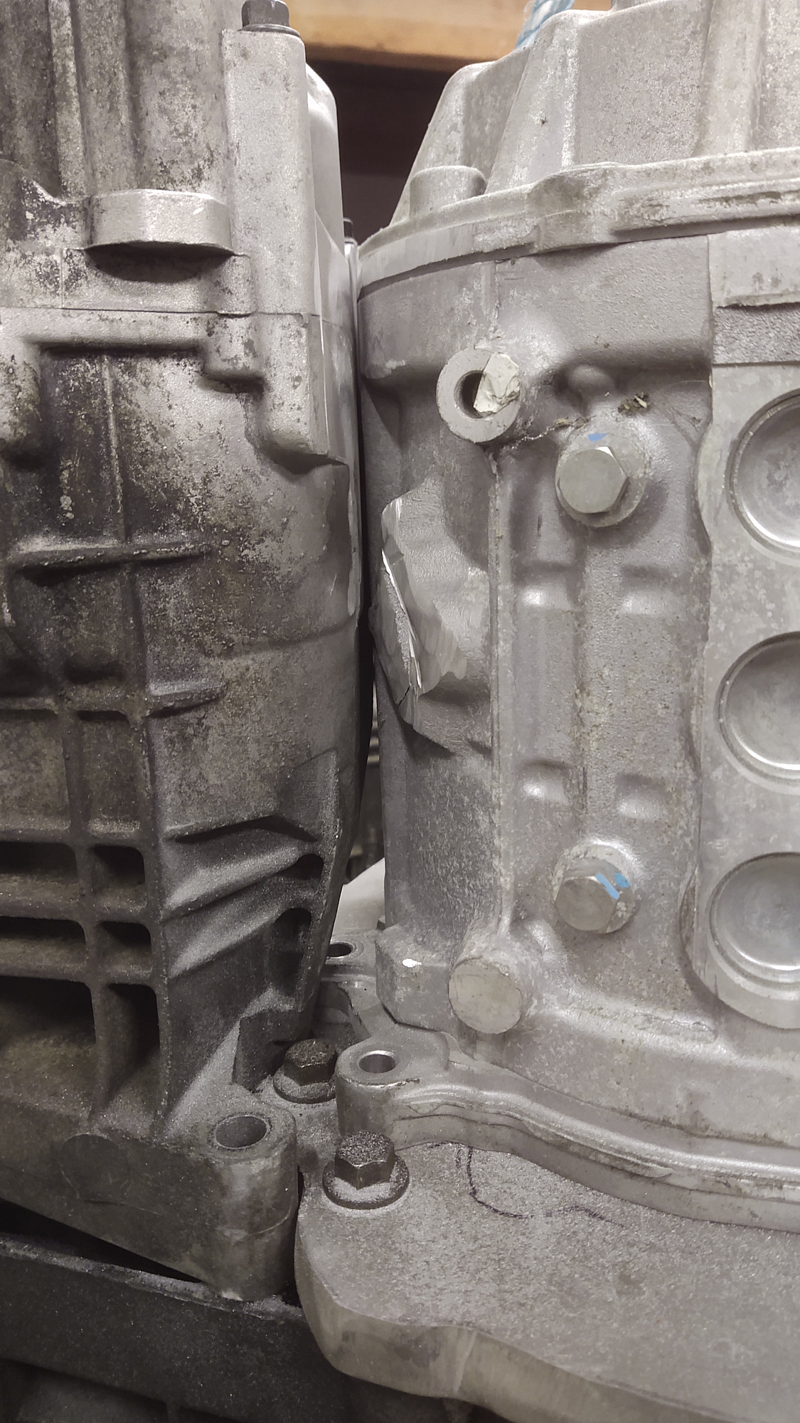

Thanks to Damien and Fiachra I was able to purchase a 2011 Nissan Leaf, complete apart from the battery. It was in great nick so I'm hoping to make most of the purchase price back from selling the parts.
This is the donor car. And this is it after a few hours stripping. Although I've spent many hours watching and reading about this kind of project I'm still uncertain how I'm going to get the Leaf motor running so if anyone has any input I'm happy to receive advice. I know Johannas has a ready made board and I'll probably end up going that way but I'm also stupid enough to think I might be able to do it myself so I might have a go before committing to anything. Once again any input from others who have been this way before gratefully received.

Got the motor and inverter seperated and out.
Then spilled half the transmission oil over the garage floor.

So the Leaf is now fully stripped of all things electric and hopefully I'll be able to sell off some of the body parts. It's not taking up too much room so I'll let it sit for now.
I said earlier that my priority was to get the motor spinning using Damiens VCU so of course I started at the clutch coupler.
I started a thread about it here
viewtopic.php?f=4&t=995&sid=988998c2450 ... 346a0c80de
And made a video about the adapter plates.
But now I've put it off long enough and I have the motor and inverter on the bench. I have to admit it is a bit daunting as I've never worked with such high voltages before. Although I've built several ebikes, this is at a waaaay different level. There doesn't seem to be much in the way of documentation for this either (yes I have the files from the github and the thread Damien started) or at least if there is I haven't found it so if there is a Wiki or such please reply with a link, but until then I'll post questions in the thread as they come up.
I've managed to solder the connectors to Damiens VCU but still waiting for the Molex plugs to fit it so haven't gone any further.

The adapter plate was now fitted with a hole big enough for the coupler.
So after lots of grinder action cutting off a motor moubt and grinding down the sides they fit but are VERY tight.
I don't know how the Fourtrak transmission is laid out but you should check for a similar issue before going too far.
I had been a bit concerned for quite a while wondering if the motor would foul the IRD so I made a temporary coupler from some pipe and test fitted the motor with the IRD bolted in.
As you can see it doesn't fit. So after lots of grinder action cutting off a motor moubt and grinding down the sides they fit but are VERY tight.
