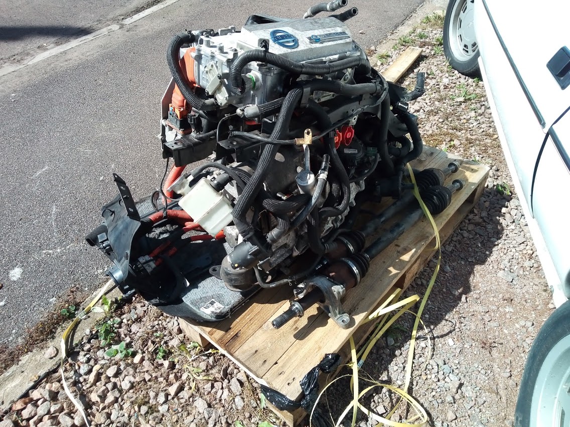

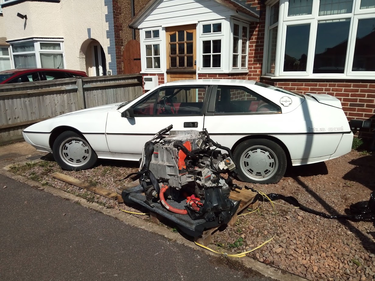

I thought I was getting a Gen1 Motor, Inverter and interconnect wiring...
The delivery truck turned up just as I was about to set off to get the van MOT'd, so I had to get the pallet unloaded very quickly and shoved onto my property before rushing off to make my appointment.
Upon my return I started peeling off the layers of pallet wrap and cardboard. What I saw first was the end of a pair of driveshafts. Once fully exposed is became clear that I had essentially the complete contents of a Gen1 Leaf front compartment, Motor, Inverter, Gearbox, driveshafts, pumps, water heater, even the charge ports.
Well chuffed!
If I made new rear suspension links and a mounting subframe, it might just be possible to use the Leaf motor and gearbox rear mounted in the Excel.
