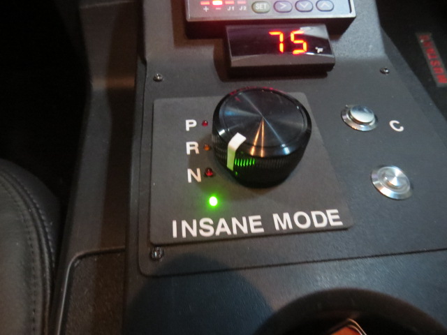

Re: Tesla Parameters Thread
Jon, I wanted to say thank you for the parameters insight and the explanations. I played with a few settings and now I can not believe the difference in performance. I'm sure myself and many others where wishing or hoping that someone along the way would do something like this as I think we are all pretty nervous about making changes since hearing all the nightmares about wiping inverter's. I have not done 0 to 60 times yet but It's insane now. Thanks again.
Here's my updated gear selector
