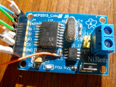

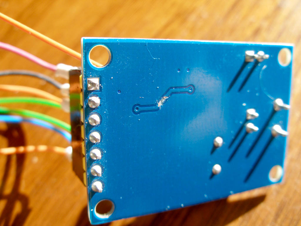

Wanted to visually document ESP8266 to MCP2515 development.
TJA1050 requires 5V but the inverter ESP8266 powered by 3.3V. We can still power MCP2515 chip with 3.3V but need to isolate CANBus chip by cutting off back PCB VCC trace. Then give TJA1050 separate 5V.
