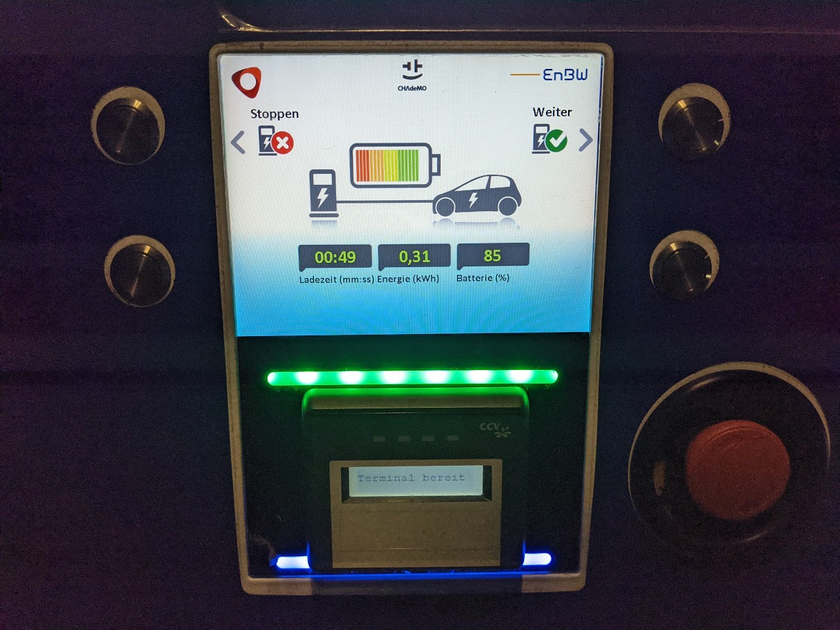

- 2 Battery Chargers in Parallel. Now i can slow charge at 6.6 kW. Planning on installing another charge socket for 2 phase charging ability in the near future.
- CHAdeMO Fast charging Socket and control box. Controlled by Orion BMS 2. Priximity is inverted in software - they told me appearently no one befor used the proximity detect feature! Had to fix the inverted byte in my own ECU.

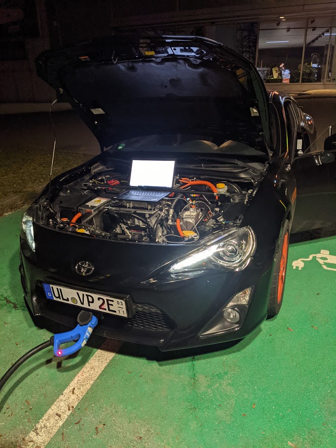

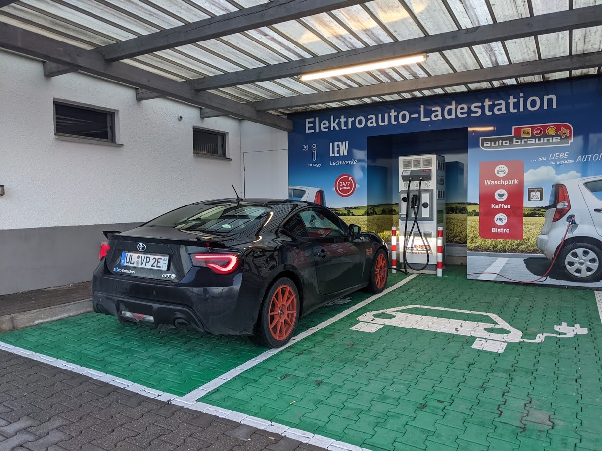

I found a neat place to install my CHAdeMO box: Under the front bumper. It's still slightly behind the crash bar so won't be the first thing to smash in case of a crash. Also it's a very rubust metal box. And here's my charging port. After thinking for weeks about where to install it, this was the best option. Still not very happy with it!

The Eltek Chargers i'm using arent water-cooled. One Charger at 3.3 Kw was fine, but due to space limitations i hat to put the second charger on top of the first. So i decided to air-cool them, in case they get too hot. Therefore i've had a fan shrout lasered out of aluminum, to put two powerful SPAL fans on it. They will be controlled by a thermostat or by CAN-Bus, haven't finally decided yet. The internal Charger-Temperature is on the CAN-Bus already. So it would be easy to turn the fans on if one of the chargers gets too hot.

That's a tidy contactor box!
I think the CHAdeMO port needs some additional moisture and dirt protection. Otherwise if you drive through rain the EVSE could detect an isolation problem. Or worse, the contact area for high current is reduced by dirt or corrosion.

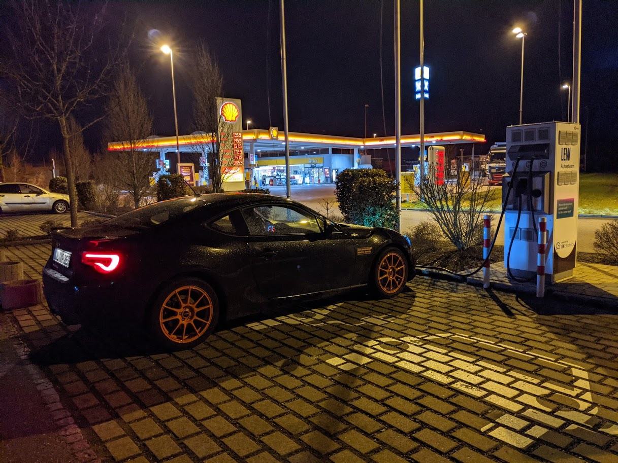

As i'm working on my air conditioning, i have a few questions.
The air conditioning compressor looks like an 18cc Benling compressor. How did you come up with this size, which refrigerant and oil do you use, and how do you know the filling quantities?
And last but not least, do you only cool the interior, or do you also cool the battery?

Re: Toyota GT86 with Nissan Leaf Motor
I use the standard filling quantities that Toyota suggests in their manual. The whole system is the same as before besides the compressor itself. I don't use R1234y as specified by the manufacturer. I used a propane/butane mix in the past in other systems with great success and will do the same here. It's cheap as hell and yes, of course it's flammable, but R1234y is dangerous, too. (of course i have to calculate the filling quantity according to the density difference of R1234y and my Propane/Butane mix).
I will have the system fully connected and running next week, then i can tell you more about cooling efficiency and so on.
It's only used to cool the interiour as we rarely have temperatures that actually really need a battery cooling.
I think battery heating would be more important here in Germany

Finally i managed to add rapid charging to my car. Now i can drive long distance - with the 30kWh Battery Pack and the CHAdeMO port this is going to be fun. Alltough my car is kinda inefficient. I use about 20 kWh / 100km. I think its mainly because of the ultra high performance tires. Will swap them for something more fuel efficient but still fun to drive and hope i get down to 16 tp 17 kWh / 100Km like Johannes in the Touran.

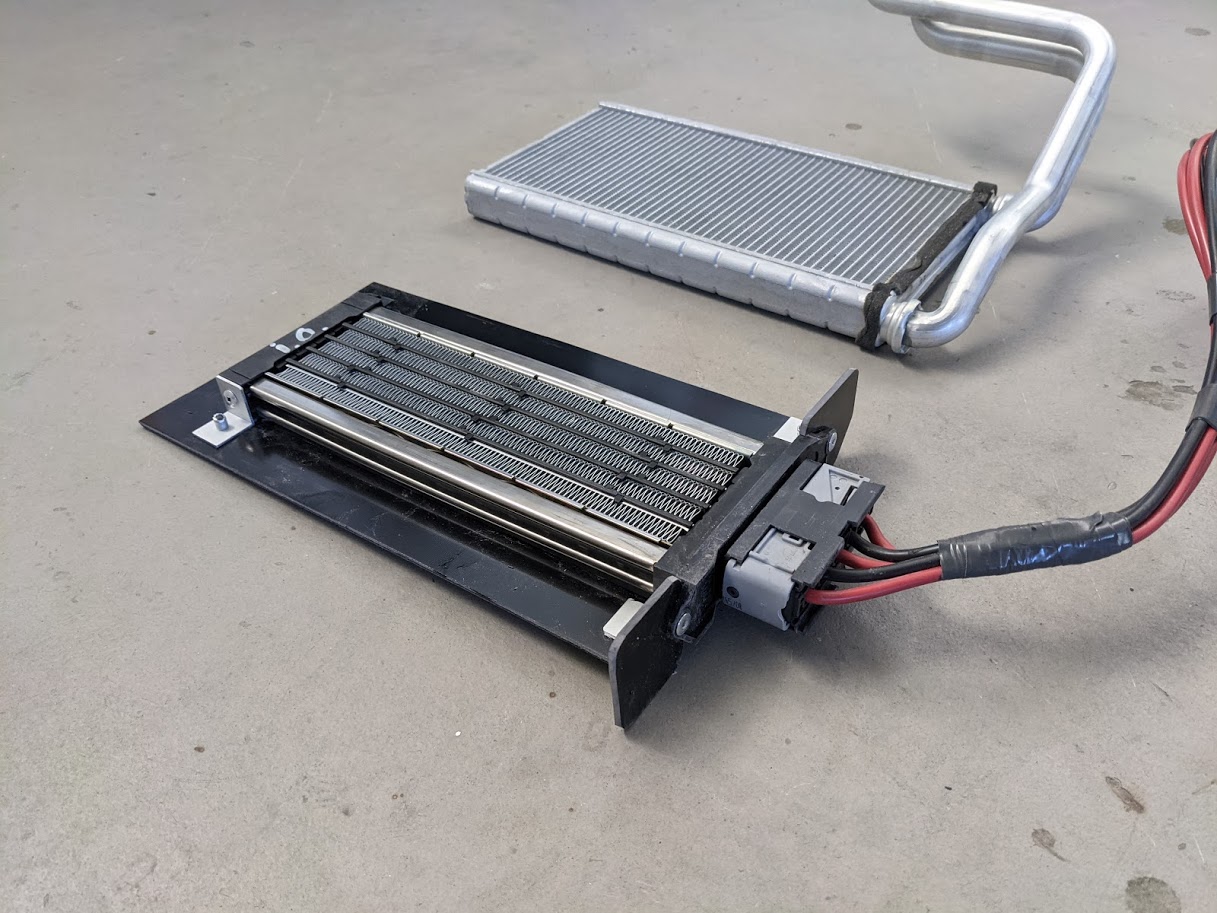

I installed the heater, which was a real pain in the ass!
I had to take the whole dashboard out and the pedals also as the complete electric power steering and steering column.
In the pictures i already had the pedals and the steering column reinstalled, so it looks less worse than it actually was
Took me a whole day of 12 hours to complete the job. And still i have to wire it up.
It is connected to a microswitch that i mounted on the heater matrix actuator. It also can only turn on when the blower is on.
As it runs on 12V this is very important. I decided for 12V because of its simplicity. The heater is out of a Subaru forester and fits nicely with my self made glass fiber adaptor in the place where the heat exchanger has been before.
I only drive the car in the warmer month's of the year, so all i need is decent amount of heating to clear fog or very little ice of the windshield in the cold mornings. 1200Watts should be enough to do the job!

Here's my feedback to the ptc heating element: More than i expected! I just drove the car at 4 degrees celcius outside temperature, today was a bit of a snowy day. And still, there is a warm breeze blowing out of the vents. It's not like super hot, but satisfying warm. With the blower set to full power 1200W just aren't enough to blow warm air out of the vents. But if i set the blower to medium or less power it works very well. So yes, 12V heating is possible, but don't expect it to be exremely hot like with a combustion engine. The Tesla DC DC converter pulls more kWh out of my high voltage battery pack as soon as i turn it on. 100 amperes out of 12 volt are quite a bit so i decided to crimp it to a 35mm² cable that leads to a relay that is controlled by the OEM actuator and ignition 12V. The cables do not get warm, even after 30 minutes of having the PTC turned on.

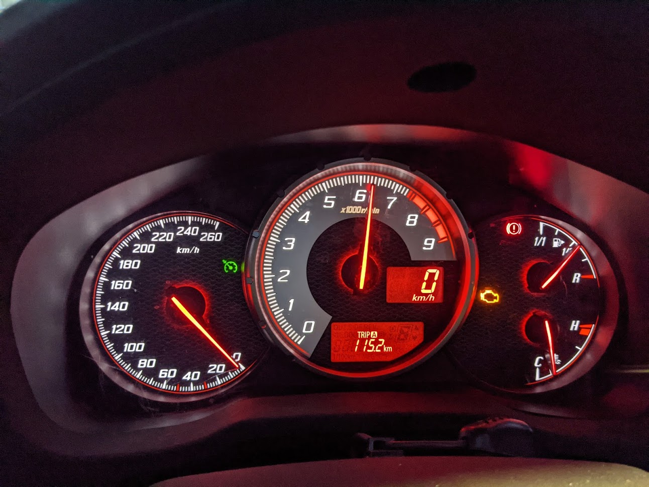

HVAC Systems all functional and no extra switches are needed, everything is controlled by the OEM controls. I'm all about the OEM-Feeling!
My rev counter shows me the SoC when the Charge-Interlock-Bit is set. Nice feature, so you can literally watch your car fill up - and it just looks so cool! Works with j1772 and CHAdeMO.
// CAR IS CHARGING
if (BMS_Charge_Interlock) {
RPM_Charging = (((BMS_SoC/2)*100)-RPM);
RPM_2 = RPM + RPM_Charging;
else
RPM_2 = RPM;
// CAR IS CHARGING END
Today i did my first longer range trip in the car. 220 Km at a outside temperature of 3C° to 6C°.
Start: 100% SoC, 398V, 4.15V per cell / Batt Temp 12C°
Total Km: 115Km / 86Km Highway with max 120 Km/h / 29Km country roads with Max 100Km/h
Stop: 4% SoC, 337V, 3.52V per cell
Charged: 18,4 kWh in 30 Minutes
Start: 95,5% SoC, 384V, 4,00V per cell / Batt Temp 28C°
Total km : 65km / 65Km Highway with constant 130 Km/h
Stop: 16,5% SoC, 336V, 3,5V per cell
Charged: 18,6 kwH in 37 Minutes
Start: 94,5% SoC, 386V, 4,02V per cell/ / Batt Temp 46C°
Total km: 40Km / 25km Highway with constant 130 Km/h / 15 Km country road
Arrived at home - didn't recharge there so no information gathered. Temperature was still 46C°
Conclusions:
- When my temperature had risen above 35 degrees at the second charge temperature derating kicked in and it took longer to charge the car.
- I stuffed the thermistors far in the inner of the cell, which is pretty easy as they are not very big. On the leaf they are more on the surface. I have to change the position. If i measure the core cell temperature my charging curve gets's worse. Sure i could adjust it in the Orion BMS, but i think the utilisation of the OEM measurement point makes more sense here.
- When i charge on CHAdeMO my SoC rises faster than my battery cell voltage. This means it starts derating earlier than necessary.
Not sure yet where to adjust here to get a safe and proper but fast way of charging. Obviousely i'm missing about 3 kWh to 80%.
- Is my 4% Limit appropriate for the leaf cells? Are there any experience from your cars out there?

Nice trip and nice feature with the rev counter The fuel gauge also works during charging?
I don't quite understand the numbers. You said you have a usable 27 kWh but your charge from 4% to 95.5% was only 18.4 kWh. Doesn't add up. I think the reason is that 4.00V is not 95.5%. Maybe Orion miscalculates that from the voltage under load?
I don't have any systematic data on the temperature throttling but I do think the Leaf BMS throttles later. Above 40°C I'm quite sure. And it wants quite some heat to even allow full charging power. 30°C or so?
