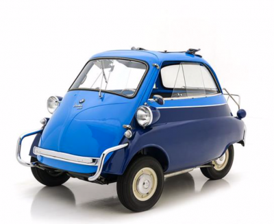

Hi everyone. Your help would be most appreciated. I can barely fit an electric socket on a lamp cord, but still read and want to engage
To summarize, a BMW Isetta "bubble" car from 1960, 4 wheel version, to be converted for inner city use. I prefer a minimal/reversible conversion, so only swapping out the ICE but keeping the Trans (not interested in hub motor). With only a 13hp engine currently (single cylinder motorcycle engine), it would seem that I need a very modest motor, and battery -- a used e-motorbike should be good for most parts; Alternatively, a new e-motor but also, low powered (but less cost effective).
A unique challenge is a real lack of space for batteries. If I re-position the original 12v small battery from it's under seat location, there would be enough clearance for a single Tesla model S dimension battery, but at 5.3kwh, not much capacity (also, I assume Tesla batteries are meant to be used for applications with more power needs). I'm just mentioning Tesla to give a feel for available space based on the battery form factor/dimensions. There could potentially be space for another Tesla model S dimension battery in the engine bay.
Details below:
Project: BMW Isetta, 4 wheel version
Current Layout: ICE, Transmission, and a chaincase with integrated rear axle (no differential as rear wheels very near to each other).
Car Weight: 350kg minus approx 50kg in ICE related parts (engine, filter, exhaust, muffler, carb, etc)
Design (I think): Swap out ICE for e-motor and use existing transmission, chaincase,etc. (Not in-hub motor).
- Power: Same or slightly more power than original engine (ICE: 13hp
- Range: Inner city use, I'm sure 50miles is great. Assume 8 or 10kwh would be enough.
- Special challenge: Very little space for batteries, and probably shouldn't add more than 50-70kg in extra weight.
(space available for charger, controller, controller radiator if needed, junction box)
Any suggestions? Parts or motors to look at? Battery is a BIG question...
Thanks. Baron (London, UK)

I'd start by mapping out exactly what space you have before spending any time thinking about the hardware. It would also be useful to provide details of the existing drive system.

First of all, welcome to the forum! And what an excellent conversion idea!
Now in terms of parts you'll need:
13hp is very little. Let's say a 10kw continuous drive system; that's about the same horsepower, and a 10kw continuous rating means you can use 20kw for acceleration if needed.
Since you don't need the highest power then a lower voltage setup would work well. 48v or 96v would be sensible; it also helps keep battery size and potential electrocution hazards down.
How about a motor like this: https://www.voltsport.co.uk/voltsport-m ... rgy-me1114
Weight of 35lbs, voltages up to 72v. Torque maximum is 65Nm.
And this might be a good controller to pair with it: https://www.voltsport.co.uk/voltsport-m ... duct_id=57
This was the result of 20 minutes of googling by the way. Salvaging an electric motorbike sounds even better; I haven't seen any where I am in the States, but maybe you all have more of those. Of course you'd need to figure out how to control the motor etc, either by use of a OpenInverter board or using the original system. It might be difficult to connect a motorbike motor to a transmission, also the RPM range might not match well.
In terms of batteries, the Tesla modules ~24V each. So if you want to use those probably go for 3 of them. Tesla modules have a good power to weight ratio.
I have no idea how much capacity you'll need to get 50 miles of range; the Isetta is rather a special case (I saw one at a car show, wow it is tiny!)
Best of luck!
-Isaac

For parts i think Isetta falls in category of Renault Twizzy vehicle, therefore i recommend you go and get that motor. Then you use Prius/Auris/Yaris inverter with Johannes brain. For battery i suggest VW hybrid battery 9kWh folded in halfh for 180Vdc and SimpBMS.
Charger... well you could use Prius inverter from single phase rectified.
DCDC is also inside Prius/Auris/Yaris inverter.
My 5c

This is cool -- except I can't find any details on the 9kwh "folded in half" battery. Is there a name for it? can it be found on ebay or elsewhere? I'm trying to get a feel for the dimensions. Thanks.arber333 wrote: ↑Thu Jun 04, 2020 12:35 pm For parts i think Isetta falls in category of Renault Twizzy vehicle, therefore i recommend you go and get that motor. Then you use Prius/Auris/Yaris inverter with Johannes brain. For battery i suggest VW hybrid battery 9kWh folded in halfh for 180Vdc and SimpBMS.

What Arber means is that the 9Kwh VW battery, which is 360v, will be split in half and then connected in parallel. Thus the voltage will be 180Vdc. That would be a good capacity for such a light car, and also help keep the total weight down. Arber, do you have a link to this battery? I'm not familiar with it.baronofbloomsburyuk wrote: ↑Fri Jun 05, 2020 5:59 pmThis is cool -- except I can't find any details on the 9kwh "folded in half" battery. Is there a name for it? can it be found on ebay or elsewhere? I'm trying to get a feel for the dimensions. Thanks.arber333 wrote: ↑Thu Jun 04, 2020 12:35 pm For parts i think Isetta falls in category of Renault Twizzy vehicle, therefore i recommend you go and get that motor. Then you use Prius/Auris/Yaris inverter with Johannes brain. For battery i suggest VW hybrid battery 9kWh folded in halfh for 180Vdc and SimpBMS.
My 5c
It would be good for you to decide what voltage range to use; either the 72v system, or a higher power 180v system. Any higher voltage is probably overkill; you don't need very much power.
The low voltage systems are usually more or less turnkey (all the components can be bought off the shelf). All you need from there is a battery and some wiring.
A system like Arber is suggesting, with the 180v battery, is lots more fun. It would involve getting a used inverter and retrofitting a board from Johannes, then finding a motor and learning how to connect it to the inverter. Then you must tune the inverter to work well with the motor and with the battery. Also it tends to end up costing less (depending on how many things you blow up; trust me, it's fun )
-Isaac

I have one 9kW WV Passat hybrid battery here in my workshop. I use it as a test piece. It has BMS installed, it has contactors and precharge relay and main fuse. It is liquid cooled and it assembles like lego .
