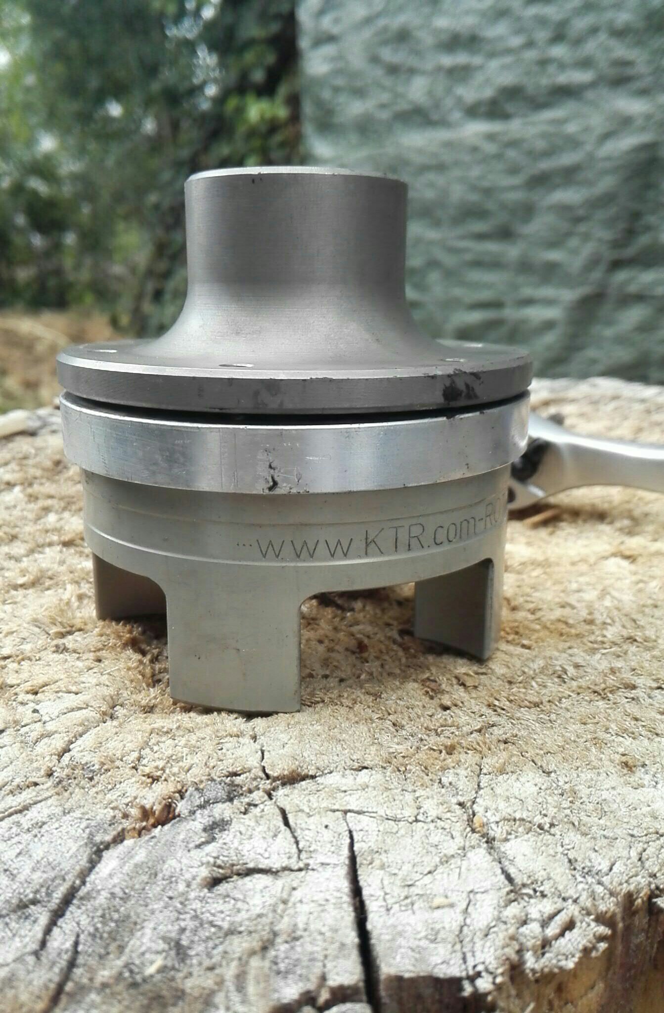

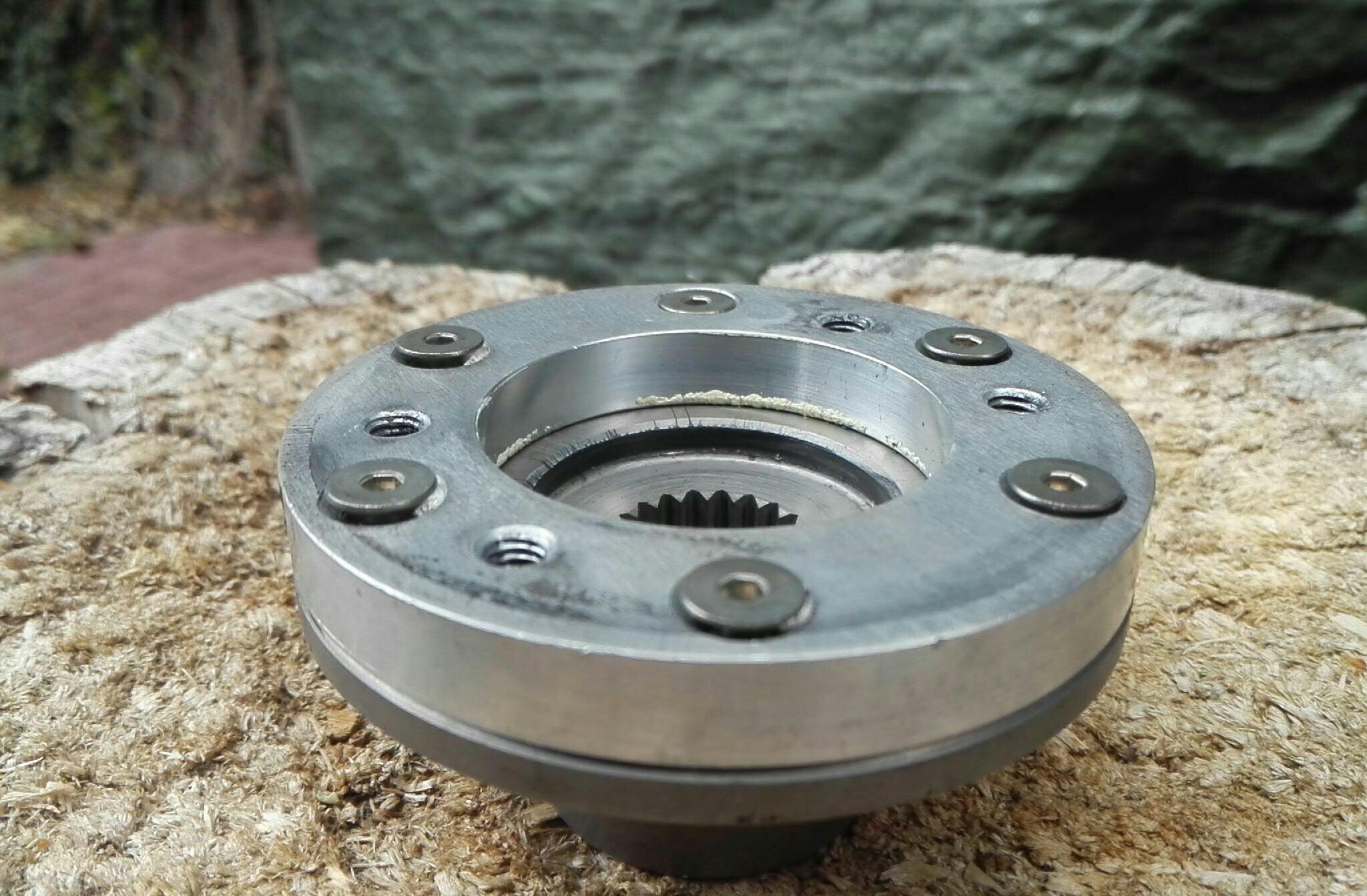

Today I had to rip gearbox and motor apart. I started out by investigating the increasing hum that now even started at 3000rpm. Stuck my gopro in the starter motor hole and a lamp in clutch hole and started filming. Wobble alarm
So turned out the screws holding Leaf spline and distance ring as well as distance ring and clutch had come out quite a bit! Added some Loctite, put it all back together, and - silencio

Nicely caught in time...

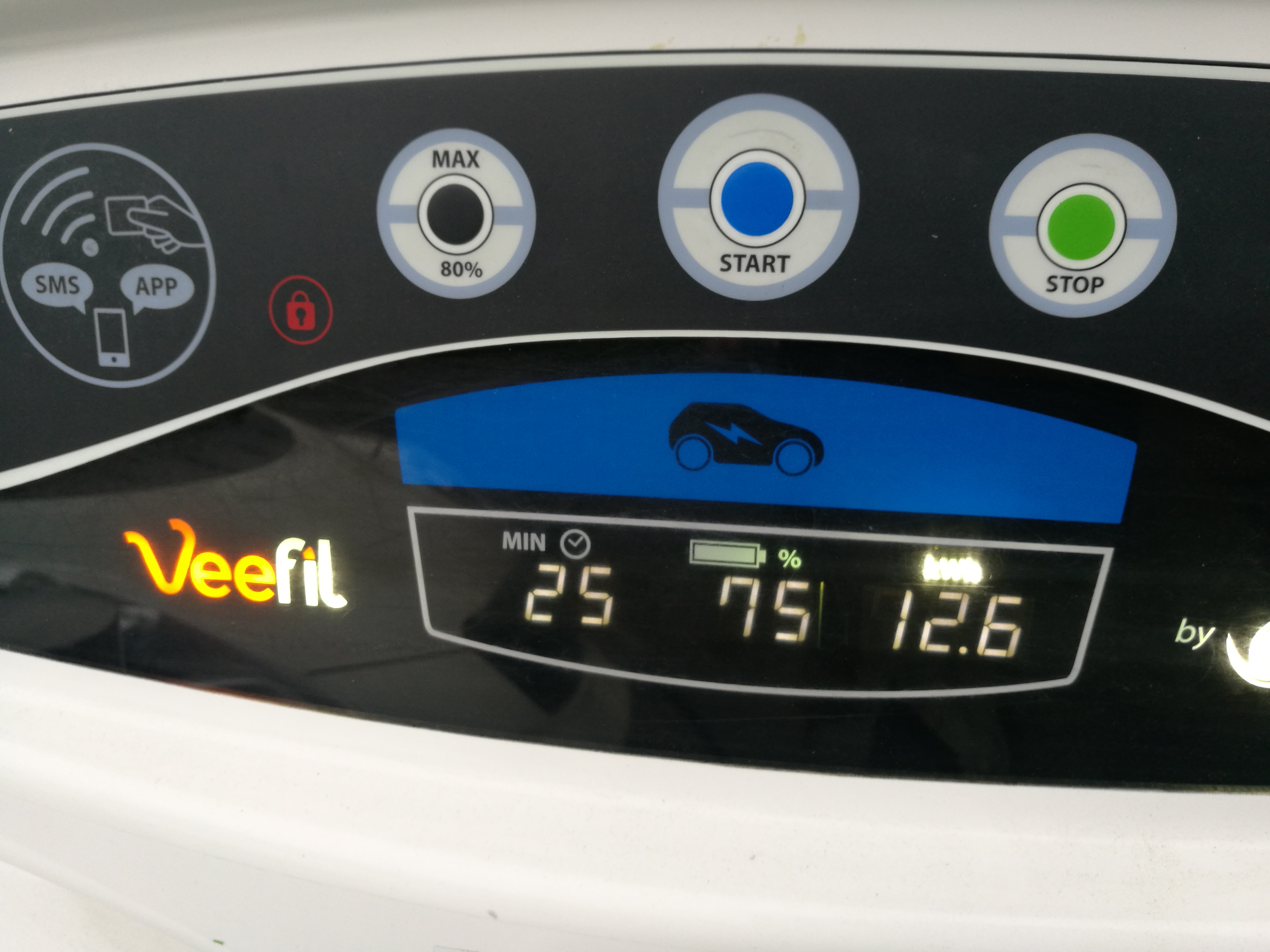

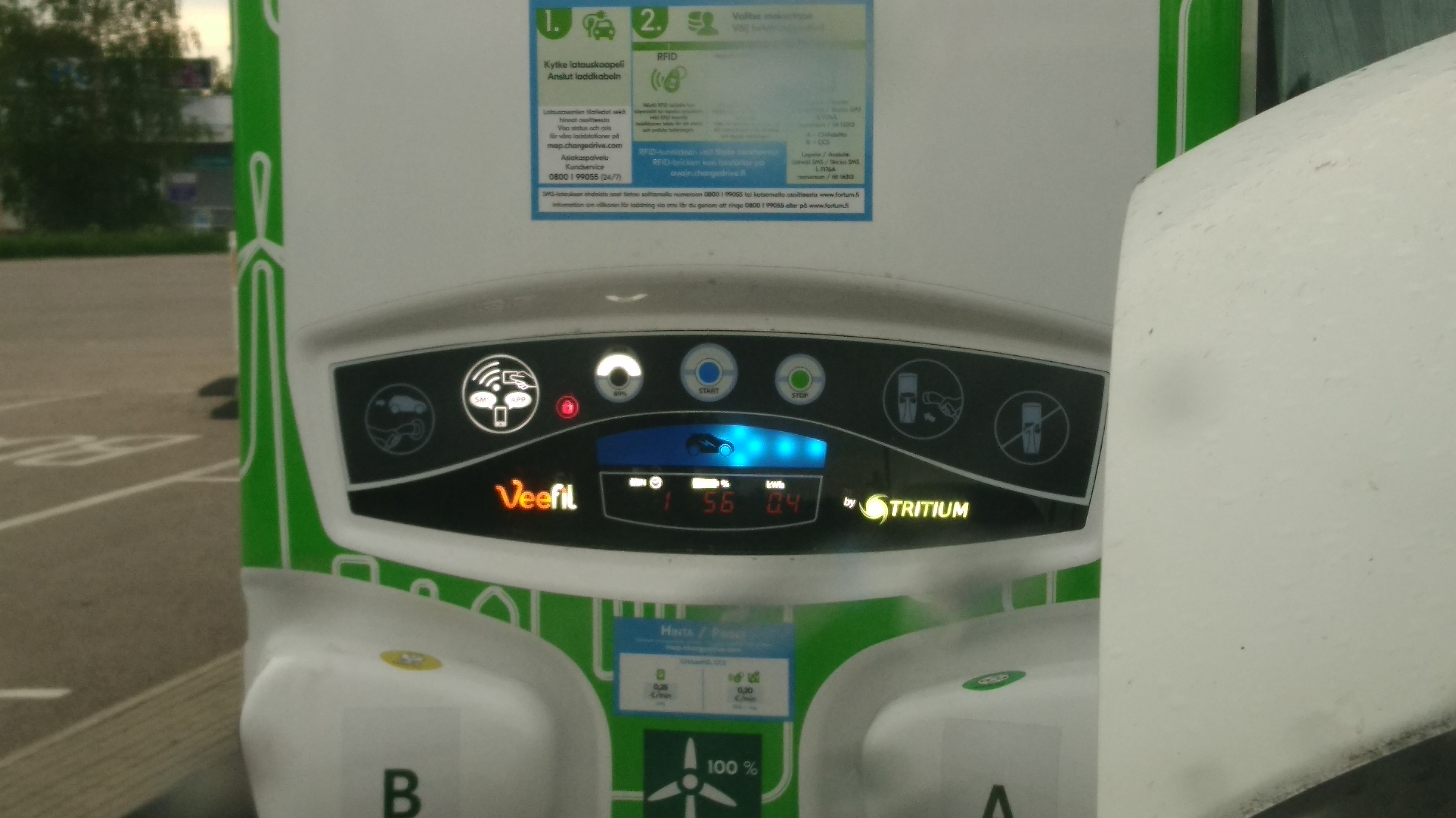

Did you charge at any Veefil chargers? Those slim, round, plastic looking ones. I've attached the best photo I could find from my collection, but just search the name on the 'net for a better one.
I've never been able to make one of those reliably charge for me. I've tried tens if not hundreds of times and maybe succeeded randomly once and I have no idea why. The charger's non-existent error messages and barely existing user interface doesn't help.
I'd like to know if this has been a problem for your DIY CHAdeMO system.

Never seen one of these in Germany only know them from Teslabjörn videos. Would be an interesting challenge. Did you have a chance to record the CAN messages? Or any other debugging tools?
I spent many hours in front of the ABB charger literally changing the software between attempts and dumping out values. That finally got it working. I think I used 3 brands on my trip, no problems so far.

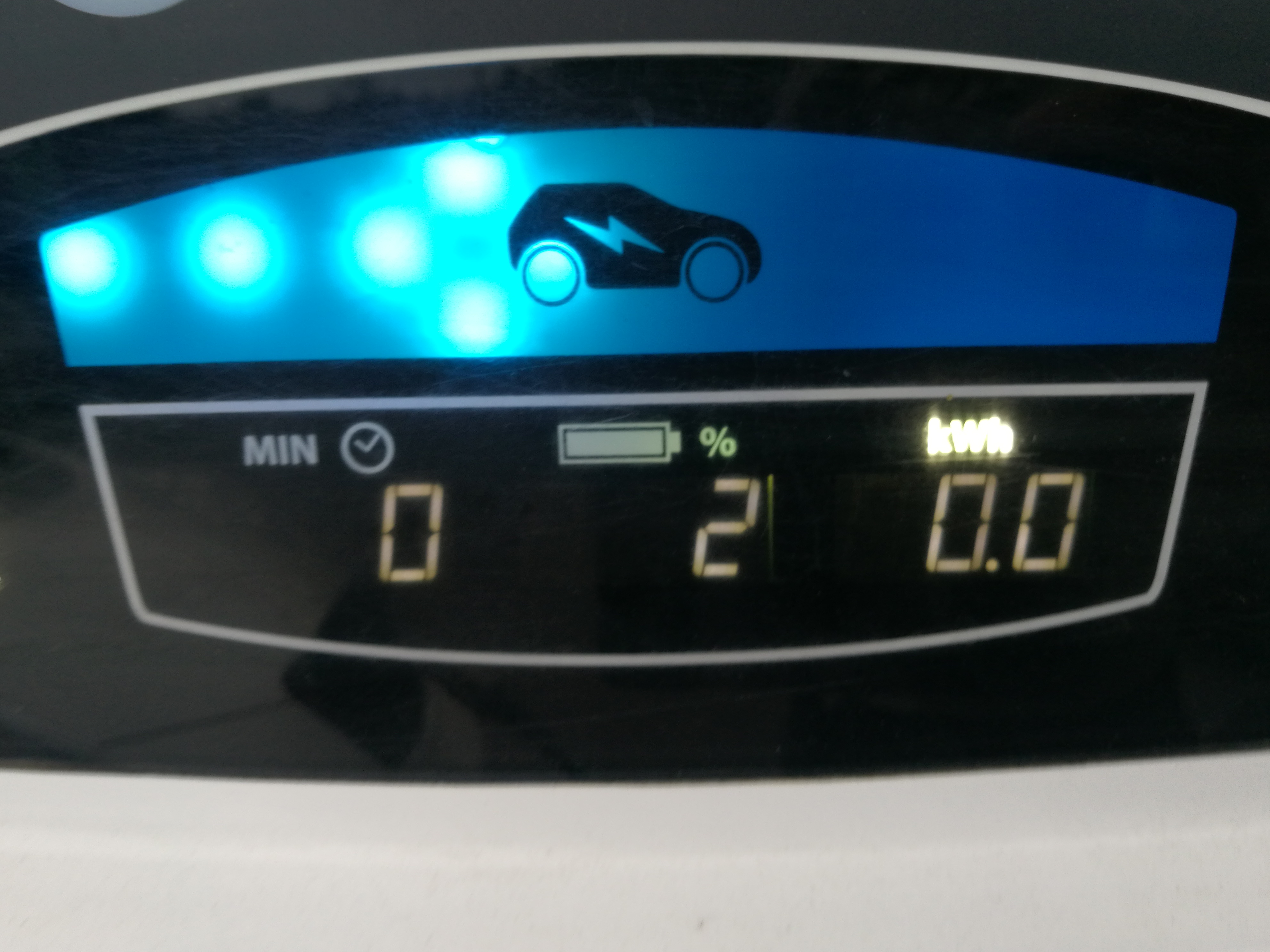

Yes they work fine, only one time in Norway it didn't work because the emergency stop was pressed by someone, called customer service and asked if there is any issues and they told all is good and I can pull it back on. Worked fine. They do often have some audible coil whine etc. sound.
Let's continue this offtopic testing in email.
Here is how low a leaf can go.
