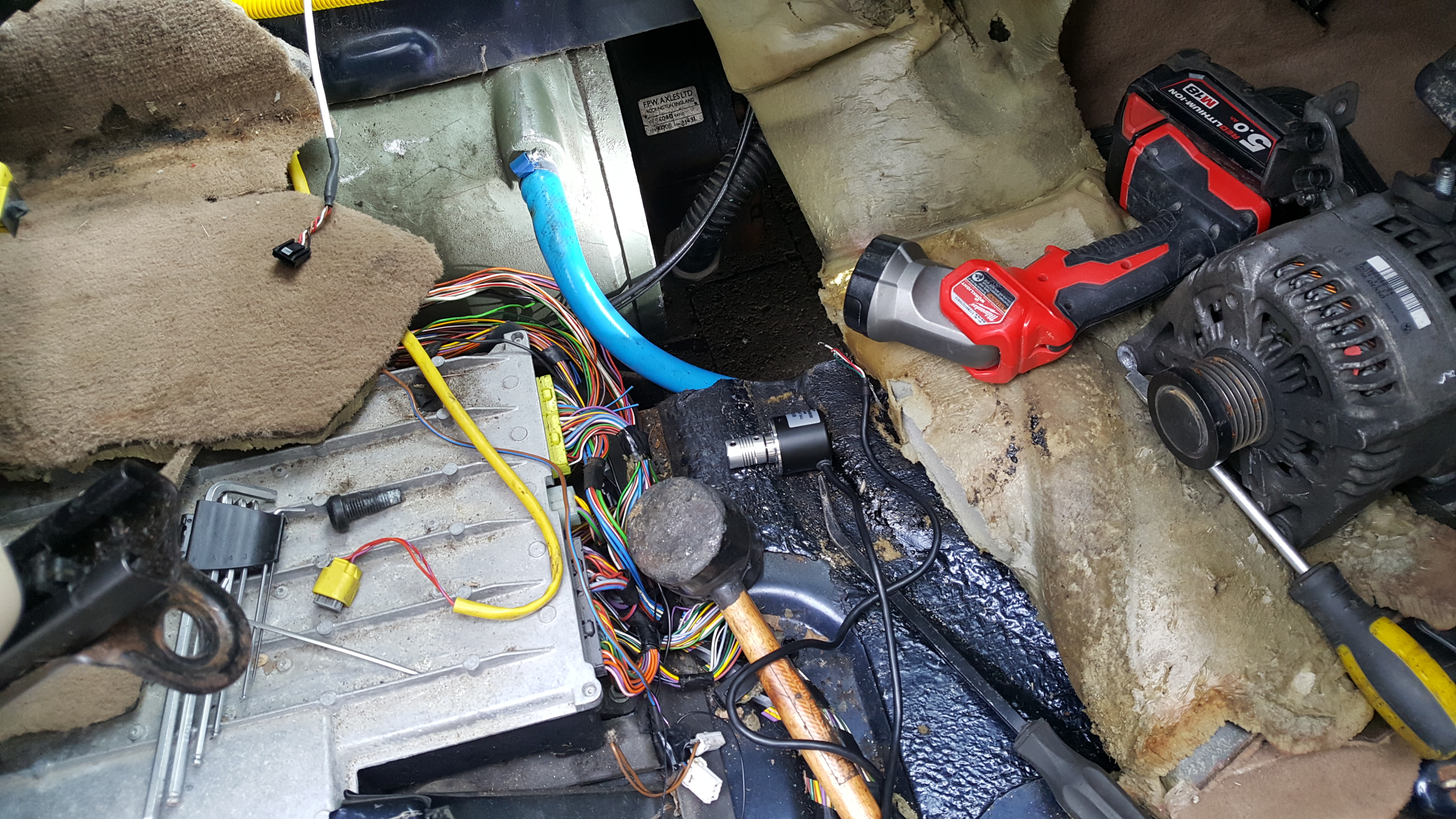

Ripped out the original encoder today on the rear drive motor on the range rover and replaces with this thing from ebay. Very big improvement. Not perfect, but much better. Never thought I'd be thanking the clown who cut out the floor...

Are these waterproof? I consider swapping the one in the Polo as it recently played up
