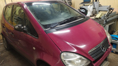

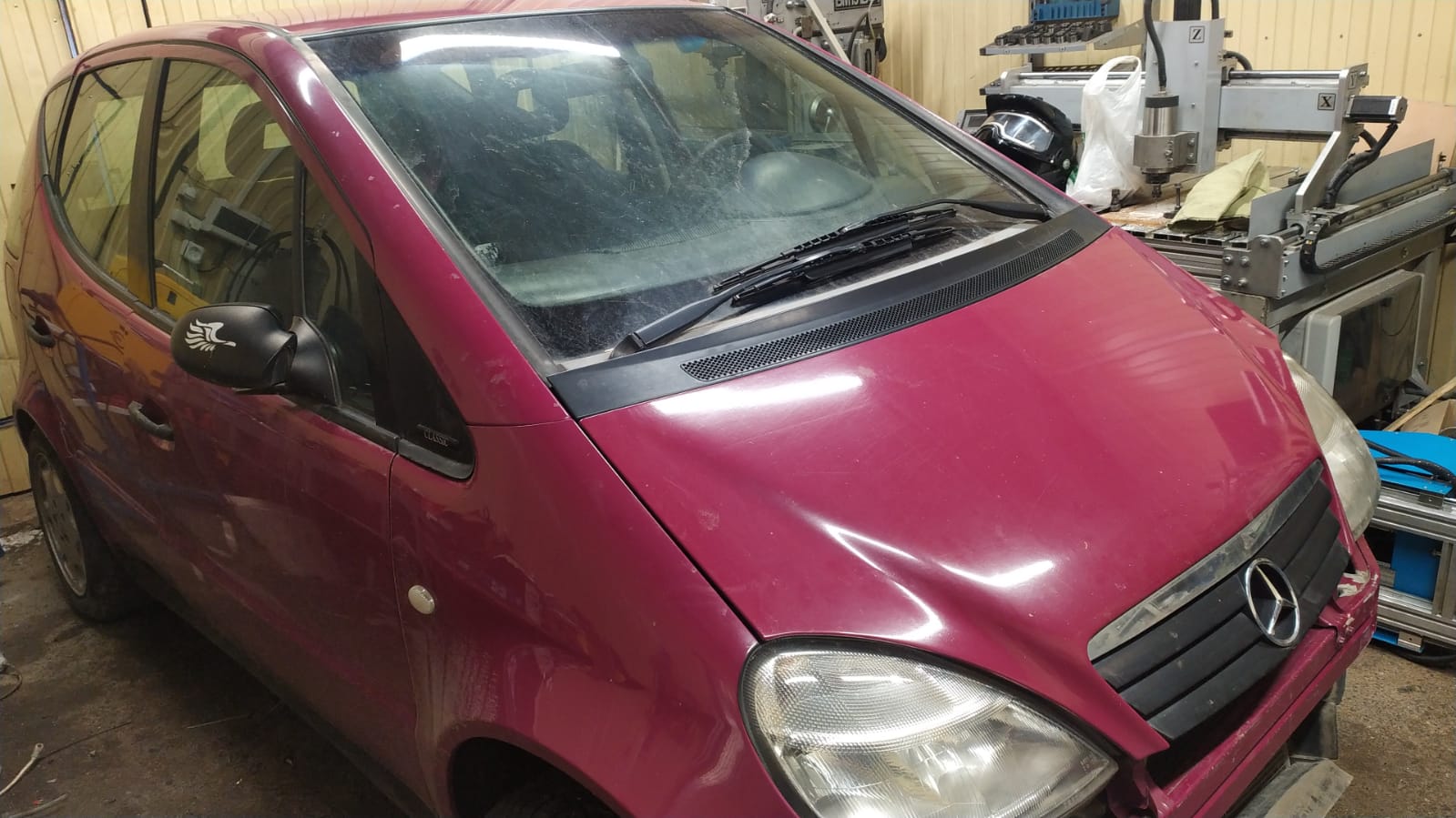

I bought an inexpensive donor for an electric car project. Good condition, great price. Plenty of space under the car for the battery

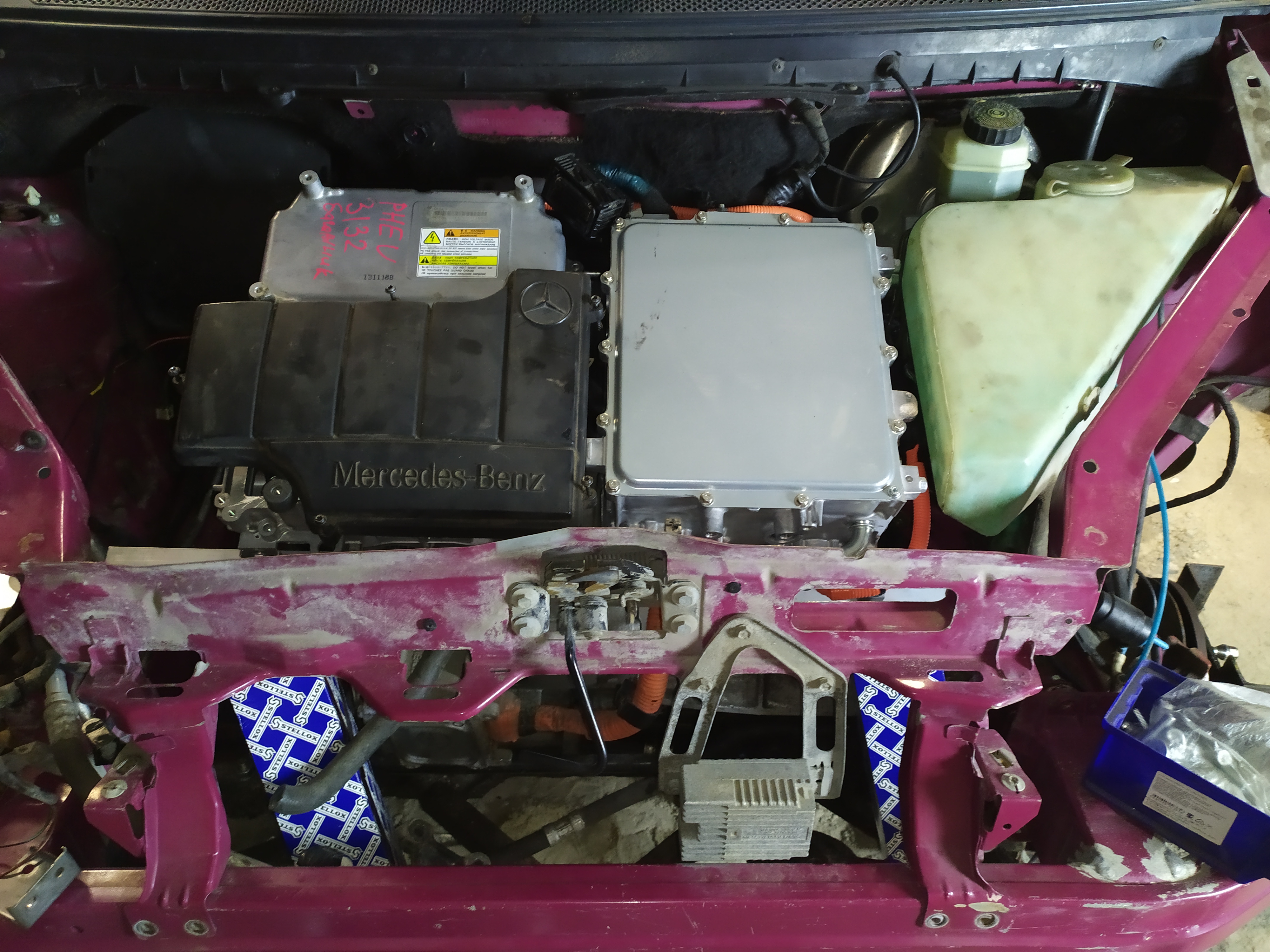

engine start

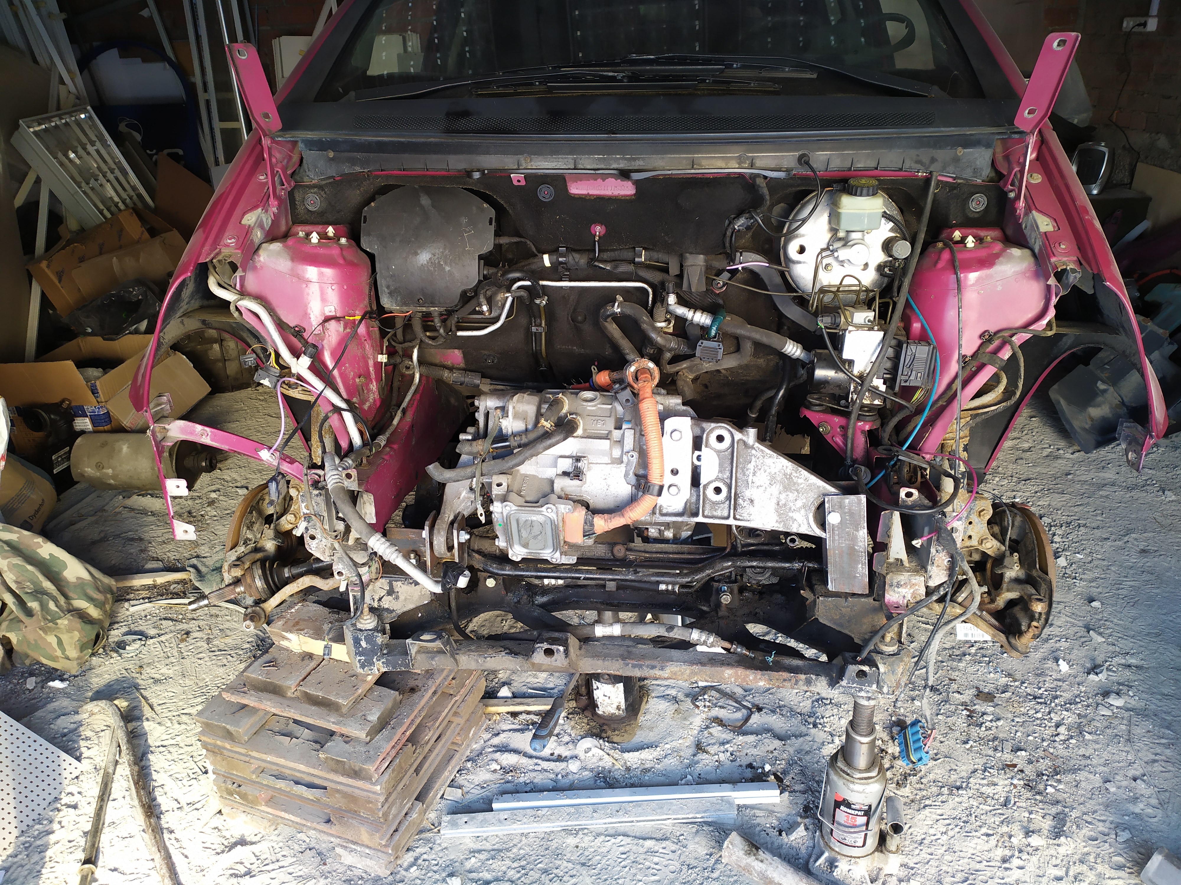

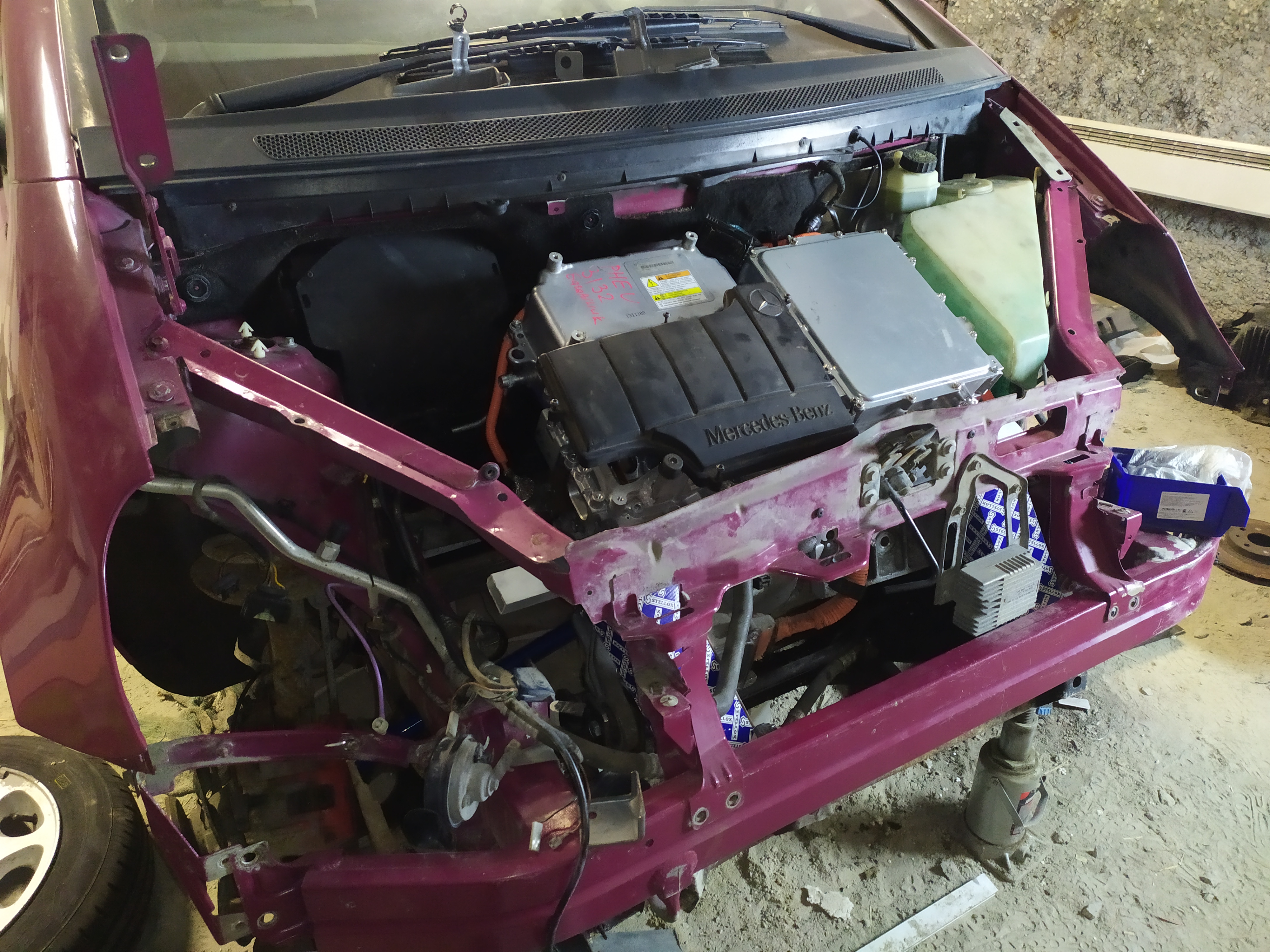

Work continues, not as fast as I would like

Re: A classe W168 - Outlander Rear differential
What inverter is it? And what's the other grey box?
johu wrote: Tue Apr 05, 2022 6:22 pm What inverter is it? And what's the other grey box?
Looks to be rear inverter and charger DCDC from an outlander PHEV.
The Merc engine cover must be throwing you off :P
Post by midway »
tom91 wrote: Tue Apr 05, 2022 6:33 pm
That's right, it's the air filter cover. It is impossible for us to formalize the transformation, so we need to make it impossible to understand that changes have been made. :D
To the left of the inverter, a Webasto heater tank of 7 liters will be installed, and under it the heater itself.

Unfortunately, I got a donor without an engine, I can not get a CAN bus listing for emulating the signals of a running engine. Does anyone have a can bus listing of a running W168-W169 engine?
I removed the oil and pump from the steering rack and installed electric power from the outlander.
