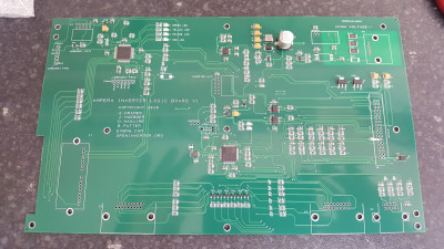

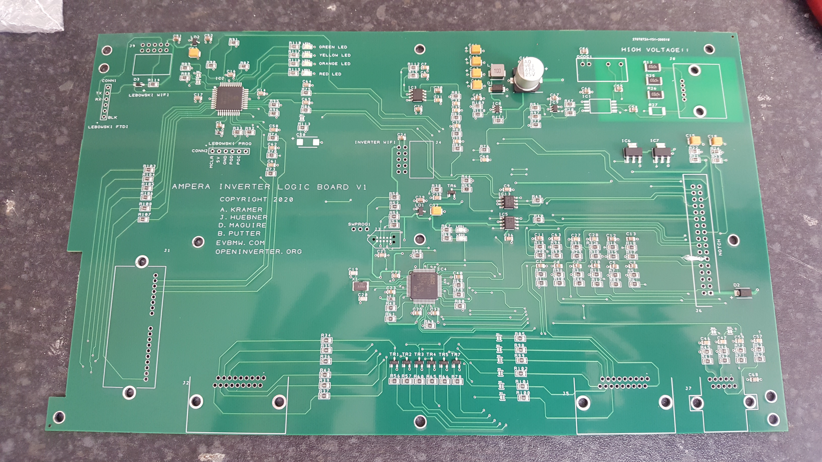

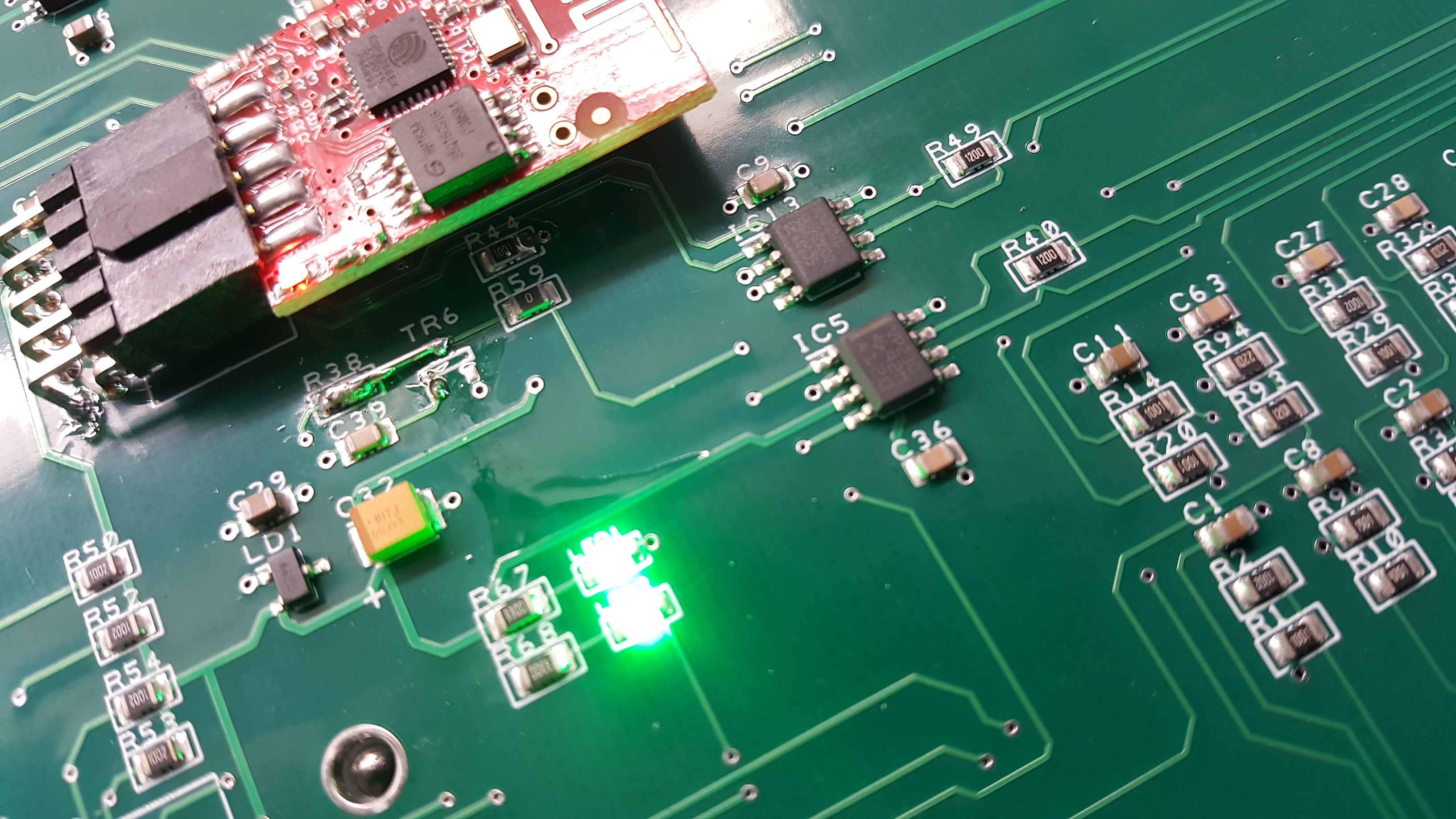

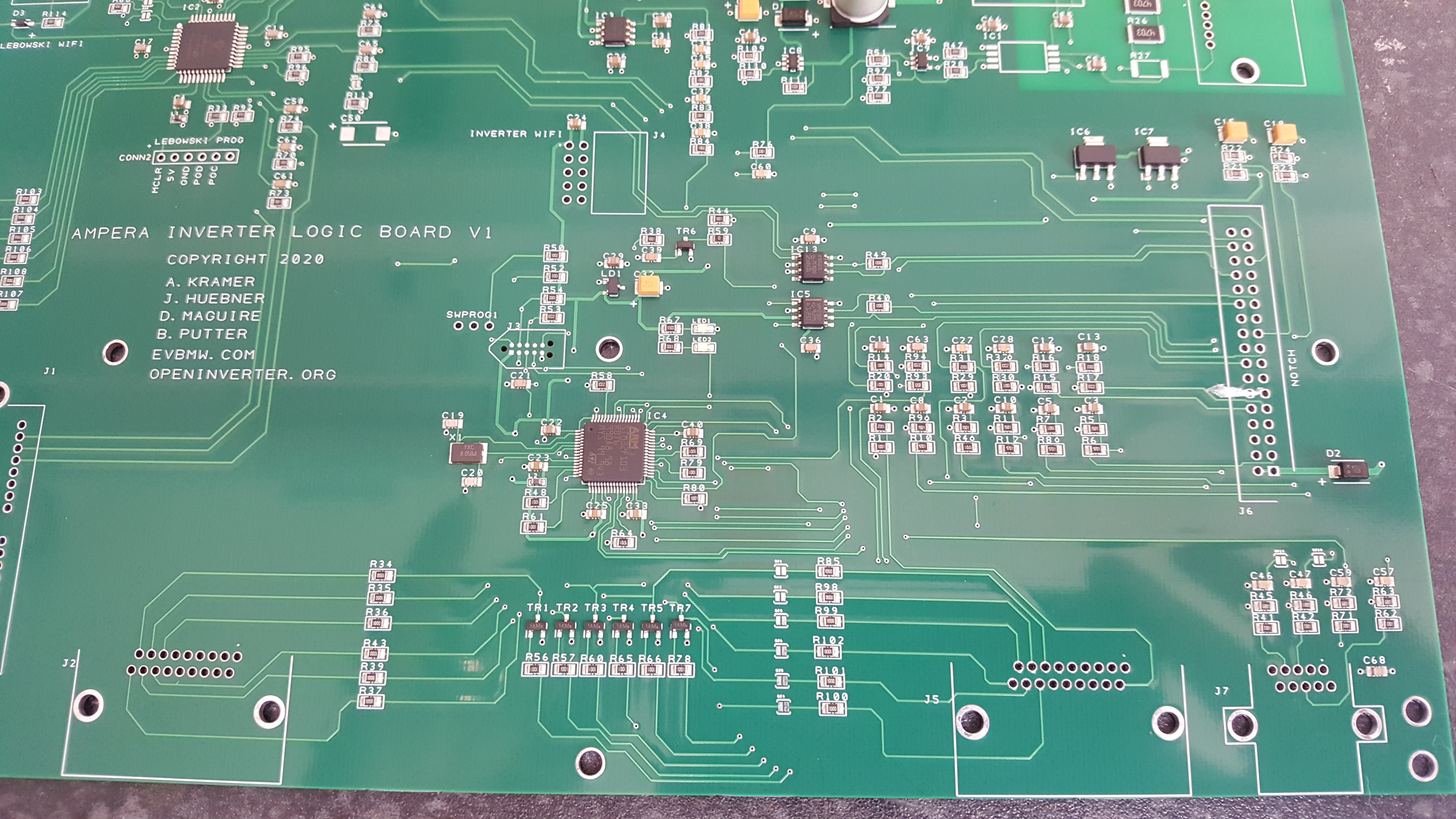

Just arrived:)

Nice!
Posts: 3795
Been thanked: 411 times
Re: VOLT/AMPERA inverter single controler dual IGBT drive
Woho! Really nice.
I see you use transistors to invert PWM signals. I thought to use SMD inverter chip myself.
Did you account for the encoder/resolver interface? I dont see it there?
Also i would advise to use bigger pins for the output signals. Well unless you intend to use the Ampseal header on separate board maybe?
We need to get Lebowski working with Wifi passthrough. That should be priority. Everything else should work as is...

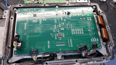

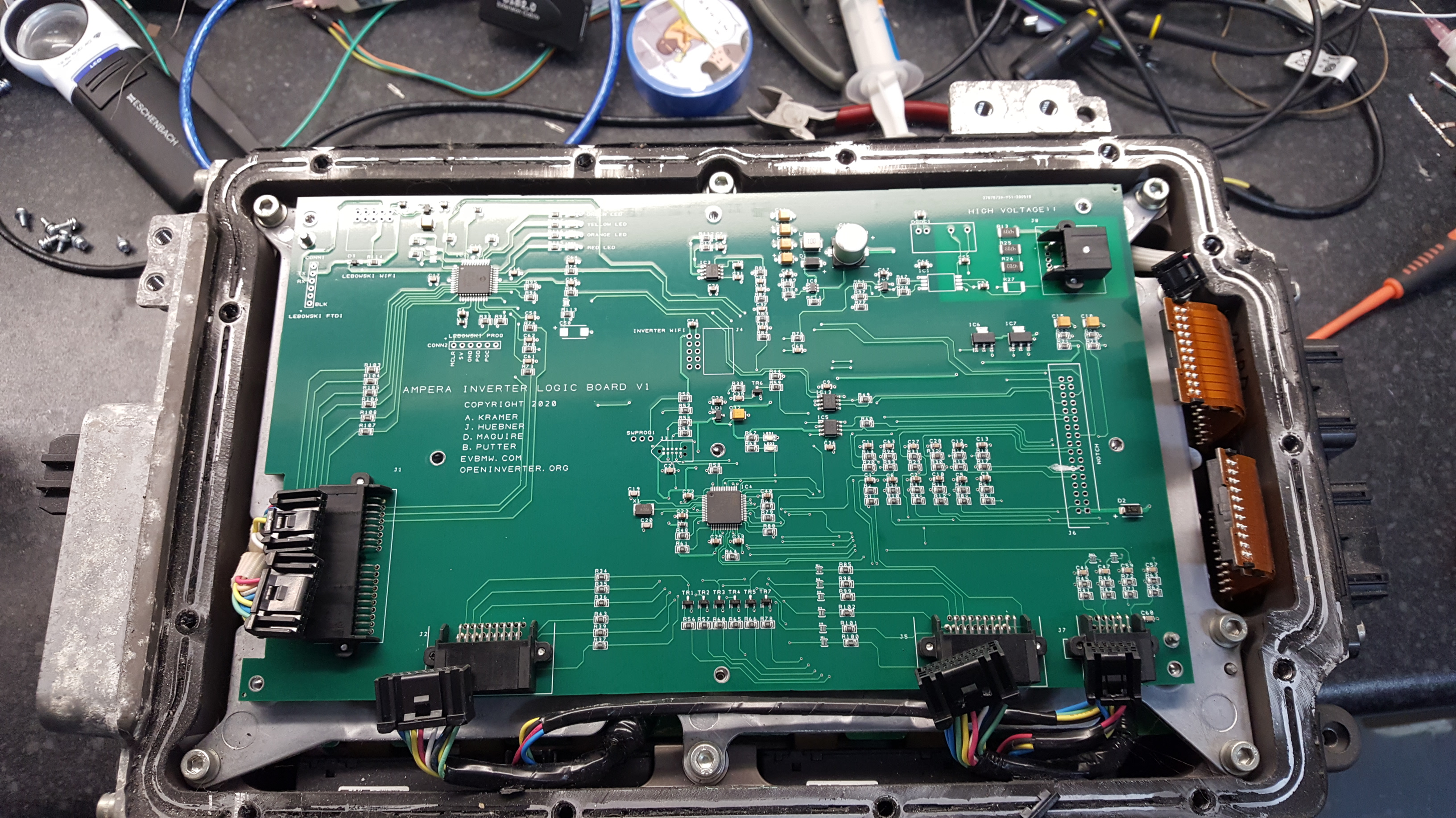

yeah I used the transistors to good effect with the prius design. It does indeed have resolver exciter and interface.
Board is a perfect fit and I managed to harvest the connectors from the oem card.
Posts: 3795
Do show us some RPM please!

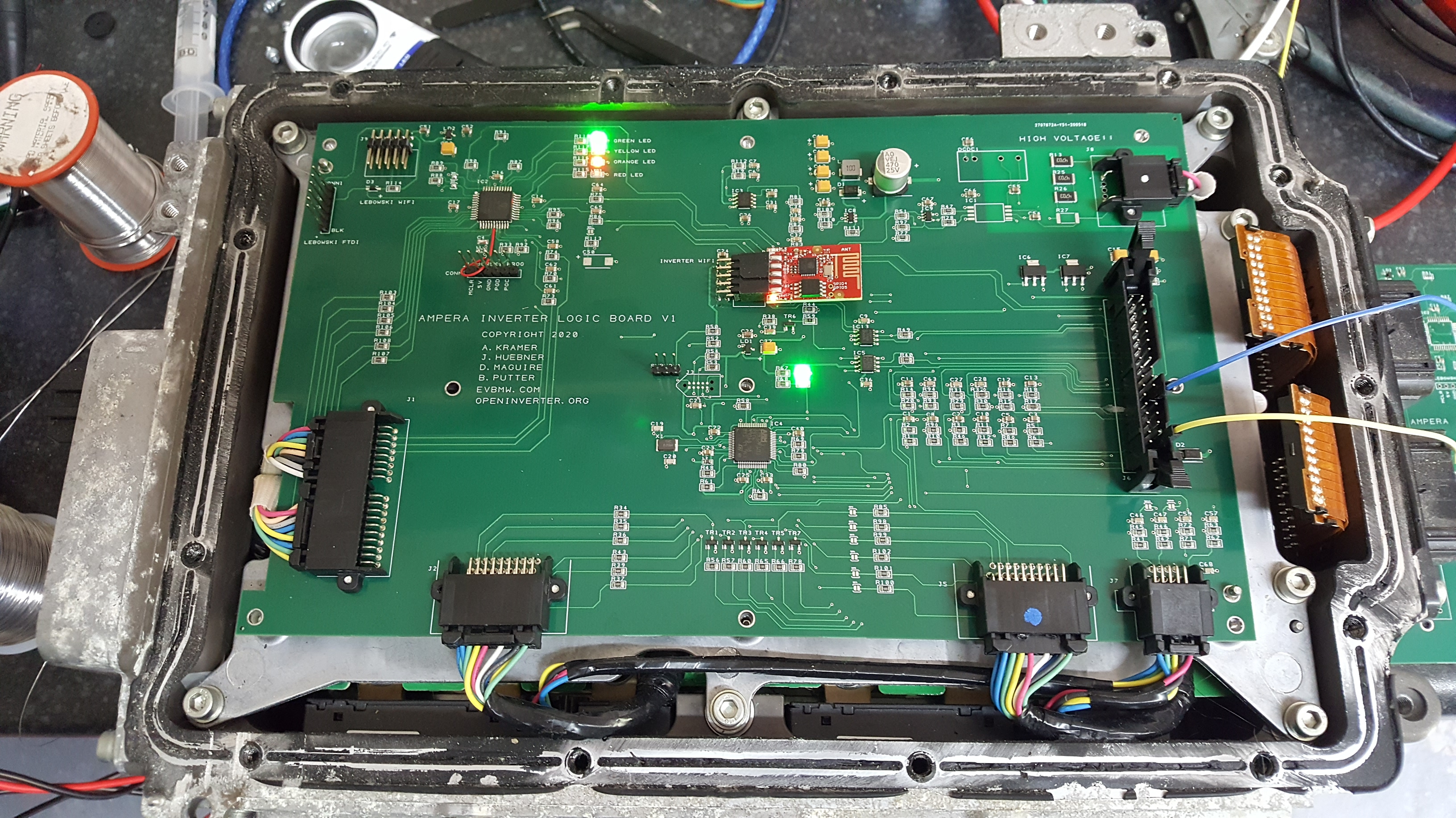

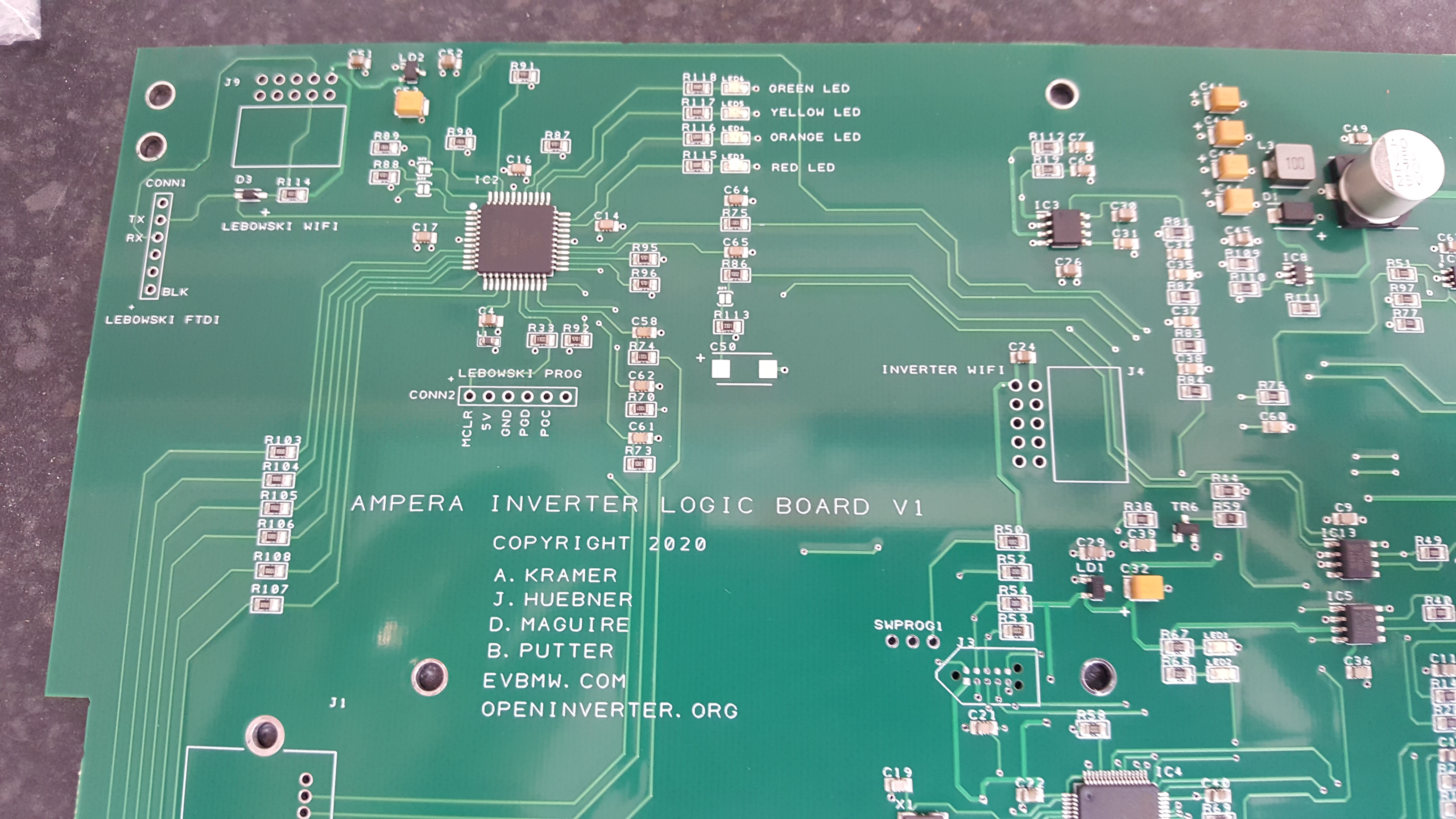

Good news is the Ampera V1 board seems to work. Bad news is there are a few Damien screwups.
1) Polarity is incorrect on analog Vdd and Vss pins on the Lebowski chip. Pin 16 should be +5v and pin 17 GND. See pictures. Modification required : Remove L1, Short out C4. Lift pin 17 leg and wire to +5v.
2)I assumed the fault lines to be active low on the main power stages. This is incorrect. They seem to be active high. Modification required :remove R38 and TR6. Short R38. Link R38 to TR6 collector as in picture.
with these mods done the Main power stages seem to work fine. Not tested Lebowski aux inverter as yet.
Arber you mentioned a serial pass through wifi? Where can I get this?
I'll pop the boards up on the webshop later nice and cheap due to the above. New rev will fix the problems once current stock is exhausted.

Jack Bauer wrote: Fri Jun 05, 2020 11:17 am 2)I assumed the fault lines to be active low on the main power stages. This is incorrect. They seem to be active high. Modification required :remove R38 and TR6. Short R38. Link R38 to TR6 collector as in picture.
Well there is a transistor on driver board which pulls on the fault line towards GND when everything is normal. If you connect this line to one NPN transistor with 4K7 pullup and connect it to OClimit line on inverter then its brain thinks everything is normal.
I will test your Lebowski inverter with Prius AC compressor soon.

Thanks to Damien I got an Ampera board that I want to install in a chevy spark inverter.The inverter is except of the missing part for the second motor the same as the Ampera/Volt, and the board fits perfectly. They are also the right plugs wired for the connector.
As a precaution, I have some material removed from the aluminum carrier plate in the area of ​​conn2 so that the connections below have enough space.
I swapped pins 16 and 17 on the dsPIC to correct the polarity. After supplying the board with 12V, a green LED next to the STM32 and a red LED next to the dsPIC light up. Fine, no smoke, power supply OK.

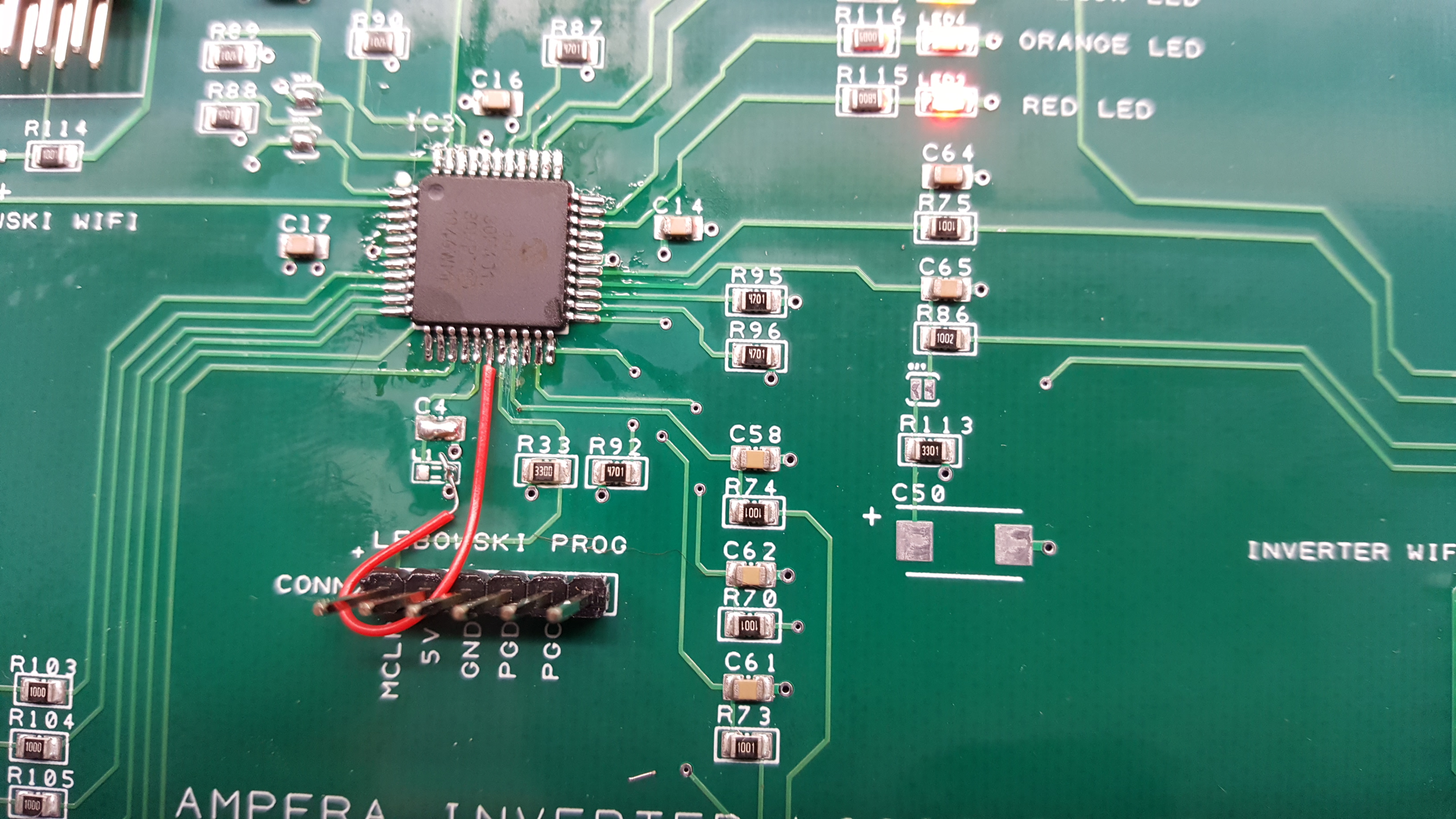

I ordered a PicKit2 programmer for the dsPIC to program via the DSPIC PROG PORT. I use the PICkit2 programmer as software.
When read the dsPIC, the message "No device detected" appears, and the red LED flashes briefly once. OK, try to program, LED flashes twice, message "No device detected" nothing else. :(
After ordering a replacement dsPIC I search again all connections in the circuit diagram and also compared it with the version by BobC. When tracking the leads in the Schematic.PDF from Damien I came across SJ7 and SJ8.
Oops, the lines on the programming port hang in the air.
After bridging the jumper SJ7 and SJ8 the next attempt and what a surprise, it works. The dsPIC is found by software and after programming, all 4 LEDs next to the dsPIC also flash. :)

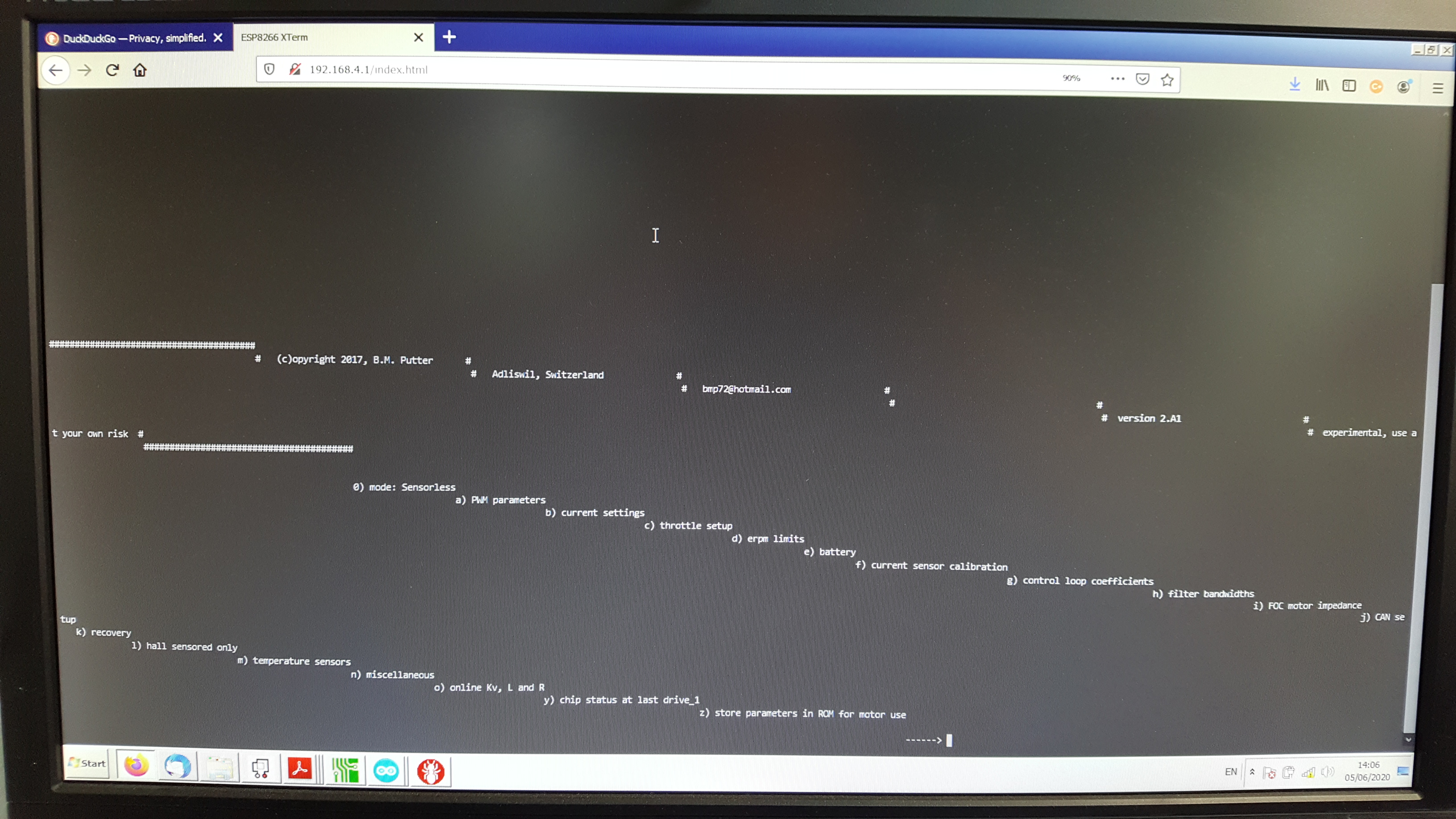

I can communicate with both inverters on the board via the FTDI port / WIFI connector.
Unfortunately, the settings for the terminal program are slightly different.
For the communication I use PuTTY.
The settings for the COM port are the same: 115200,8,1, N, N
edit: Johannes says 115200,8,2,N,N for his board, it worked for me with 1 stopbit, but 2 stopbit are safer and do not interfere with Lebowski.
In the terminal setting for the Lebowski Inverter "CR for every LF" must be activated, for Johannes Inverter not.
Without a complete setup, two pairs of LEDs for the Lebowski flash alternately.
The Lebowski Inverter only responds on the COM port after a setup signal.
To do this, pin 38 must be set to low while reset or switch on and all LEDs are then dark.
There is still a jumper missing on the circuit board, I solderd a pin directly to R87. The setup manual says Pin 19, but this only applies to the DIL version of the ds30F4011.
If you then press enter in the terminal program, the setup menu appears.
RX and TX are interchanged on the WIFI connection of the Lebowski inverter, this has to be taken into account when using.
So far I have only tested the direct connection without WIFI.

It took some time to realise that the pin in the discription I had to hold on GND was different from the text.
So I tried a lot of different seriell communication with and without transistor as inverter between the rx and tx lines as in the original design, crossed rx tx lines, RS232 kabel, different TTL kabel, different terminal settings, etc.
Now that I have found the right settings, there is no problem with the communication. I use a 5V TTL adapter for the Lebowski part and a second one with 3.3V for the Johannes part.
After starting the setup when the led are off, pressing enter brings up the menu on the screen.
In the meantime I found that Johannes suggest 2 stopbit for the communication, for me it worked with 1 stopbit and 2 stopbit, but 2 stopbit is much save, because the difference is the time for the stopbit, and it will have a minimum lenght.
So far I haven't connected HV yet to the inverter.
The configuration of the signal polarity that arber suggest should done before power up the HV on the inverter.

Any advice for troubleshooting the 5V regulator?
I couldn't source the MP2359 so I hand soldered a XRP7659.
sometimes the chip appears to go into shutdown mode and sometimes it comes up just fine.
If I remove everything from the board, current sensor and WemosD1( wifi) then the 5V power supply comes up fine when powered from 12V on the LV connector.
I can backfeed the 5V directly (with 12V disconnected of course) from the LV connector, and my benchtop power supply indicates the draw is only 300mA, so the XRP7659 should be happy.
I stuck with the 10uH inductor, but based on this load level 20uH might be more appropriate, also it looks like the output capacitance Is way bigger than needed.. the design sheet calls for 22uF.
1988 Porsche 911 targa with warp11 motor. Soon to be Tesla SDU.
