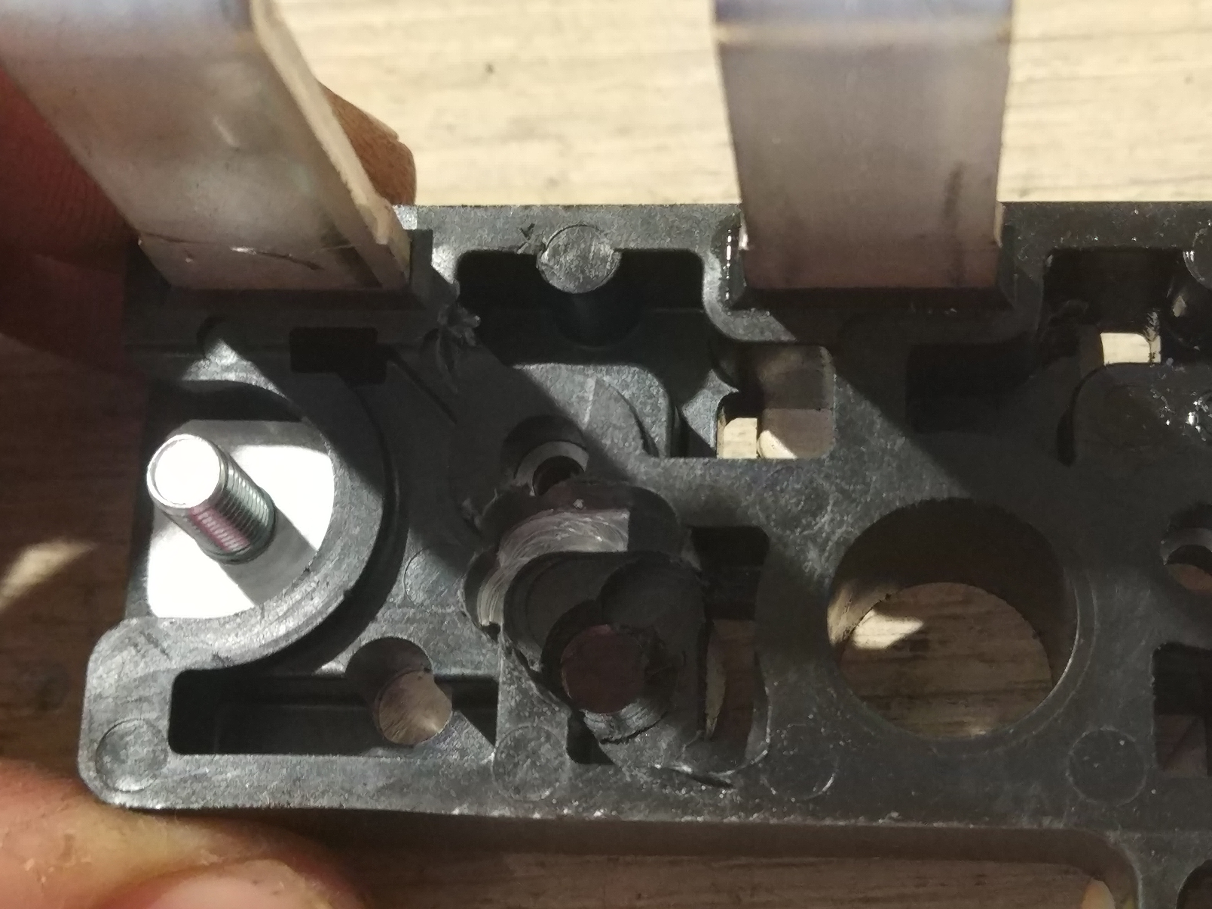

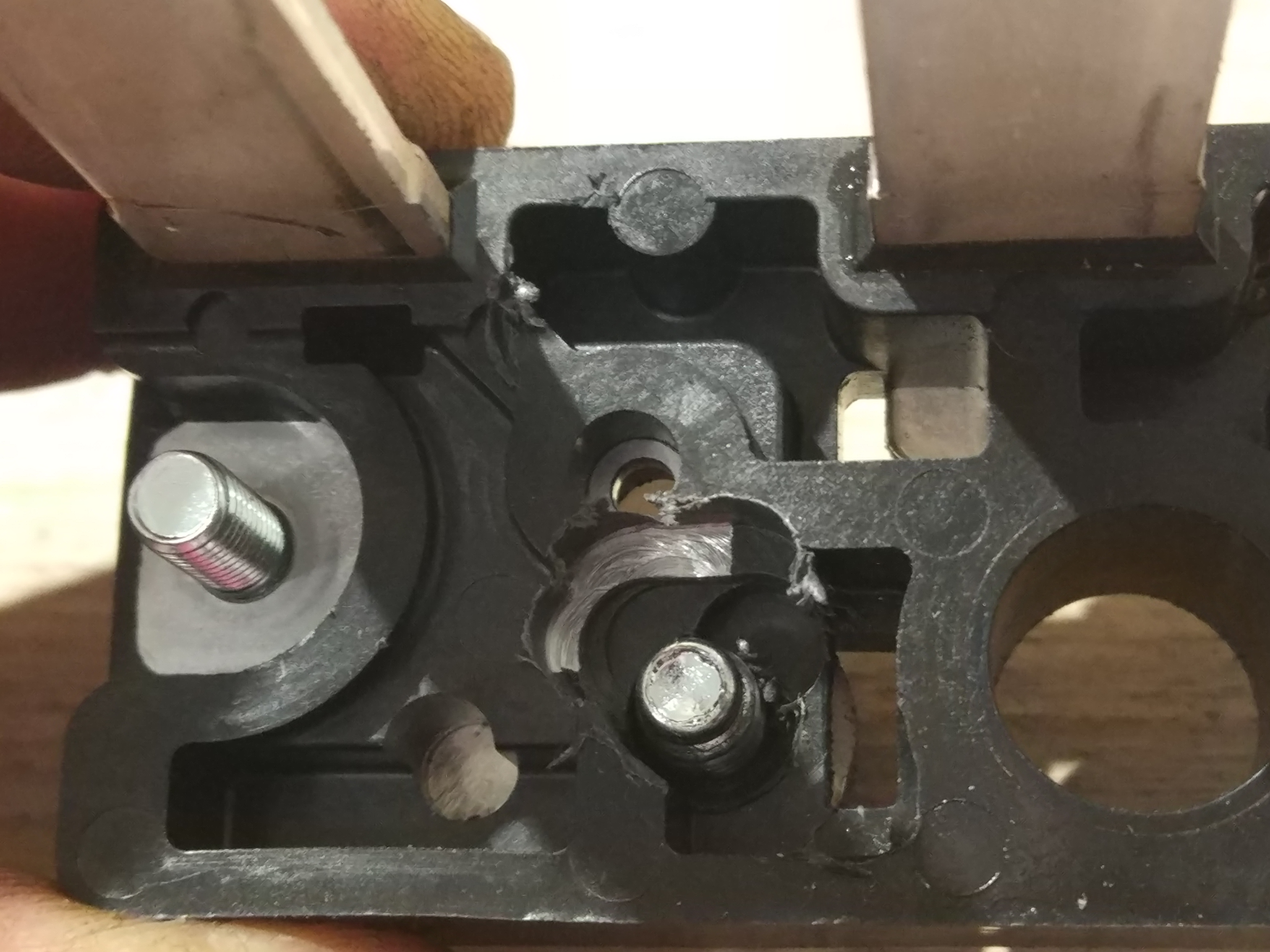

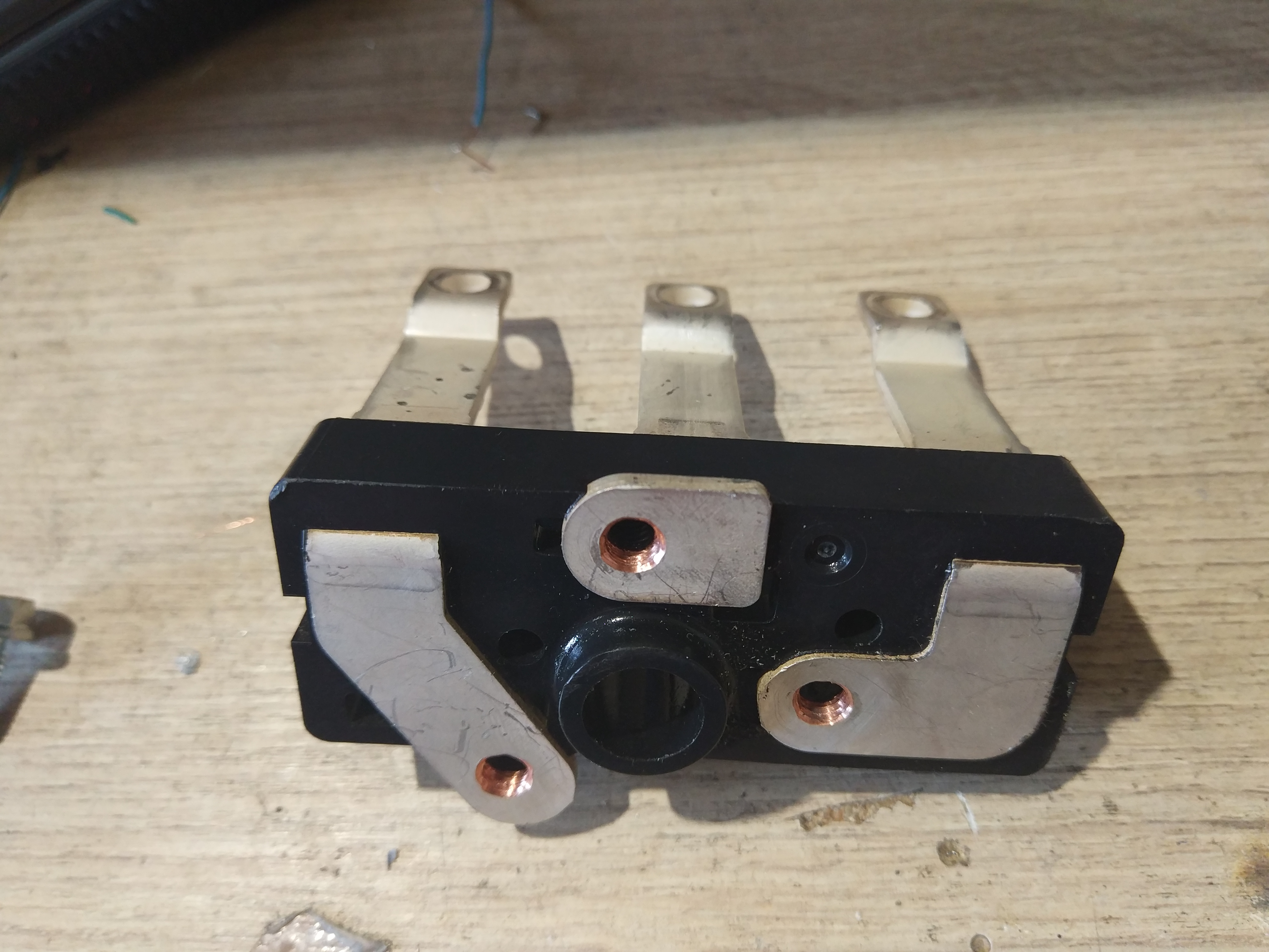

I feel i need to stress this detail for those that will use Volt inverter with original phase connections.
If you drill M6 thread into those contacts you get a good 35mm2 worth of connection. You just need to find out how to cover tha contacts from weather.
However there is a potential incident lurking. We found out there is a steel brace inside plastic of connector which is in contact with inverter casing. If you drill out the copper there is a space underneath where your phase bolt has a chance to hit this brace and cause a short to GND. Instant smoke from IGBT!
So everytime i drill out that i turn the plastic around and mill out that plastic to reveal where metal brace is. Then i mill a piece of it out. At least 2mm around bolt should be enough.
THIS IS CRITICAL FOR LIFE OF INVERTER! Dont ask me how i know :twisted:.

What do you recommend for cables to connect to the motor? Is there a way to get those covers without the cable (to make your own?) or do you think the stock cable will work for 600A for ~10 seconds? https://www.ebay.com/itm/2013-CHEVROLET ... 4174304816 they're not exactly cheap cables, and that's a good deal compared to new...
Posts: 3795
Been thanked: 411 times
Re: VOLT/AMPERA inverter single controler dual IGBT drive
mdrobnak wrote: Wed Apr 29, 2020 10:55 pm What do you recommend for cables to connect to the motor? Is there a way to get those covers without the cable (to make your own?) or do you think the stock cable will work for 600A for ~10 seconds? https://www.ebay.com/itm/2013-CHEVROLET ... 4174304816 they're not exactly cheap cables, and that's a good deal compared to new...

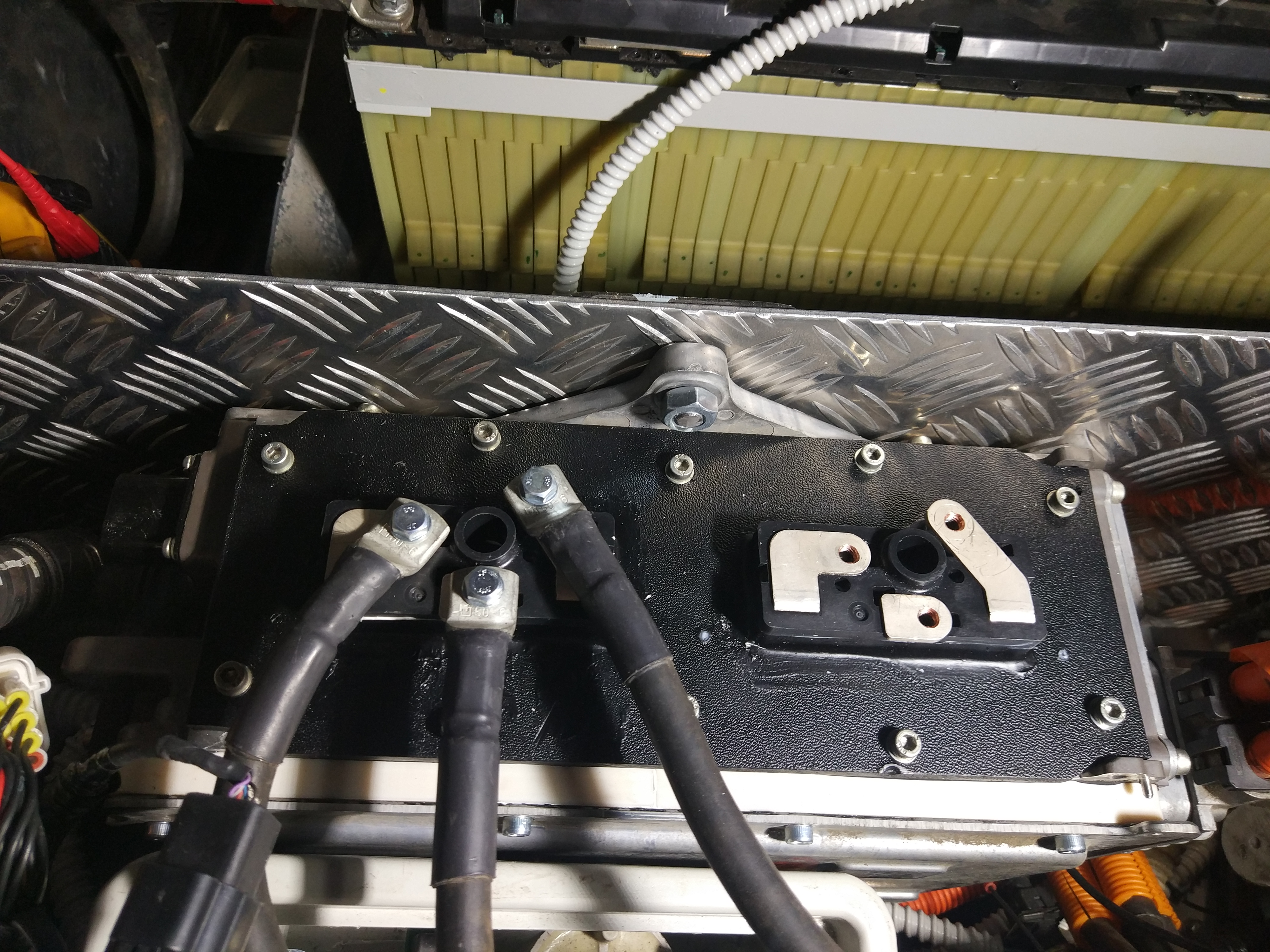

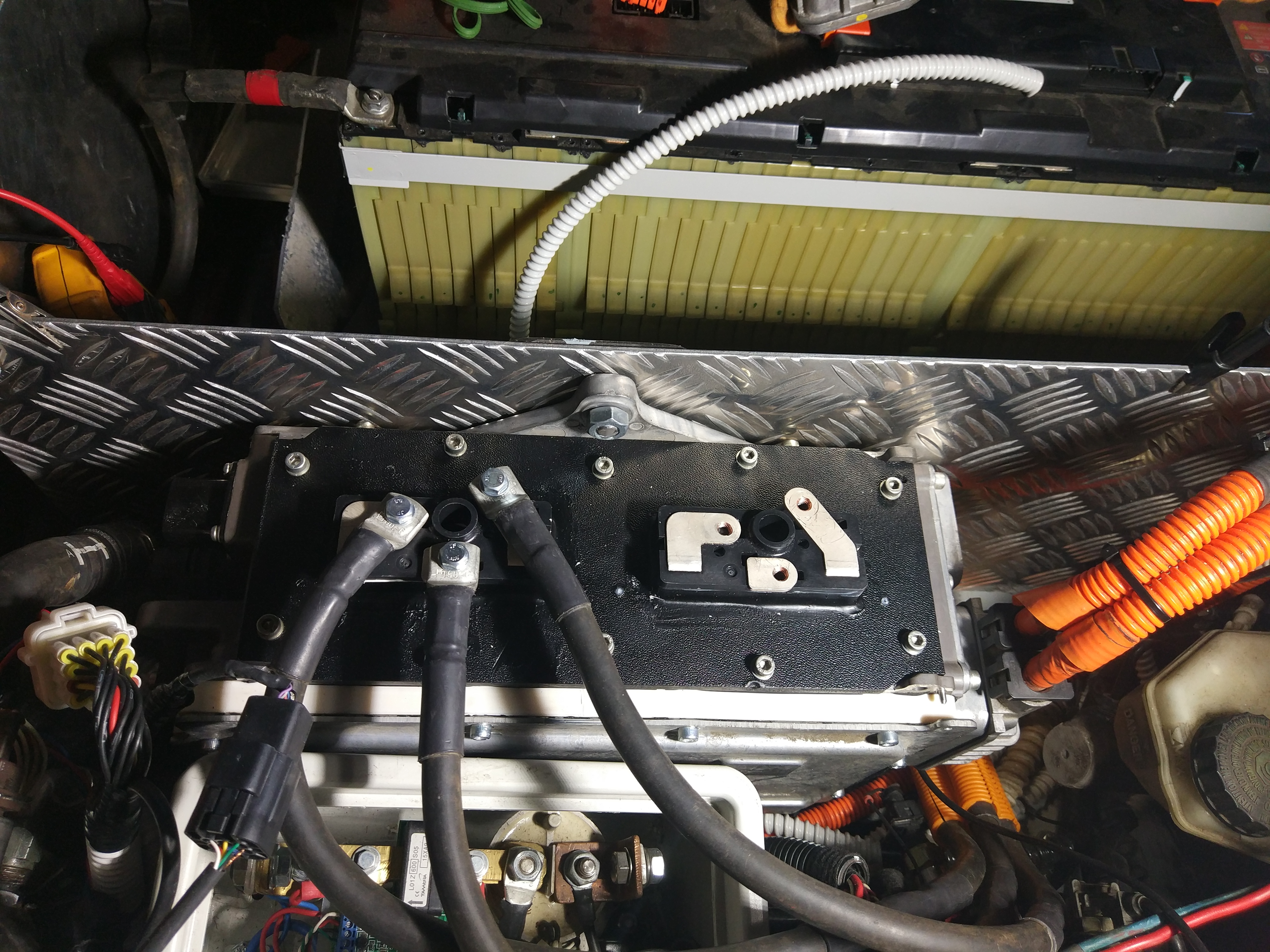

I use a single 50mm2 cable on one IGBT side. Later if i am successfull with both IGBTs i will use 35mm2 cable from each phase that will meet inside the motor cover. Leaf motor has plenty of space for thick cables.
However the cables you show are actually some 16mm2 inside. They look thick, but it is only shielding. I think it will be ok with 350A per phase for a minute or so max which is what Volt motors can handle. If you are ok with 350A per phase and maybe use 700A in all from both sections i think those cables will be good and safe.
I replaced original phase cable cover with insulating plate to which i mounted original phase links and current sensors.
I intend to have Alu metal cover above both sections with side bolts tightening also this. It will be closed on 3 sides and partly closed from one side where i will make sure you cant get to contacts with your fingers.

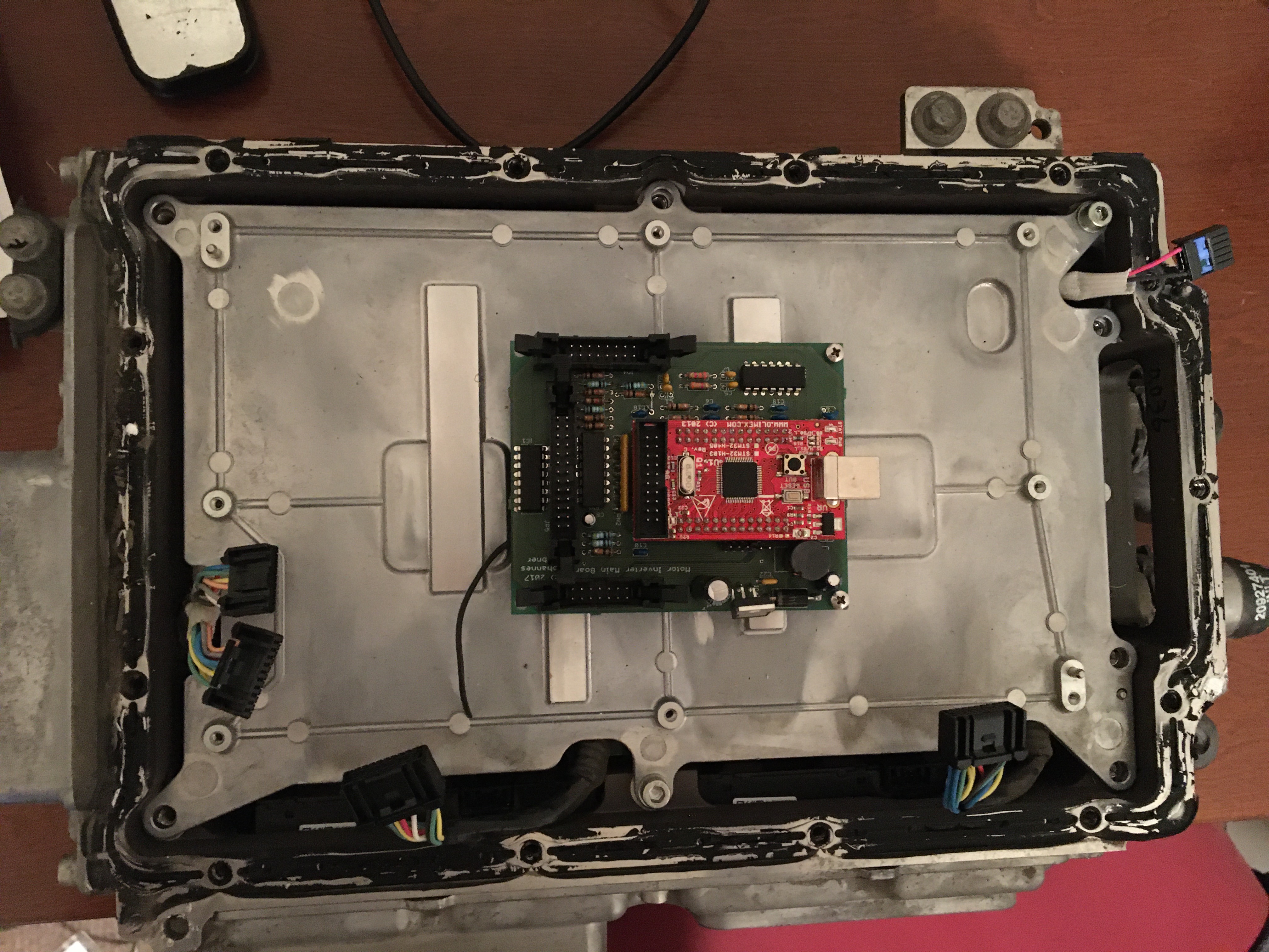

Hi all,
Just got my Volt inverter in the mail. It's a 2013-2015 with p/n 12643810. Looks identical so I guess I have the right inverter.
Here it is with a Rev2 brain for scale:
The brain doesn't fit inside the lid. Spacer time maybe?
I have parts from DigiKey on the way so we'll see how many components I forgot to buy ;)
I'll be attaching lugs to those weird output connectors, just using 1 side of the inverter for now. And probably also attaching lugs to the power input connectors, since I didn't get those wires with it.
Arber, it looks like you only have the upper power connector hooked up?
Ohmmeter says the two connectors are shorted together anyways. Who knows why they put two on then...
It looks like the connector in the upper right corner is for monitoring HV so I'll just hook that to the interface board.
How do we handle the dual current sensor inputs? If running only half the inverter, then wouldn't the output of one sensor feed into the output of the other and get messed up? Maybe just leave the unused sensor disconnected? I'm no EE so please excuse the silly questions :)
When (if) I get this working I hereby pledge to document it and wiki it (and also any explosions that happen) :)
Thanks!
-Isaac

I will describe how the interface board works later with pictures...
And yes I use printed 18mm spacer with O - ring groove to lift the cover a bit. You can mill it off Alu plate. I'll post solid works file.

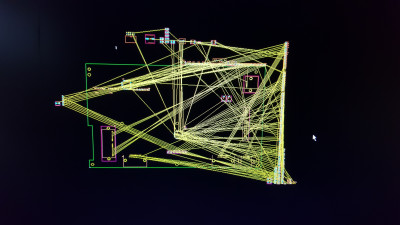

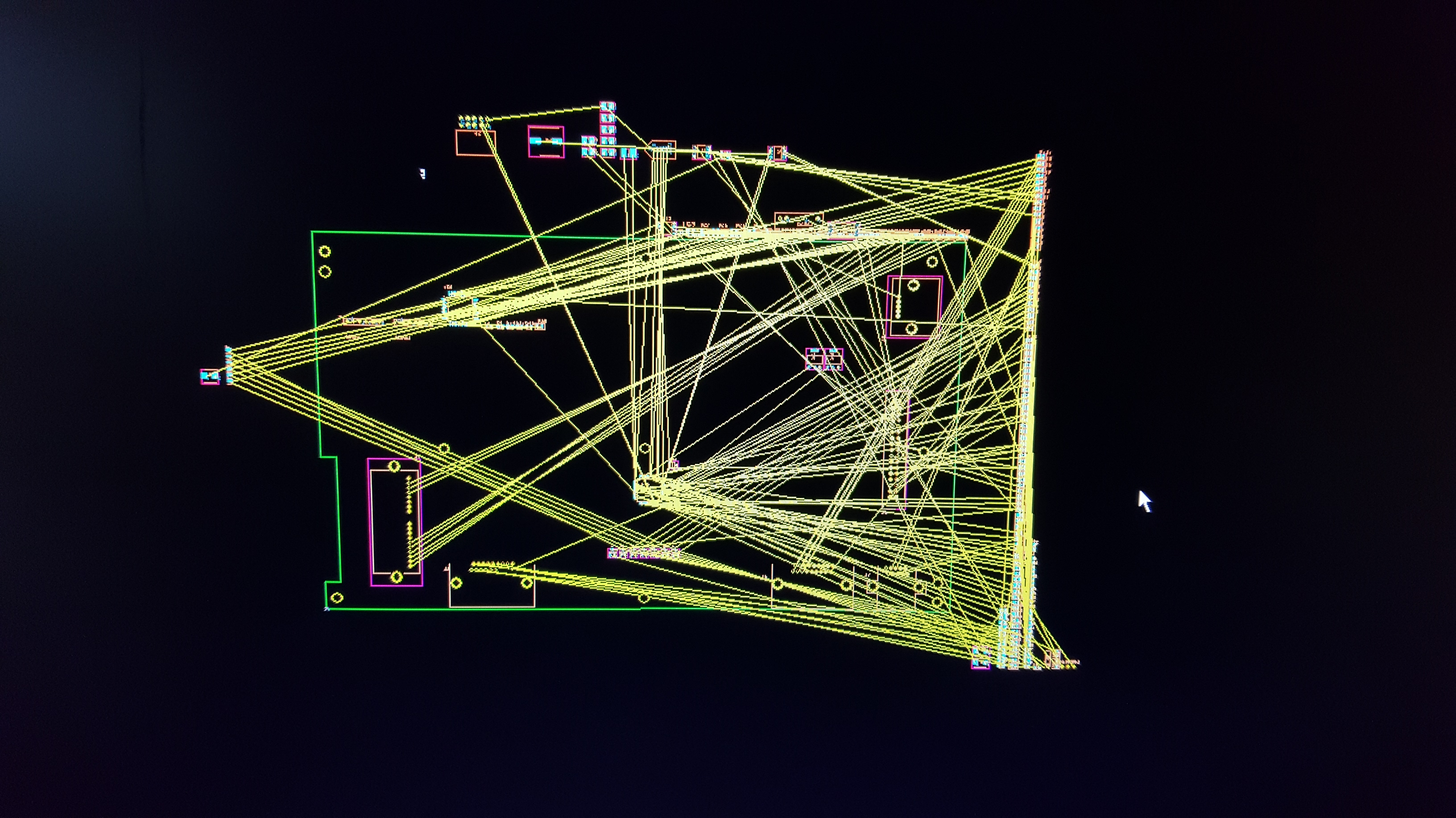

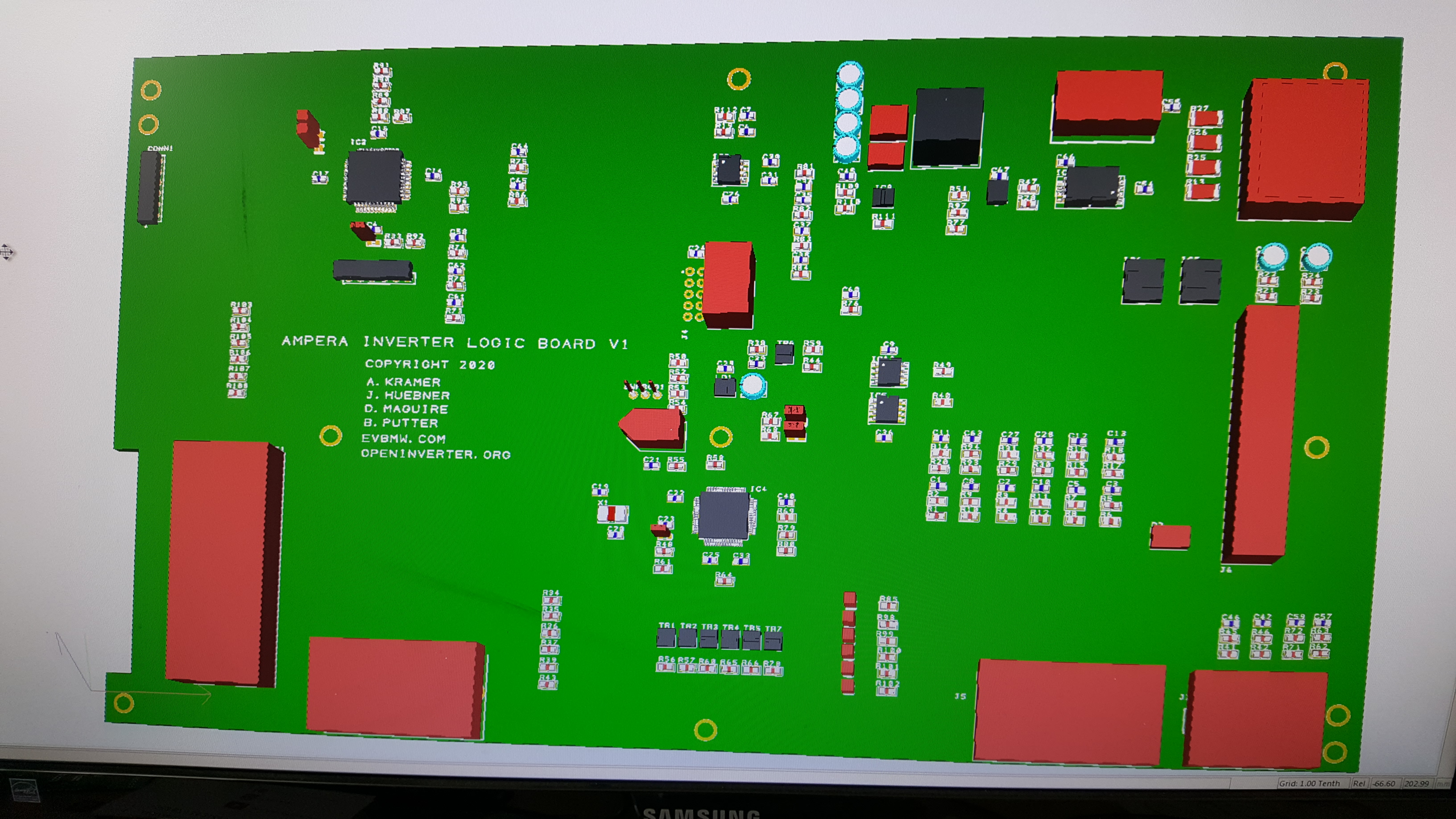

So based on Arber's design I have decided to whip up a board that can be made at JLCPCB. After all I have two of these inverters so they need something to control them.
As Mr.Lebowski has released his source code we can get the dspic placed by jlc and program it in circuit. So as per Arber's design the big L controls the aux inverter and the big J can control either MG1 , MG2 or both. Thinking of putting an option in there to allow the big L access to one or both of the main inverters also.
Based heavily on the Gen 3 prius design it will use the same 34 way idc to ampseal 35 system for external connections.

Well thank you JB.
On a second note, since you are using L controler in circuit, please hold a bit... i made some improvements. You may want to include them.
1. CAN bus with dsPic will require code rewrite since L has its own CAN which has nothing to do with our CAN bus.... :(. But i built 2x CAN bus transcievers onto the board. Could be fun running everything through CAN.
2. I have successfully built autothrottle into Lebowski AC compressor control. I apply 12V signal to throttle line and it now spools up to its RPM and holds it there. You can setup throttle travel in setup menu and have it 80% or 75% etc... Compression works very well and when you remove signal it spools down slowly. Idea is to run it with AC clutch signal and retain whole AC system in the car, save compressor.
Basicaly i put 10K/3K3 divider onto throttle line and put 470uF elcap across 3K3 resistor. Signal from 12V now rises from 0V to 3.4V in about 1s and of course it diminishes when stopped. With Lebowski acceleration limiter set broadly you now have auto-throttle :twisted:
3. You could just build a second Lebowski brain into it. It doesnt require much space. No need to take away AC drive... You need to use precharge system somehow. I recommend to keep Lebowski in reset via relay until DC switch is triggered.
4. I am well on a way to try Wifi gizmo with Lebowski. Please include MAX232 chip onto RX/TX pins of dsPic. We need to translate TTL into serial for our Wifi module. I want to have everything on wireless setup.
This one did not pan out as MAX232 reverses voltage. So i am left with blocked wifi module. I will try different methos...
5. Additionaly series of 6k8 pulldown resistors are important addition because they drain pwm signals and protect driver section from switching on when STM32 resets under power.
6. You can build original contact headers on the board. They are 2.54mm pitch dual row and i tried to remove original low profile connector and replace it with ordinary 2.54mm dual row socket. However i think there is not enough pins to connect everything including brain I/Os, Lebowski I/Os and resolver lines... You need at least 30pins if not 32. I like to have 12V/GND supply separate from other connectors.
I will post my rev 3.2 on github. I just need to finish drawing. Maybe wait untill tomorrow?
EDIT: I uploaded rev3.2 to github now.

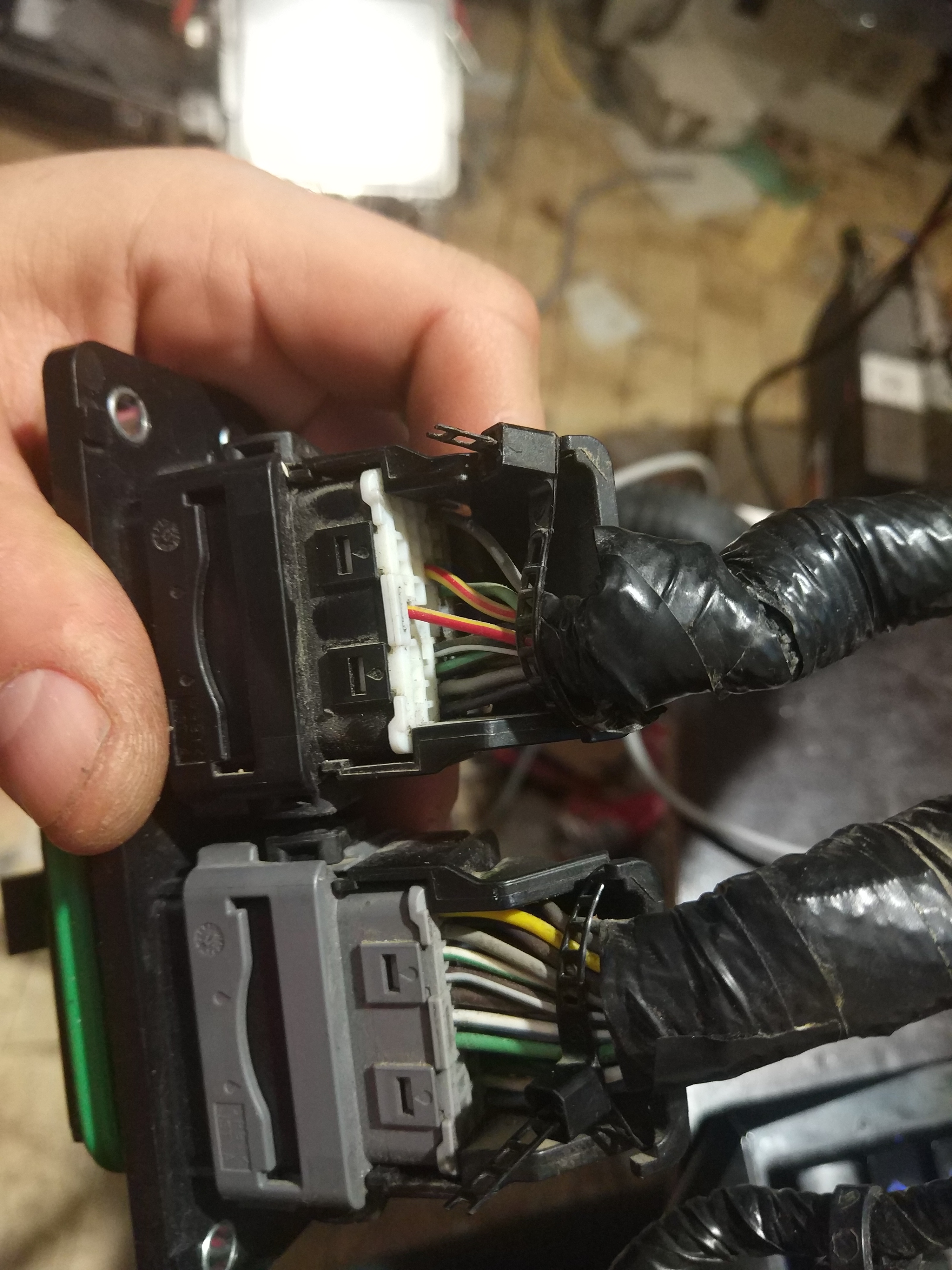

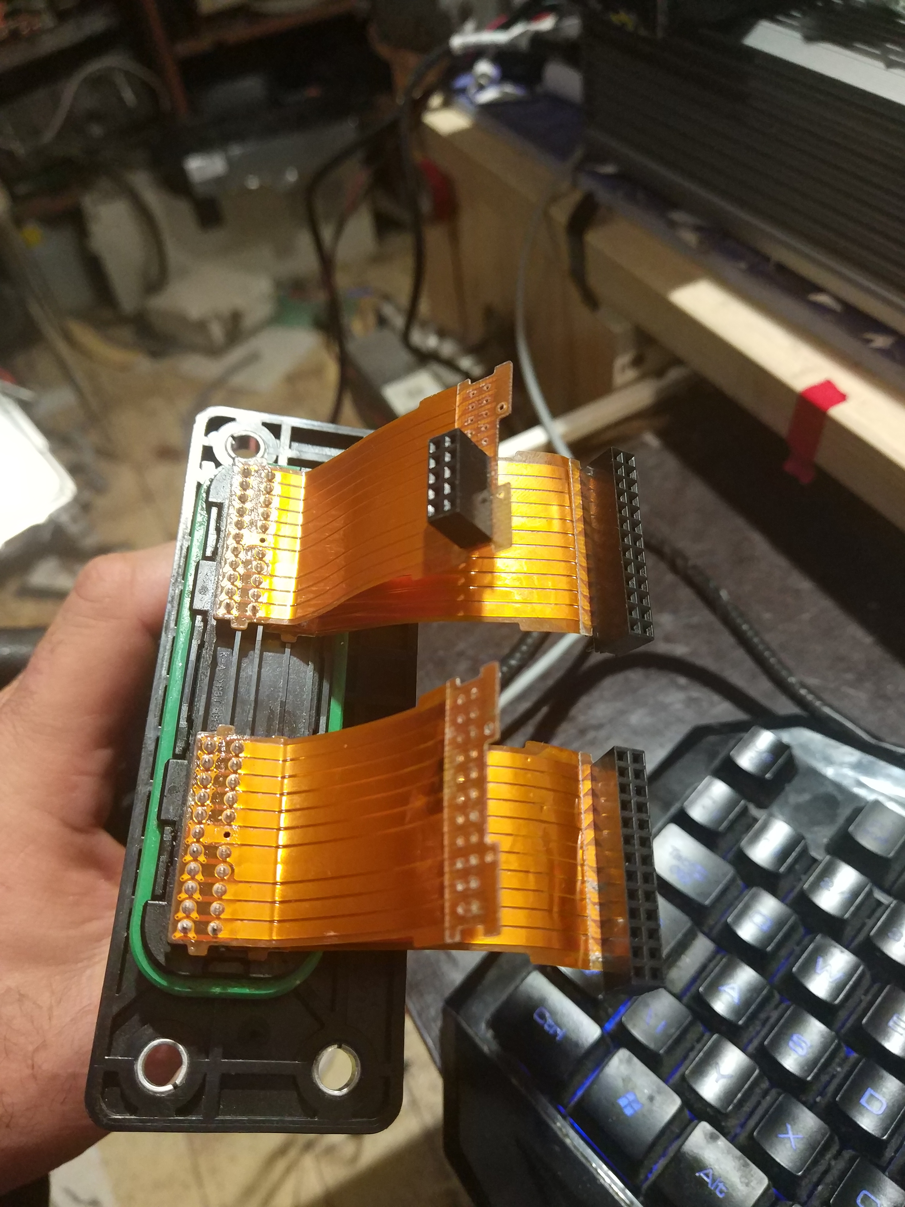

Speaking of headers - I had a hard time finding the 10 pin header that you could buy in less than 500 quantity. I found the 18 pin no problem..
Are you talking about the header for the external control signals?
Posts: 3795
mdrobnak wrote: Fri May 01, 2020 7:08 pm Speaking of headers - I had a hard time finding the 10 pin header that you could buy in less than 500 quantity. I found the 18 pin no problem..

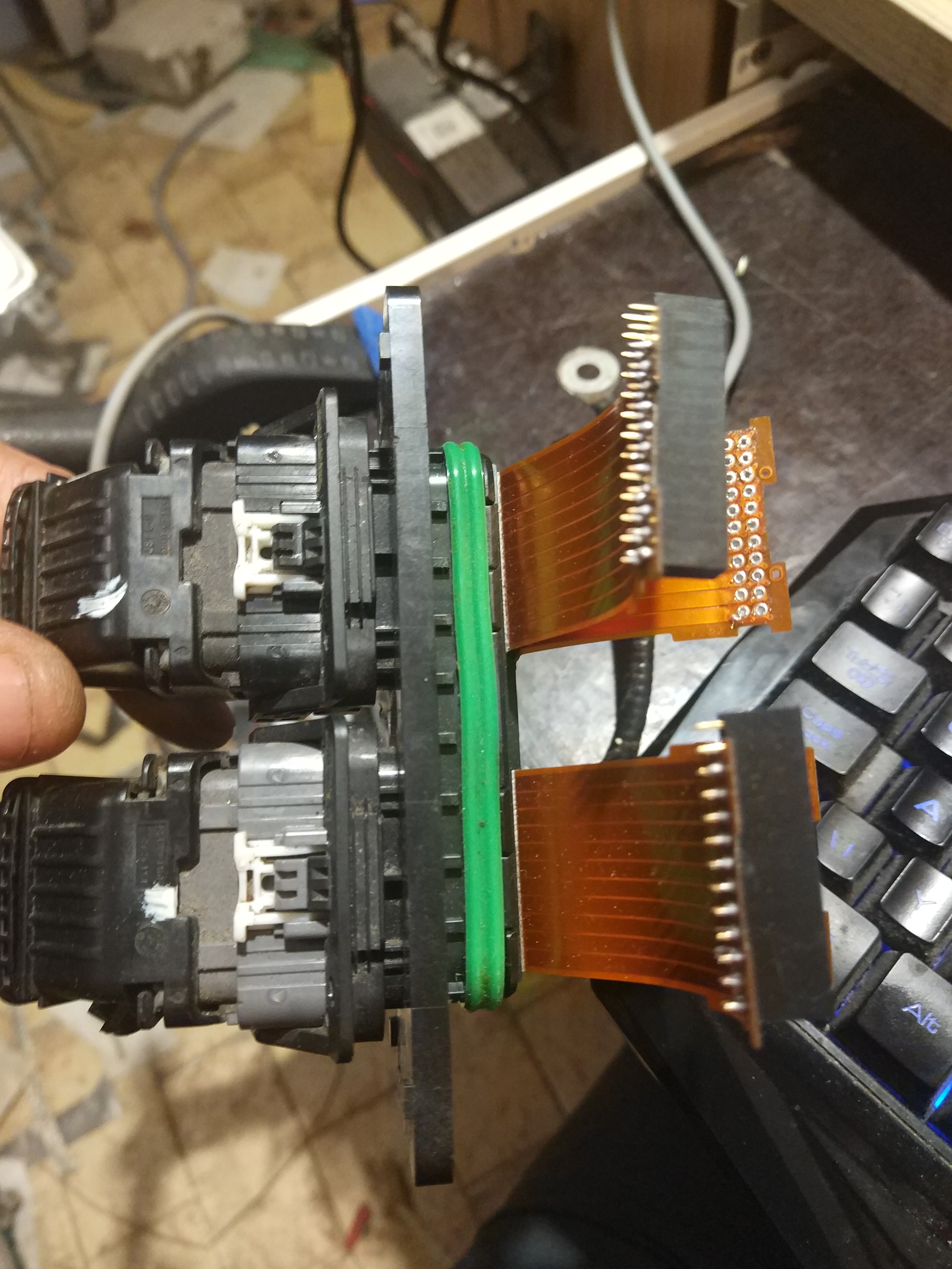

Yes i am speaking about original Volt connectors in front and the way they connect to original control board. I have unsoldered that from flex strips and soldered normal 2.54mm 26pin female sockets. I assumed we could have the male counterpart on our control board. True i can only use 22pins, but that doesnt mean we cant put it on board.
If you look closely on photos you will see there is not enough wires to use everything. Maybe One Johannes board and one Lebowski AC control...
But original connectors are hard to get anyways. Maybe Ampseal would be better way.
Damien you just have to verify if connector can fit into front panel. There is quite small space with all the coolant hoses and all.
BTW coolant hose connector can be taken off and cut short so you can use any 18mm coolant hose with it.

Isaac96 wrote: Fri May 01, 2020 4:04 am Hi all,
Yes i have printable 18mm spacer with O-ring grove. I put it in my Github design folder for Volt inverter board.
I have demonstrated how to thread holes for phase cables in original conductors here: viewtopic.php?f=2&t=697&start=20#p9999
On the outside the upper connector is connecting the HV battery via the cable and it is a sealed connection. See here on my installation
Lower connector is connected to AC compressor and heater.
RH side upper connector was meant to supply clean HV to main board sensing circuit. I use it in the same way. I you use my translator board for rev2 Huebner board you should just take the connector off the driver board and replace it with good 2 pole cable to supply the X1 connector with sensing HV.
On the upper LH side driver board has its supply connector. I dont recommend even touching driver board.
Both current sensors have their own input pins on connectors. I use 4K7 pulldowns to decouple them in 0A state. When single side is used they perform as normal hall sensors. My method of using both drive units sensors will let me use resistor divider on both sections with further signal paralelling before division. So normally in single side operation i use 6K8 resistor as a pulldown and i feed it 5V level signal through 3K3 inline resistor. This makes for 3V4 signal divider and true i get 1V6 on sensors in 0A state. You will use this divider for single side.
With dual side operation i only experimented on desk. I replace 3K3 signal resistors with two 6K8 and lead them to a single 6K8 pulldown for each channel. This is how i get 1V6 in 0A state. Now how the gain will behave i intend to see. Do i need to change gain in code or do i just keep the current gain so inverter would think it is operating 500A power section, when in thruth it will power 1000A from both. TBD.

EDIT After some more disassembly, it looks like the two connectors are just different ends of the same pieces of metal. I guess one wasn't enough for the current draw? Anyways I'll probably fabricate a cover and just bolt straight to the bus bars.
Definitely, if you have option of alu fabrication you can make the covers yourself. They only use simple flat seals.

Got a chance to place the components on the board. Lots of space:) Now to go read Arber's comments and design em in.
Ampera_V1 - PCB.pdf
(235.55 KiB) Downloaded 1007 times
Posts: 4000
Been thanked: 1117 times
Now with Arber's latest mods for 12v big L throttle and option for wifi (includes level shifter).
Ampera_V1 - Schematic.pdf
(501.2 KiB) Downloaded 877 times
Ampera_V1 - PCB.pdf
(247 KiB) Downloaded 918 times
Posts: 3795
Well to summarize:
1. Add 4K7 pulldowns directly to current sensor connector. Also one 104 cap to supply
2. Pin 24 between hall sensor pins is REVERSE pin. It needs 2K2 pullup and needs to be pulled to GND to activate REVERSE.
3. Do you have an option for resolver to UVW commutation conversion? You may add my design with Prius chip.
https://github.com/arber333/Ampera-Lebowski-interface
4. Autothrottle for Lebowski AC compressor control. Basicaly i put 10K/3K3 divider onto throttle line and put 680uF elcap across 3K3 resistor. Signal from 12V now rises from 0V to 3.4V in about 1s. Please design this with normal throttle input (3pin connector) still possible, for those that want to experiment.
5. You could build a complete Lebowski brain that would drive second power stage. You only need to use the signal inversion, because Lebowski reacts to 5V logic and signals LOW. Also you may want to bypass inverter chip for PWM. I recommend to keep Lebowski in reset via relay until DC switch is triggered on the first drive section.
6. I couldnt make Lebowski work with Wifi module and Xterm in Dimas code. I tried with MAX232 chip but it is totaly different protocol. I am sure it is something trivial so i ask you to put TX/RX transistors in like Lebowski schematic shows and use normal 4pin connector. Later on we can try various solutions for wifi...
7. Additionaly put 6k8 pulldown resistors on PWM signals from STM32 chip to drain pwm signals when in reset. dsPic30F does not need this drain.
Please send me the resulting board schematic before you publish it because some things are not so apparent with lebowski board.
Posts: 4000
DONE
I'm using the 44pin qfp package. Think I have the reverse pin right? See attached.
Will have a look.
DONE. Selectable via solder jumper.
Probably not do that on the V1.
DONE
May not need to do this as the stm32 is driving an npn transistor.
smdlebowski.pdf
(187.53 KiB) Downloaded 822 times
