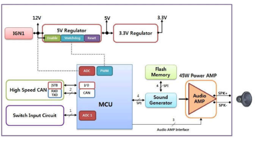

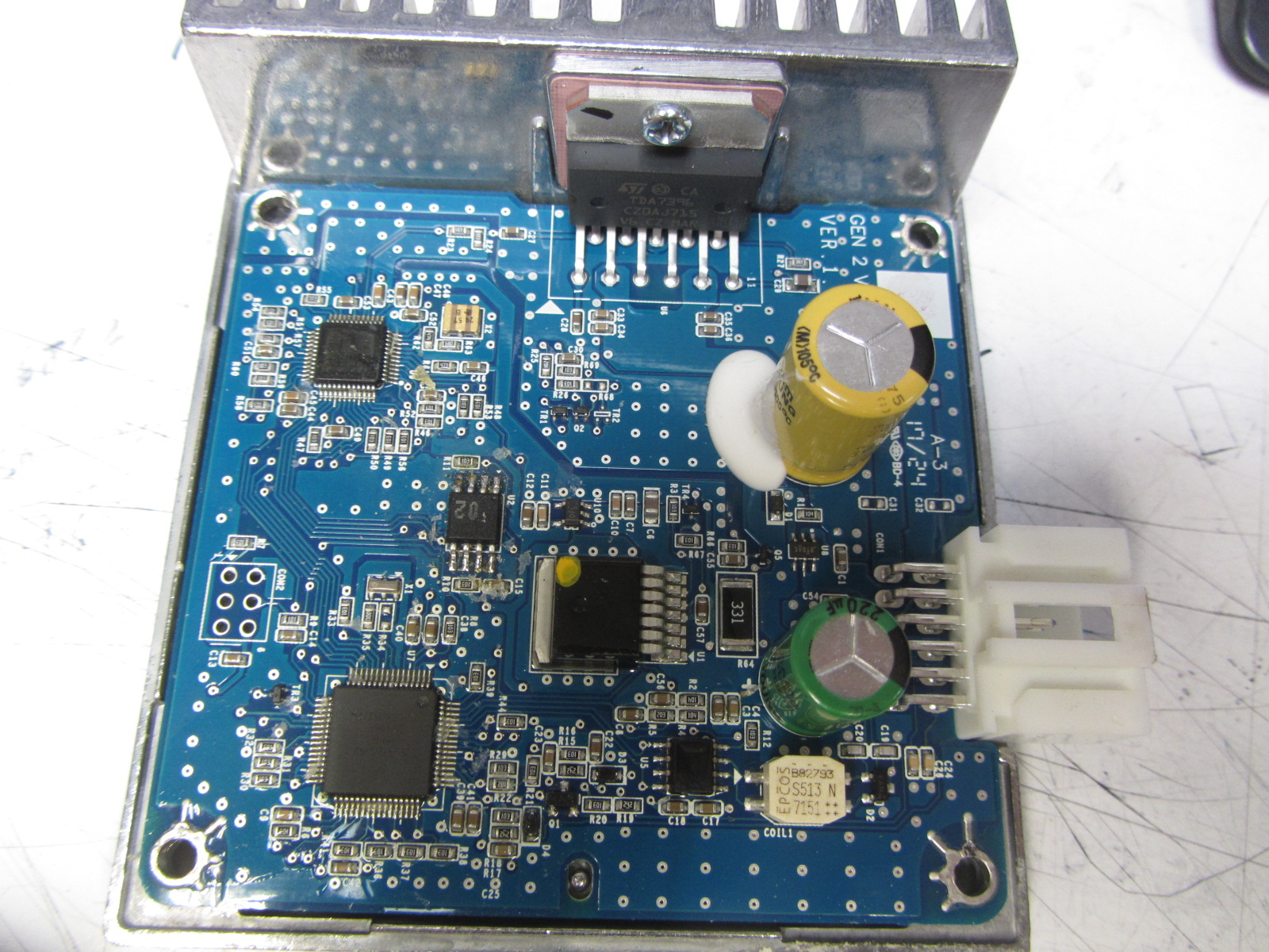

If anyone fancies adding fake engine noises, I notice that the hyundai Ioniq VESS module is often to be found pretty cheap on ebay, often £25-30
e.g. https://www.ebay.co.uk/itm/274838841817 ... SwnStgzd~m
And if you want to customise it, the audio is in a SPI flash device in a fairly obvious uncompressed format. I have a copy of this if anyone's interested - PM me.

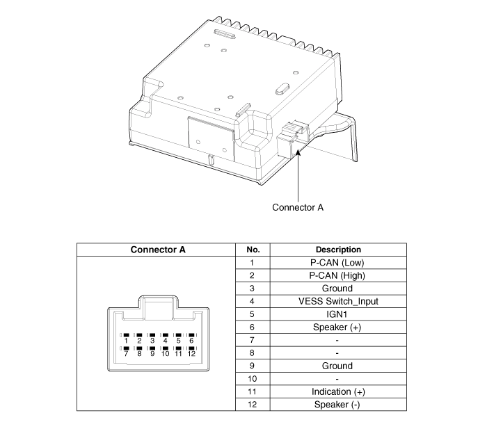

My VESS module arrived today. Had enough time to hook it up to the teensy and 12v. Got the standing CAN frames of the module being alive.
I found the github of that python script in the firs video so I will try and get some sounds out of it later tonight when I am back home again.
https://github.com/ereuter/vess

Ok I've been messing around with the code and I am pretty certain I am now sending CAN messages.
I think there might some slight differences between the Ionic and Kona VESS units. The wiring connectors look to have a slightly different pinout on the Kona VESS unit.
The connector that came with my unit was setup as per the first post, but was missing the wire for pin 4. I think this is the temporary disable switch, ground it on start up and the unit won't make a noise until the vehicle stops.
On this Ionic unit I can power it up and get CANBUS messages from it. So I am fairly certain that is running ok. Can't get it to make any noise though using the same Canbus messages that the Kona unit was using. I've tried a couple different speakers just to make sure it wasn't a hardware issue.
So I think I'm a bit stuck on this until I can find some Ionic canbus logs with the VESS enabled.

The Kona VESS has an internal speaker, and the hardware is very different

Re: V.E.S.S / fake engine sound module
So does it use 1 sound sample and bend the pitch and volume according to CAN speed input? Or are there discrete samples?
mikeselectricstuff
- Posts: 120
There are three sound samples plus a reversing bong. I don't know if it adds any pitch/modulation or other effect to these to get a smoother transition between speeds.
Attached zip contains the flash image, and an MP3 of it loaded as raw data into Audacity.
