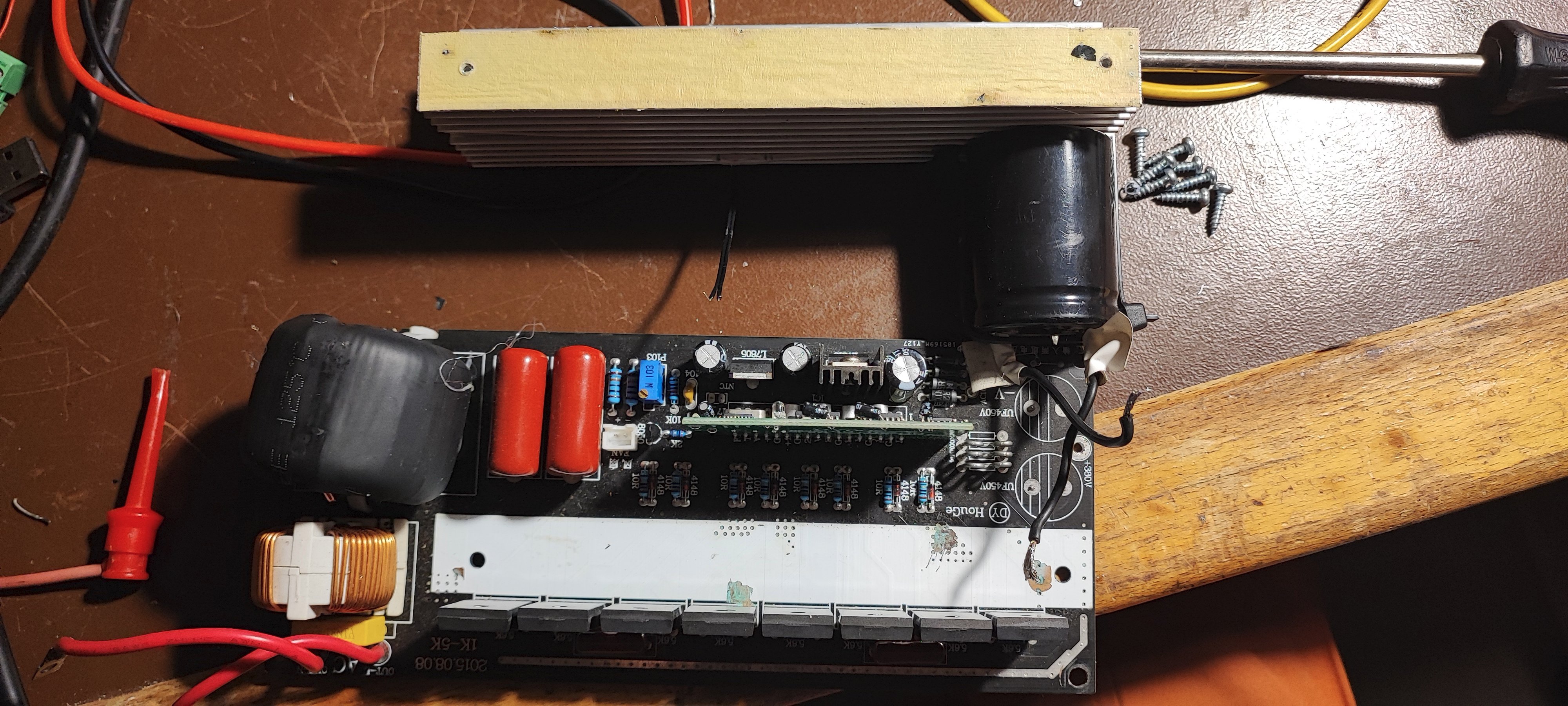

Oh no, more failures! The cars heater needs 230V AC to run (because bimetal contact and AC motor for pump). So I installed this Chinesium inverter board to run it:
Not the best product in the world:
- First the main caps exploded
- Then the inductor came loose multiple times
- Now the heat sink that is only isolated with painters tape, shorted out DC- and AC output
3 FETs are toast and the PCB looks pretty poor, will scrap this one.
Have a new one ready anyway, should be good enough for this winter

DOH! Similar story here...

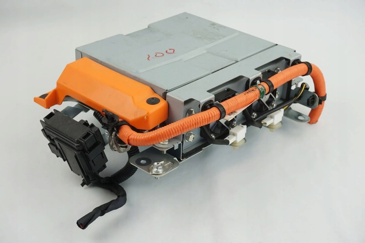

I recomend getting one of these hv dc to ac converters from a toyota hybrid. The outlander has a 1500w one, while the prius is a 400w one from my understanding.
https://www.toyota-industries.com/produ ... index.html
they can be found on ebay cheap!

Is that outander AC inverter command can telegram known? or is it simply plug and play...?

Ok, thank you.Bratitude wrote: ↑Mon Dec 01, 2025 8:34 pm![]()
Its just a 12v enable pin!
See here: https://openinverter.org/forum/viewtopi ... 142#p86142
But what about this component then? i thought it is another inverter...
37129-01001

Not sure, haven’t seen that one before, is it a Mitsubishi part or Toyota?

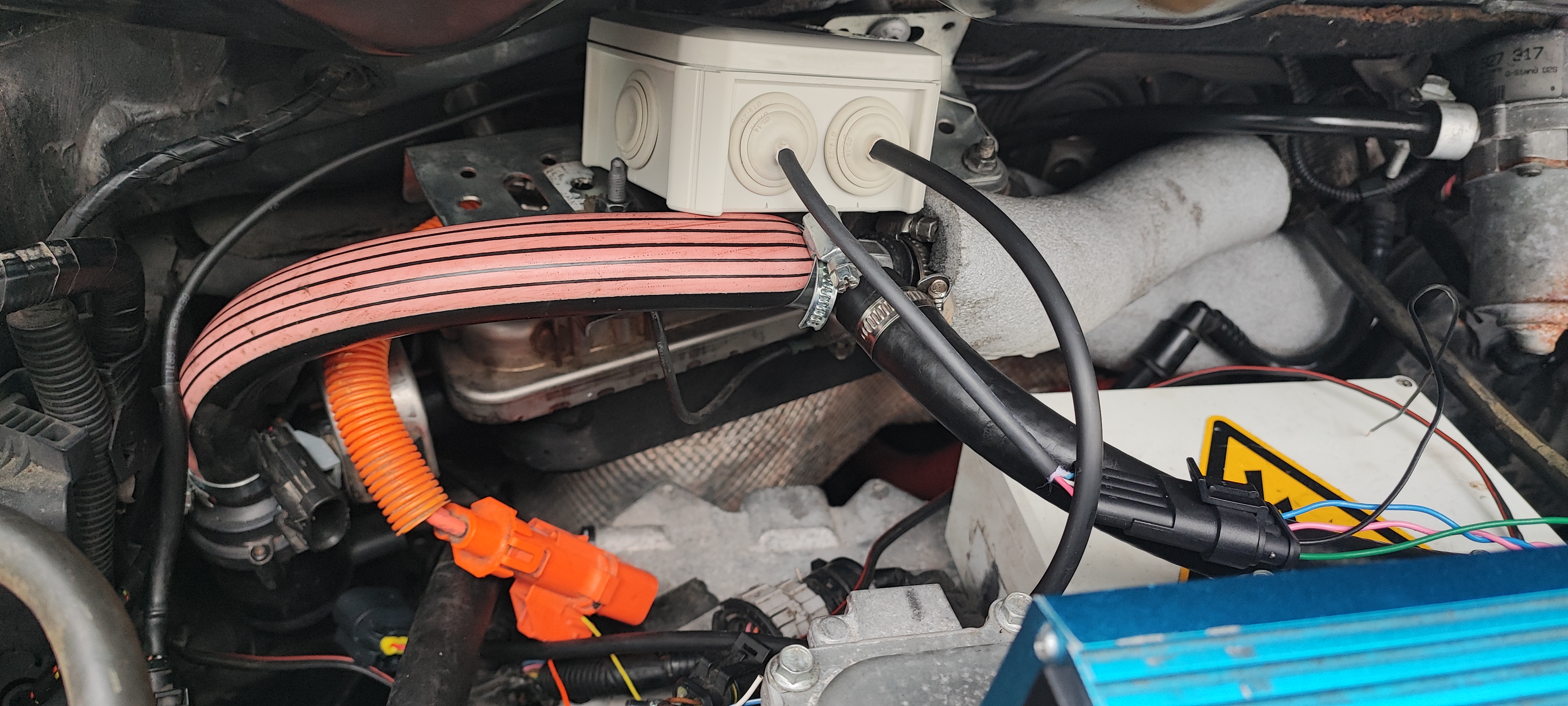

Mounted the heater today. Mechanically medium sound...
Now have to do the HV wiring and tie it into the CAN bus

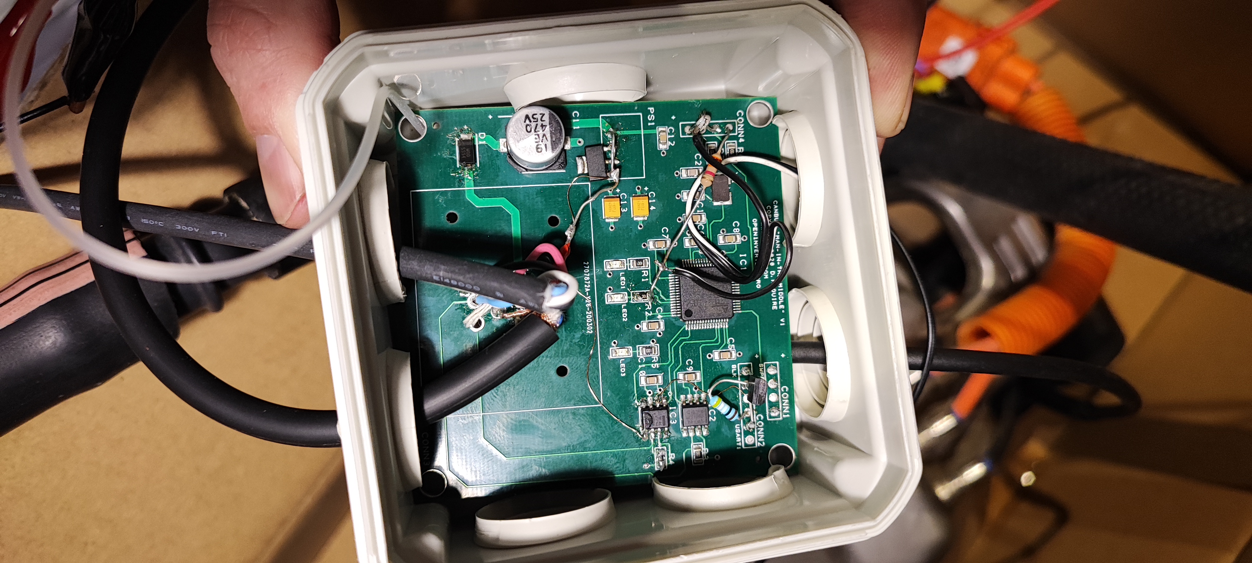

Cross posting the controller:
Damiens MITM board with one transceiver swapped for SW-CAN. Also controls the pump via transistor.

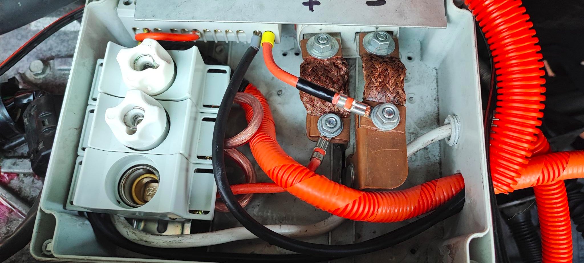

Also cleaned up the junction box somewhat with some left over domestic stuff
