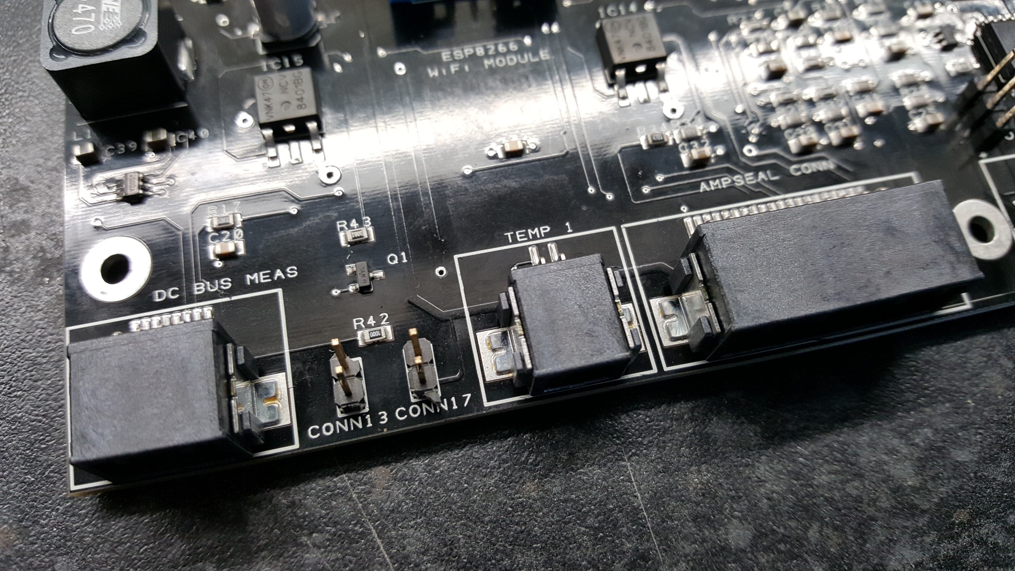

And 11 to ground.

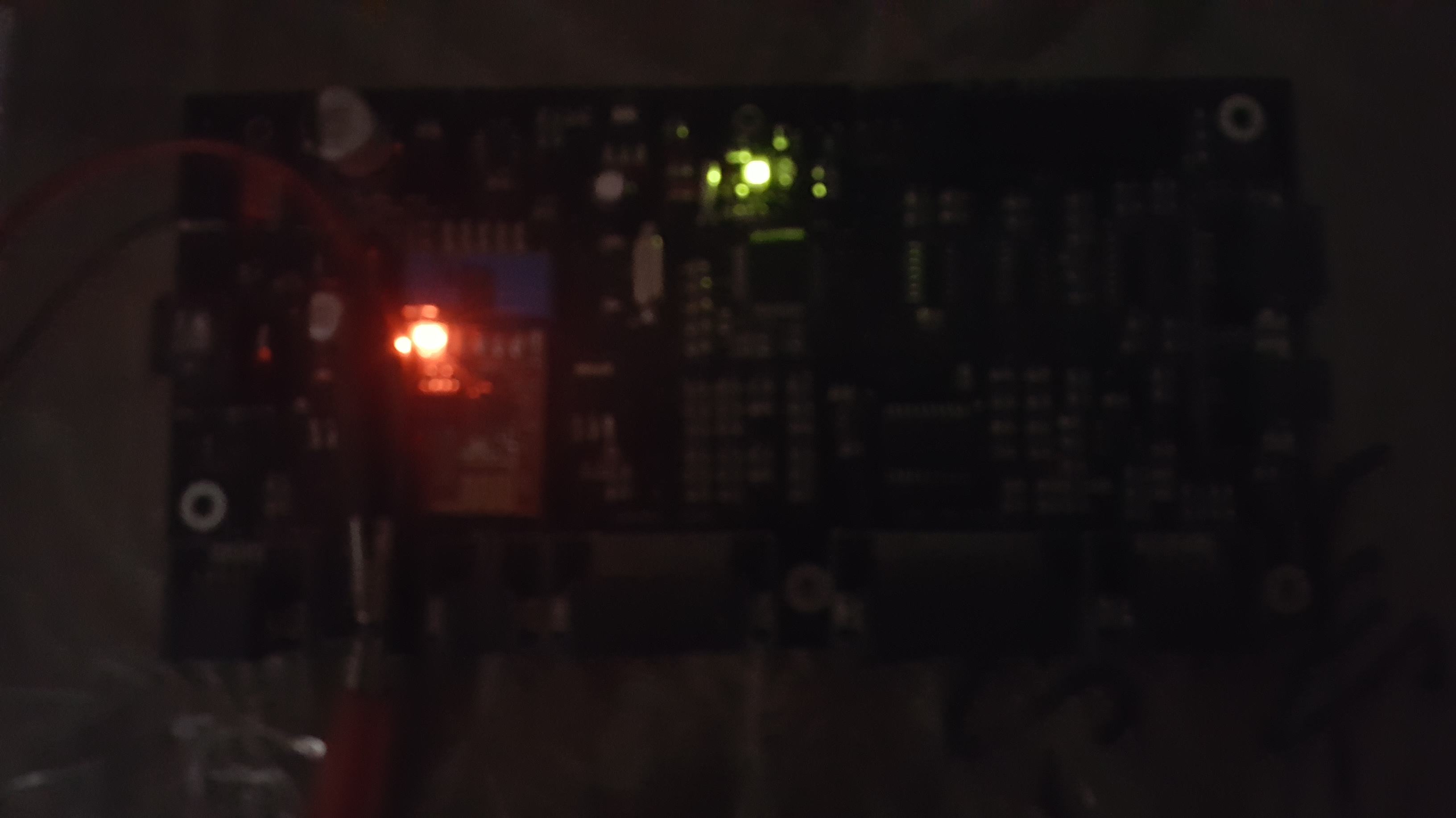

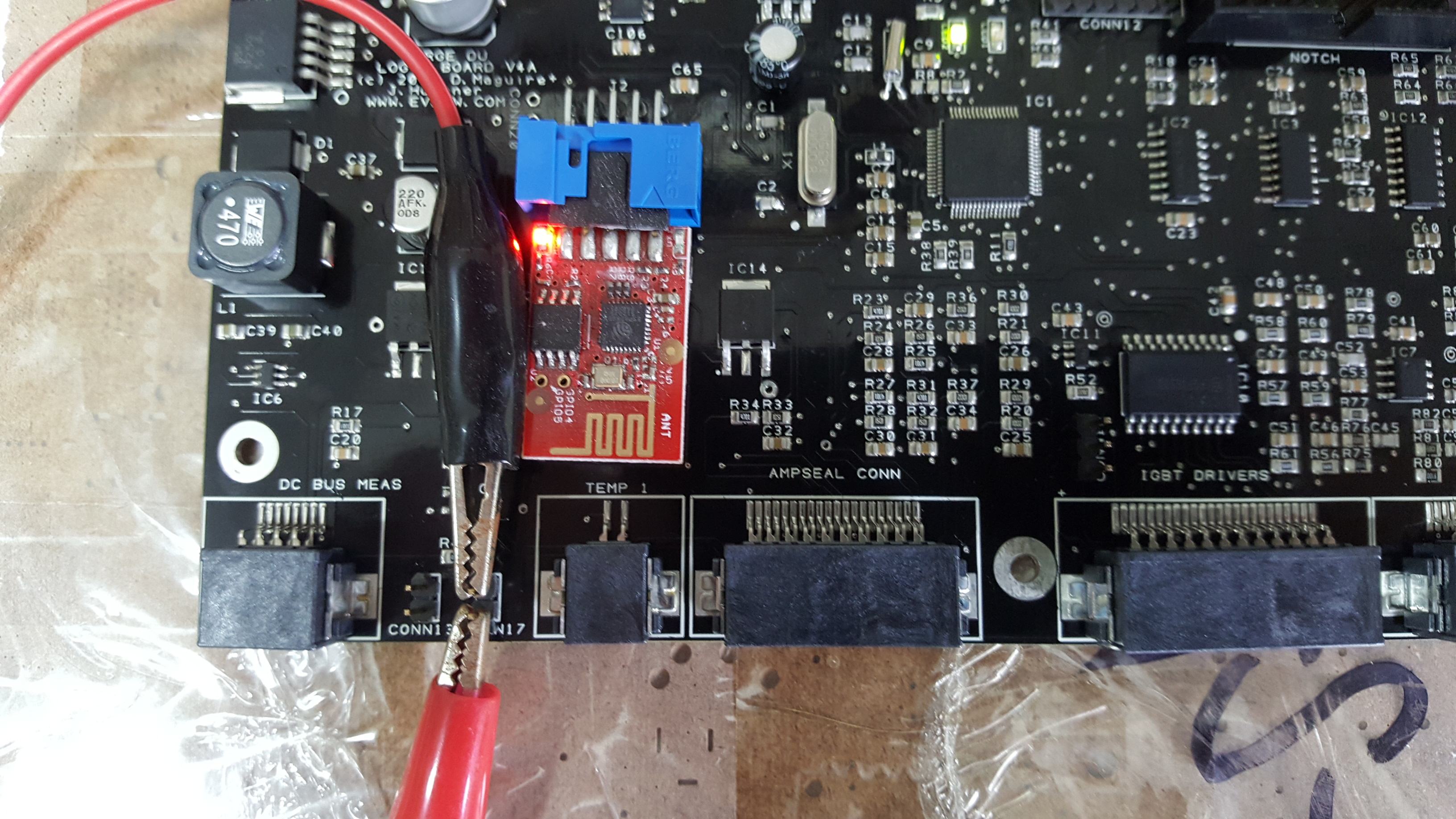

Here is video when i do ignition on red led light blink on three board of the inverter facing 23 pins.
I did Also check amps it draw only 3.5amps.
and output voltage at encoder pin 9 is only 1.17 volt instead of 5v
and output voltage at accelerator pin 12 is also 1.17 volt instead of 5v
no any led lights on at logic board.
my input voltage at pin 1 is 13v

Ok now we're making progress. Under no circumstances should the drive unit draw 3.5amps. The fact the 5v lines are low may indicate a short somewhere.
What I suggest is to remove the logic board from the drive unit and test it on its own on the bench. This will help determine if the problem is with the logic board or drive unit. To do so, remove the logic board completely from the drive unit. Connect a 12v power source to connector CONN17 as shown in the photos. 12v to the pin nearest the edge of the board. Once powered, the leds should illuminate as per the photos and the wifi access point "inverter" will become visible.

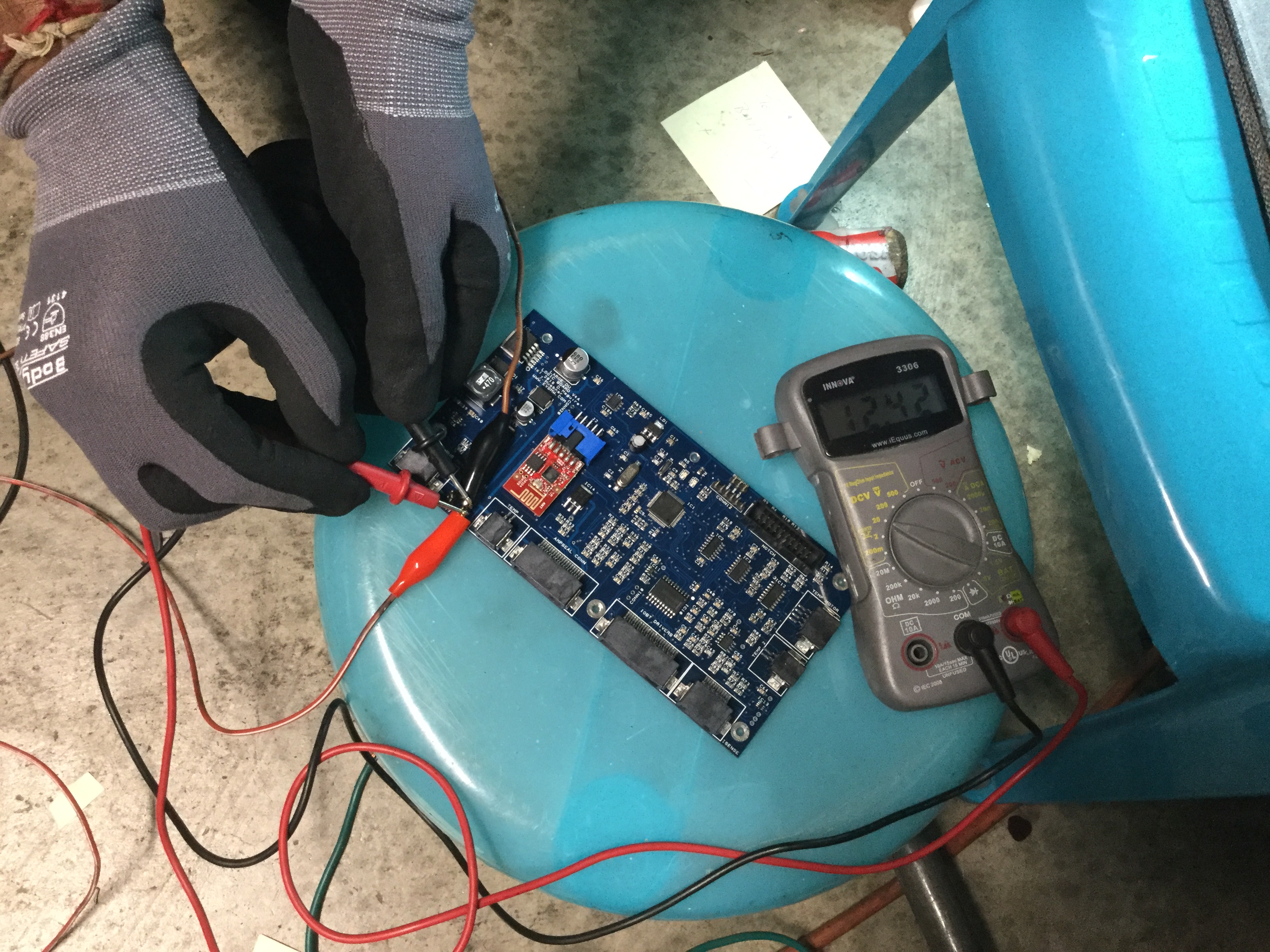

Here is the photo voltage across pin 17 is 12.42v but no any led light on logic board.

I have contacted you off line to arrange return of the board for investigation and repair.

The main inductor for power supply was loose on the logic board.
Resolder it working fine now.
Thank you Damien for help.
