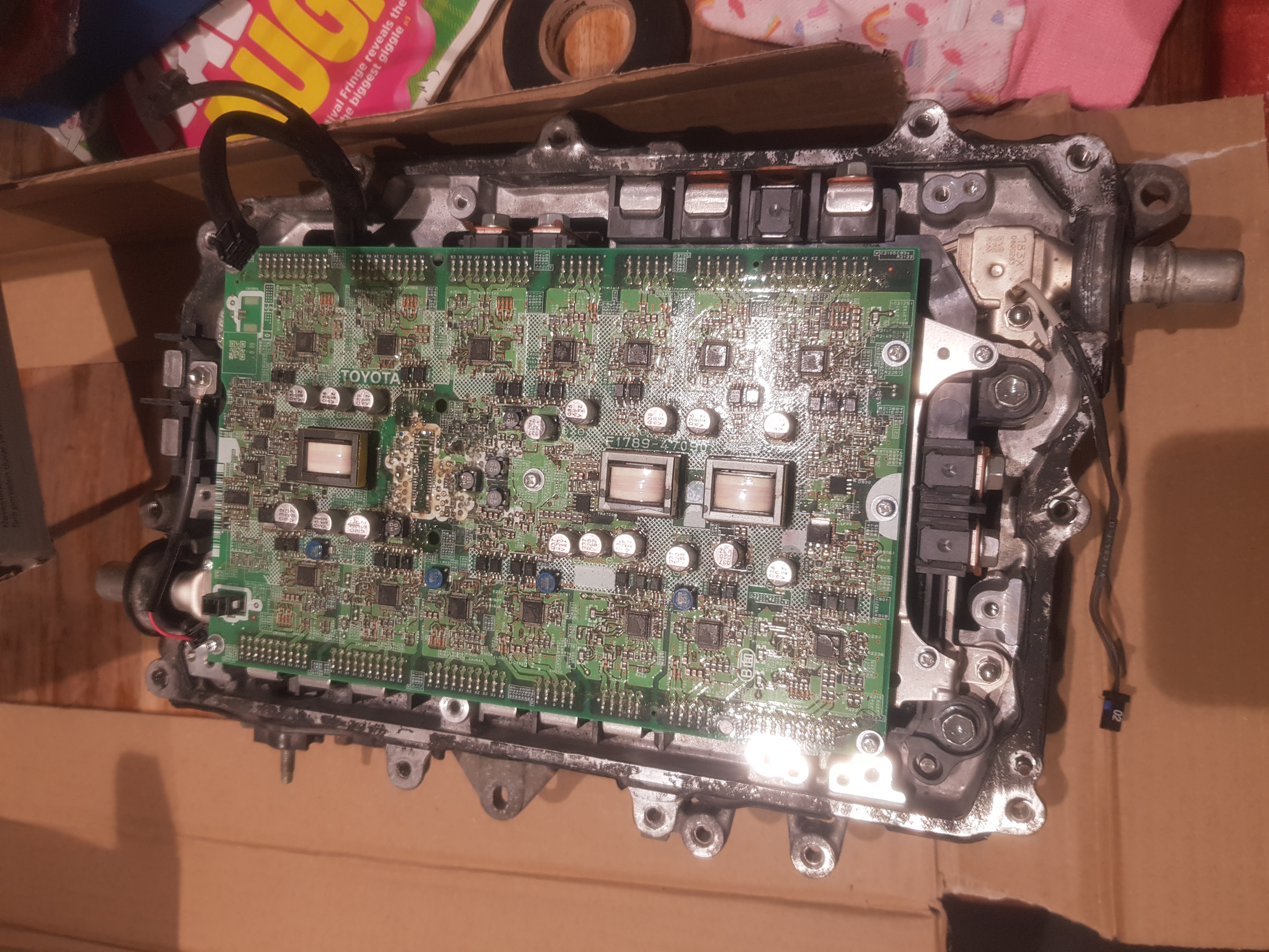

What was the failure mode of the Prius inverter that you had before the Yaris one?
Posts: 1885
Has thanked: 91 times
Been thanked: 517 times
What killed it? My old charging code didnt check the contactors was closed, the outlander charger ignores the voltage and respects the requested current. I did a firmware update while charging, silly right?, contactors opened. Charger filled inverter caps to 420v, voltage was above precharge so contactors closed right away. Blew the fuse and inverter could no longer report voltage hv so precharge error.
Still got the power stage and driver board.

Oops :(
Safe to assume that it was nothing to do with the cutt outs then!
Wonder what failed, the inverter shouldn't have had a problem with 420V, IGBTs should have been off, should have been no current through the boost inductor?
Just one thought, you are powering it direct to the DC bus terminals rather than through the Prius battery input connections aren't you?

Direct to dc bus.
Didn't spend any time looking in to why. My only thought was the rapid discharge damaged something.
Use the car daily so just threw in what I could source quickly and was offered a yaris inverter with a smashed capacitor for 20 quid.

Bigpie wrote: Tue Sep 27, 2022 7:23 am Direct to dc bus.
Thought it would be but it just occurred to me that the boost inductor in series could explain the dead Prius inverter and possibly even the cutouts so worth mentioning just in case.
Bargain on the Yaris inverter! Don't bin the Prius one, may well be some bits worth salvaging.

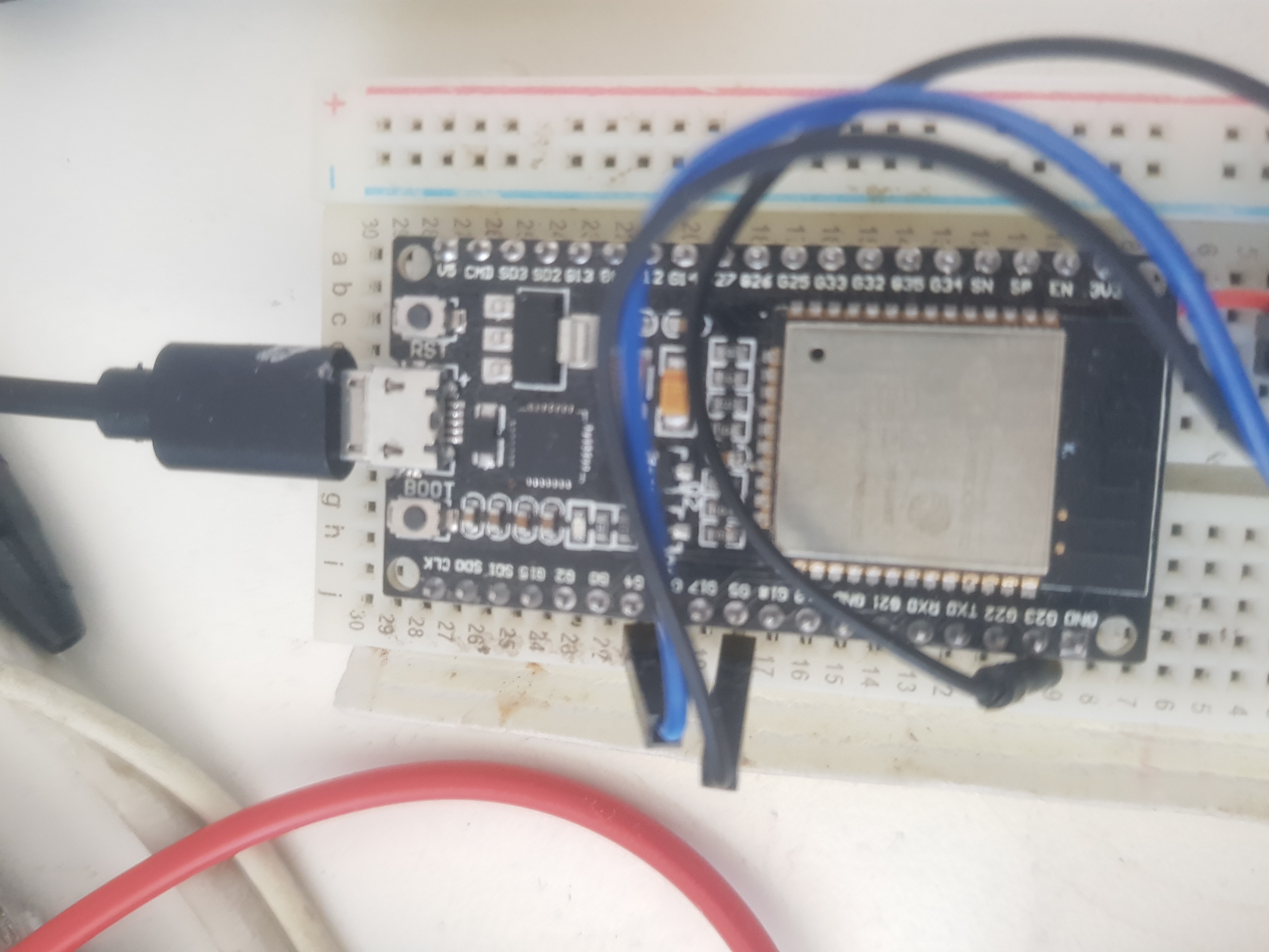

Ok, the module Ive gone for has a ESP32-WROOM-32E on it and Im going to try and get the card working in sdio rather than spi mode so anything compatible with those should work fine. Will start a new thread for it once the bits turn up.

Did you get a dev module with built in sdcard or a separate one? Got a link?

Couldnt find one with an integrated SD so went for one of these https://shop.pimoroni.com/products/adaf ... kout-board, should be here tomorrow.
Edit - once the coding is done ill have no real use for the dev boards (plan to build the bits directly onto my board eventually) so happy to pass it on if it helps.

Got a few pretty similar on desk next to me atm. Just need to pickup an sdcard breakout.

That should work fine.
Ive also ordered an I2C rtc to use with it to time stamp files. I have sd card logging on the ecu of one car and it just uses sequential file names, its always a right PITA figuring out which file is the one that needs downloading.
Edit - do you use the Arduino environment or Platformio to code for the esp32?
Edit2 - For further details of data logger see here viewtopic.php?t=2690

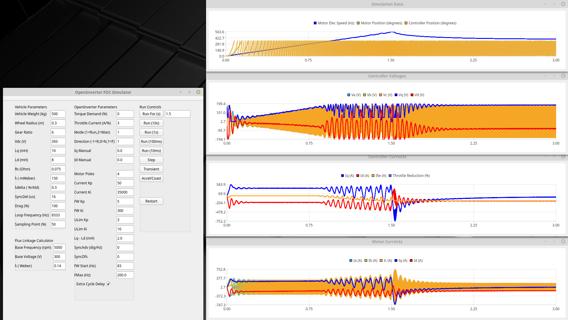

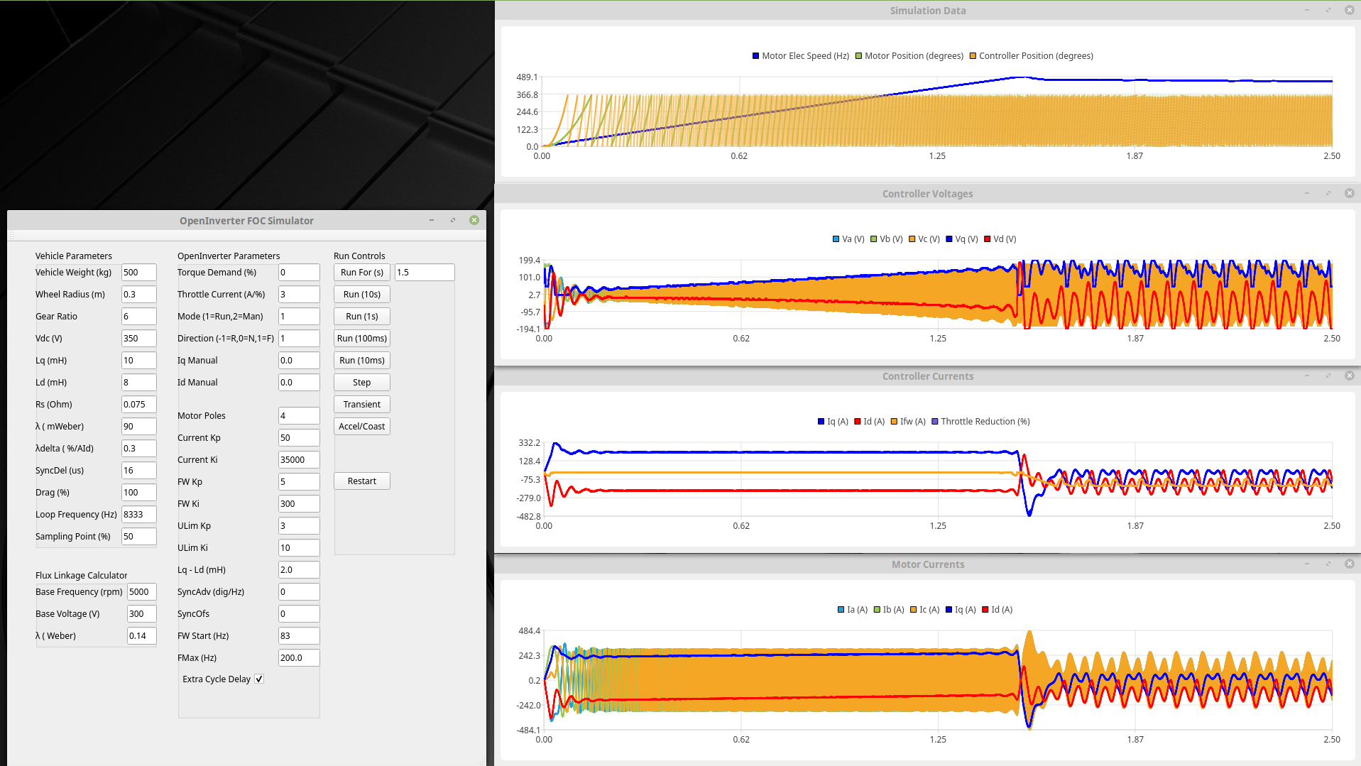

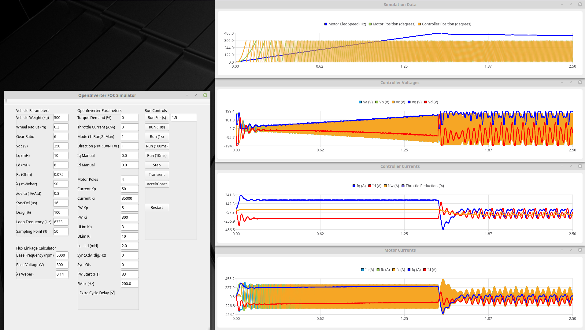

Here are the plots, two for each. One run just accelerating and one accelerating to around 7krpm and then coasting.
fwmargin=2500, d-controller max-1000:
fwmargin=4500, d-controller max-3000:
The differences are fairly subtle and there is no significant difference between the behaviour of the two coming off the throttle. None of them look stable though and they are both going open loop at times when moving to coast. My gut feel is that you were lucky with the 2500 version (it was still going unstable/open loop but not in a way that produced the nasty effects) and it only took a small change to push it outside that sweet spot. Without more detail (a high speed log for example ;) ) I'm not sure it's worth spending much more time looking at this. Once it goes unstable it becomes highly unpredictable and I don't believe my model is good enough to be representative at that point.
The goal has got to be to get the control loops stable and staying within the closed loop region. I think part of the problem is that when you come off the throttle the Mtpa pulls a lot of -Id out. Up to that point that -Id has been helping with the FW but with it gone the FW controller has to suddenly add a lot more -Id to replace it to stop the motor voltages shooting up (you can see this in the plots where Vd and Id shoot up to full scale positive before being slowly pulled back down). This required a very fast FW loop response which then compromises the normal FW control and causes all the noise problems that can be seen in the plots. By changing to the FW and Mtpa scheme I suggested above you avoid this discontinuity completely and can instead tune the FW controller to be a lot slower which avoids all the noise and avoids a lot of the stability issues.
Edit - you can also see the difference between the controller view and motor view of the currents in the plots. Sync compensation should help with this and allow better separation of the q and d components.
Edit2 - That's interesting, based on the simulation FW isn't needed at 7k, will have a look at the settings as see what that means!

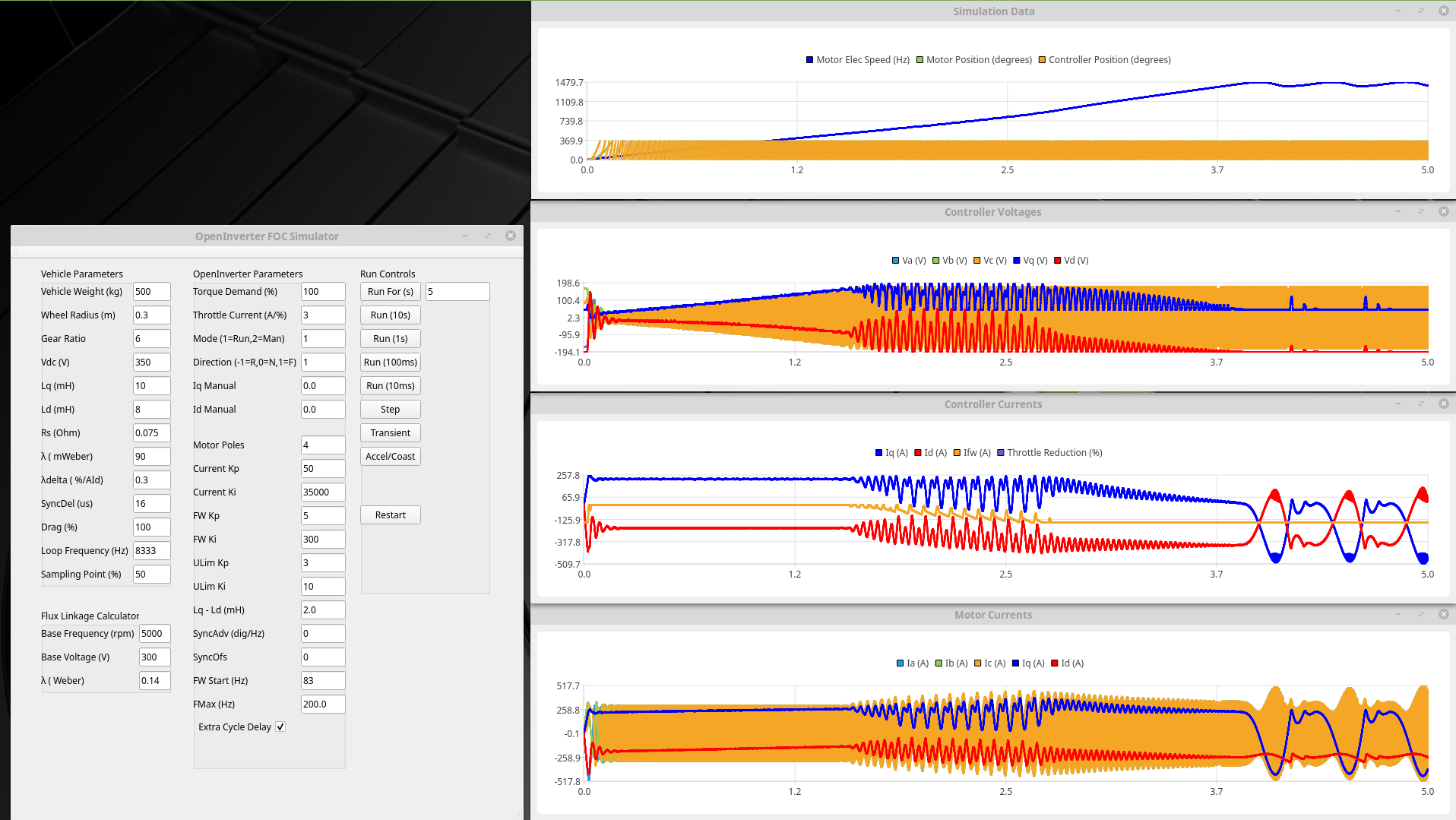

Two new plots, both accelerating to around 7k and then coasting but with the value of 150 for flux linkage so that FW is now active at that point.
fwmargin=2500, vd = max-1000:
fwmargin=4500, vd = max-3000:
Except that I got two of the plots swapped on screen :oops: they look very similar. The fwmargin=2500 is slightly more stable (bigger overshoots on the currents on the fwmargin=4500 plot) but there is not that much in it. All the comments in the above post still apply.
