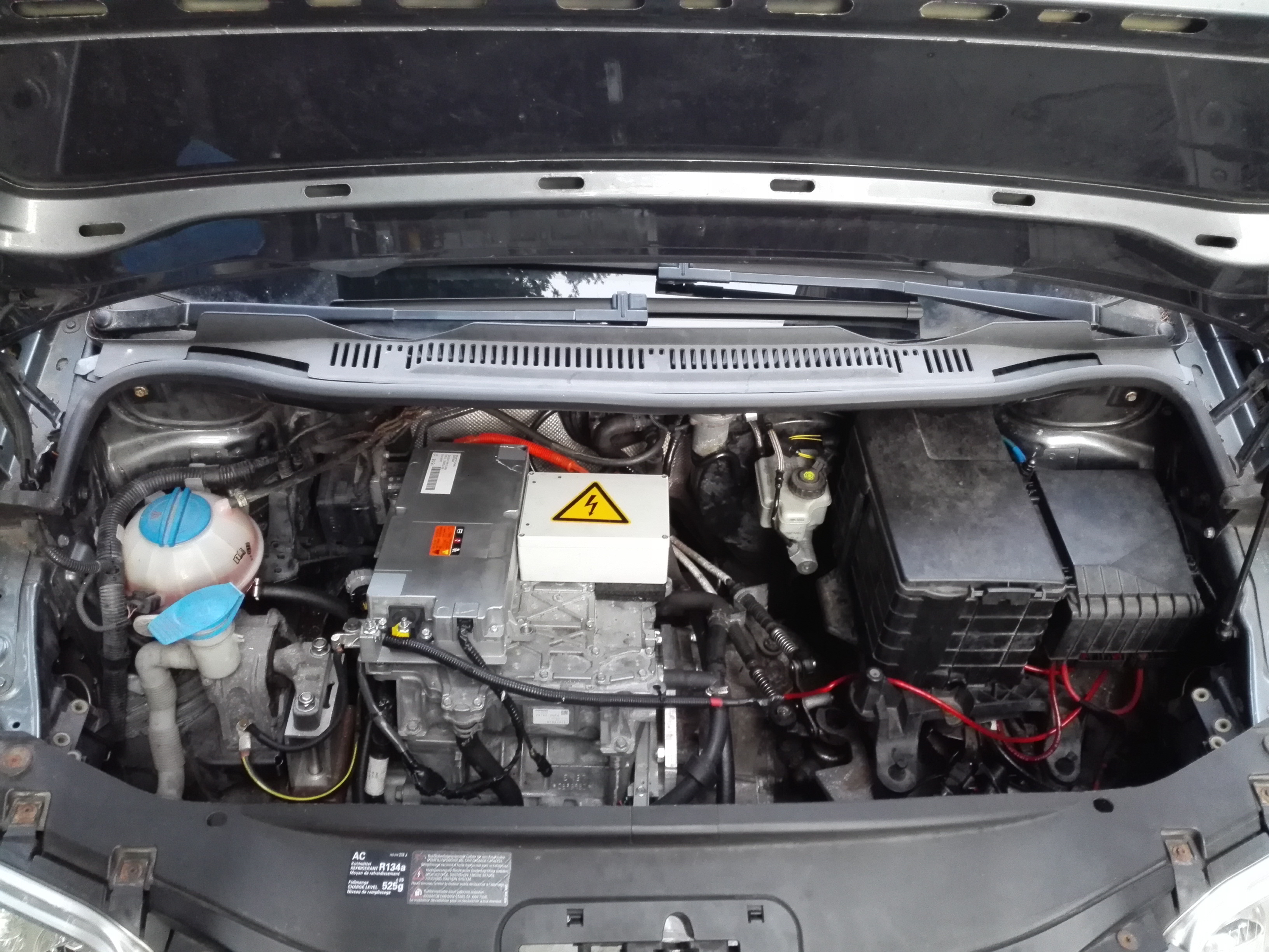

So, biig Touran update.
First, the road trip. Drove a total of 1200 km last week. Lots of charging needed, must be the cold weather. I started with batteries cooled down to 3°C. I drove quickly to the first quick charge stop after just 70 km and by then they had reached 18°C. They will charge at 50 kW at that temp but not for long. At around 40% it throttled down to 30 kW and when it reached 10 kW at 70% I decided to leave.
Batteries did rather cool down 3-4°C while driving between the charge stops and heated by around 10°C when being charged. So not rapid gating problem, rather cold gating.
All went well on that first leg. When driving the final stretch from Mannheim to Neunkirchen (about 130 km) I decided to try if I could go 96 km on a full battery. I passed the charger at Kaiserslautern (which I don't favour because you have to drive into the city) with 35% and 25 km to go. After the last possibility to get off I noticed the voltages looked rather low, like 3.4V under light load. But SoC was still 20%, so WTF? Well it was no good, I just reached the exit with the BMS commanding 0 kW power limit and the lowest voltage being 2.4V.
So exit reached, but not the charger. That was still 2 km away. The gas station where I was stranded had a 400V 3-phase outlet and let me use it (with rich mans charger). Just that - the outlet was dead.
I took one more look at the charger map. A type-2 charger was advertised just 500m away. I decided to give that a try. With the help of a gentle push I made it in front of the hotel with charger. Which --- didn't work. The guy from the hotel even tried his own RFID but even that was rejected.
I bailed out and called by father to drive 30 km to Landstuhl (where I was at) and give me the short tow to the fast charger.
Had to trick the inverter into starting as udcsw was too high for the depleted battery. During the tow I sucked some amps from his e-Golf via regen and was at least able to drive up to the fast charger myself
Similar thing happened on the way back. At 15% the battery is essentially empty, not sure why the BMS doesn't correct the reading. Maybe the current sensor just doesn't match the BMS? It is a Gen2 sensor on a Gen1 BMS. But then, when charging from ChaDeMo the EVSE and BMS currents do match up. Weird.
So on the way back it turned out the road was closed just 1 km before my charge stop. Again the battery was so depleted that I got a serious power limit and I just made it to a type-2 station which actually worked. Charged just enough to make it to the next fast charger.
Not so happy about the BMS situation because that seriously throws off my charge planning. Maybe I should just get a 40 kWh battery with a matching BMS.
On the plus side every single fast charge session worked and no charger was ever blocked.

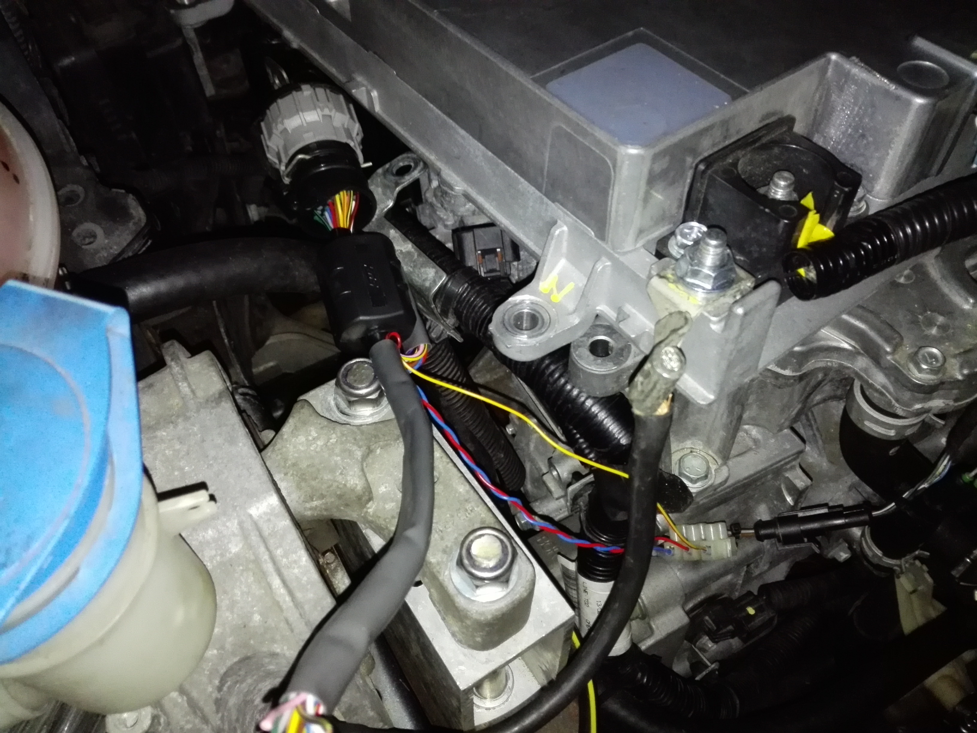

DC-DC Upgrade
I took reception of an Ampera DC-DC converter, thanks Arber
I has a 12V enable and CAN. I found CAN on the dangling round connector that used to connect to the PDM (aka bigass Nissan charger). Also made sure to put switched 12V on there. Operation is governed by CAN message 0x1D4 - which is also used by the Nissan BMS
But lucky me, DC-DC used the first 2 bytes, Nissan the last 2 bytes
and there seems to be no unwanted effect. Only downside for me as a software perfectionist: I now have DC-DC code in the BMS module...
Programmed it to enable the DC-DC 1s after closing the contactors. Voltage is now really stable at 13.8V no matter which loads I switch on. Still not getting much power on the PTC, will need to check that separately.

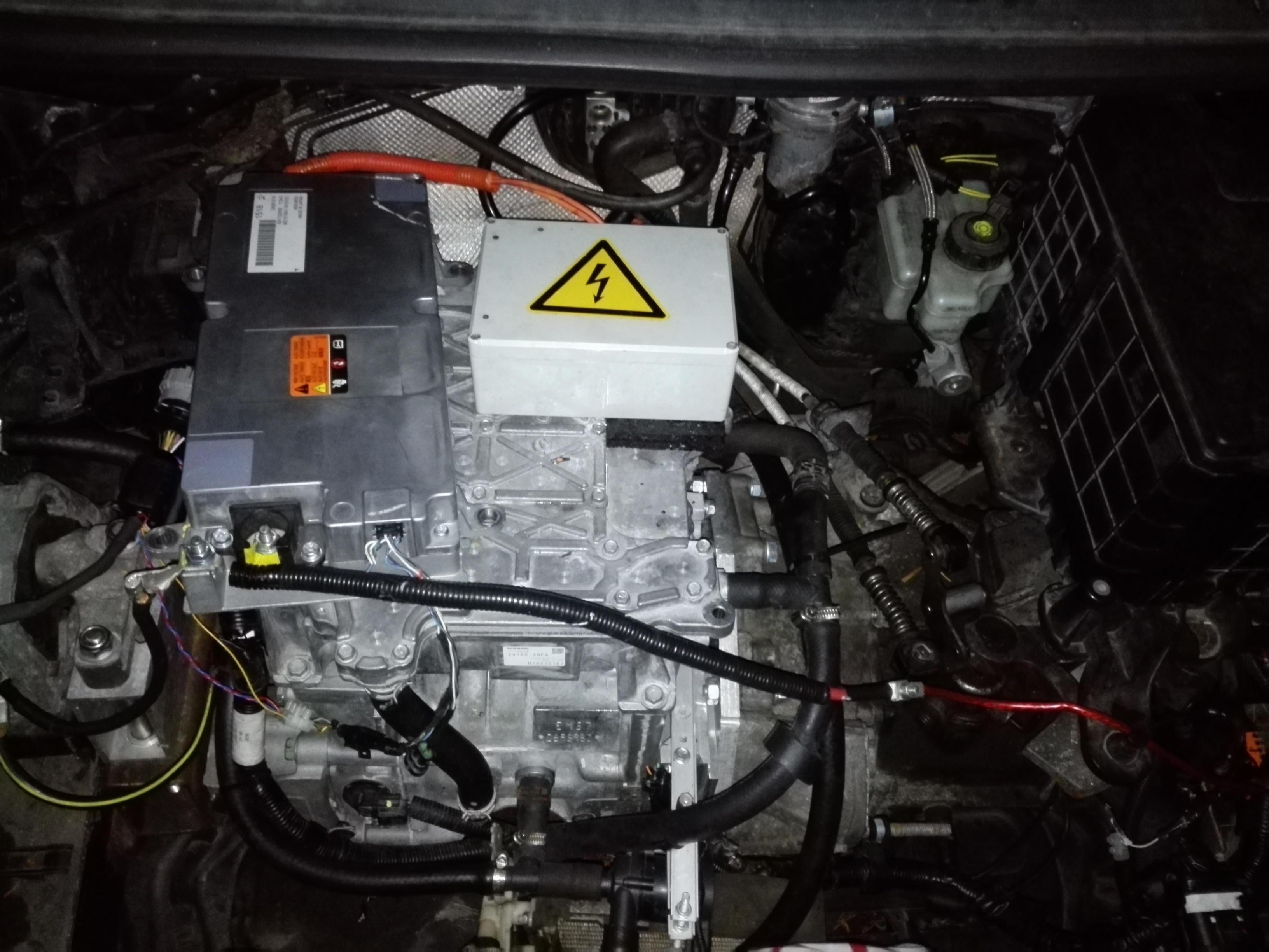

No, still 24 kWh. I'm eager to swap it for a 40 kWh pack.
Bolted the DC-DC in yesterday. 3 bolts through 90° angle on the inverter, 2 bolts to DC-DC just on one side. it is a bit wobbly, might add another restrain on the right. The fins are exactly opposite of the former air intake, so I'm hoping cooling will be sufficient from the natural air stream. Maybe a duct would be a good idea also.
The car uses about 20A in standby, head lights add another 10A and of course the heater adds many amps. Since that is not active in summer, I think passive cooling should be adequate.

I have the same DCDC as you and have it mounted 'outside' in the old fuel tank area with no additional cooling (plastic undertrays of car protect it from splashes). It's been fine for the past 8 months / 3000 miles. It only draws about 30 amps with everything switched on including heating fans, wipers and lightsjohu wrote: ↑Fri Dec 11, 2020 2:29 pmNo, still 24 kWh. I'm eager to swap it for a 40 kWh pack.

Ok, thats rather encouraging to hear. Seems I now have a fanless car

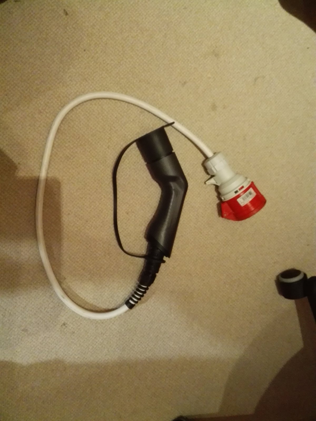

Johannes, would you share a bit more how can you charge from type2 public charger since you don't have a nissan charger on board? I know you have your own handmade charger but you are not using that with type2 only with regular 3 phase? Are you using inverter as charger? If so can this be done with Prius gen3 inverter and synchronous motor? Thank you
- Been thanked: 1914 times
Yes, I use this adapter cable and rich mans charger
I also have a Type-2 to Schuko adapter for poor mans charger.
Both chargers have CHAdeMO output and thereby interface to the car.
