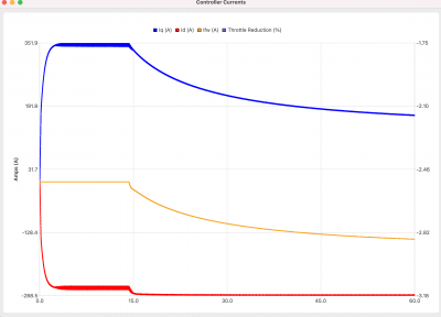

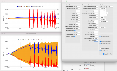

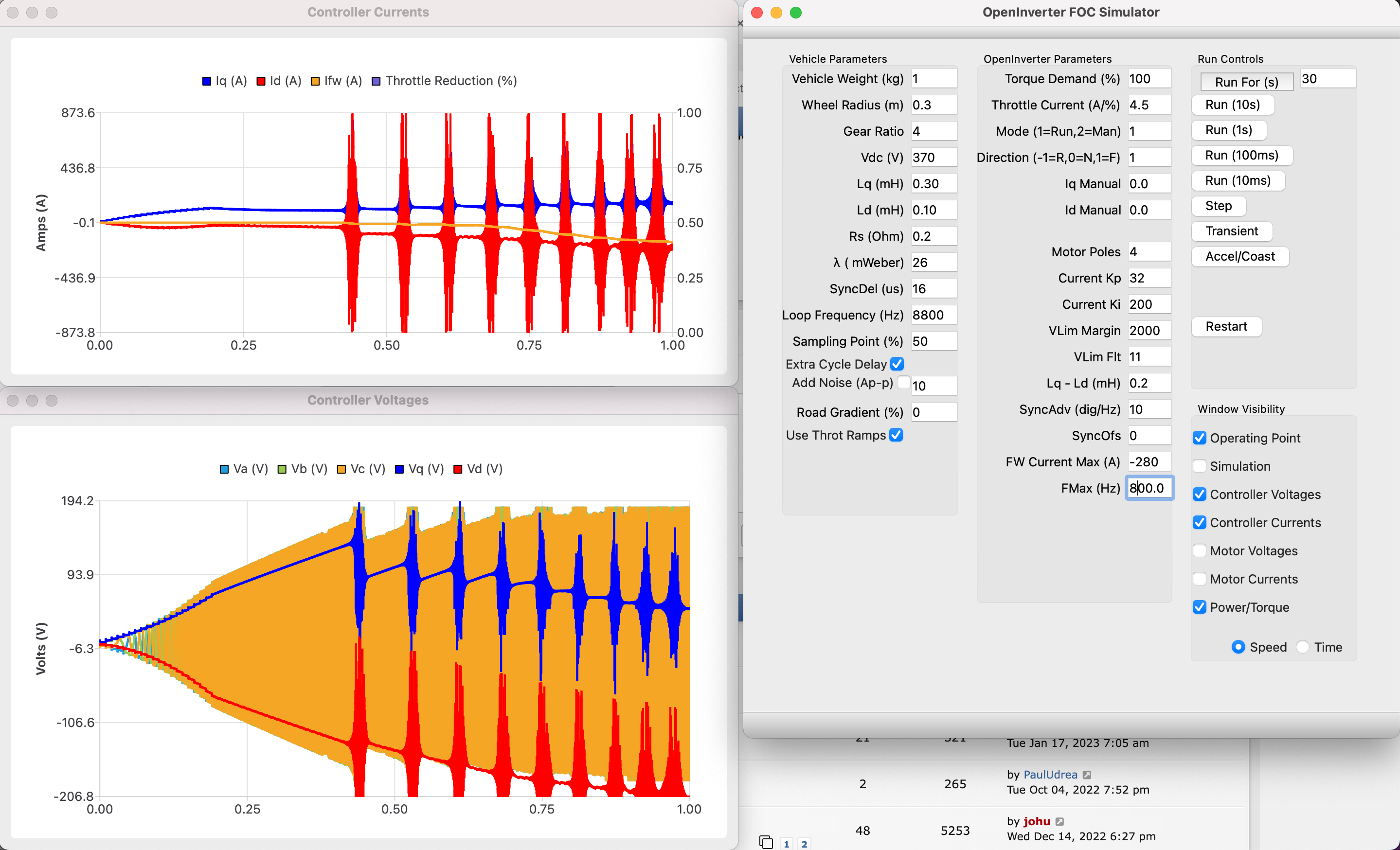

Struggling to get anything that looks stable with with the sim built against latest release.
This seems to be closest I can get, any ideas?

Not this is it viewtopic.php?p=50997#p50997?
Also if you are still on my code fork you may have problems with the latest sim?
Edit - alternatively it could just be accelerating to a speed where the control loops can't keep up and you get unwanted regen (you only have a vehicle weight of 1kg set!)
Edit2 - Yep, just checked, it's accelerating up to high speeds and the control loops give up, unwanted regen slows it down, and repeats over and over. Increasing vehicle weight should fix it.

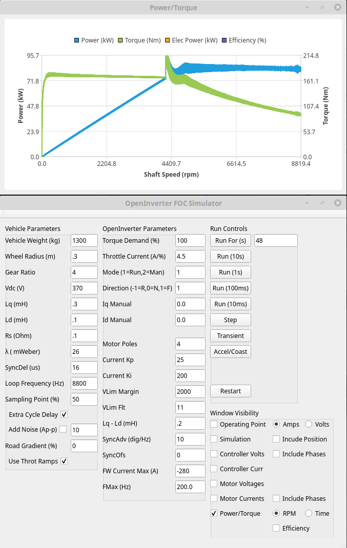

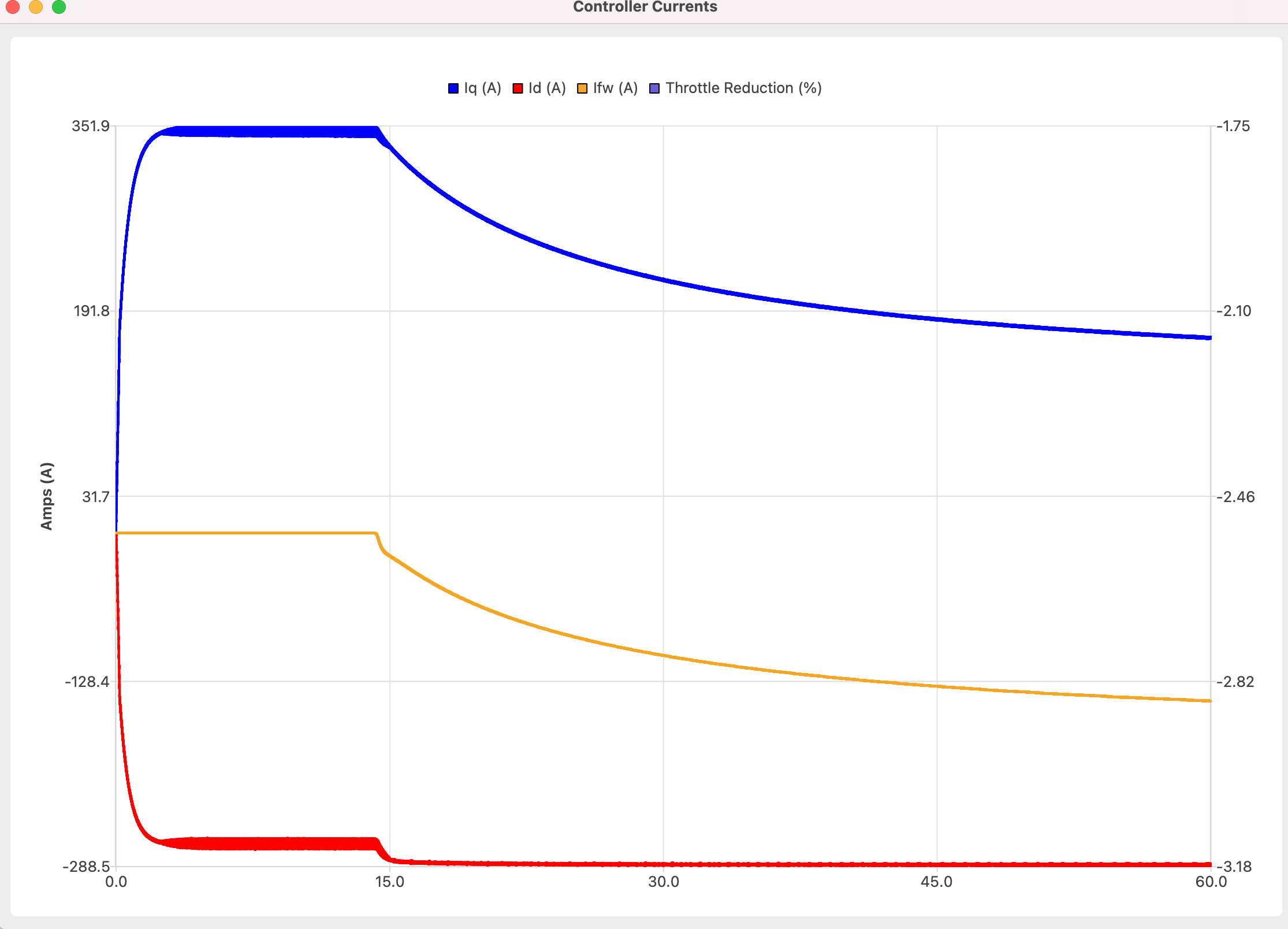

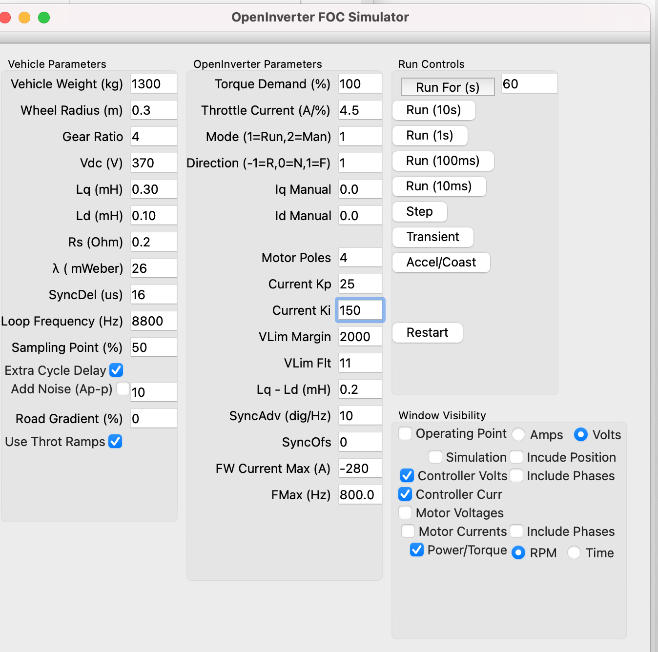

Ahh, I'd checked out Johannes fork. I've sync'd with your repo now and it's working and got some fairly stable plots from the looks of it. Admittedly, I'm still not 100% sure I know what and ideal plot will look like and which parameters will have what effect on various aspects.
My ignition switch seems to have broken though, I've constantly got 12v on the start line, so as soon as I power up the inverter tried to start in run mode so got to either address that or fudge something so I can update and change params.
I've got Janosch, bobby_come_lately and rstevens81 visiting next week so want to get the car performing as good as it gets this weekend
They last drove the car pre pete. I *think* these are best simulation settings I've got but will test them in the car at weekend on 5.24

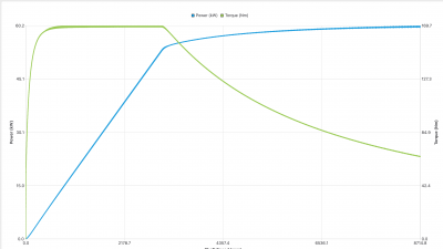

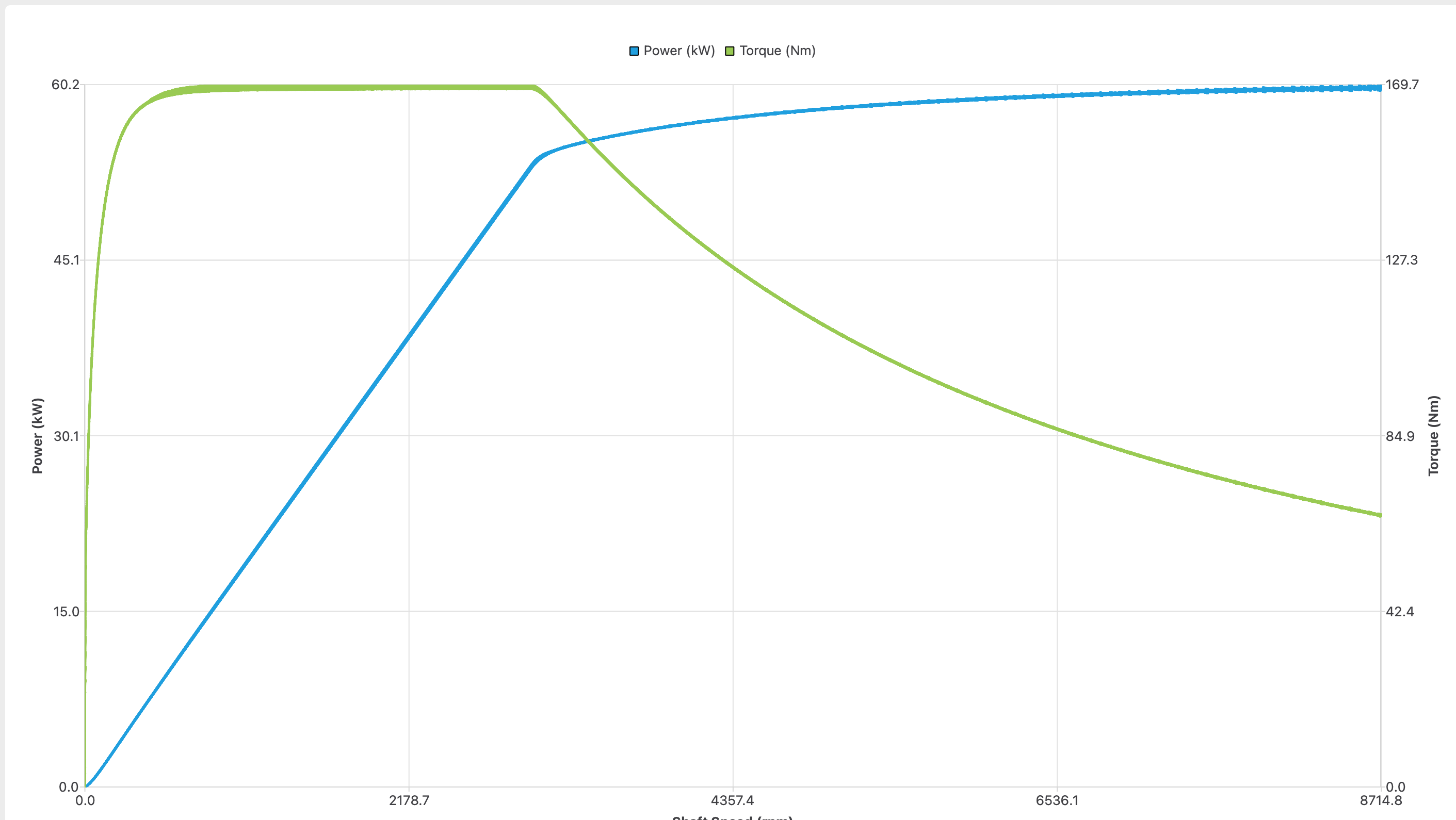

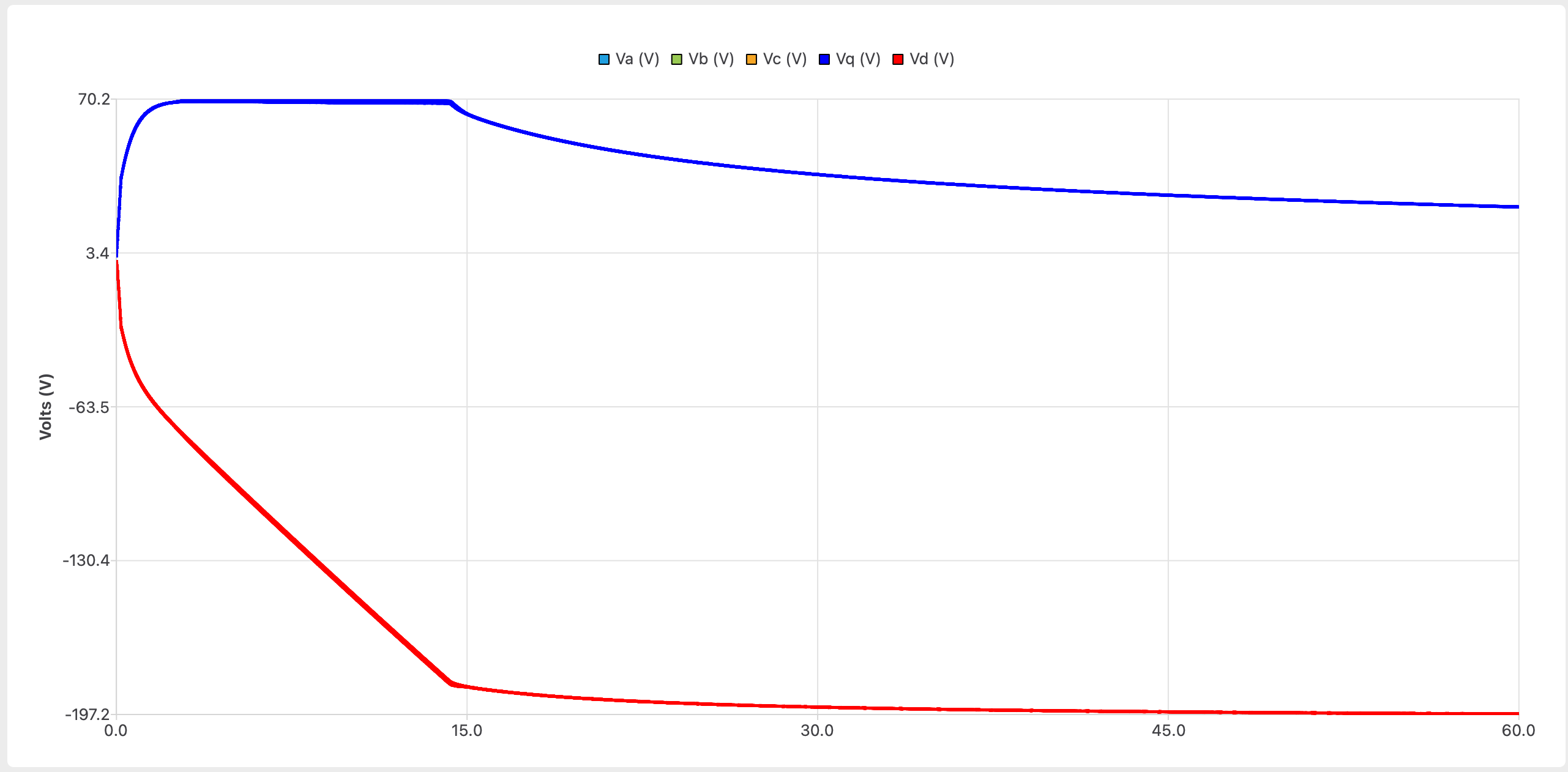

Not looking bad at all, think your motor resistance is probably on the high side though, I'd drop it to around 0.1 and see what difference it makes. It should lift the power a bit.
Noticed your plot is saturated on Ud not Uq which made me wonder what the MTPV stuff might do for it so tried your settings (except for the resistance, dropped that to 0.1 which may explain some of the gains) and got this: Not sure whether to believe that or not (it's without over-modulation too!).
Still needs a bit of work, you can see it doesn't transition between MTPA and MTPV nicely and it's prone to oscillation but there is definately potential there.

The above is without over-modulation, just MTPV. With both it should add a bit more. Was hoping to have something to test by the weekend but it's not looking too likely at the moment

Your ki and kp both seem very low but I didn't see any real improvement when increasing them and your sim plots look pretty good. Worth trying Johannes latest code first as it should be an improvement.

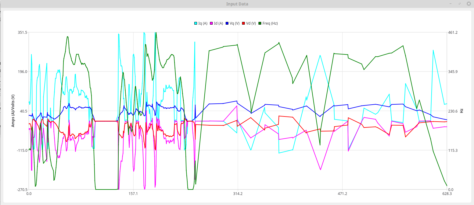

Managed to get a cutout on 5.24 too unfortunately, was web logging at the time and attached to my project thread.
Pete9008
- Posts: 1801
- Has thanked: 102 times
- Been thanked: 350 times
Had a look but nothing obvious in the plot. I'm not even sure where the cutout is. Here is what the log looks like: Not sure where the cutout is in that, any ideas?
The voltages all do seem pretty low, not more than half the battery voltage used.
What does look odd is the data after 250sec, not quite sure I believe that section of the log?
Edit - just logged it in open office and the second half looks a lot better, need to figure out why my plotting is not reading the second half of that file correctly
Edit2 - OK found the trip, it's at 250sec. After the trip the logging goes strange, instead of getting a row of data in the file a few times a second we're only getting one line every few seconds (with 20second gaps in places, my plotting is fine, it's open office that doesn't process the time stamps right). This is odd, looks like the trip, or restart, somehow messes up the logging function, not enough to kill it just enough to slow it down by /10-/100 ?!?
Still nothing obvious jumping out as to the cause of the trip. The question is does the trip cause the logging disruption or does whatever causes the logging disruption also cause the trip?
Edit3 - The logging seems to continue for around a second after the trip. This would suggest that the restart somehow breaks the logging so the logging disruption is nothing to do with the cause of the trip.
The big problem here is we have 1 measurement point every 300ms, that about 2600 runs of the control loop. Looks like we might still need the binary fast logging to find this?

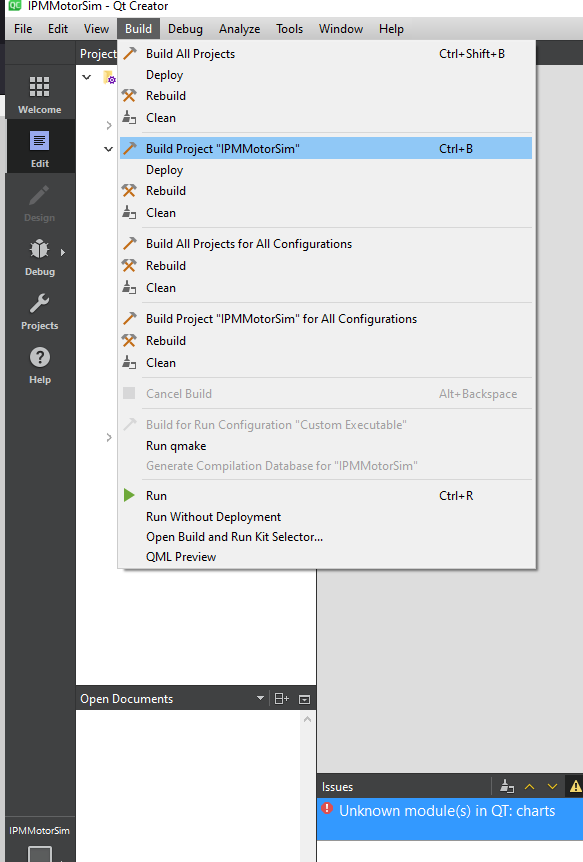

Hey quick question, trying to get this working and got stuck at building the software.
The instructions say
but there is no such option. I tried "Build Project 'IPMMotorSim'" but I get the error:
To build the software go to 'Build' at the top and select 'Rebuild Project: IPMMotorSim'
I have no idea what I'm doing here so any help would be appreciated.Unknown module(s) in QT: charts

Sounds like you may need to install the qtcharts module, see https://stackoverflow.com/question ... -windows
