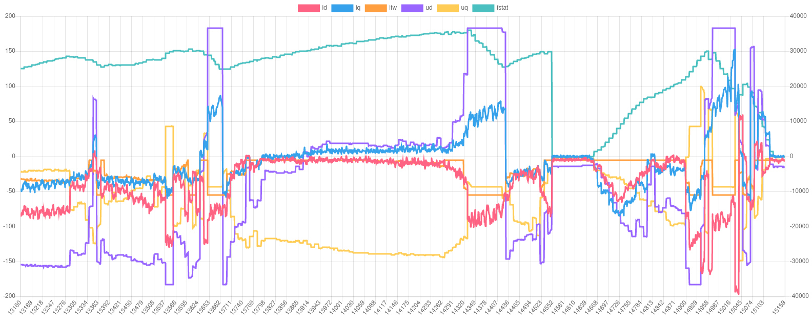

Posts: 6723
Has thanked: 370 times
Been thanked: 1547 times

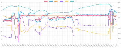

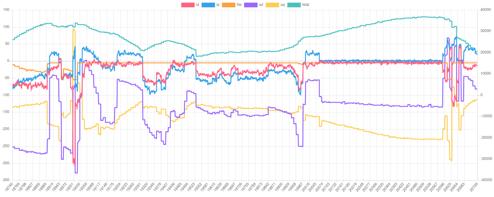

more Audi test driving, now with ADC2 software. No difference. Since I "fixed" this bug where the angle was updated after forward transform it no longer behaves :( But I want it to run with the correct angle.
It's not down to FW, it does the same jumps and suddenly locking in at maximum ud with field weakening turned off. Also tried various values for syncadv with no observable change.
Towards the end I let it coast downhill until I reached about 50 kph then touched the brake which brings in a little regen. And boom it goes silly.
And here I was kindof trying to maintain speed but instead ud saturated full positive and I got massive regen.
Whats wrong with this motor? I thought high inductance was easier to control
EDIT: can too little proportional gain make the controller unstable? It's just set to 10 right now.

Other way round, high inductance are a nightmare to control!
Fairly sure my understanding of motors is right now and one thing I'm sure of is that if the critical current is similar or less than Mtpa current the old control scheme isn't going to work over the full operating envelope. Whenever you cross the critical current the sense of the control loop reverses and it will go full scale. You can see it happening at the right hand side of the plots. With the phase reversal there is no gain setting that will keep it stable :(
TBH you need to try my code (I'm reasonably confident it will help a lot with the FW stability although if it doesn't I'm out of ideas)
Edit - see what you mean, high inductance makes it easier to keep the ud and uq controllers stable but makes the fw controller a nightmare. With low L motors it is the other way round!
Edit2 - looking at the plots again it might be something else going on. With a high L motor at high speed iq and id start to interact a LOT more, iq produces large amounts of ud and id produces large amounts of uq. This means that a rapid change in one controller can induce a big error in the other which can produce a big change in the output and so on. Essentially the two controllers are no longer independent. Wondering whether the dq compensation you mentioned is a way of limiting this?

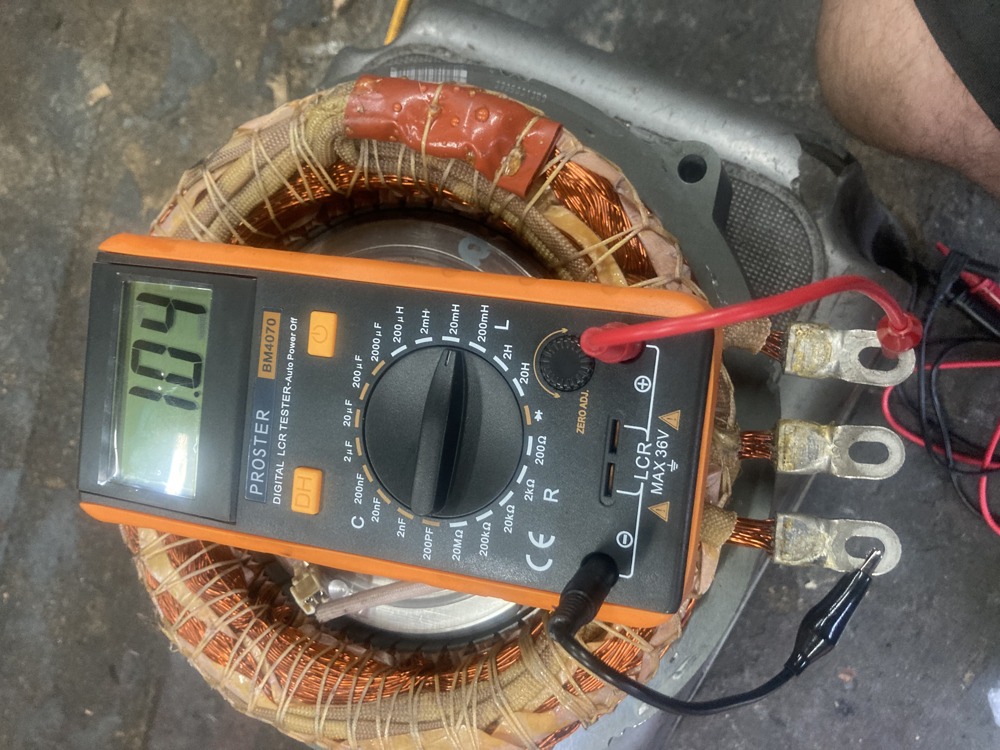

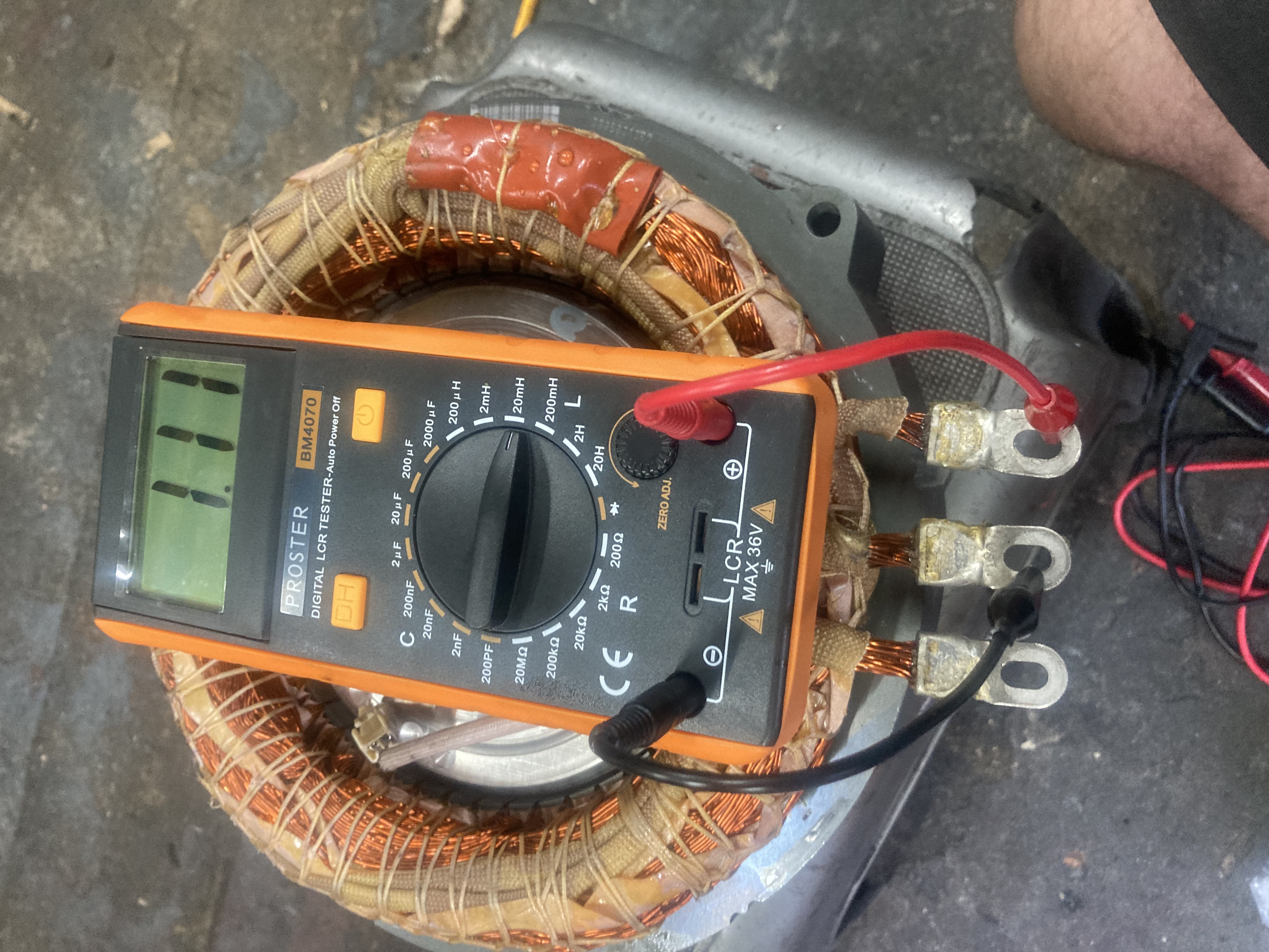

Post by Ev8 »

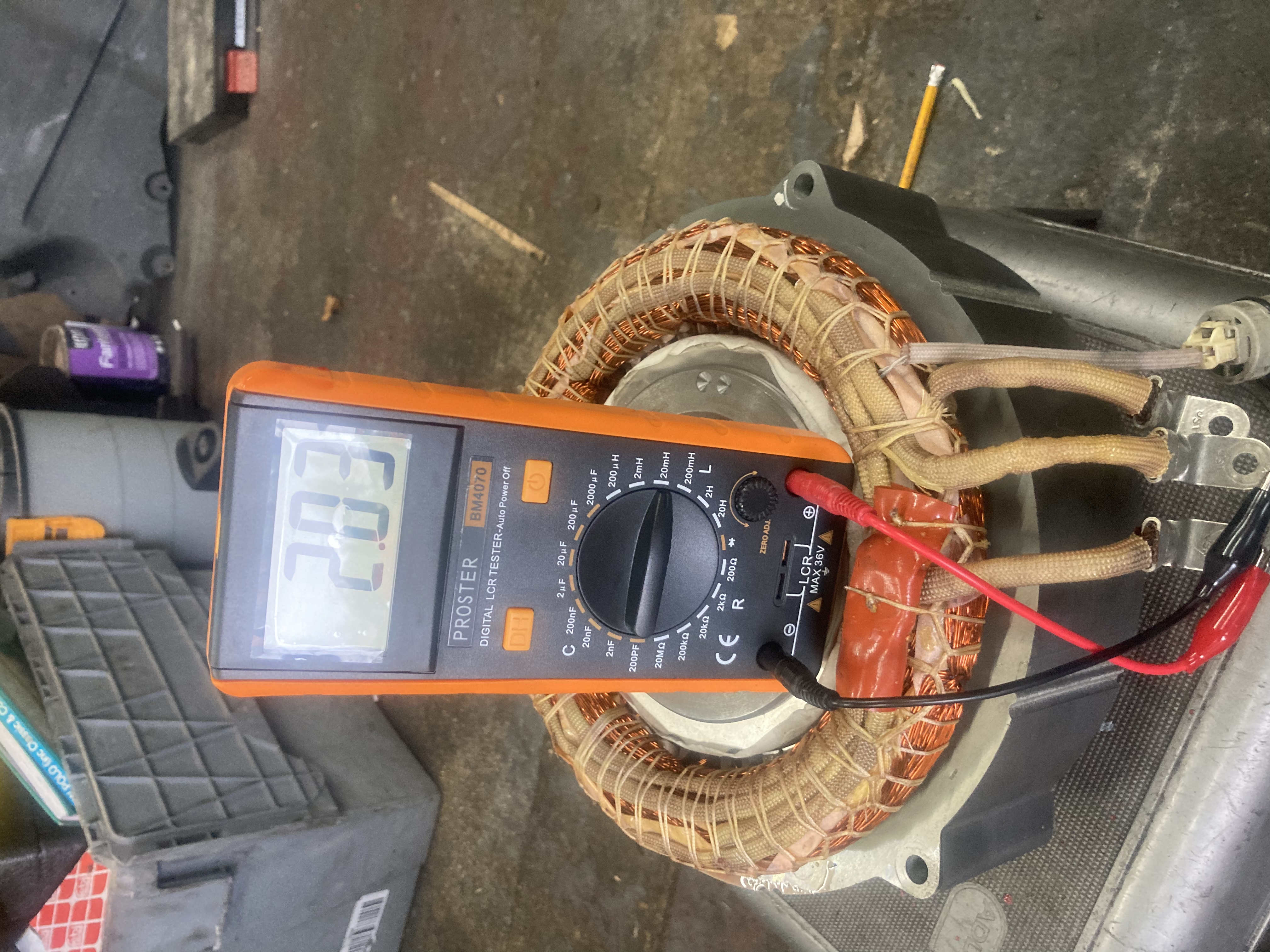

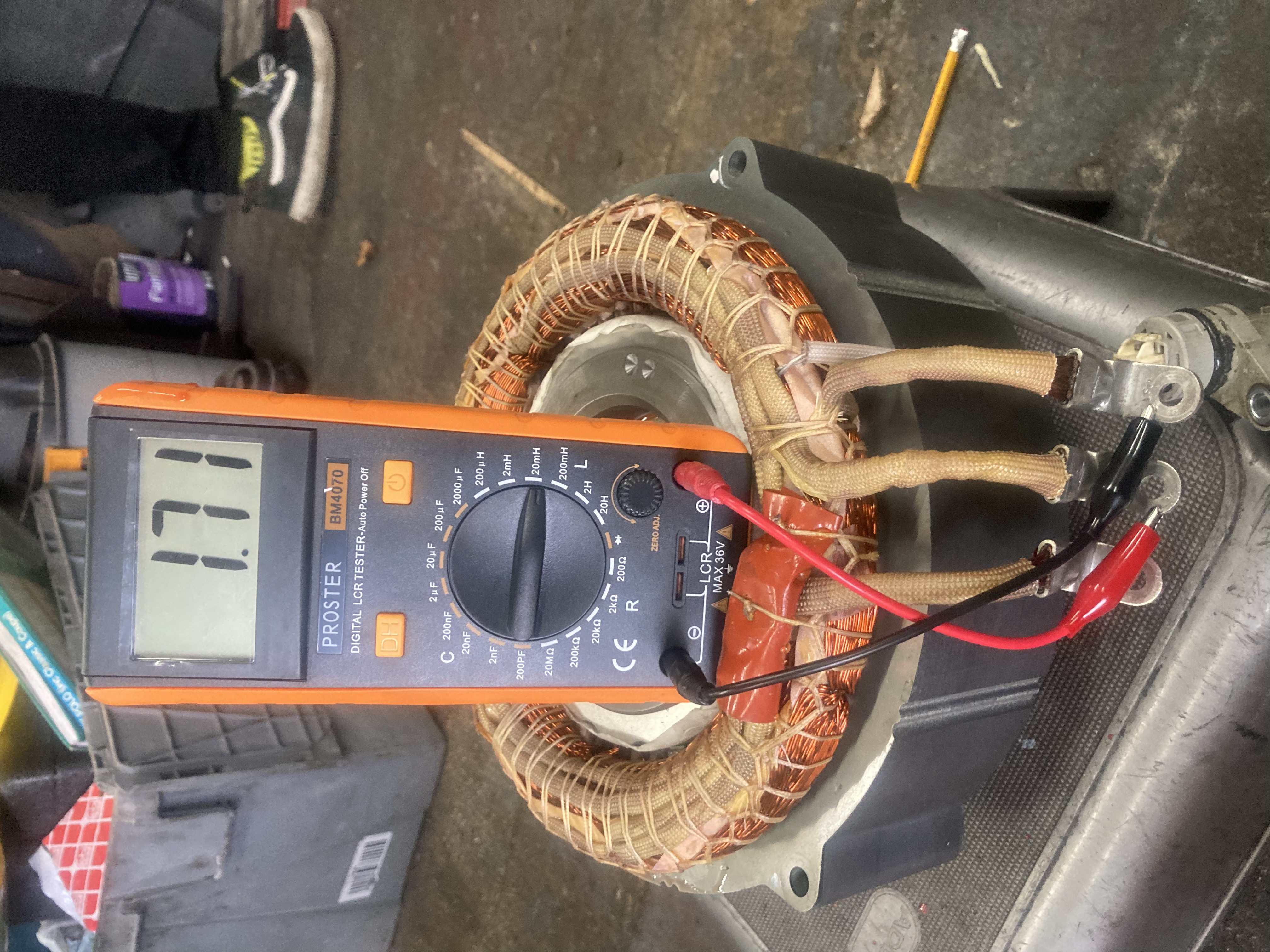

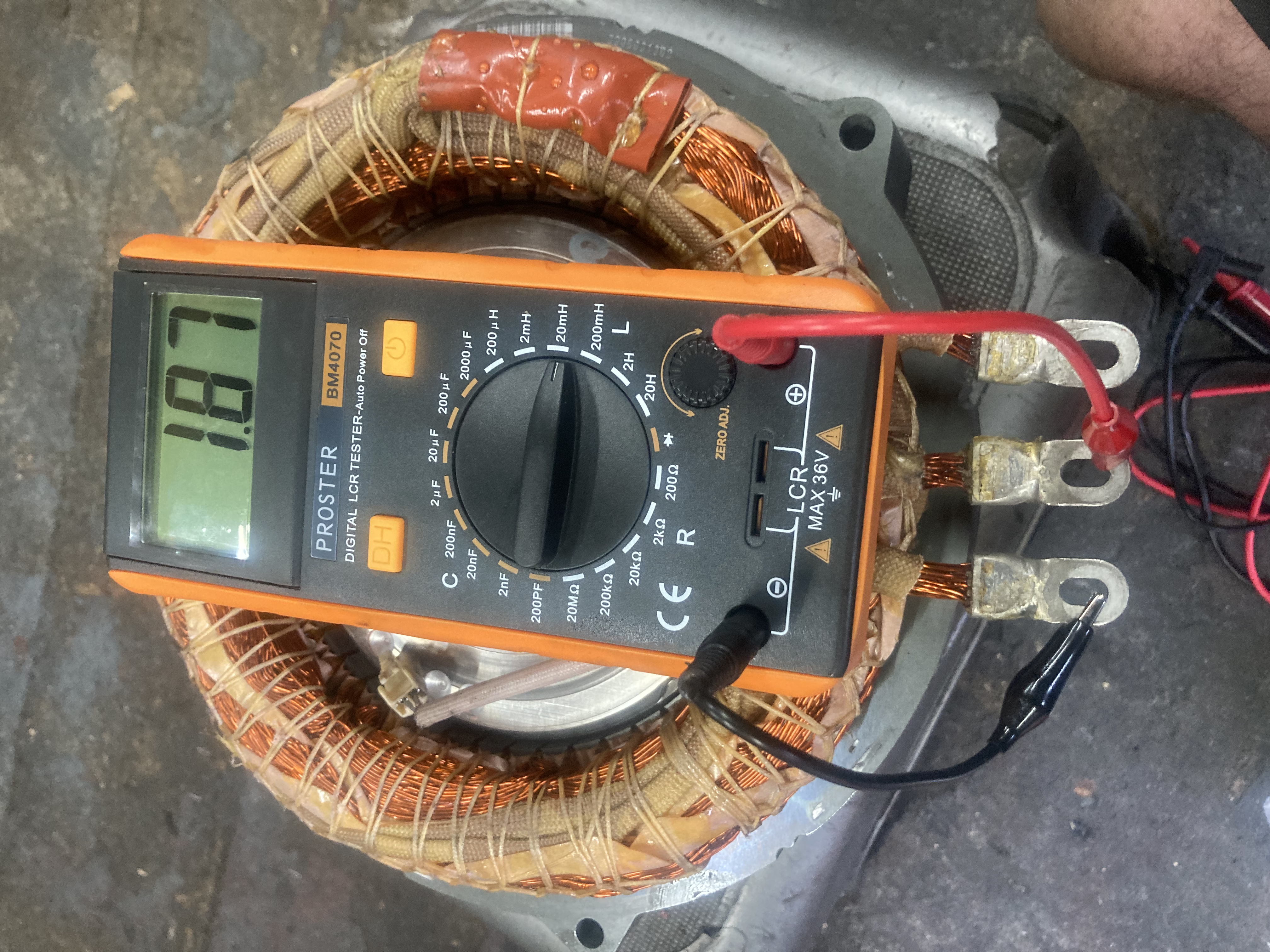

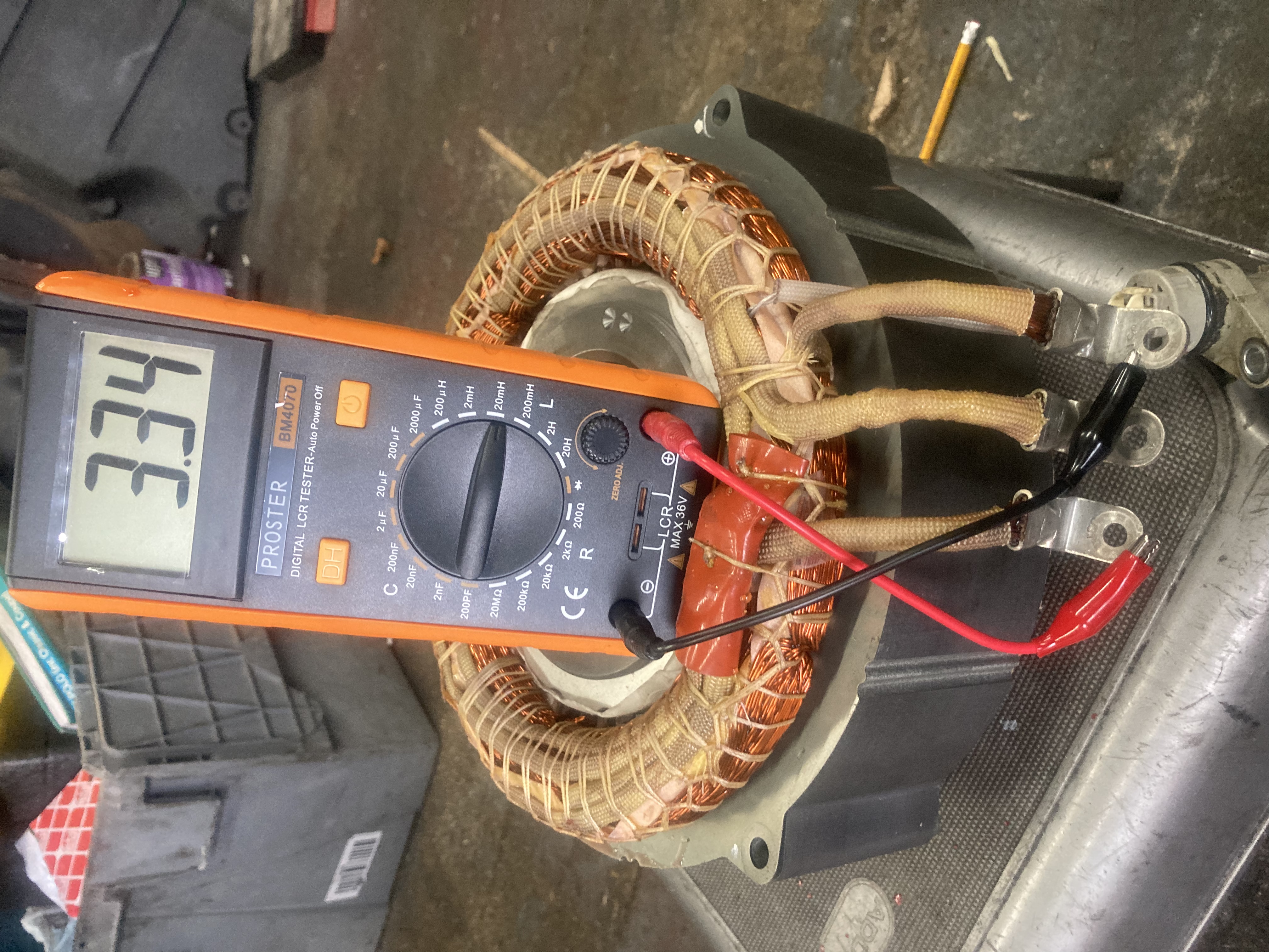

Ok I dug out some spare motor parts, only tested with stationary rotor in one position but these are Lexus rx400h transaxle
Mg2
Ev8
Posts: 818
Has thanked: 43 times
Been thanked: 163 times
Post by Ev8 »
Mg1

Ev8 wrote: Sat Oct 29, 2022 7:05 pm Ok I dug out some spare motor parts, only tested with stationary rotor in one position but these are Lexus rx400h transaxle
Thanks for taking those but any chance you could redo them :( To measure Lq and Ld you need one lead on one phase and the other two phases shorted together to the other meter lead.
I'm sure there is a way to convert your measurements to Lq and Ld, I just don't know what it is :(
Sorry, should have mentioned that before.
Edit - I'll have a google first to see if I can find how to convert them. Anyone know if these motors are star or delta wound?
I think the converted numbers are:
MG2: Lq = 2mH, Ld = 1mH
MG1: Lq = 1.1mH, Ld = 0.6mH
Without spinning the rotor those could be plus or minus a bit but should be fairly close. The Lq measurement will be a bit low as the motor wouldn't have been correctly aligned for them so maybe 2.2mH and 1.2mH respectively??
Not low inductance but then nowhere near as high as some of the numbers we have been working with :)
Threw these numbers into the simulator and with 300V it gave a peak power of 100kW dropping to a steady 30kW at higher speeds for each of MG1 and MG2 (MG1 stronger at low speeds, MG2 happier spinning up to higher speeds). No idea how that compares to reality? (Edit - Hmm, those power numbers don't seem quite right, need to have another look at that)
In case the conversion equations are useful to anyone else:
Phase measurement to winding inductances La=(M1+M2-M3)/2, Lb=(M2+M3-M1)/2, Lc=(M1+M3-M2)/2
Winding inductance to Ld/Lq measurements L1 = La + ((Lb*Lc)/(Lb+Lc)), L2 = Lb + ((La*Lc)/(La+Lc)), L3 = Lc + ((La*Lb)/(La+Lb))
Assuming the motor has naturally come to rest aligned on one phase one measurement will be low and will be Ld the other two should be larger, roughly equal and a bit smaller than Lq (for example MG1 above came to 0.6mH, 1.1mH and 1.0mH).
