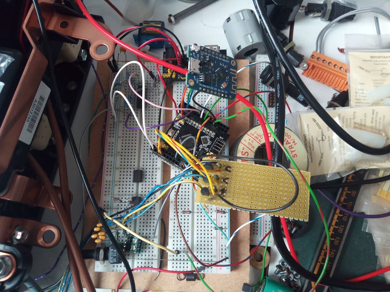

Connect your inidcator bulb between one of the phase terminals (U, V, or W) and HV+ on the bus supply.
Okay, so I think that's what I put in my diagram above, except you split the system 12v from the bus 12v.
Good so far, I have two power supplies.
By default, the lower transistor in each half bridge is on when the IPM is enabled, so the bulb should light on all three phases.
Surveyyyyy SAYS?:
... nothing.
Well, 0.26v on between 12+bus and any phase. -0.26v between Gndbus and any phase.
Connecting or disconnecting MSDN to 12+system has no effect on this voltage.
I even got paranoid and swapped my gator wires just to reconfirm.
Also swapped out a new Dupont wire on MSDN, just in case. No change.
Find the PWM signal for each phase, these are;
MUU (Blue/Black) pin 18 on the IPM, pin 9 on I-10
MVU (Blue/Yellow) pin 19 on the IPM, pin 10 on I-10
MWU (Yellow/Black) pin 20 on the IPM, pin 11 on I-10
The voltage on these connections should be similar (or I recall a little higher) than the system supply. This is the internal pullup.
Yes. 14.6v across any phase to ground, with a 12v system supply. So, a little higher, yeah.
Oh, and, one other thing no one's mentioned, but just to rule it out, since the lid has been off this whole time (months), I've got a jumper jammed into the enclosure switch to jumper it closed (have for months, nothing's changed). Gave it jiggle, seems solid. However, removing it has no effect on the voltage I was measuring either. Still 0.26v.
There's also a little white connector with a single wire, that connects to the case switch, that I do nothing with.
Here's my setup just in case I'm communicating this wrong.

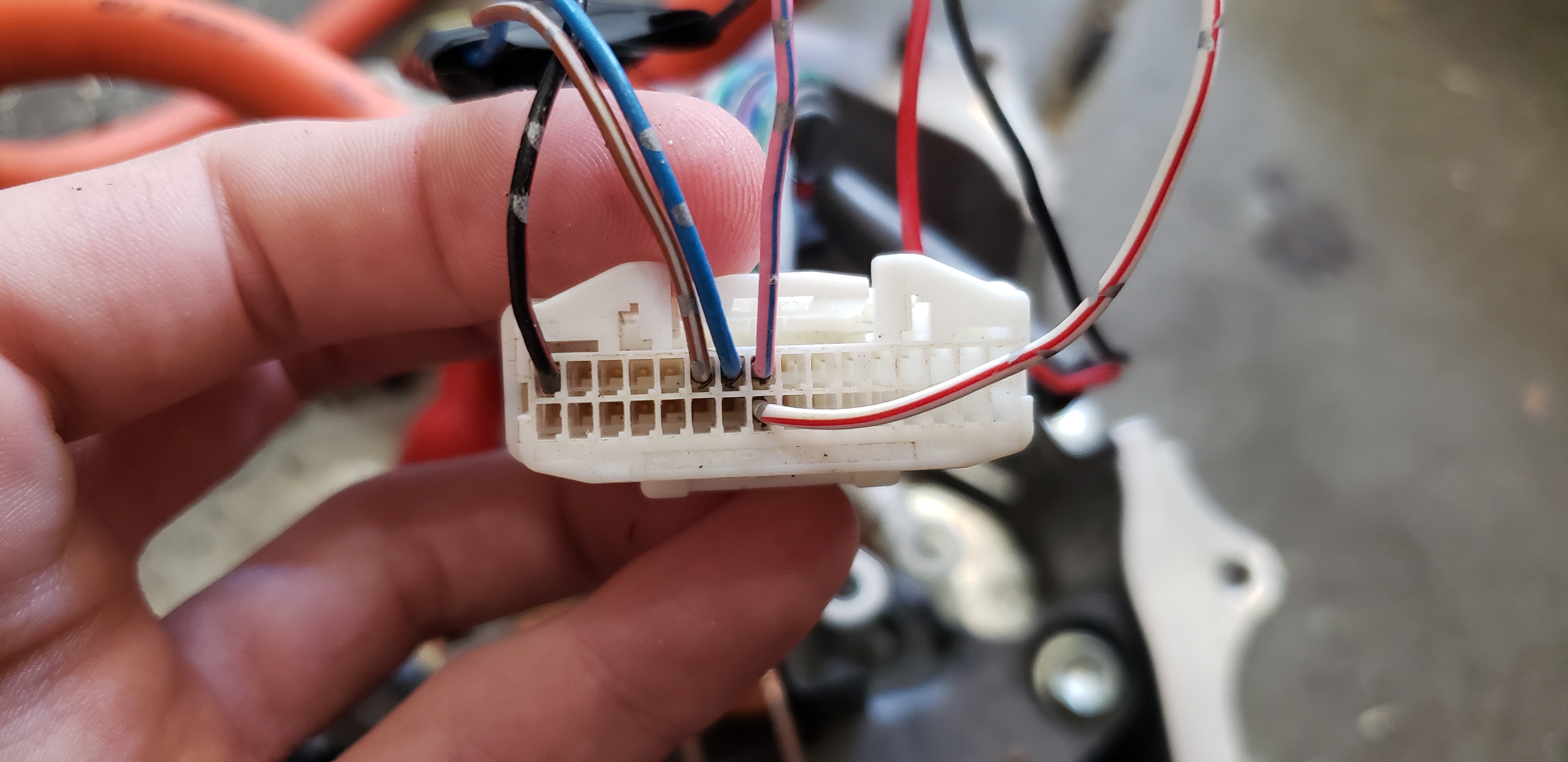

i did manage to get all my missing wiring harness, the MG1 and MG2 wires, the 32-pin connector, etc. But, no inverter. There's a chance it's on a pallet in the processing area, but, manager is gone for the long weekend. Oh well.

Here's a baseline test of inverter functionality that I ran today. I've used my inverter to drive small DC motors and it seems to be very functional.
Wiring as follows.
I9 gets 12v and ground.
HV into inverter (this being 12v at the moment).
On the white 32-pin: (I10 I think?)
Ground to pin 16 (black)
12V+ to pin 25 (red/white, MSDN) --- NOT GROUND!
And signal to pin 9 (pink/blue, MUU)
Default behavior. No signal, MUU floating.
Bulb does not light when between phase U and ground or phase U and HV+. So phase U is floating.
Then we ground MUU.
Bulb lights when between phase U and ground. Phase U is supplying HV+.
Now we let MUU float again.
Bulb lights when between phase U and HV+. So phase U is grounded.
So it seems that until you send a signal to a phase that phase is 'asleep' and will neither source nor sink current. Once it's received a single ground pulse it will then respond to signals.

Does anyone have any suggestions of what to next pursue for diagnosing my problem?
Troubleshooting the problem from both ends (keyboard on one side, HVDC / systemDC on the other side) towards the middle...
From the OI software: Connection to wifi module seems to work. Interface loads. Settings save. Starts and stops.
From the Blue Pill/signal: PWM is being generated. Signal appears to be correct waveform (soundcard oscilloscope). Voltages appear correct before transistors and after transistors to the terminals.
From the connection to the inverter: Wires between control board and inverter seemed to connect correctly, PWM signal was getting to the inverter harness as judged by backstabbing the wires. Even removing harness and connecting directly to the inverter IPM resulted in no change.
Then: ??? one or several gaps here ???
From the inverter side: HVDC is getting into the inverter. System 12v is getting into the inverter. Power transistors all seem to be working, and conduct HVDC+ (after wakeup) to the motor phase terminals, and after powering PWM line, the transistors toggle to conducting to HVDC-.
I'm not really sure what could possibly be breaking down at this point, or, what could possibly be the missing link. If I understand correctly, my latest test of powering the PWM line and manually connecting it to 12+ and seeing the transistors invert... is just a really slow mechanical version of PWM. So why does an actual PWM signal not work, when it does the same thing to the same pins in the same way?
The discovery of a "wakeup" requirement is interesting in terms of theory, but, should not have any practical implications since a PWM signal is going to be giving it a wakeup many times a second. This is probably why neither Damien nor Johannes nor anyone else reverse engineering the inverter ever noticed it was "needed".
And, how does this relate to the inverter working when I tapped on the blue pill board to get it to work, but connecting the wires better somehow made it stop working?
