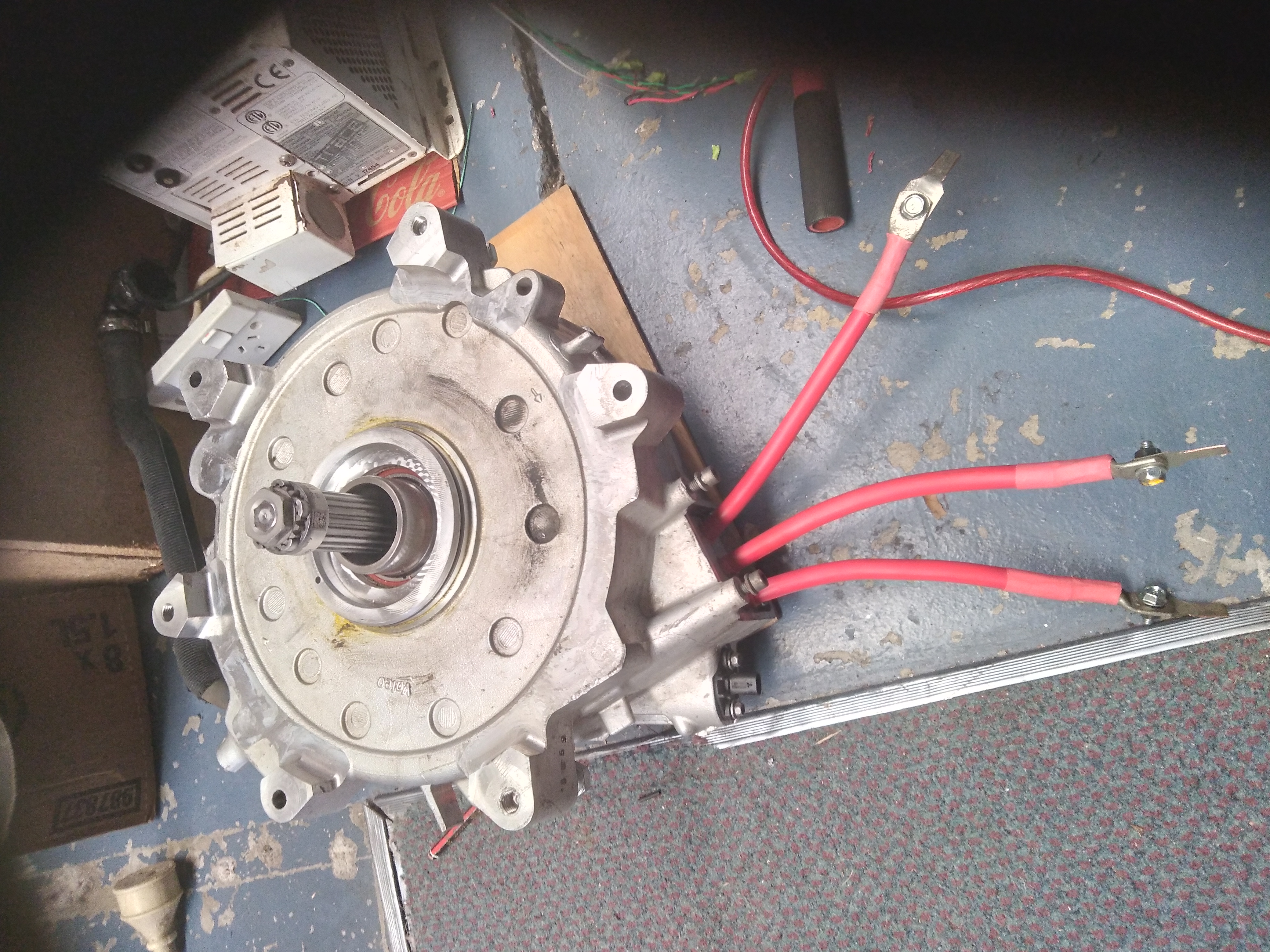

Re Jacobmess CVT suggestion. FOR an additional motor input , I.e . 3 motors and 3 inverters, if 3rd motor is electric not an IC input.
The CVT control of Lexus gs300h L210 to mitigate the higher speed of MG1 out of field weakening would seem like a Plan.
Have considered locking the 3.3 reduction on Mg2, with obvious torque reduction, but if MG1 and Power split combined with input shaft rotation, Electric or other, the 2.6 ratio of MG1 complimation and output driveshaft could be programmed for its max torque at low speed, (sprague clutch to stop reverse direction of input or your additional motor on the input, drawing amps to provide no rotation,so not a power draw???)and control the max MG1 speed to a non detrimental figure of maybe 6500rpm or similar.
BTW, now Have the I 3 REX now spinning on a Leaf gen2 inverter, if that would help.
I wonder of that unit would be helpful for your CVT plan.
This has become a L210 topic, so have repeated it here, from MGR topic.

There are 3 of the 6 holding M10 bolt holes that are tapped M12 x1.5, in place of yhe Bmw special tooling,
But with 3 M12 bolts and 25mm long 10mmdia dowels inserted in the threaded holes first , it can be uniformly jacked off.
The gripping of the anti backlash Torsion spline if what holds on, and at first thought it was possibly Rusted together.. once 25 to 50mm apart, depending on one or both ends of the Torsion spline releasing, it falls apart,
Bmw give no procedure for re using the spline , replace it at €504 or so.
Yes have a method if any one needs help , to get it together, will see if it works okay.

https://github.com/damienmaguire/Stm32-vcu
Results are going from 120A DC to now 280DC, and rising. Testing will still need to be conducted to find the real power limit.
viewtopic.php?p=67985#p67985
