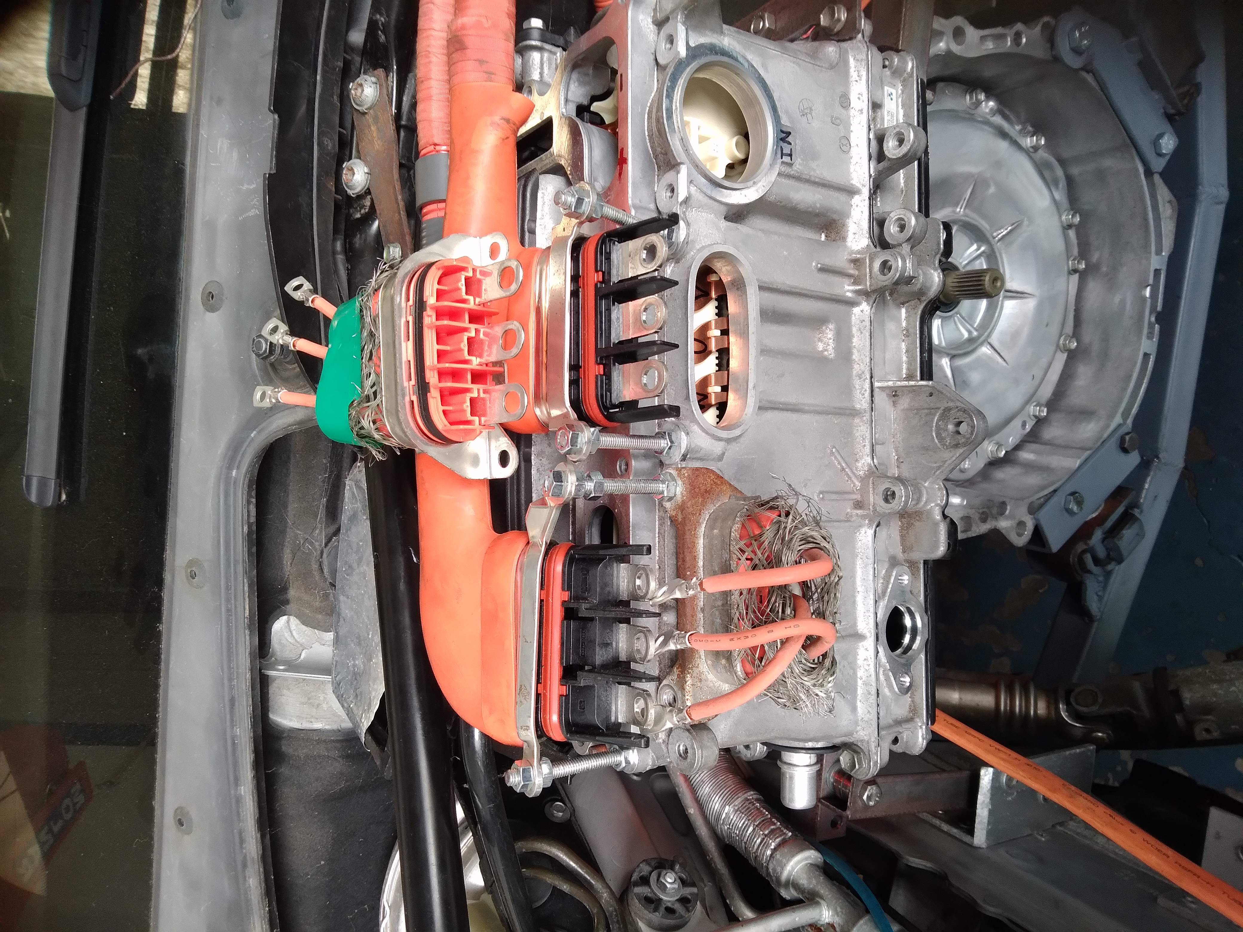

Hi, on the topic of L210 and Prius gen 3 inverter,
Have managed some test driving, using sync serial HTM
communication.
Have found is limited to max of 45 A, and max of 53 Kph.
Thinking is that this is similar to Priys EV mode, so now have a vehicle test bed instead of the Bench, some re discovery of the control into is required.

Nice work, couple of questions though. Did you hookup and cooling and MG1 for driving test?

Cooling circuit and small radiator are installed. A 5km run on MG2 only , raised temp 3°C above ambient.
First step is MG2 by itself, and establish V requirements , for desired speed of operation.
Then to add MG 1 to the power train .
Final stage will be to have a range extender option, input into spline, of a moderate 10 or 20 kw, with a Sprague clutch or other locking, to still use MG1 and MG2 for traction when required.

Re L210 trans gs/is300h Motor speeds, Gearing ratios etc.
Aim to establish expected rotor speeds, reported MTH speeds, in real world experience.
The BMWagon with the
1)L210 transmission,
2)Prius Zvw30 inverter, sync serial communication with
Dueboard,to HTM, MTH, REQ and CLK.
3)Running code modified from Gs450h github V7
Output Driveshaft has 3.33:1 reduction Mg2 to the driveshaft. (Wiki, and chrksy strip down.)
It would appear that Mg1 to the driveshaft has around 2.6:1 reduction.
At 50kph, measured with GPS app, as cars speedometer is not indicating, the serial data on arduino ide, reported 5200 to 5300rpm.
With bmw diff ratio of 2.7, and 26" OD tyres,
It would be expected to be around 3500rpm..
Am now suspecting that perhaps the L210 has a 6 pole pair motor, and the Prius inverter is reporting as if a 4 pole pair
Motor, which would report 6/4 the rpm.
A further test will be done with the wheels off the ground, and check Mg2 to Mg1 relative soeeds, as had only asked my screen observer for Mg2 speed, the test set up had multiple lead, comport losses, restarts, yardgate closures, and abnormal startup hiccups, which were further complicated by the arrival of some all important Sausages and Chips, for the assisting crew ,as a consequence Mg1 went unnoticed, in a few minute outing of 3km to find suitable road/traffic free zone to achieve constant 50kph.

Yes thanks, real world is good
With the drive system as described in previous post, battery current draw of a bit over 90A has been observed.
However had maximum speed appeared to be around 63kph, even on a slight downhill bit of road, and max of 78A drawn.
A step further, with wheels in the air, on a hoist, to see if some speed limit from the inverter was active, and higher speed estimated at 133kph, at the reported 14,000rpm if Mg2. And felt it would go higher..Just trying to assure that this is being overstated, before risking more speed... The gs300h or is spec is 200kph at 14,000 so again thinking if 6 pole pair maybe the case..
Has anyone any knowledge of the pole count?
So surprise there doesn't seem to be a rev limitation , unless this is linked in some way to power being delivered.
Back to some speed results
Mg2 at reported 14,000 believed to be 9333rpm if 6polep
Mg1 at reported 11,000 believed to be 7333rpm if 6polep
Numbers were fluctuating, but is fitting with the Mg2 ratio of 3.33, and Mg1 to driveshaft of 2.6 ish

Hi All,
Inthe progress and group assisting excitement, I have Screwed up... and apologies for the
17Dec post.
Haven't figured how to put in Highlighted snippets of previous messages. WIP
I stated a ratio for Bmw diff as 2.6:1
WHERE IT SHOULD BE 3.75:1
this lead me to concluding there was too many pulses coming from the motor, and that it could have been 6 pole pair.... I believe now that it will be a 4 pole pair motor, as in Prius's, Highlander Q211, and estimas, that have observed stripped down.
Regarding the reported info on the Bmw Diff ratio , that had measured maybe 2 months back, had written on tape on the driveshaft 3.75 : 1.
Memory had a brain fart, and when had looked up the gs and is diff ratios, of around 2.47 to 2.7, somehow perceived that the Bmw was in that ball park at 2.6.
Wrong...wrong... wrong, so apologies again for that serious anomaly..
Moving on to other things..
Have run at no load up to 14,000rpm,
And seeing 50A drawn which seems way too much.
Any thoughts appreciated. Thanks

Started on a path to check the seemingly large battery current under " No Load " ie wheels off the ground, so just final drive train unloaded losses.
These figures were recorded, before unfortunately damaging the ZVW30 inverter , with a suspected cooling pump fail.
MG1 and MG2 were slightly stammering at 3300rpm,
Current Draw of 7 to 10 A when holding constant speed. Not good.
So ran MG 2 alone. Mg1_torque = 0
3300 rpm 4.5 A
6600 rpm 10.3A
9900rpm 20.8A * then the unfortunate large "POP "
THIS Terminated any further measurements. The 20.8 A bus current would have been run for around 30 secs , Have no idea if what motor current was, cooling plate with water in was at 34°C after the event.
The Brief result of the little data gleaned before it Died
Is that the current was doubling at each step..I realize more data is needed, but this still indicates excessive current draw to me as the drivedshaft 1000rpm steps proceeded.
I had not disconnected UVW of Mg1, batt V were 298v
Could it be this excessive current is Field Weakening?
The Prius ZVW30 inverter is maybe unsuited to L210
Will Require another inverter to Continue..Bugger..

Today was able to do some more follow up.
Another Inverter, #2 with its Boost converter annulled, I.e. it's connections isolated, as may have had some of its Boost circuit fail before I obtained it.
Mg1 has had UVW disconnected, and set mg_torque = 0
Comparing to inverter#1 , appears to draw more current at 3300rpm Mg2 speed, at 6.3 A cf 4.3A beforehand
This is not encouraging, as I was already concerned that the unloaded draw felt a bit high.
But the more disconcerting fact is that when run forv15 sec at 3300rpm, a change in note of motor noise occurs, and a Current jump to 10.4 A. This indicates some instability that is very undesirable.. Unknown at this stage, but raises the question of is the Prius gen3 ZVW30
Inverter not suited to the L210.
If anyone has bench test data of V and A draw of L210 transmission with its proper 300h inverter, at 1000rpm driveshaft speed, I.e 3300rpm Mg2 speed.
I would be keen to know your findings.

Lexus L210 trans having some back emf challenges.
some more, Bmwagon probing. Input shaft locked wheels unloaded.
Running Mg1 to drive Mg2, phases disconnected.
1000rpm drvsft 140vrms
2000rpm 280vrms
3000rpm 460vrms
4000rpm 560vrms
Hmmmmm could be a challenge for the 270v nominal bus. Seems like back emf is troublesome and being a possible handicap to the 63kph max speed achieved, at around 1875 rpm drvshaft speed.
Options are.
1)More base voltage.
2)A macho Boost convrter
3)Diff ratio of around 1.5:1 (presently 3.75 which about 3000rpm for100kph.)
4) modify internal gears in some way.

Do you think it's a fundamental issue with applying the Prius inverter to the L210 - would results be better with matching inverter from GS300h?
Woodfie
- Posts: 242
- Location: Auckland NZ
- Has thanked: 221 times
- Been thanked: 96 times
Re: L210 gearbox
Would like to have had a matching inverter to try, but haven't one available as yet. The Prius gen3 inverter maybe switching to FWeakening at lower speed,
However unfortunately feel it is fundamental at this stage.
The GS300H. with 2.7 diff, 14000rpm Mg2 would likely be 600vrms, with FW and bus boosted to say 650v, maybe where it sits.
May have an option to try a GS450H inverter, although yhis will not change the suspected voltage deficiency.
