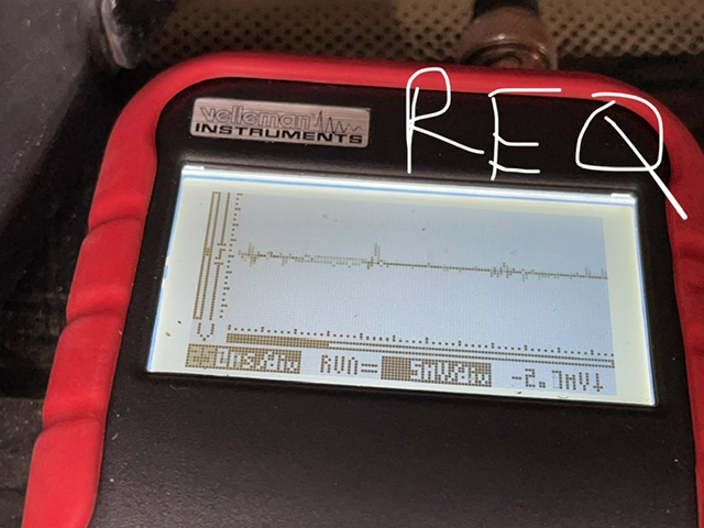

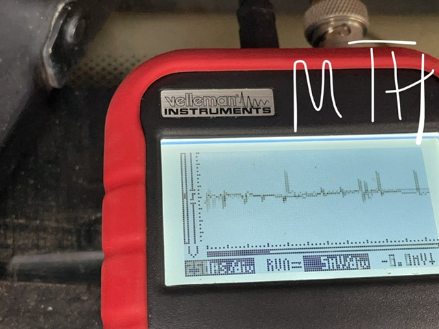

Still having some issues when trying to get my is300h inverter to work:
After every power cycle (remove 12v from zombie and re apply) I have to reselect CAN2 for shunt can, yes I’ve saved parameters, it starts as CAN2, I have to select CAN1, then back to CAN2 for it to work and precharge etc. re-initialising the shunt hasn’t helped
All 4 comms channels have 60ohm resistance and using an oscilloscope I found REQ and MTH seem to have no data on them, just noise (see photos)

The CAN2 issue sounds like either a VCU specific code or libopeninv problem. Either way I should be able to replaicate this on the bench and provide a fix. Not seen it myself as my shunt is on CAN1. Just goes to show how valuable feedback and participation is to this project.
Regards the GS300h. 1 amp of 12v draw means the inverter is alive but not initialised. It will draw approx 1.5A when punched up and ready to run the motors. No MTH data can mean : Inverter problem (unlikely) or the CLK signal is not reaching the inverter. The REQ pulse is very narrow so may be missing it with a handheld scope. That said even if REQ were missing you would still see MTH packets. With 60R on all 4 pairs it means you have no open connections but it does not mean the polarity is correct so be sure the + is to + and - to - for all 4 pairs. Just one last random thought : like the 450h the 300h inverter has an inverter disable line. I dont't have it connected to anything on my bench rig but if that were asserted ( i forget its either pulled to gnd or 12v) then that would cause the inverter to display the symptoms you are seeing.

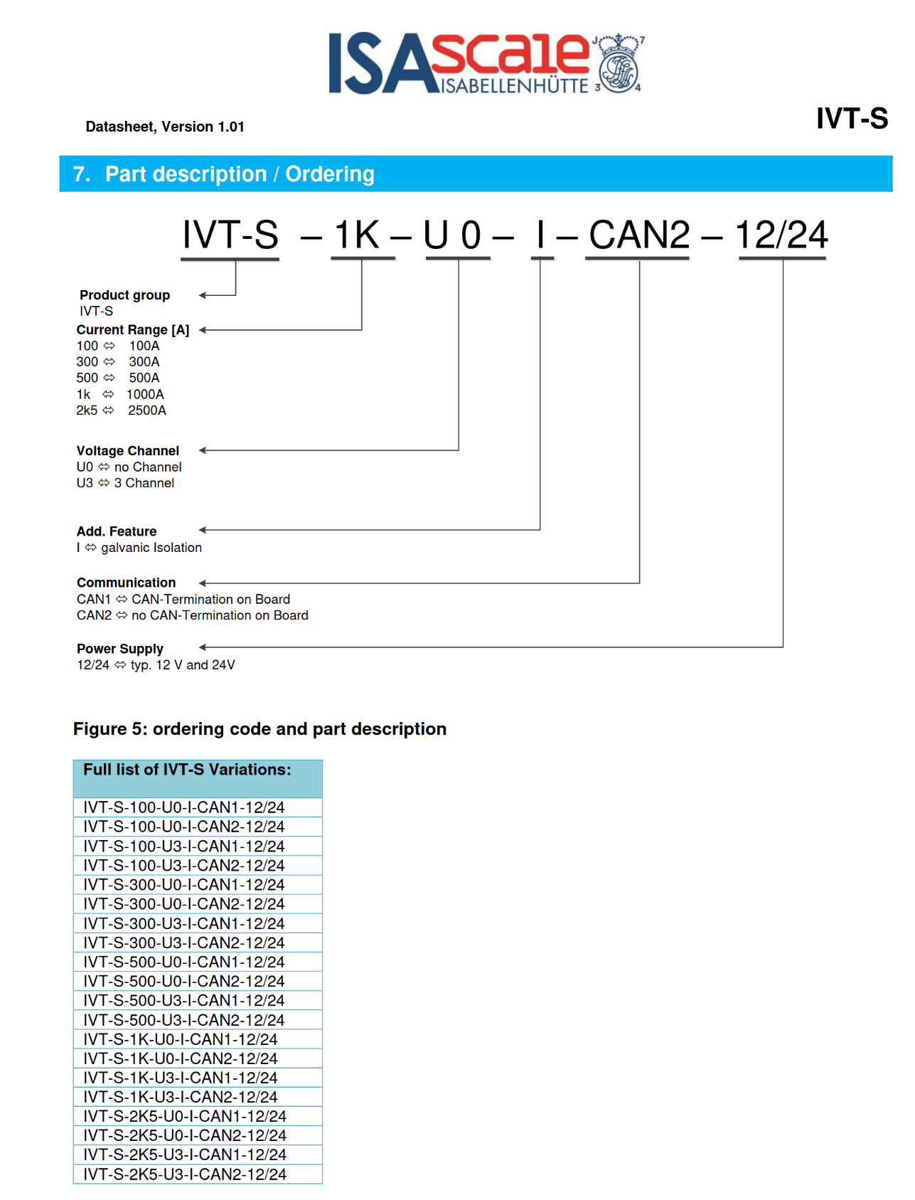

FieroJam wrote: Mon Sep 26, 2022 7:48 pm The link for the shunt has this:
[wrong IVT-S]
I notice that Isabellenhutte has a number of different models.
Is there anything specific we need to look for in a IVT Shunt for it to be compatible to the Zombieverter VCU?
Generically, the "correct" (probably most commonly ordered/used) IVT-S is IVT-S-1K-U3-I-CAN2-12/24
https://www.evcreate.nl/shop/charging/i ... ge-sensor/
and Lars is selling it at €295. I need to buy one too, but the price is a bit daunting right now. I'm hoping a group buy comes up again.
Depending on your installation, you can change some of those parameters (eg "1K" could be "500", or "CAN2" could be "CAN1", but you'll need to stay with "U3", otherwise the unit doesn't have a way to measure voltage, which the ZV needs.
"I" and "12/24" are the only available options, so they don't change, ever. Click on the image below to be able to read it:
ISAScale IVT-S datasheet
The datasheet (at Lar's website) is https://www.evcreate.nl/wp-content/uplo ... _IVT-S.pdf

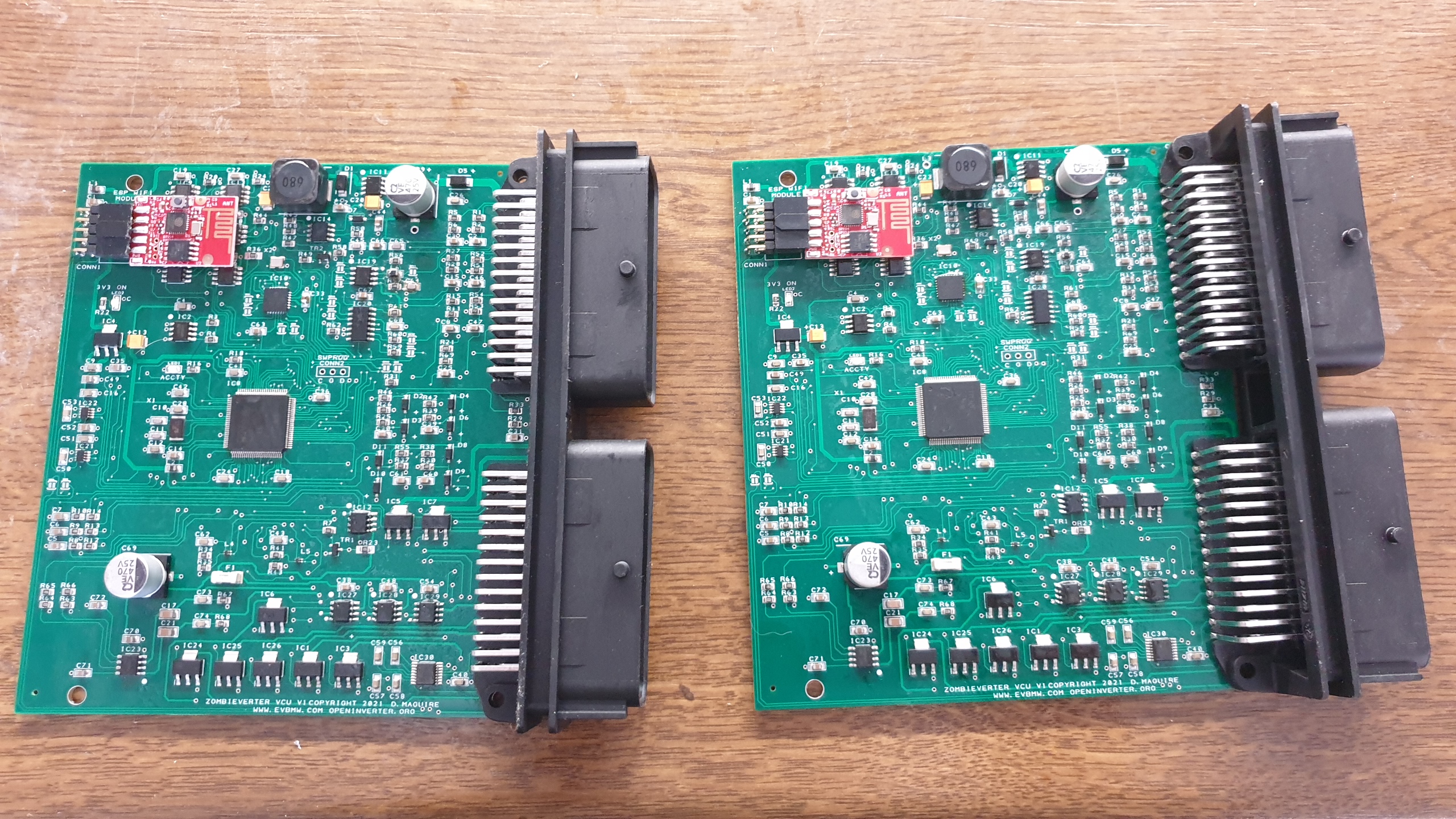

Fully built vcu boards are in progress:) Of course my crappy aliexpress 60v 5a psu decided to go pop this morning...

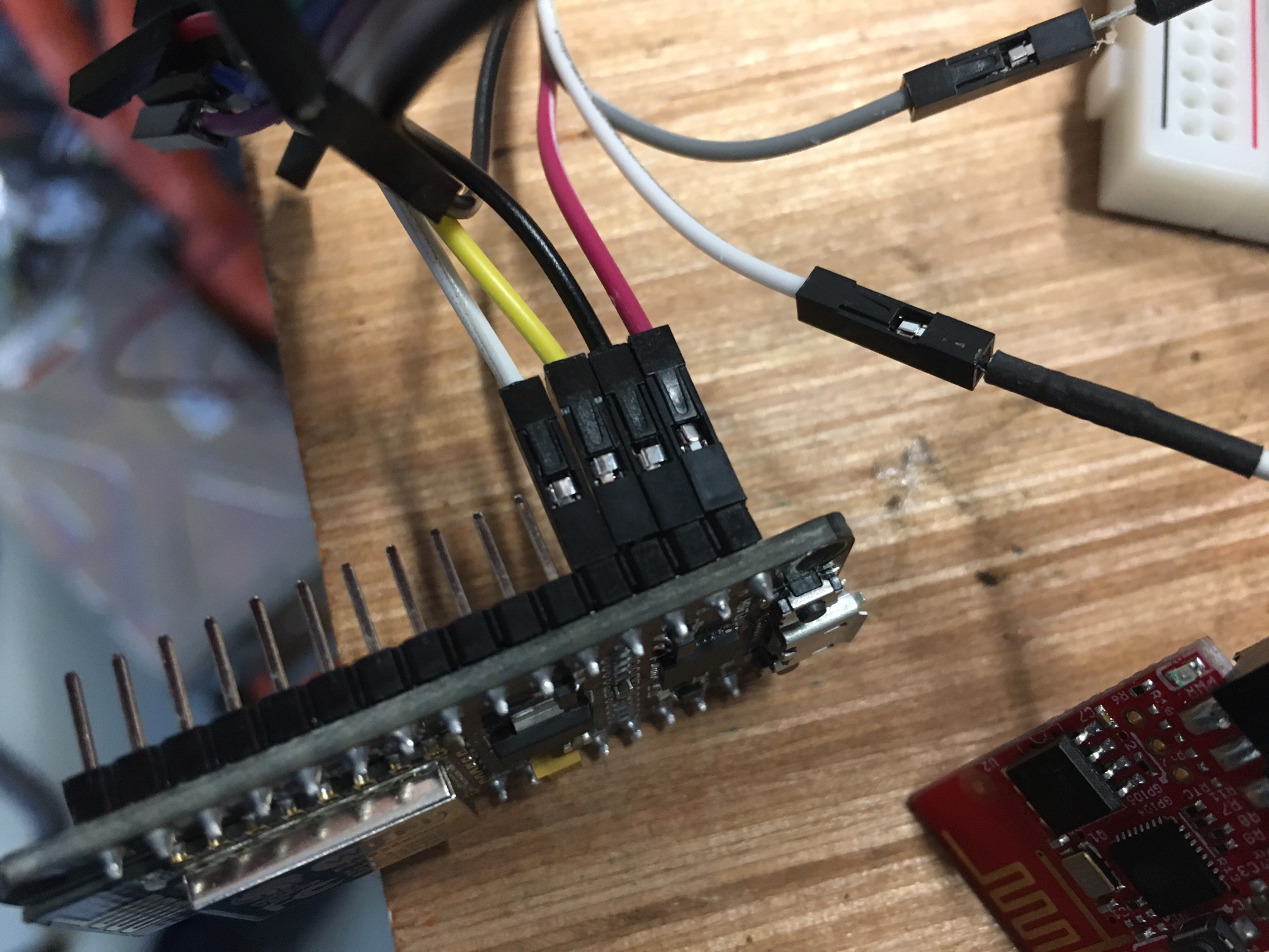

nkiernan wrote: Wed Sep 28, 2022 7:27 pm Just for info really following some earlier comments/suggestions in this thread.
I downloaded an android wifi analyser and did some checks. Pretty much out in the sticks so only networks that showed up were the Zombie and PCS controller wifi channels, and the PCS I can turn off when testing the Zombie. So my hit and miss wifi firmware updates could be the ESP or maybe just my old laptops issue.
So I got a clone ST-Link hooked up and working with STM32 Utility and can now upload hex files direct. Uploaded the latest V1.01 hex and was feeling good that this might fix the no spinning, InvStat = Off and InvUDC = 0V issues I'm having, but ran a few tests and same result.
So will wait for the built Zombie I have on order and see if that has a different result, pretty sure it will work out of the box
What's that I hear you ask?
Thank you for asking - that's a nodeMCU in place of the Olimex. After much headbanging, it works beautifully. I had PIA network issues, installed a WiFi repater, changed the wifi channel to no avail. Swapped out the Olimex for a nodeMCU (nodeMCU because I had a spare one handy) and it all works a zillion times better.
Today is a big day - got the nodeMCU working reliably on the ZombieVerter, bought a good value 2004 E46 Touring for conversion and a 530e HV battery pack was delivered to my home...... That should shut me up for a while
