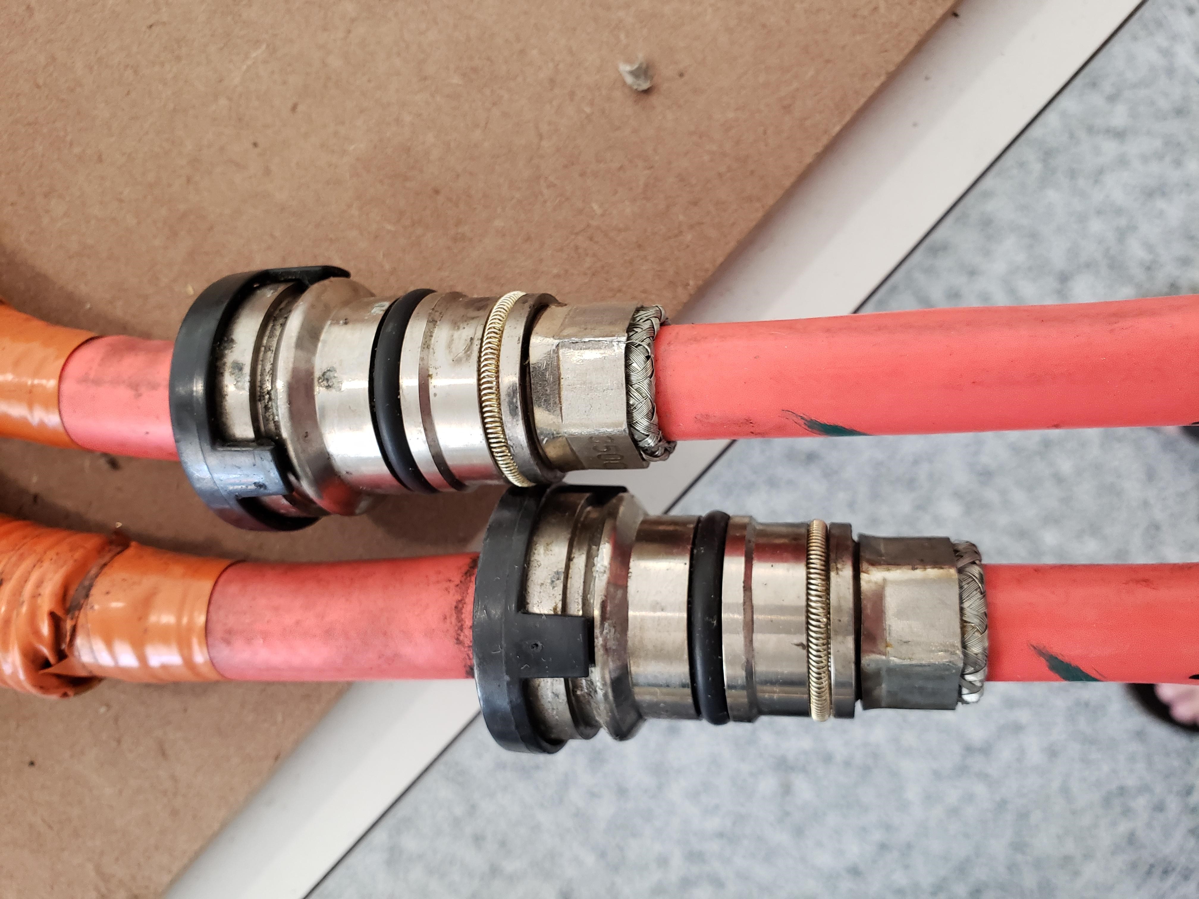

I'm not super happy with the stock HV cables for the LDU from Tesla, and am considering building my own bespoke cables, but there are some bit's I don't know how to source, or even what they are called. They are the connectors/Shielding terminators in the attached photos.
Any help would be appreciated.

Post by Kevin Sharpe »
Hank wrote: Thu Jun 04, 2020 6:24 pm Any help would be appreciated.
I tried searching for terms like coroplast, screen termination, ferrule, HV crimp, etc., but didn't find anything useful :(

Post by Hank »
Alrighty then....$20 Amazon gift card to the first person who can accurately help me source these little buggers for use on my project.
This is driving my crazy, and I'm 90% sure these are available off the shelf somewhere.

Post by SciroccoEV »
Closest I've found so far are pass-through systems from APTIV.
Pages 16 & 17 of;
http://www.farnell.com/datasheets/27874 ... PEQAvD_BwE

Post by Hank »
Thanks for the tip, couldn't find anything, but did get some good search terms.
Anyone else?
Hank wrote: Mon Jun 15, 2020 4:23 pm Thanks for the tip, couldn't find anything, but did get some good search terms.
Anyone else?
I'm still looking for the crimps. In the meantime I did find this;

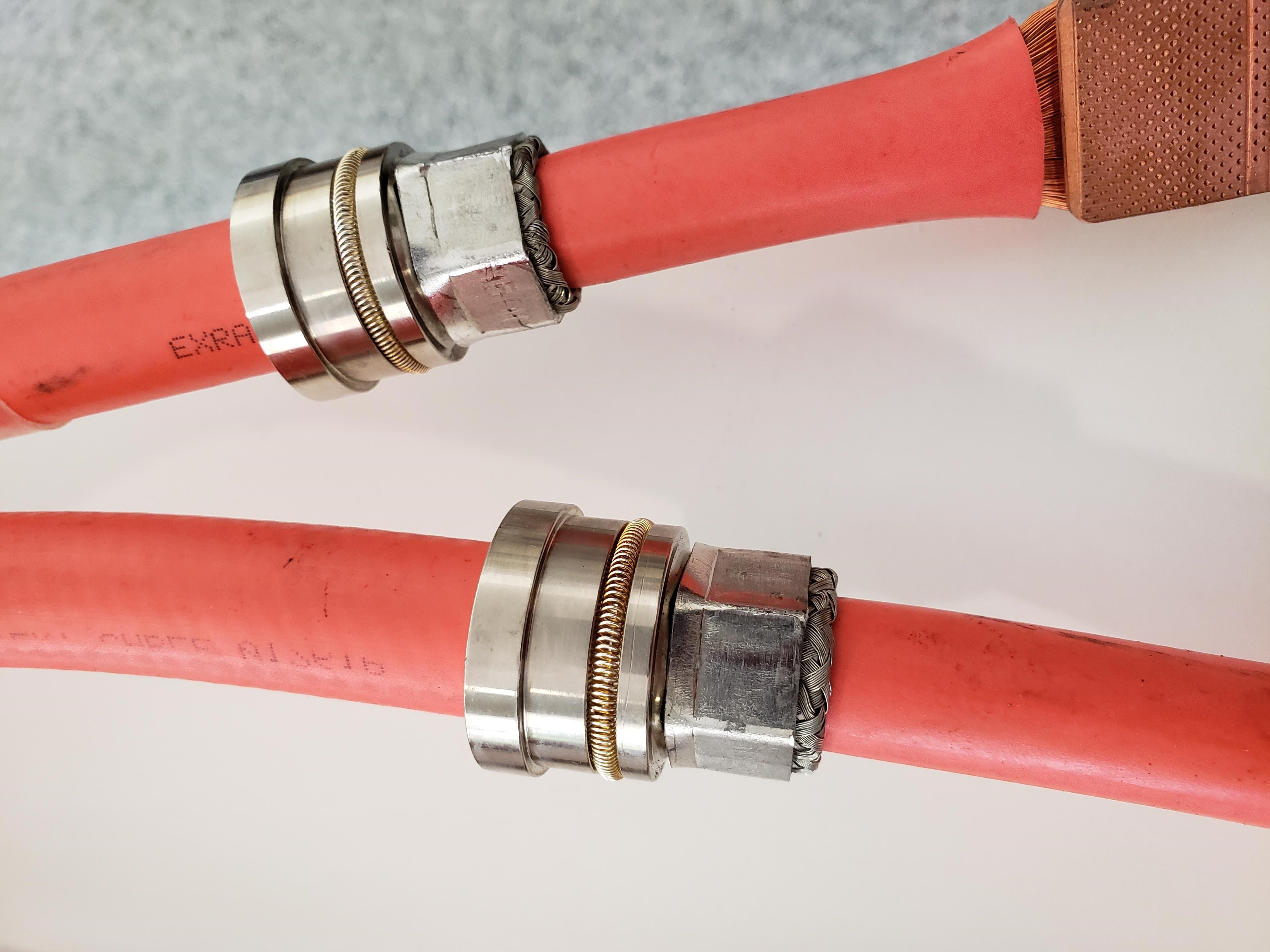

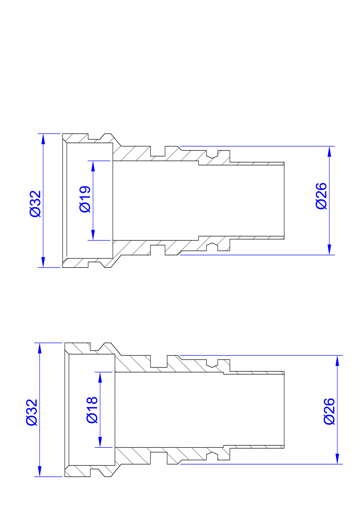

I have a similar problem, I need longer cables on the motor. My 70mm² cable has a larger outer diameter than the AWG 2/0. I will make stainless steel parts to make it fit.
Posts: 2962
Has thanked: 328 times
Been thanked: 847 times
I am also working on some adapters that we hope to sell at Zero-EV. Utilising gland components to work with 70mm2 or 50mm2 shielded cables.

Just got confirmation from Zero-EV that they expect to have these available in the next couple of weeks.
I'm on the notification list, very excited about this. Thanks @Tom91, appreciate it!

Hank wrote: Thu Jun 04, 2020 6:24 pm I'm not super happy with the stock HV cables for the LDU from Tesla, and am considering building my own bespoke cables, but there are some bit's I don't know how to source, or even what they are called. They are the connectors/Shielding terminators in the attached photos.
I couldn't find anything and decided not to wait any longer :)
viewtopic.php?f=11&t=37&p=15806#p15806

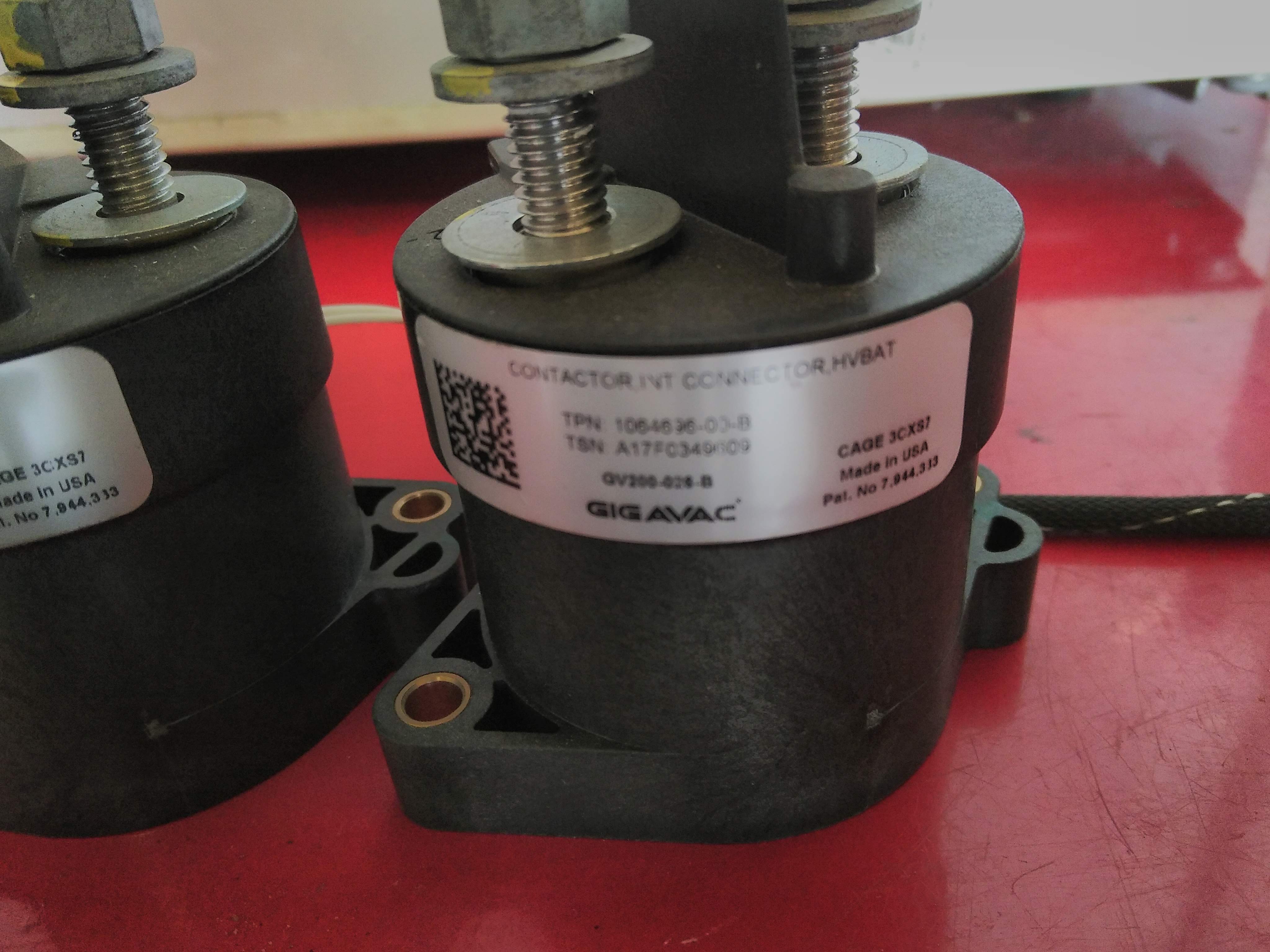

Kevin Sharpe wrote: Fri May 22, 2020 6:32 pm
konstantin8818 wrote: Fri May 22, 2020 5:37 pm So I need to attache them back?
If you run a contactor that requires an economizer without one then you'll burn out the coil.
We had the Tesla Model S/X contactors on the bench this week. I can confirm they consume ~2.5A @ 13V and get very hot. They require an economizer.

Post by JaniK »
So to test if you need economiser on random contactor, just run it for a while on the table and check if its hot?
And check amps.
Is it that easy?

JaniK wrote: Sat Aug 29, 2020 3:58 pm So to test if you need economiser on random contactor, just run it for a while on the table and check if its hot?
And check amps.
Is it that easy?
Any contactor drawing anything more then 1 amp usually will run hot, so thats the first tale tell sign.

Post by JaniK »
tom91 wrote: Sat Aug 29, 2020 4:15 pm
And check amps.
Is it that easy?
Went ahead and tested Ford Focus Electric 23kWh contactors.
Main HVBAT+ TE 2098952-2
It Will disconnect at 1.2V0.3A
Reconnect happens at 6.6V1.56A
Draws 2.7amps at 11v stepping down from 12V el-cheapo.
When adjusting the voltage down to point where current is 1A, it will take 4.2v
Charge/precharge contactors TE 2138551-3 draw
0,7A@12V
0,35A@6V
Cutoff 0,16A@2.8V
Cutin 0,28A@4.8V
Measured with a DIY adjustable 1-12V power supply made with about second cheapest semi ready parts on ebay, so not the most accurate but still wanted to share.
