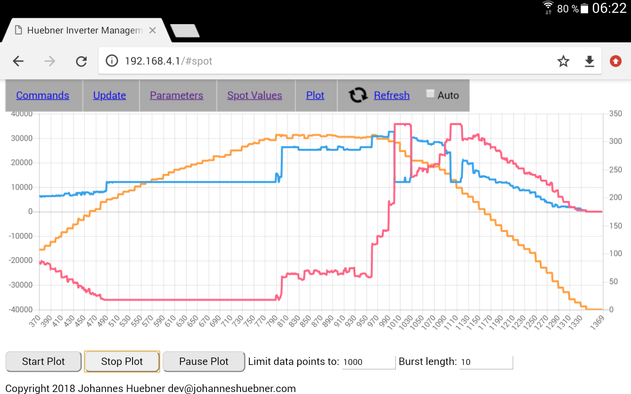

I finally got a chance to test drive my car up to resonable speeds. Unfortunatly the results are disapointing but expected after tests done by tom3141.
I'm getting good acceleration up to around 40-45km/h and then field weakening is required and reduces the fun to about 11kW or 30A battery current with the settings used. The car still accelerates uphill so I can get upp to my desired speed of 80km/h. I would prefer to have 20kW available up to 80km/h for some more margin. Running a 96S battery pack at 360V. To make this motor work good I guess you would need a lot higher voltage...
Ud and Uq on the left and fstat on the right scale.
Prius_MGR_FW5_00FOC_2021_03_31.json
Used parameters during test
(1.28 KiB) Downloaded 413 times
Maybe time to admit defeat regarding MGR and try to find another motor solution.. Kia HSG might be an option, even though on the weak side...
EDIT: To get from fstat(Hz) to motor speed(rpm) multiply by 15 and to get from motor speed(rpm) to vehicle speed(km/h) divide by 65,8,

Lets you specify id/iq per throttle separately. So you could try 2A/% id and 1A/% iq or so.

Re: Renault Clio Electrique -97
Post by bexander »
No, I must have missed it.
However I don't think that SW is a permanent solution, more a testing thing? I already know there is potential in the MGR so I will focus more towards finding a permanent solution with good control far out in the FW domain...
